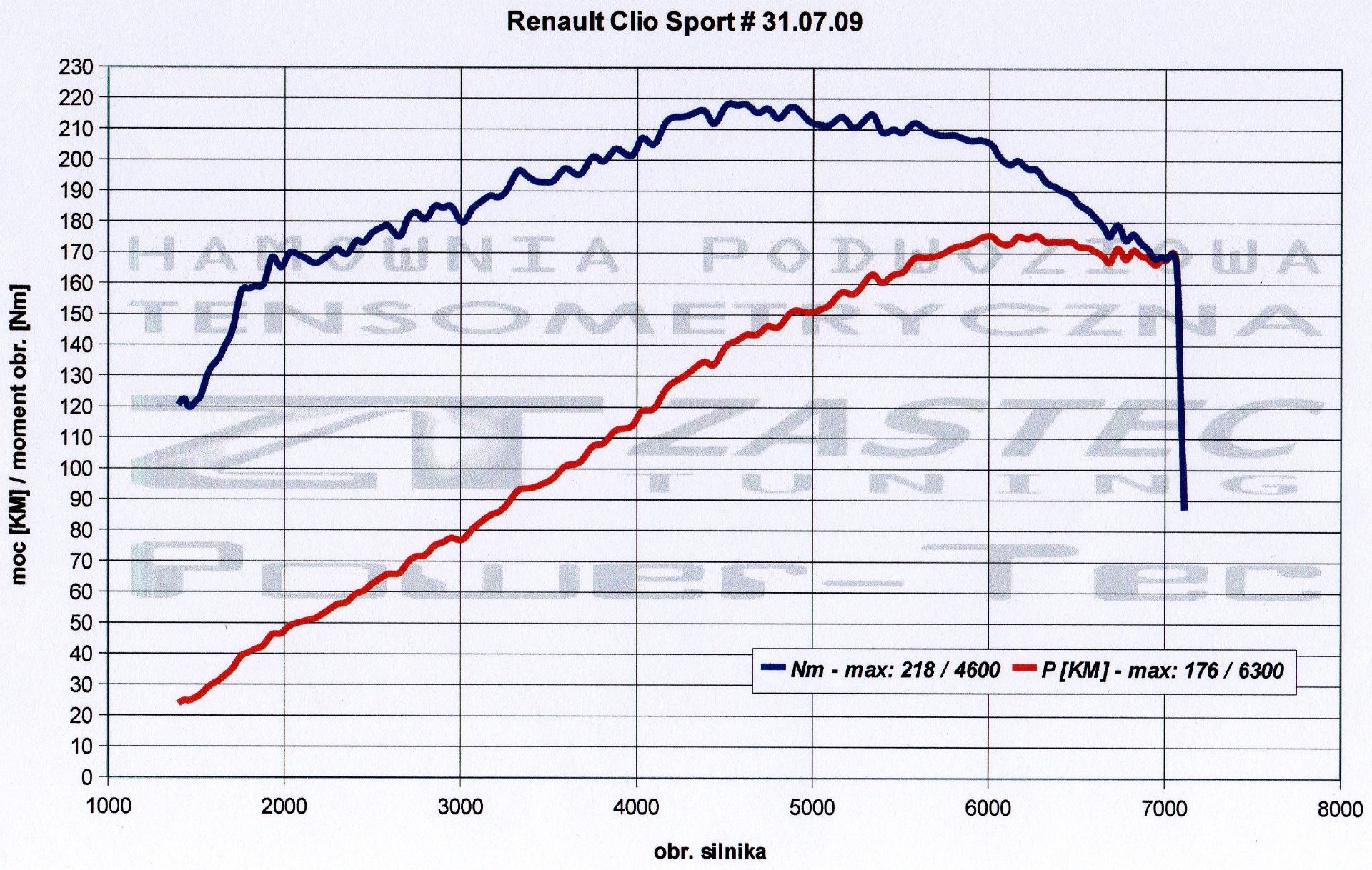

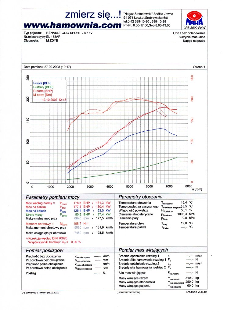

not by it self no. I'm just saying how my power and torque changed before and after fitting 182 mani and full stainless steel exhaust.
before:
and after:
Notice the top end power is 2BHP less and 500rpm lower, but mid range is way better in ful range (and still last RR was made in 30'C heat without DIN correction)

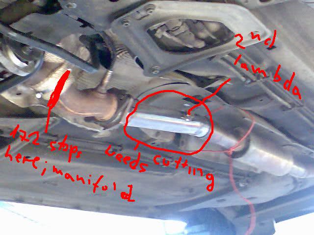

just the keep the new threads down, i've got a ph1 but want to so a 182 manifold at some point. would i be able to use say an 182 mani - decat - mid section, or does it take a different route down the car. at a guess the back box would be the main difference?
cheers

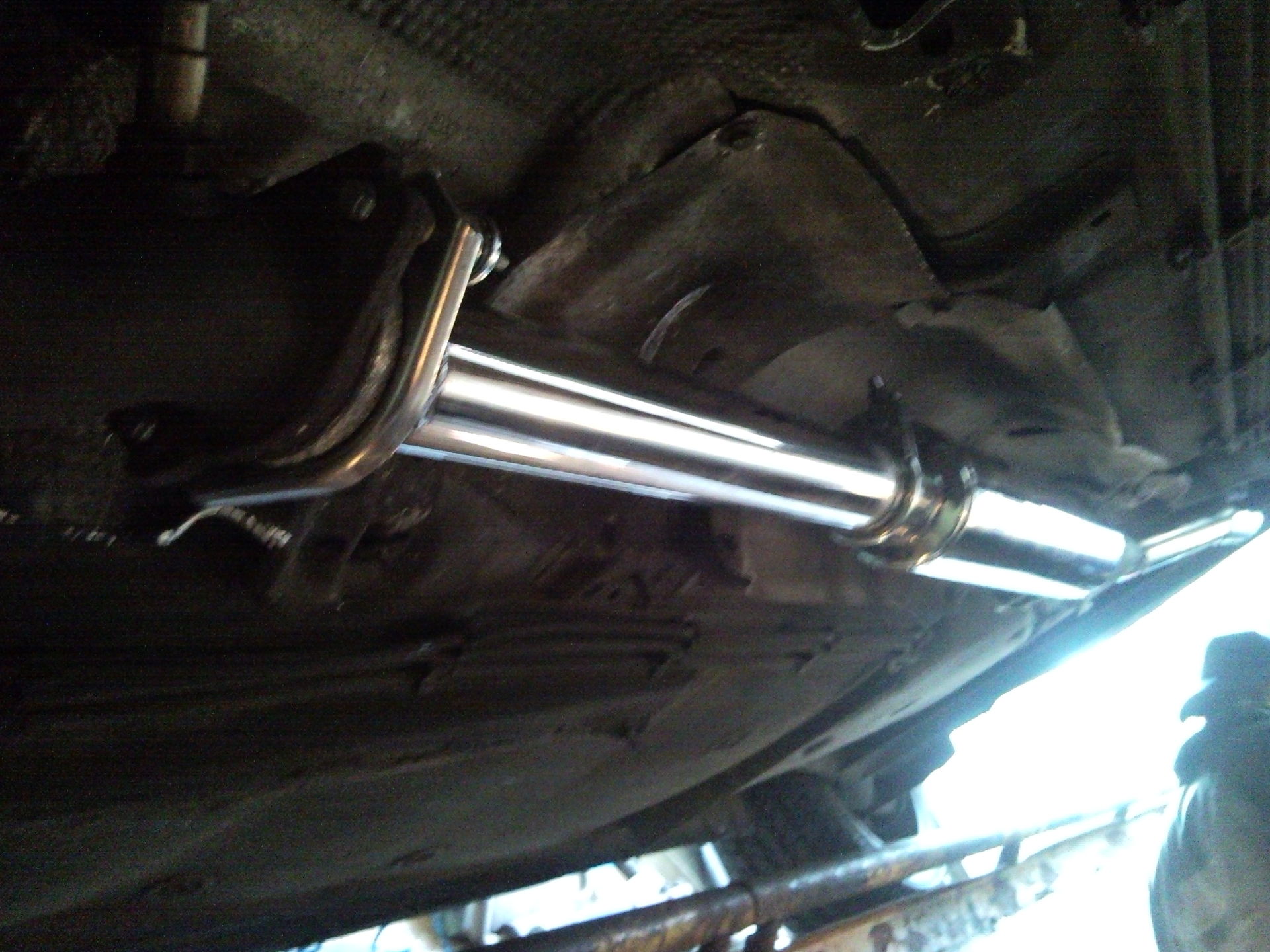

main difference would be the center section :) You can use the linking pipe or make a whole new one to make it work
I made myself a new whole custom center section which links mani to the end silencer section. It works perfect
