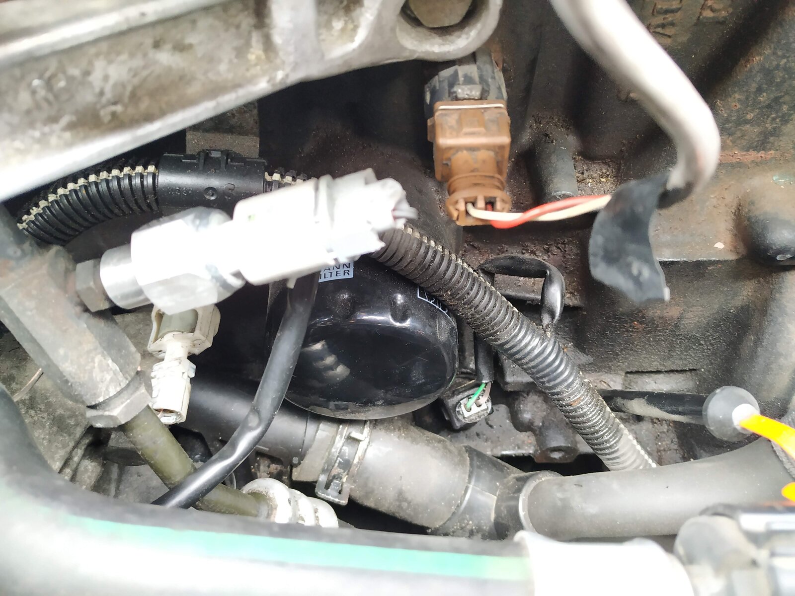

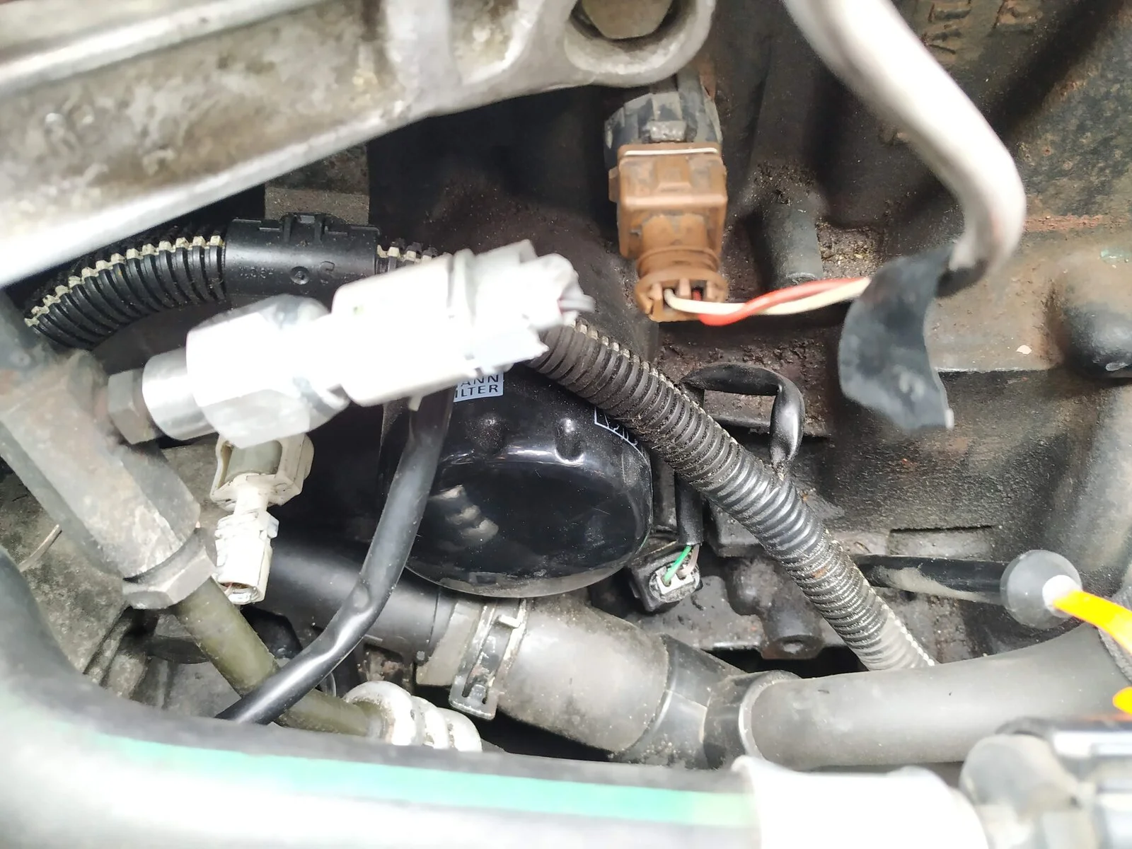

Back on it again this weekend ...... so ... after changing all four fuel injectors for new (no improvement) ... I tried the following .....
1. Disconnected two sensors on the front of the engine see photo ..... I assume the one top right (red/white leads) is the knock sensor with very awkward cable connector and the other left of oil filter with only one lead is ???? and I did not touch the one below the oil filter that I assume is an oil level sensor
results in no change to EML warning (misfire on cylinder 1) and engine always running well
