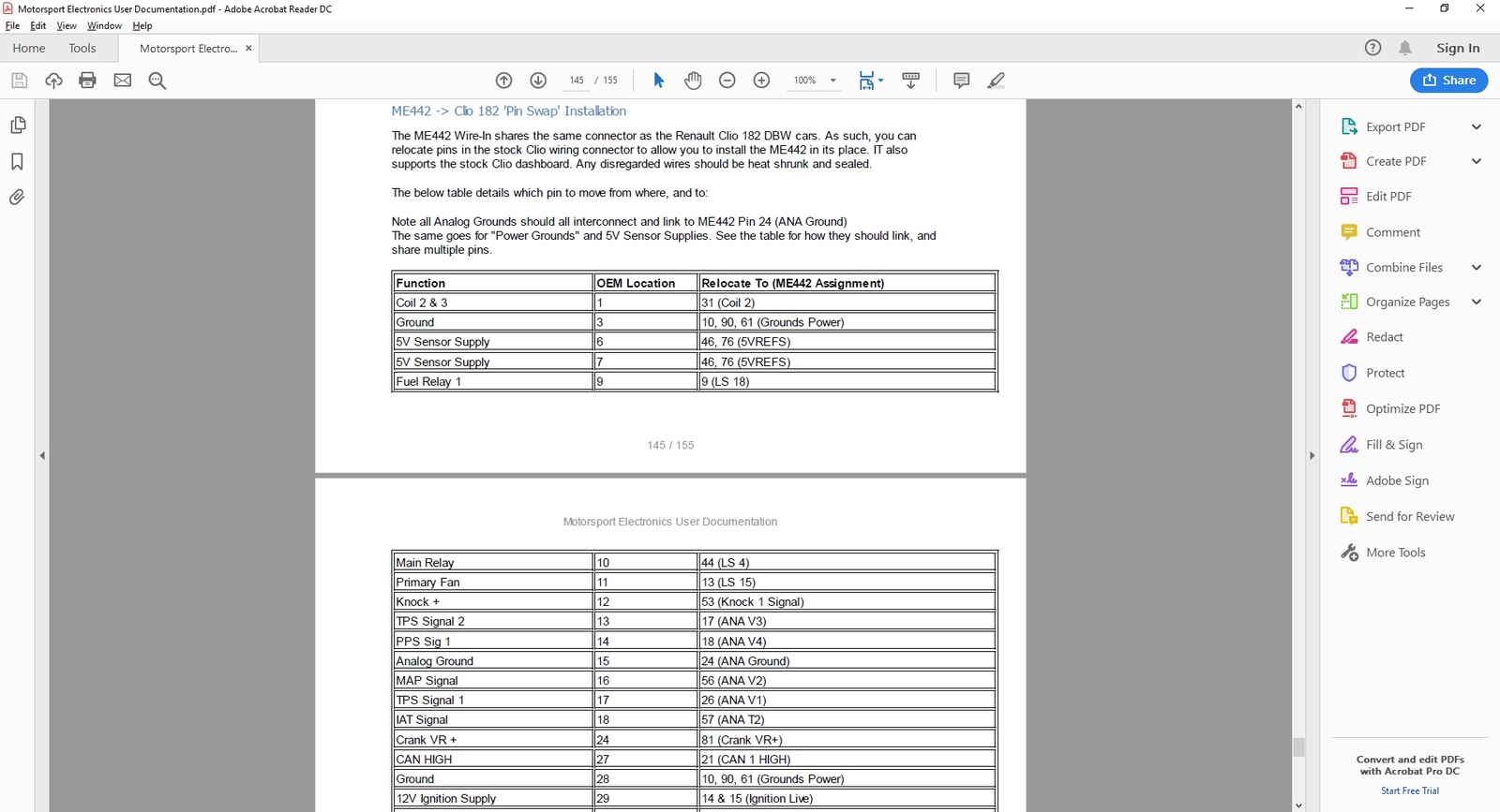

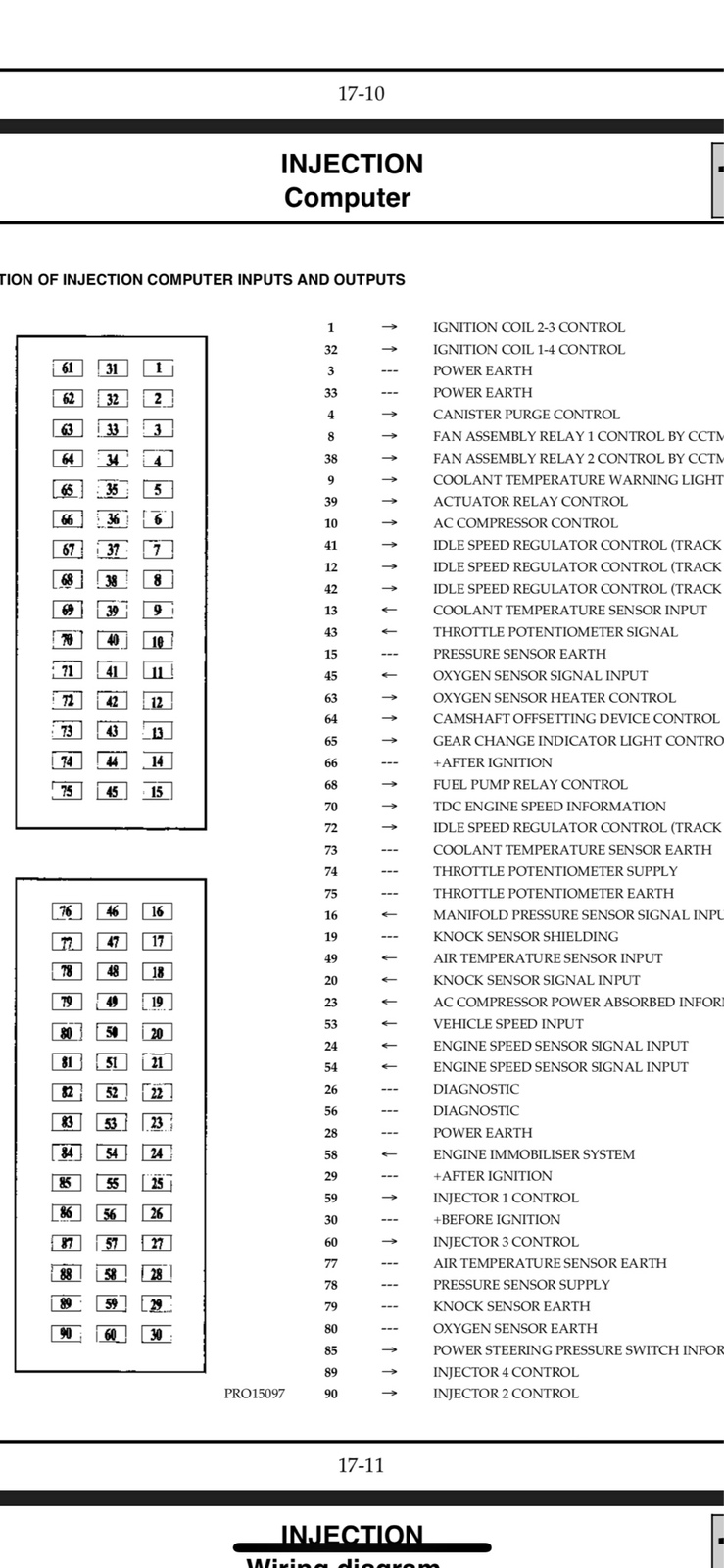

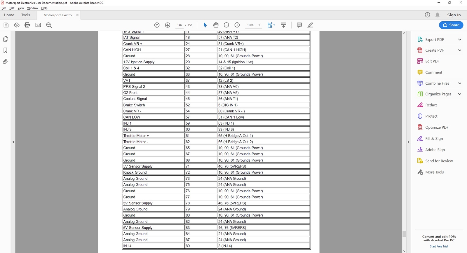

Hi CS sluths can someone familiar with the wiring pinout for a 182 let me know if the pinouts for the ME442 is correct? I have an old copy a phase I 172 manual and the pinout in the OE side are number different to the ME wiring guide. As below. Is this right? For example fuel pump relay is marked differently.
