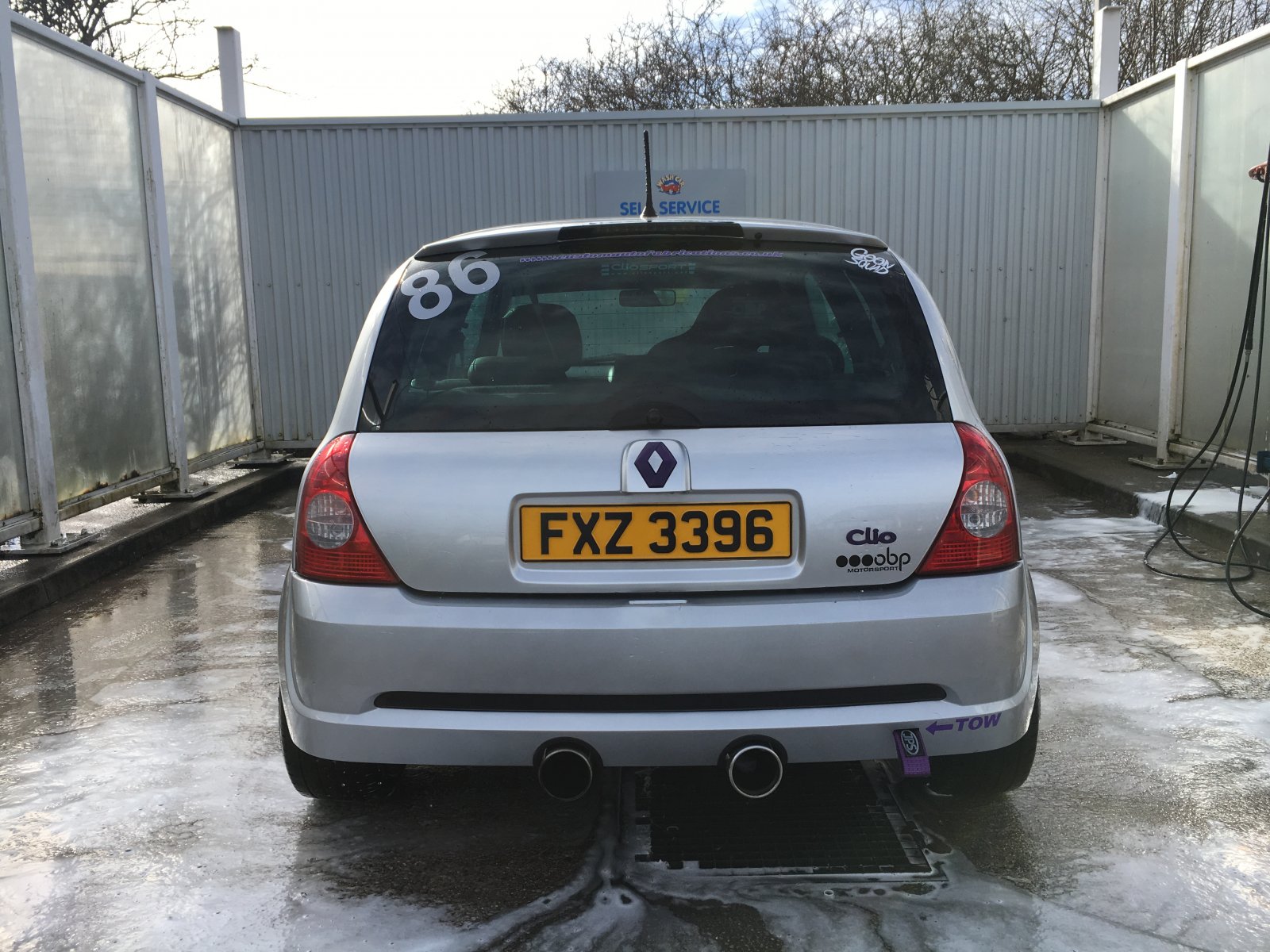

Not usually required if its for recovery on track and you have a cage, pop boot open and tow from that with a strap

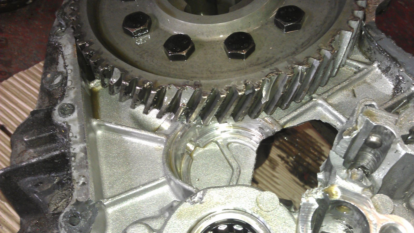

nah, belongs to guy called rob. it's the one that kept eating gearboxes!! just waiting for my back to b fixed then chucking a sadev in it.

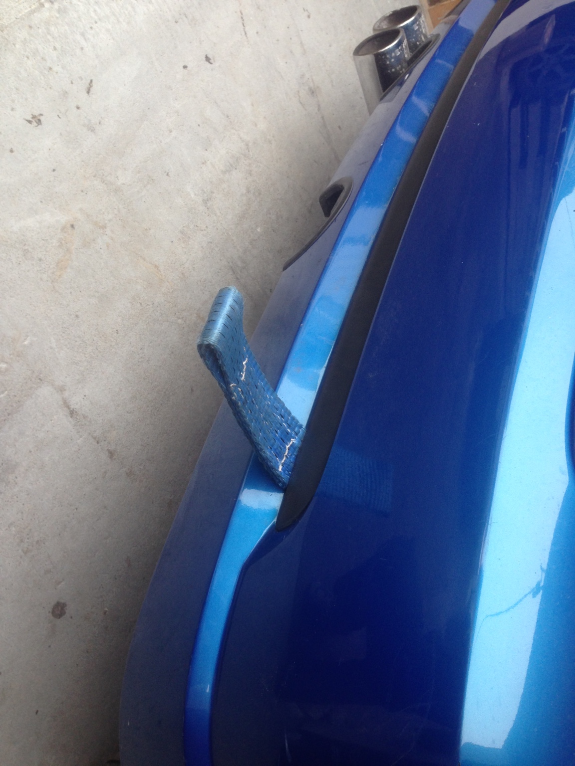

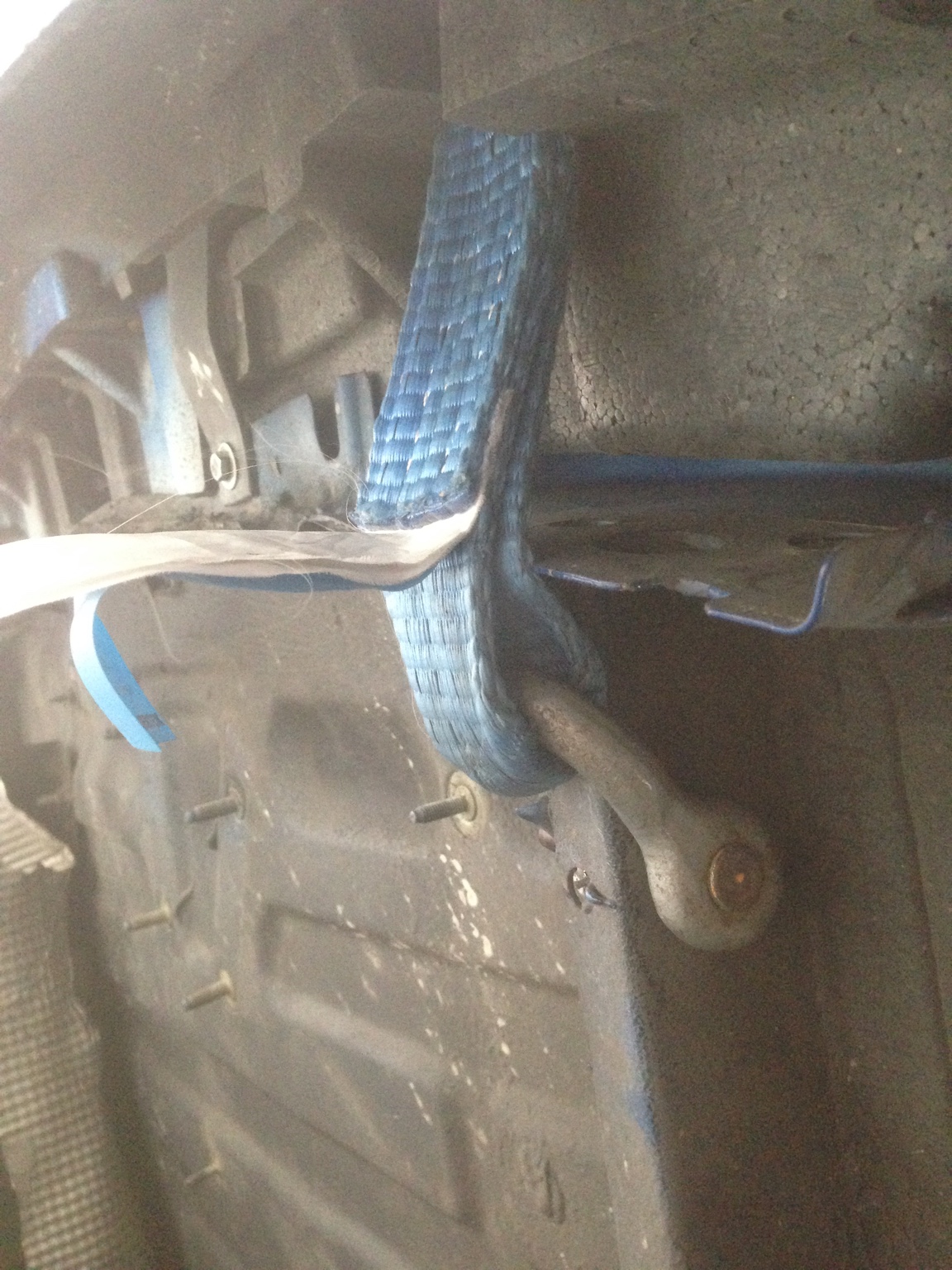

Rear towing,,,,,I'm cheap so used one end of 2T ratchet strap, relieved the black trim and cut bumper behind. Strap is then D shackled to the rear frame. There is a convenient hole I think. My thinking was that if I'm on fire I just want to be off the track pdq before it catches fire too.

Theres a hole in the rear chassis behind where the rear bumper insert is. About 12-14mm diameter.
