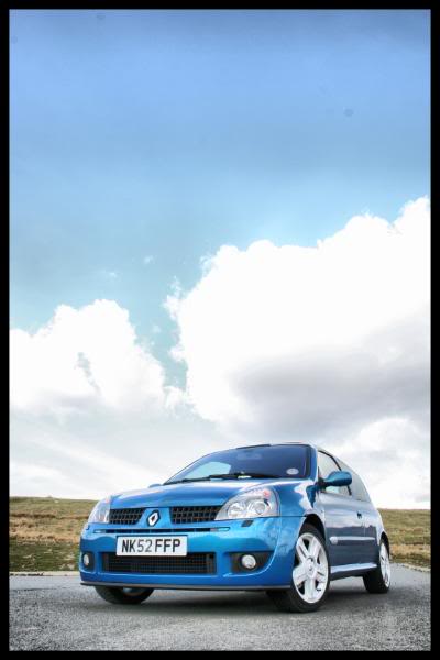

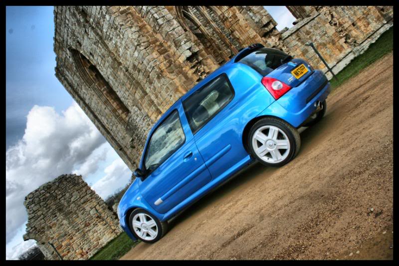

heres mine
front bumper with all grille's fogs and cup splitter 150 pounds
new old passenger wing 20 pounds
new drivers wing off renault few quid short of 50 pounds
side skirts 80 pounds for the pair
rear bumper 60 pounds
dynamique interior 25 pounds
xenon headlights 170 pounds
sport steering wheels 50 pounds
182 exhaust surround 32 pounds or some thing daft
i make that 637 ish plus paint and to get them painted your talking a good 250 if not pushing 400 really, doing a sport rep aint cheap, and im sure most people will tell ya them bits i got are bargins
then add custom exhaust at 320 and your lost in negative numbers in your bank account :(

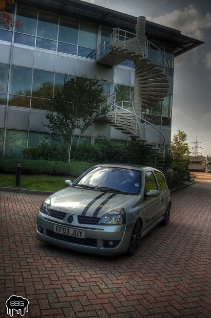

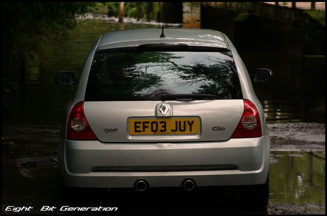

ive done a 182 rep too, it doesnt have to be stupidly expensive if you dont mind doing the work yourself
the break down for mine was
front bumper, grill and fog surrounds £80 posted
rear 182 bumper £60 posted
side skirts £65 posted
front grill £48
exhaust materials £50
meggy splitter £25
paint / body work materials this included paint for colourcoding bumpstrips, doorhandles and wheel refurb £100
totaling £428 (not bad for everything needed, all parts painted and fitted. most bodyshops were looking for around £850 -£1200 just to paint and fit the parts)
then ive done a few other things like
lowering (including springs) £100
wheels £150
to save some money i modified the 182 front bumper to fit the standard wings and fitted replica sideskirts. this ment less parts, cheaper sideskirts and less painting. a bodyshop i spoke to said you would have to paint the bonnet if you did the wings to blend it in.
the exhaust was a bit of a pain in the arse but i just took my time to make sure i did it properly, and i have to say im pleased with the results. its only cost me £40 rather than £400 which one place quoted me and they wanted to drill through my spare wheel well
you can see the progress thread here mate
