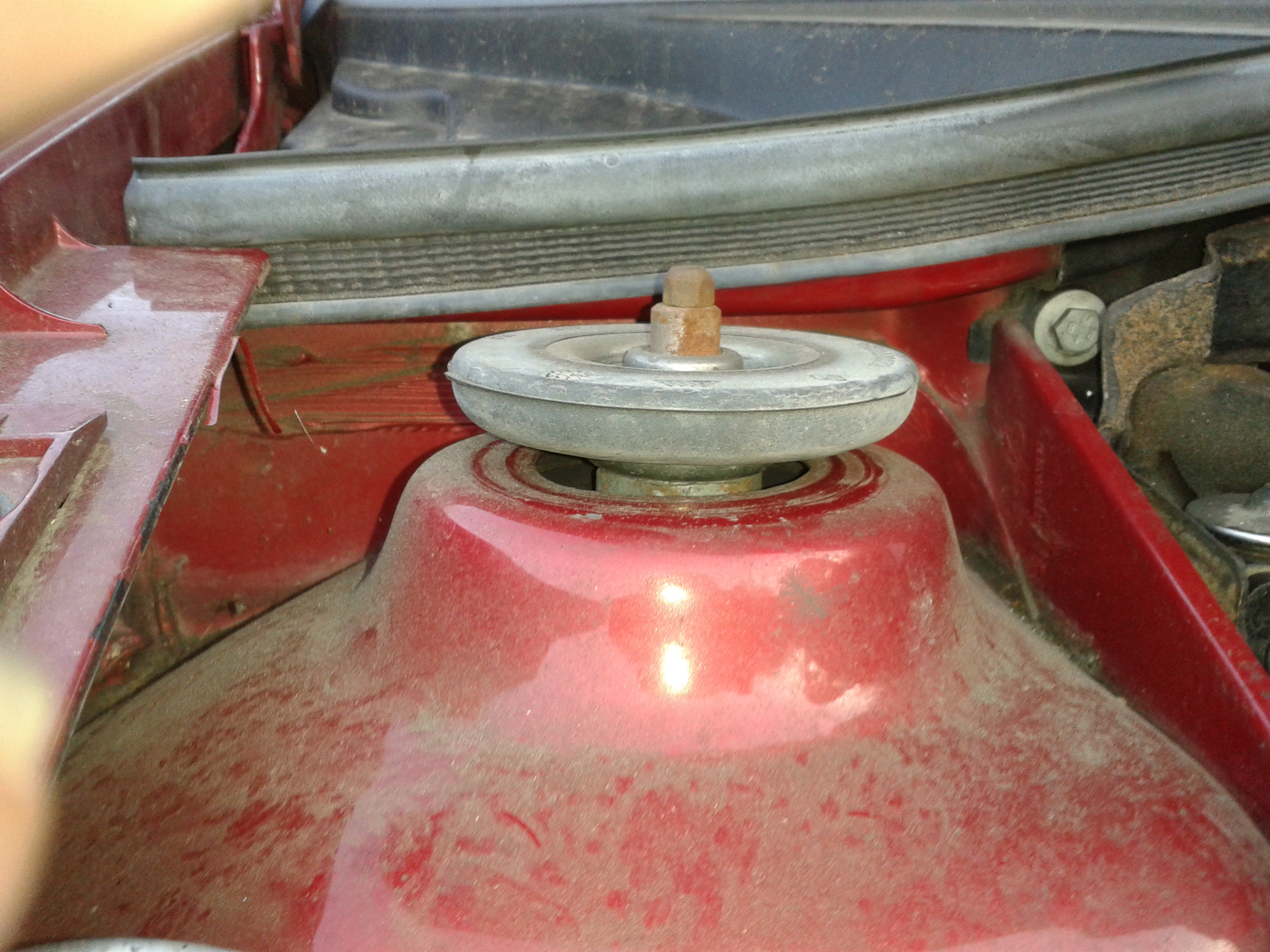

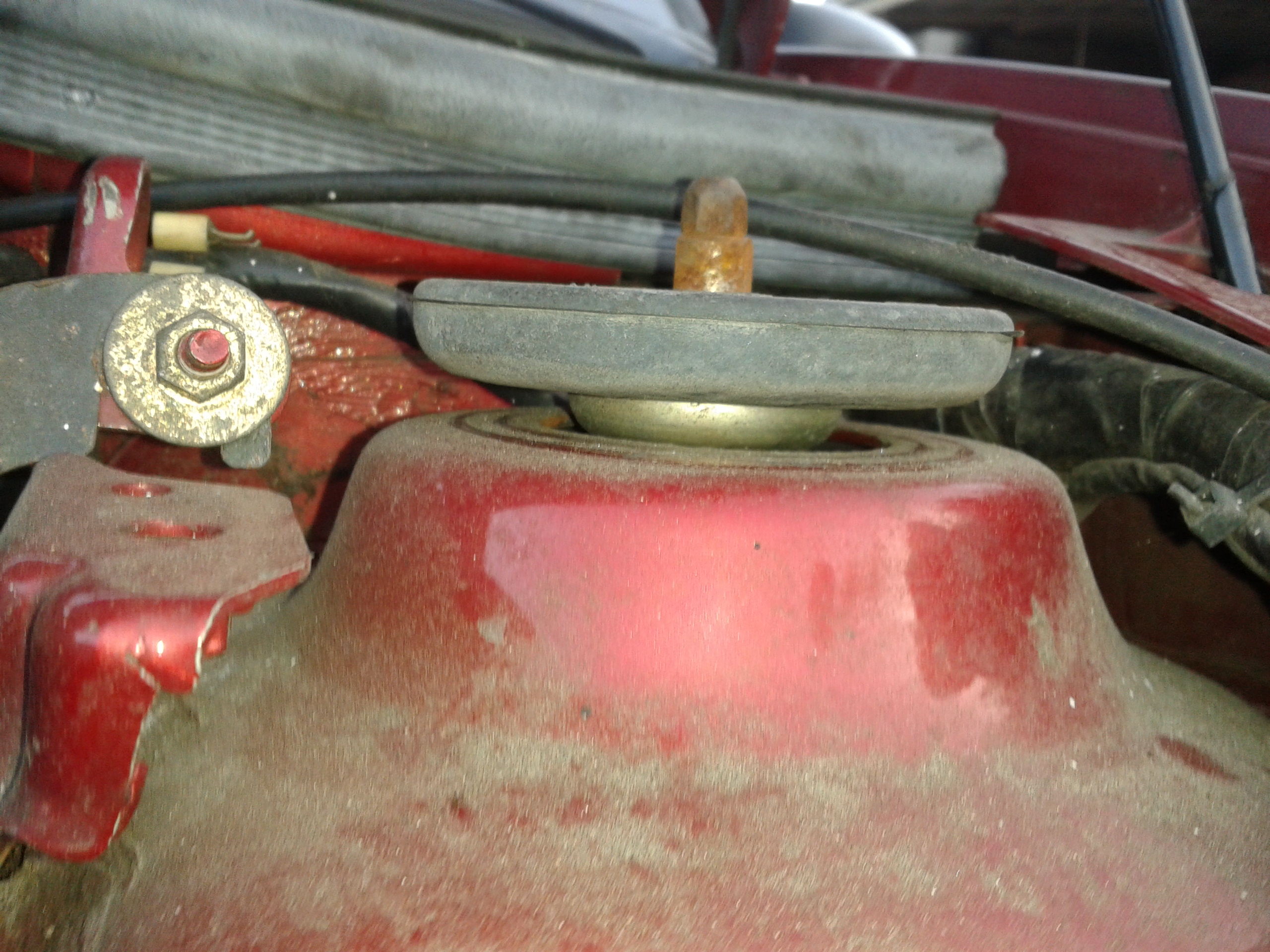

Hi Guys,
New to 182/Clio ownership and all was well until the weekend!
Jacked car up to jetwash underneath to get a good idea on what would be needed for up and coming MOT. All looked ok bar a few parts (new posts to follow), lowered car back down and drove home, car began to knock while pulling away and braking from front right - could feel through the steering also. Figured it must be an engine mount until I looked at the top of the struts (see image below), I can only assume that this is NOT normal, what has failed to let this happen?
Any advice would be great - about to purchase a pair of new Renault top mounts, is there anything else I should get? Also considering new dampers (think mine has the cup pack) and a spring kit.
Cheers and hello!
Rob,
Drivers side:
Passenger side (looks much better but still not totally what I would expect):
  PH2 172

Looks normal.
Drive forward 10 yards with the steering straight and they sit square.
There should be a gap between the turret and top cap.
If you do replace them, get the Febi ones, not the modified Renault items, to avoid this palava.
https://www.cliosport.net/threads/172-new-top-mount-modified-spacer-issues.641094/

PS - what is actually stopping the top of the strut from moving about if the top mount/cup (pictured) is aloud to move about so freely?
The bearing is located in the rubber seat under the turret.
https://www.ebay.co.uk/p/Febi-Bilst...5&clk_rvr_id=1553779620232&afsrc=1&rmvSB=true
Clunk when braking or pulling away could be wishbone bushes, ARB bushes, bottom ball joints, a loose caliper, worn engine mounts.
Get an MOT station to take a look.

There are 3 items in the kit, 2 are obviously not the bearing, the round object is.
Make sure to fit it the right way up!
