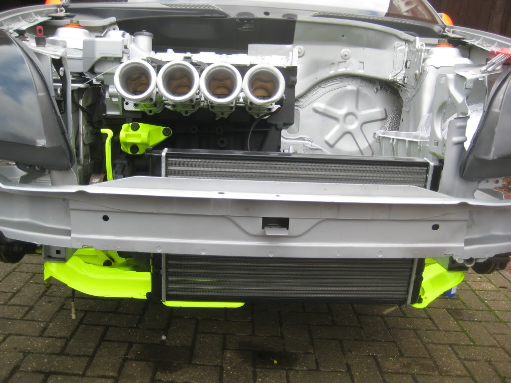

ac condensor is gone so is slam panel. so rad is moved forward and im making new brackets to hold it. i have a kenlowe fan off a land rover some where but cant find it!
dont need ac car is only for track and track season is winter only.

bodies now fitted and finished. going for mapping on saturday.
also fitted new engine, gear box and dog bone mount. got a slimline fan from motor factors couldnt find my kenlowe anywhere! the fan is the same diameter but a lot thiner so should be ok. not really worried about the temps as not going to be sitting in any traffic as im gonna get a trailer for it anyway.
next weeks jobs are fit spacers, top mounts and rear camber shims and get it on the scales and set up.
