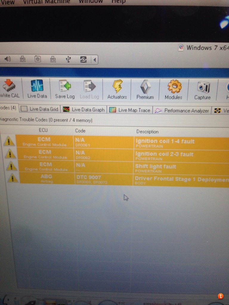

Plugged the car into the rs tuner, still havnt found the cause of the problem but these 2 fault codes must have something to do with it, DF0061 DF0062 ignition coil 1-4 fault and ignition coil 2-3 fault,
Anyone got any ideas ?
