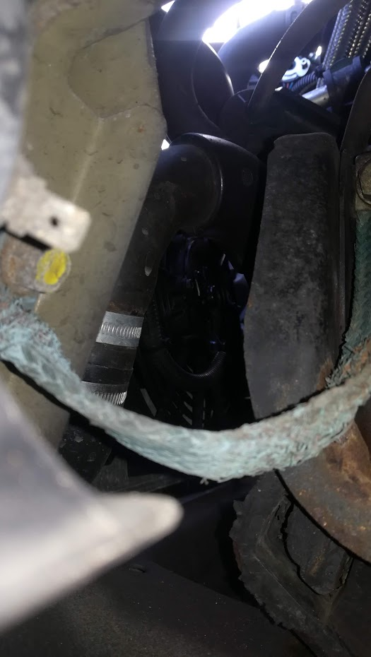

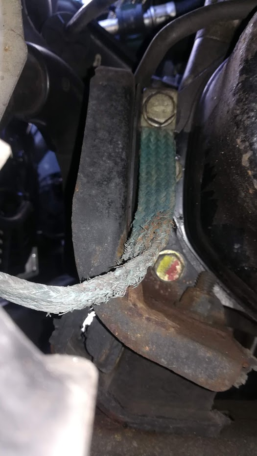

Earth lead condition as below, looks ok to me?

Wasn't there a post a while back where the earth strap looked fine but the car was a no-go. The owner replaced it with a new one and it was instantly ok.

There's lots of threads about this issue and none of the solutions I've tried from them are working. I would have thought that bodging an earth from the -ve terminal to the box would do the same.

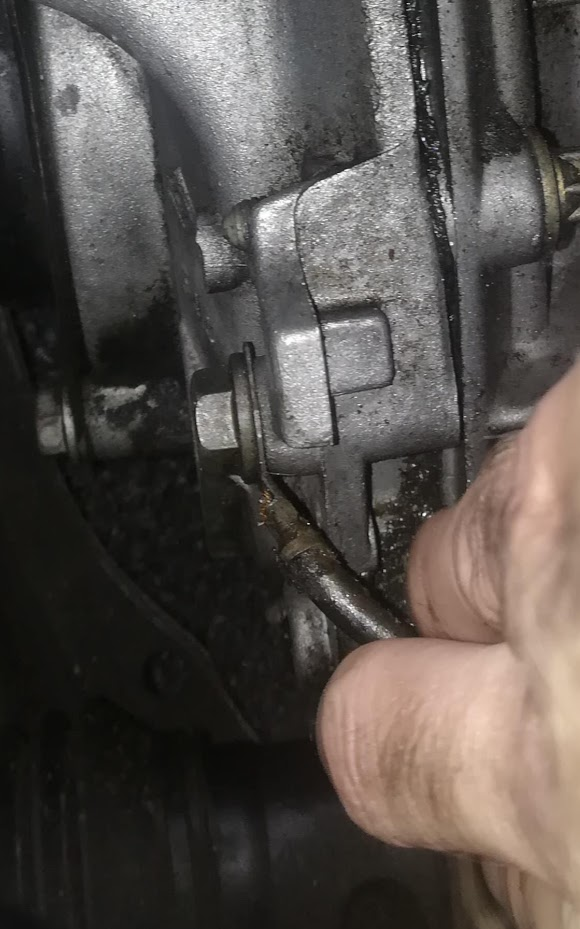

Have you checked the earth wire from the loom that attaches to the back of the gearbox?
Is that a second one, different to the one pictured above?

Yes that's the one, slide the covering back and check it.
What do you think? A bit greast and corroded but looks ok? All in one piece which is a start.

I had the same issue exactly as you. Earth strap looked fine but that was the issue. They’re not much from Halfords or to make your own.
