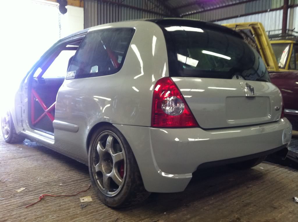

197 diffuser 85% complete lol
attachment.php
Carbonraider
  Raider, 172, the van
Ah so youve done away with the wheel well for it?
Is the 197 defuser the same as the 200? As in size?
No way it could be fitted while the wheel well is still insitu?
Yes wheel well gone 182 boot floor in place will be tack welded when cage goes in.
Yup same size just different looks.
As for fitting with well in the way it could possible be done but would look like blue car..

Are you going to make a tray to go the full length under the car to meet up with the diffuser?
Are you doing this as part of an aero kit or is it just for looks?
I wonder if this was done properly (for the sole purpose of aerodynamics) how much difference it would make...

It looks ok I suppose, but you're not going to get much by way of aero benefits as the underfloor area doesn't go far enough under imo.

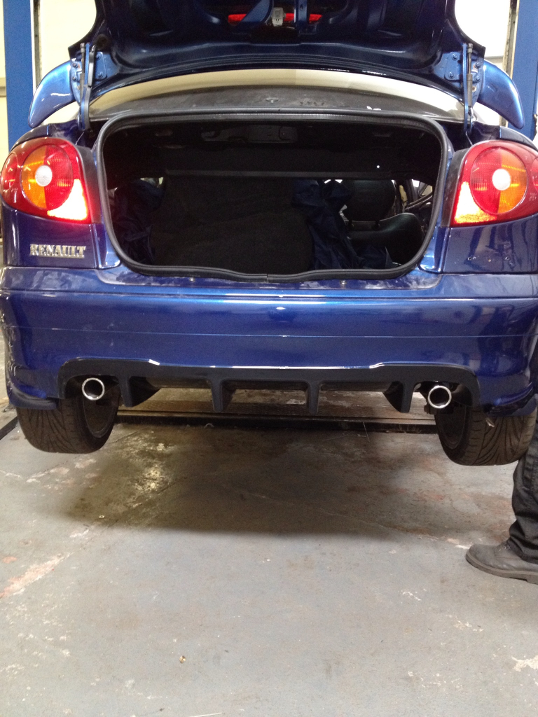

Here's my effort...
painted mine bmw carbon black, suits Monaco blue perfectly
Jaff.
Thanks :) had a ball ache fitting it to the bumper, I'm very interested to see how the OP is going to tackle it.
he has it easier though as there's a line across the back of the Clio bumper for the insert to follow and it seems the perfect height to mount it too.

I will be doing a guide as to how I fitted it but will do that when complete only really get the odd weekend due to work. As for fitting it to the car I won't be attaching it to the bumper other than a few clips that you use to hold the front bumper to the wing, the rest will be on Zeus clips and bonnet pins.

That's what I was going for.. As it will be a purpose built track car so looks don't really bother me.. Obv I want it to look neat but having it smoothed into bumper was a no no as I'd hit the kitty litter and it would just crack..
I had to remove boot floor too lucky the 182 has a stitched on panel so I ground the welds and split it so looks o.e.m
Although so far it's down as a 172 with a 182 boot floor with a 197 diffuser and will be running 200 brembos :/
Cut and shut comes to mind lol

Lol mines like that.
megene 1.6 with a 2.0 engine, vw gearbox, fiat 4 pots, 197 diffuser, evo seats.
should call it Frankenstein lol.
i ended up just making a few panels out of 1.6mm steel and welding that into place, your lucky to have had the choice of a 182 floor :)

Once ive finished il put a build thread together just so you guys can get a feel if anyone else wants to do it.. So many ways of fitting just trying to get the rite 1 without the costs and skill needed.. Will update in a couple of weeks.

This may be a retarded question and someone might have already asked, but why have you cut out the spare wheel well?

Cheers dude.. The well had to be removed so that I could get the diffuser to the height I wanted plus make room for the 200 exhaust system :D
