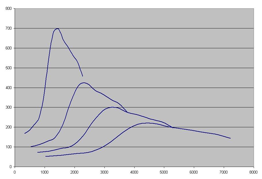

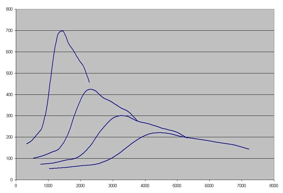

Im still waiting for you to show me mathematically how power is solely responsible for acln....
how about a graph? This is engine torque corrected for gear ratio to give torque at the wheels compared to speed (I forget which engine and gearbox this was, it's just something I dug out of my PC, feel free to replicate the exercise with the 197 engine and gearbox). Ignore the units, they're not corrected for anything, however, I'm sure that we can agree that at any speed (horizontal axis) the gear that provides the most torque to the wheels (vertical axis) will generate the most acceleration (I'm going to ignore inertia).
Taking a velocity of about 3200, in 3rd gear the engine is making it's peak torque, according to Stan peak torque makes the car accelerate faster. In reality the car is accelerating faster in 2nd gear, and the greatest acceleration occurs when you never use the peak torque part of the engine power curve.
(I hope you can see the graph, I had to open a photobucket account for this)
For a start the X axis is engine speed, not velocity.
Secondly "In reality the car is accelerating faster in 2nd gear"...yes because as the graph shows, torque at the wheels is increased for lower gears!
Thirdly, I never said a car acclerates at point of peak torque, I said Torque is what provides acln. In terms of engine delivery characteristics, this will be a nice "fat" torque curve spread over as long an rpm range as possible.

Secondly, "In reality the car is accelerating faster in 2nd gear"...yes because as the graph shows, torque at the wheels is increased for lower gears!
Thirdly, I never said a car acclerates at point of peak torque, I said Torque is what provides acln. In terms of engine delivery characteristics, this will be a nice "fat" torque curve spread over as long an rpm range as possible."
and as I also said: Getting boring now.
For maximum acceleration, you want to be operating in the range of rpm/s which offer maximum engine torque, and therefore maximum tractive effort, over/for the longest period. Maximum tractive effort=maximum acceleration. Increased power (with rpm) allows this tractive effort to be excercised, but as engine torque drops off with increased engine speed, ultimately there becomes a point of diminishing return for tractive effort, and also acceleration.
So to summarise, you will gain the main bulk of acceleration through the engine speeds which offer most torque. The "length" of period of the this acceleration will be determined by the trend of power delivery around this time/area. However past the point where torque drops off, acceleration rates are lower.
:coffee:
