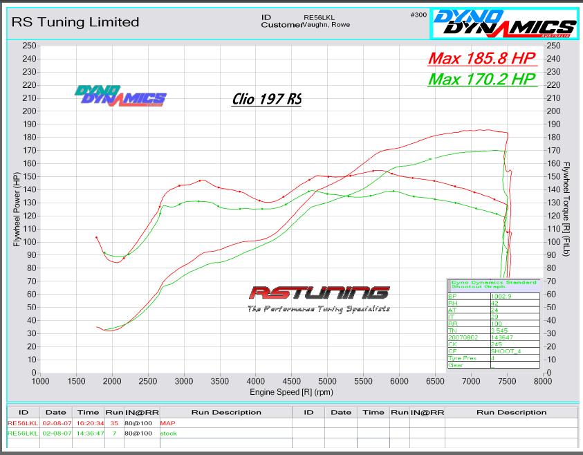

197s gain a load of torque mid-range but not heard a claim that big for bhp
EDIT: I lie, i have a graph of 15bhp increse top end and gains of about 20ftlb torque accross the range
not been told i cant...
Graph was provided by K-tec and is as you can see, an RS Tuning map.

I'm sure the result will speak for themselves but I would be shocked if a remap can give that big a gain. 15bhp at the wheels is just too good to be true (isn't that about 215 bhp?!) If not I think I'll be trying to get a 197 engine put in the cup and not bother with throttle bodies lol

they're not 197bhp, The figures on that graph are fly wheel figures.
on a completely standard 172, a properly mapped omex can get you 10bhp
lol so a remapped 197 might get 185bhp at the fly?
Chris
So it does...thats more like a 172 with mods than a 197 lol
Yes thats at the fly. Apparently they are down on power as standard, inlet mani apparently could be part of this still
197's make their power generally, not seen one below 190 bhp on any session yet. Much better than the MK2's....
Just going on what I have been told by respected tuning companies. They advised me the inlet mani was not much of an improvement, they also said that 197s do seem to be down on power. What they didnt say was how old the cars they have been working on have been. These could be low mileage (read not run in) exmaples
yeap but both Paul and the guys from k-tec says you can get up to 7-9 bhp depending on other mods...
15bhp is a bit more isn't it?
Well that graph was sent to me by K-Tec, who use an RS Tuning map (or at least it would appear so as it says RS Tuning on the graph) and that shows 15bhp gain.
Cant really argue with that?

That's a marketing strategy. Would you ask them whether this are back to back tests just after a remap or remap + decat + free flow exhaust and etc?
By the way I have not seen any RS giving the book value on the rollers. They are always a bit lower. Pug's are alsp suffering from this. 206 RC on the rollers 165 HP top. Dynoed 4 of them highest 165 HP at the wheel :)
That car isnt making book figures before remap...
Check the times on the graph and you will see its back to back
Its just a remap no other mods

only by people who dont like to admit a number given to a car isn't it's power output ;)
Even so, you're right the car on that graph is down on power as standard even for a conservative dyno. And the owner of the car we dyno'd at 180 completely stock thinks it's gutless.

Here is the question
Saying '' +15 HP gain on a down-powered 197, i.e. 170!!'' is totally different than '' +15 HP gain on a 197'', which is gonne be 212 HP.
Something very similar to that happened for 182 if I remember correctly. RSTuning still claims a big fat +13 HP gain !!!!.
well for starters, the 197 has only ever claimed to have 194bhp (197 is the PS measurement)
Secondly, the car wont be down on power due to the map, as its the same map on all 197s out the factory. The power loss is coming from somewhere else. So the fact the remap gained 15bhp on a car thats down on power originally is neither here nor there, it should give the same gains on all 197s when tested in the exact same circumstances (tempreture, humidity etc etc)

I have already covered your point about this car being down on power in stock form and the fact that it cannot be related to the original mapping and that, as was the case with the 1*2s it must be related to something such as, the poorly cast inlet manifolds as was the case on the 1*2s
