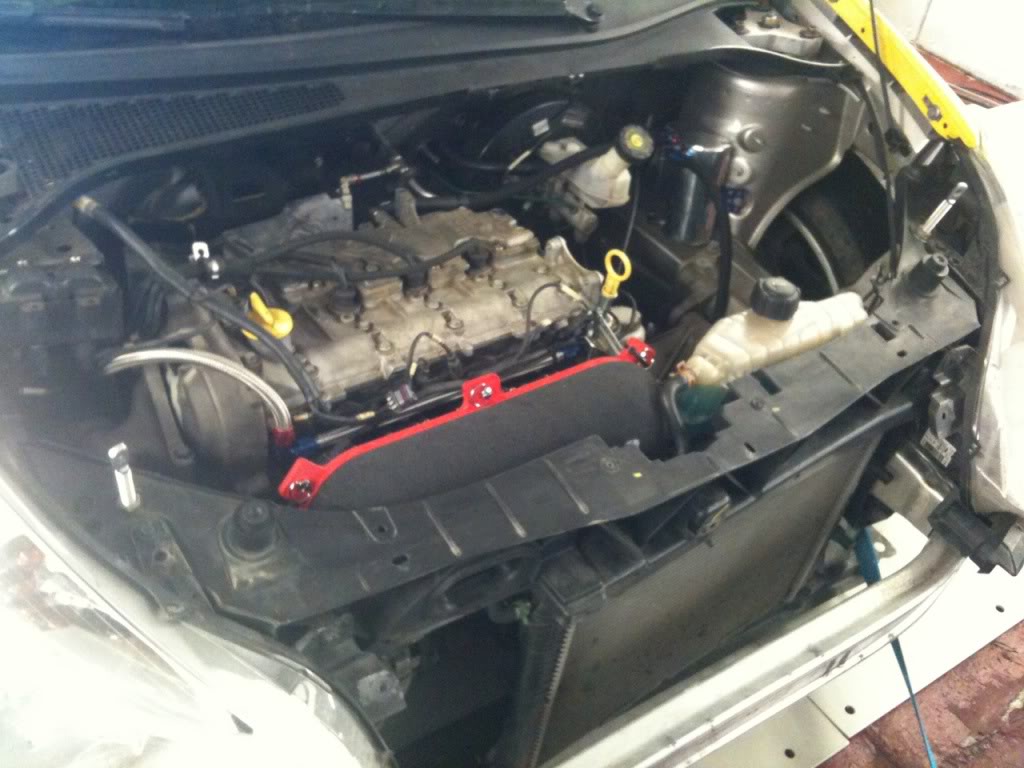

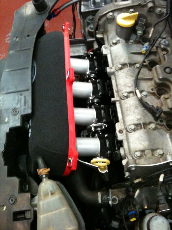

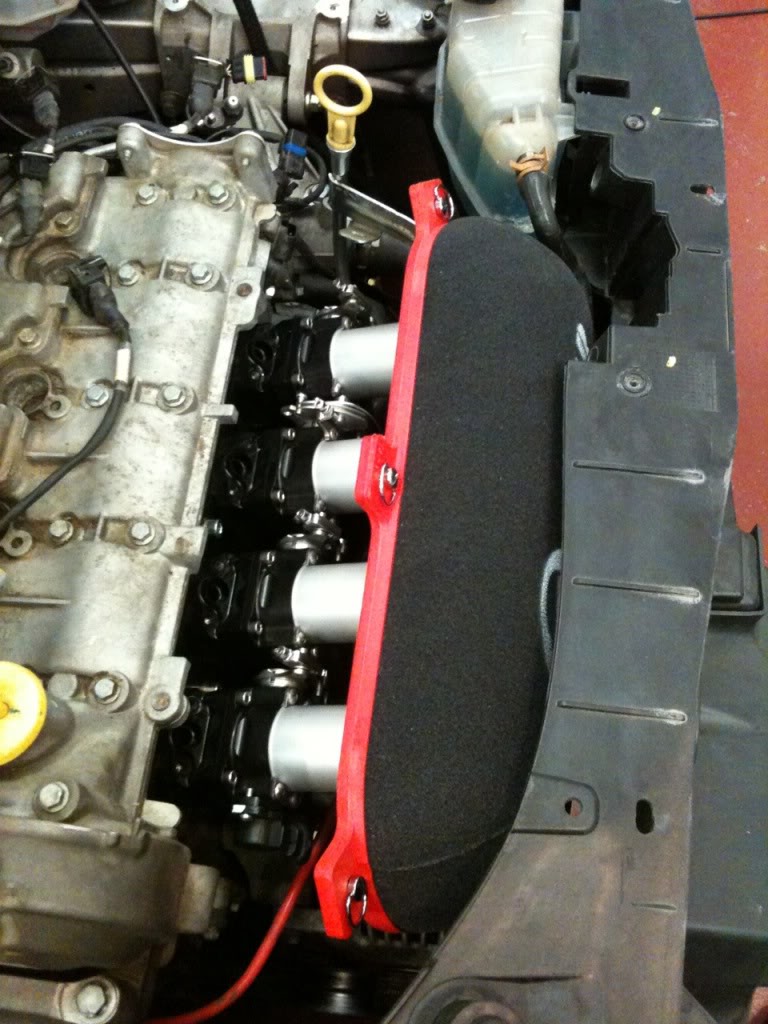

We have options available for the F4R 830 cars upto 270bhp Naturally Aspirated. We've done an awful lot of X85 and C85 Clio Cup/R3 Rally cars over the past couple of years with our 225PS engine package comprising of cams and port throttles kit with EC1 engine control, oddly this makes about 12PS more than Renaults 230PS kit ;)
The stock cylinder head porting can be improved upon but it's a lot of money for minimal gain unless you move the port position in the head to downdraft the port, which is what we do on our S2000 and high output engines.
Here's some pics of an X85 with our 225PS kit.
