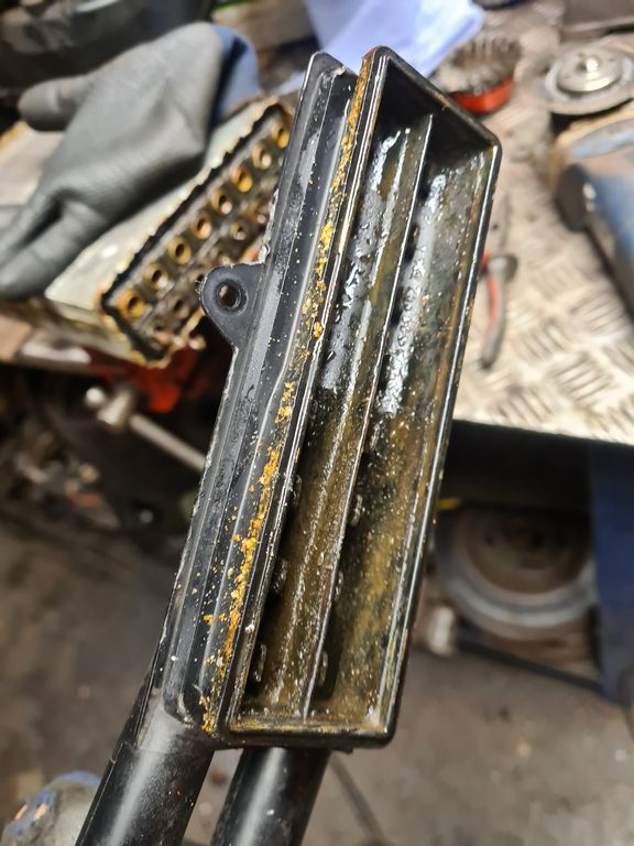

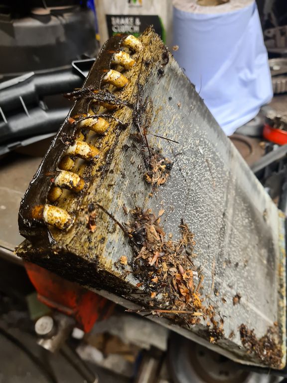

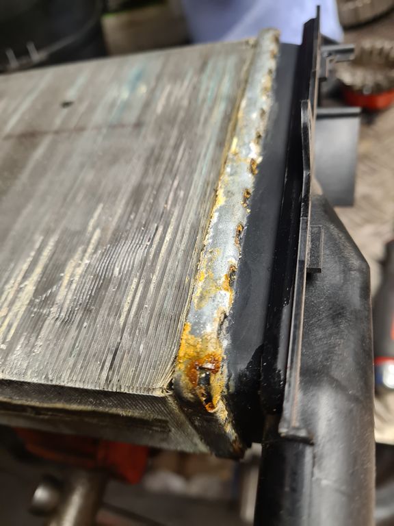

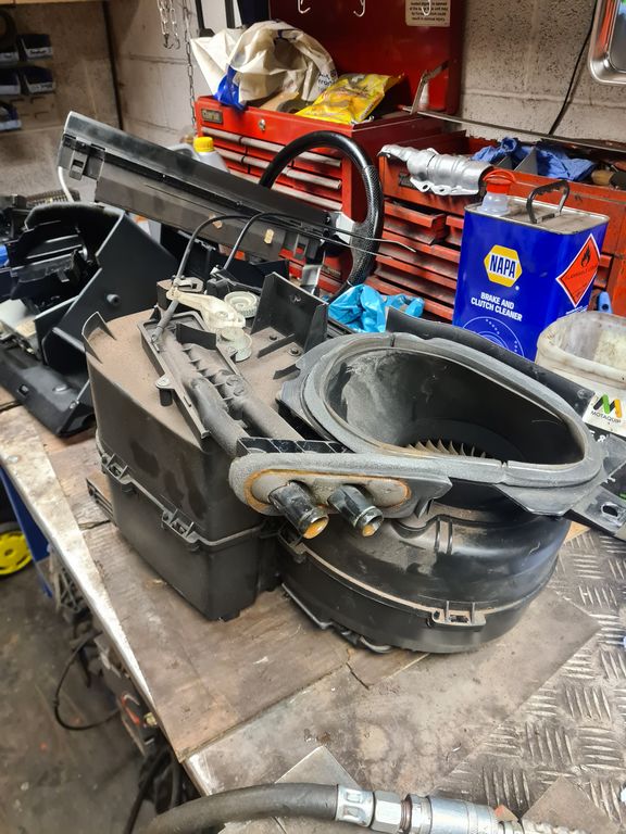

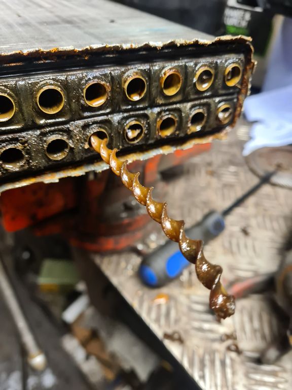

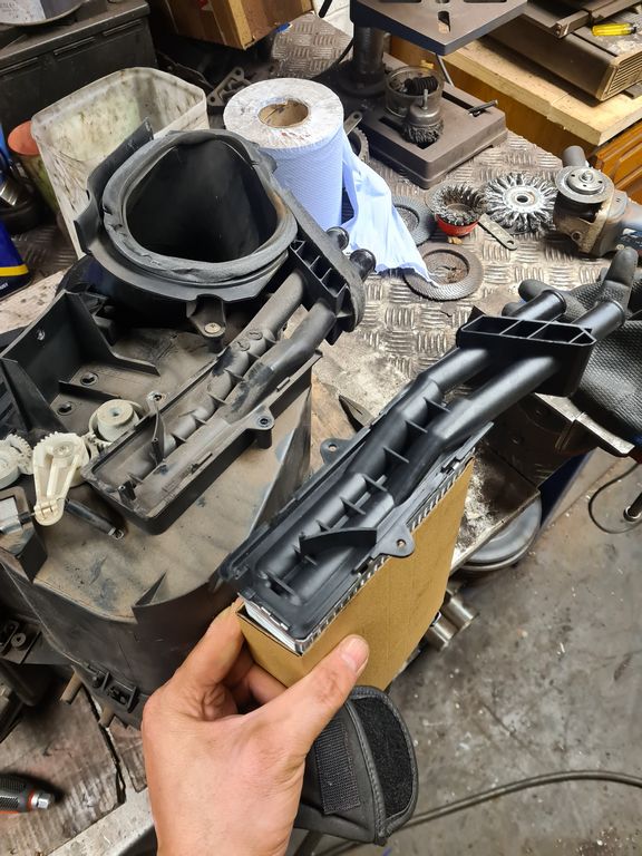

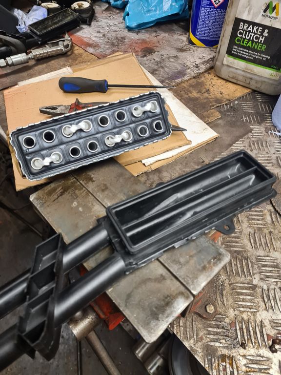

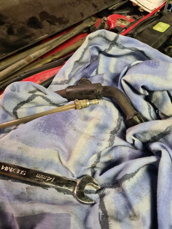

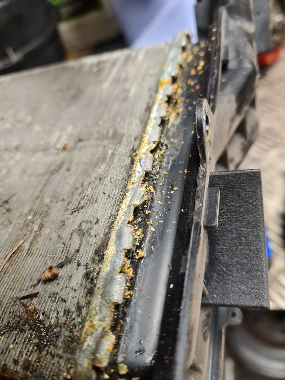

The times ive run it up to temp I noticed a bit of steam coming out the heater inlet, when I turned the blower motor on it blew steam out the heater vents. I was hoping it was just some residual damp in the matrix but seeing as its been dry stored for almost 8 years, I knew deep down what was coming.

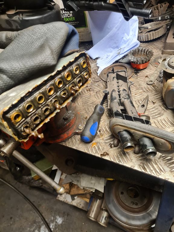

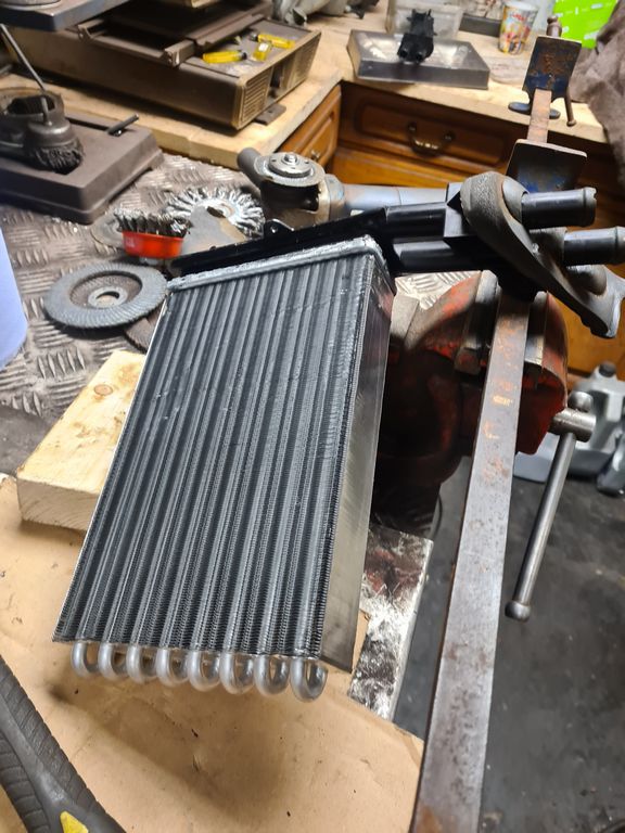

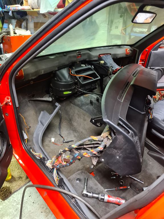

Heater box out, and yet another parts problem in that I can't get a new matrix for RHD any more! Supply seems to have dried up, so I had to improvise and bought a LHD one. The core is the same, so I set about swapping the top end tanks over. Might seem a faff but the new matrix was £30 and recoring the old one was >£100.
Yeah, definitely a leaky matrix. Yuk!

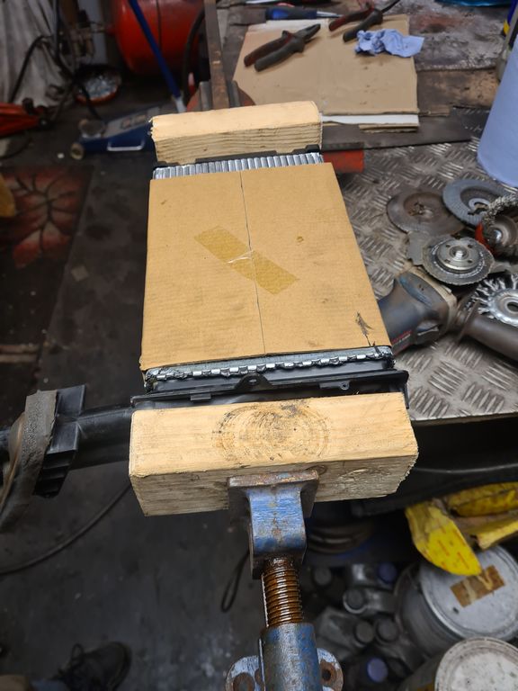

End tank swap.
I sank the end tank in on some sealant after a good clean, put it in a furniture clamp and tapped the tabs back in gently.
I sat that to dry off and went and did the thing in the next post, then once that was done came back to this and dropped it in the heater box

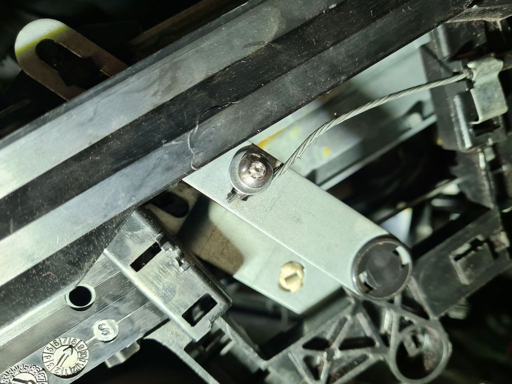

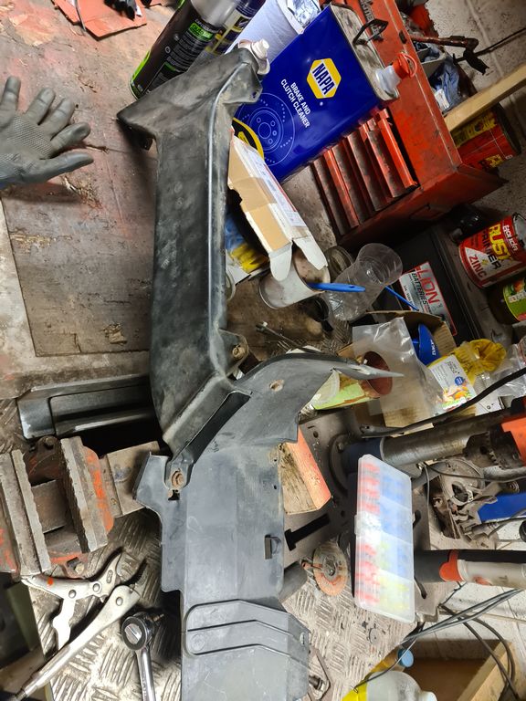

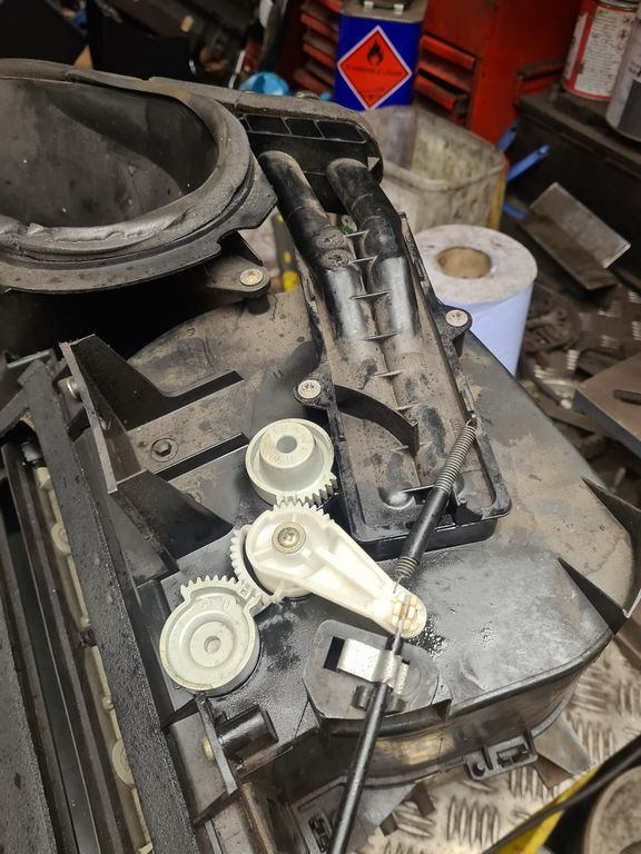

One of the plastic tabs that holds the control cables in to the control arms of the heater panel was broken, seriously, f**k these things they suck. Can't get em new any more it seems (surprise surprise). I employed an M5 bolt to secure the cable end in.

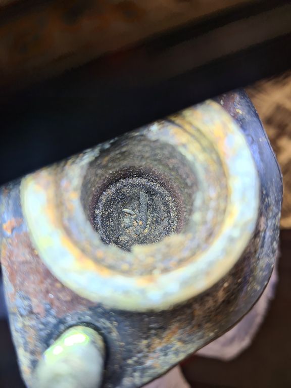

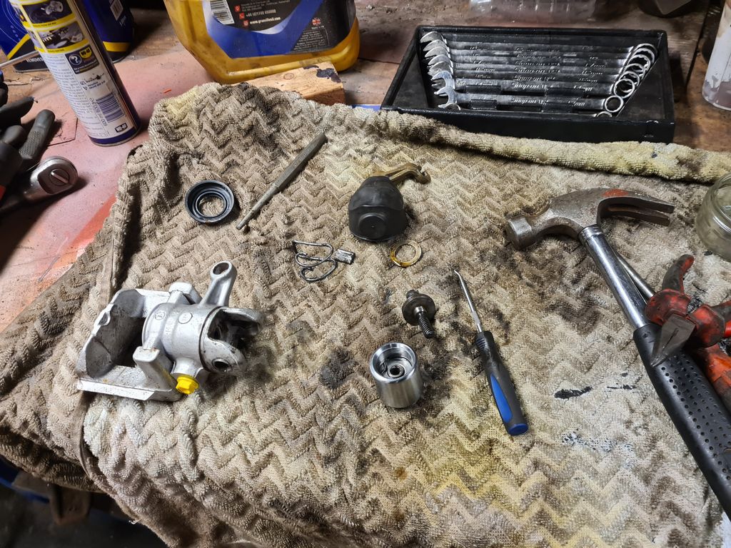

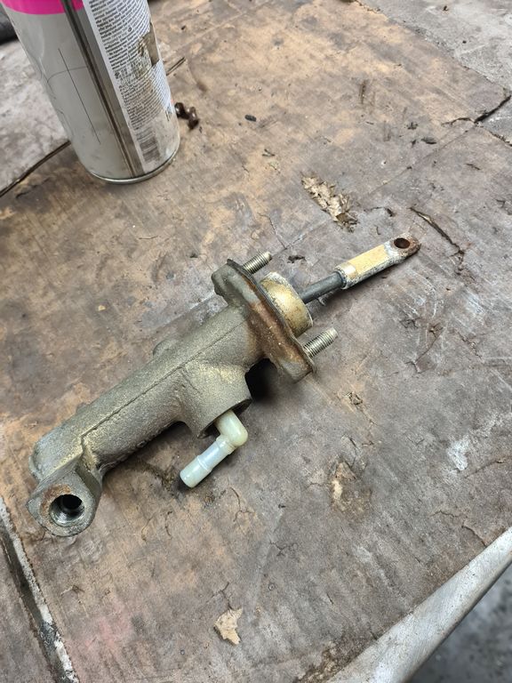

When I got the brakes back together I filled the res up with fluid and bled some through the system, then bled up the clutch. I go no pedal at all, great! Bled the port on the master, got some yukky fluid through, still no pedal. Bled from the slave again, STILL no pedal.

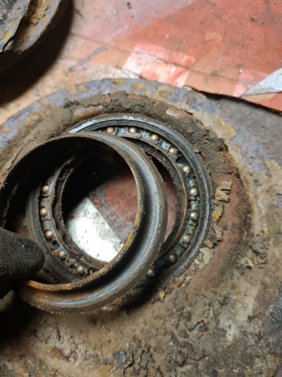

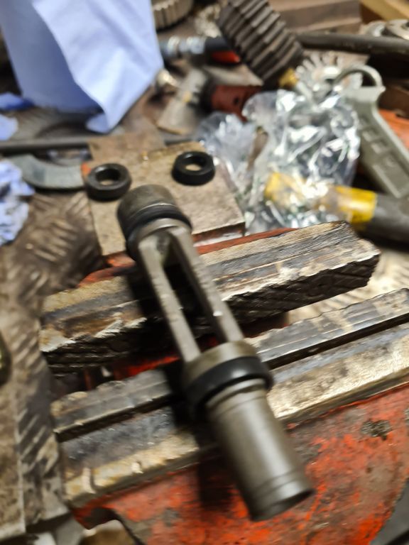

Another dreaded problem from cars that have sat I prodded the clutch pedal with disdain, trying to feel the piston in the master returning, which it wasnt. So the piston in the master was stuck at the bottom of its sweep. BRILLIANT. While the dash was out, it makes accessing the pedal box easier so I dropped the brake master down a bit, and removed the clutch master.
Popped the front end off and...urgh.
Long story short, big fight and lots of swears later the piston is out of the cylinder, the bore is cleaned up and a refurb seal kit is fitted to the piston. Cylinder reassembled, refitted, bled it up and now I have a fully working clutch pedal...HURRAH. It only took a new clutch kit, a new fork, and a rebuild on both the master and slave cylinders (rolling my eyes as I type). I didnt take any more pics of it for some reason,

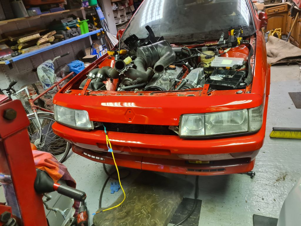

So, now, I am getting closer to having it on its wheels. The brakes work but are a bit spongy, so I need to get a proper bleed cycle done next to firm the pedal up. Got all the interior back together as well, and ran the car up to temperature again - nice warm heater and no leaks :)

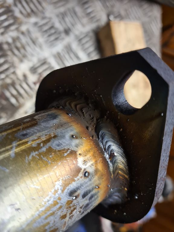

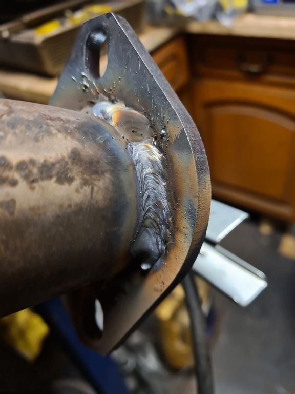

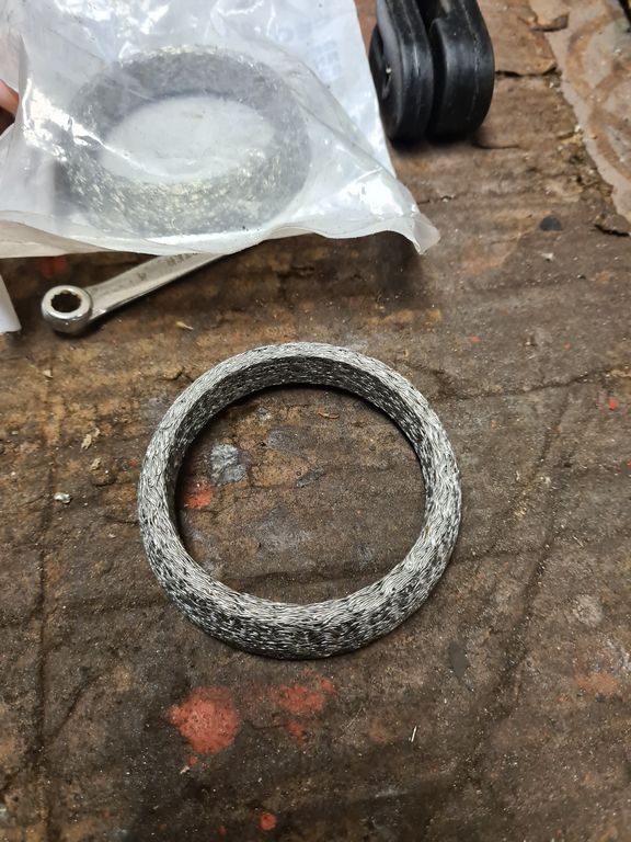

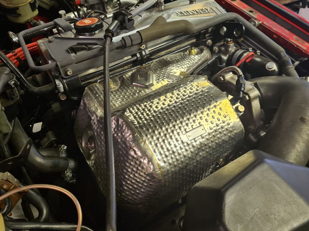

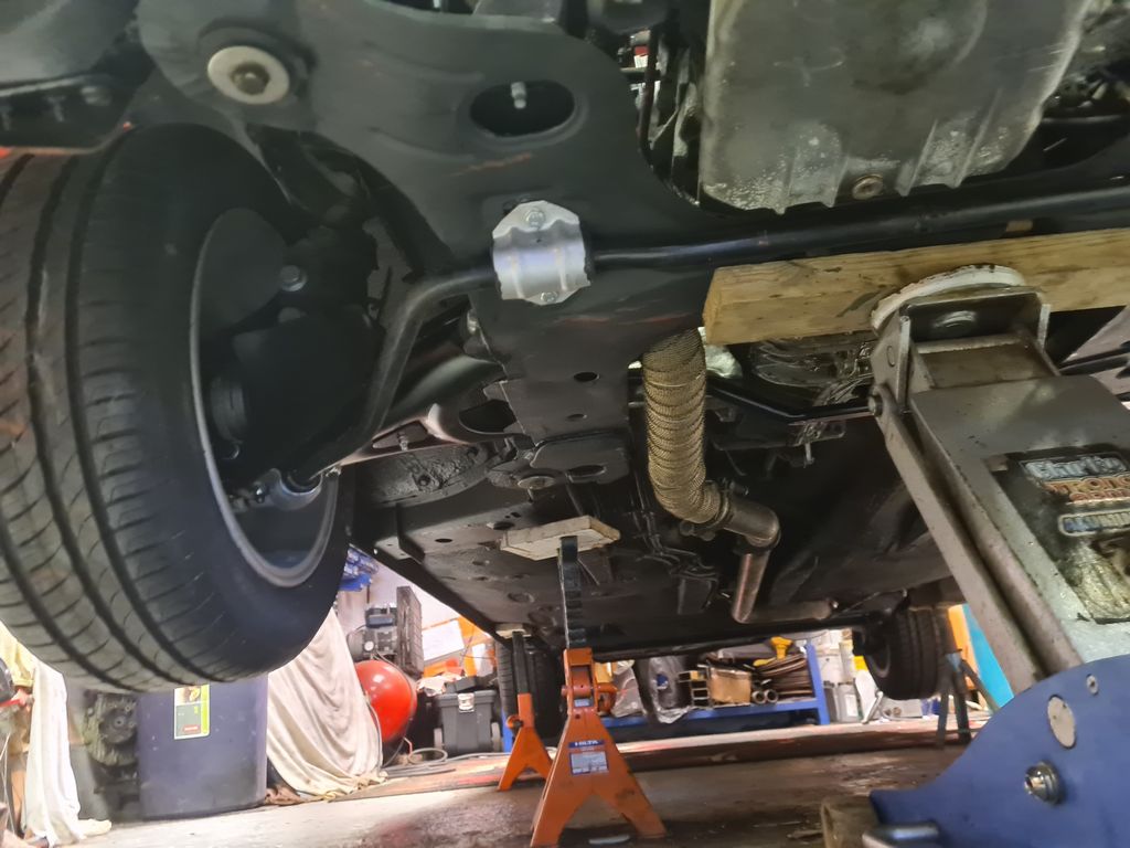

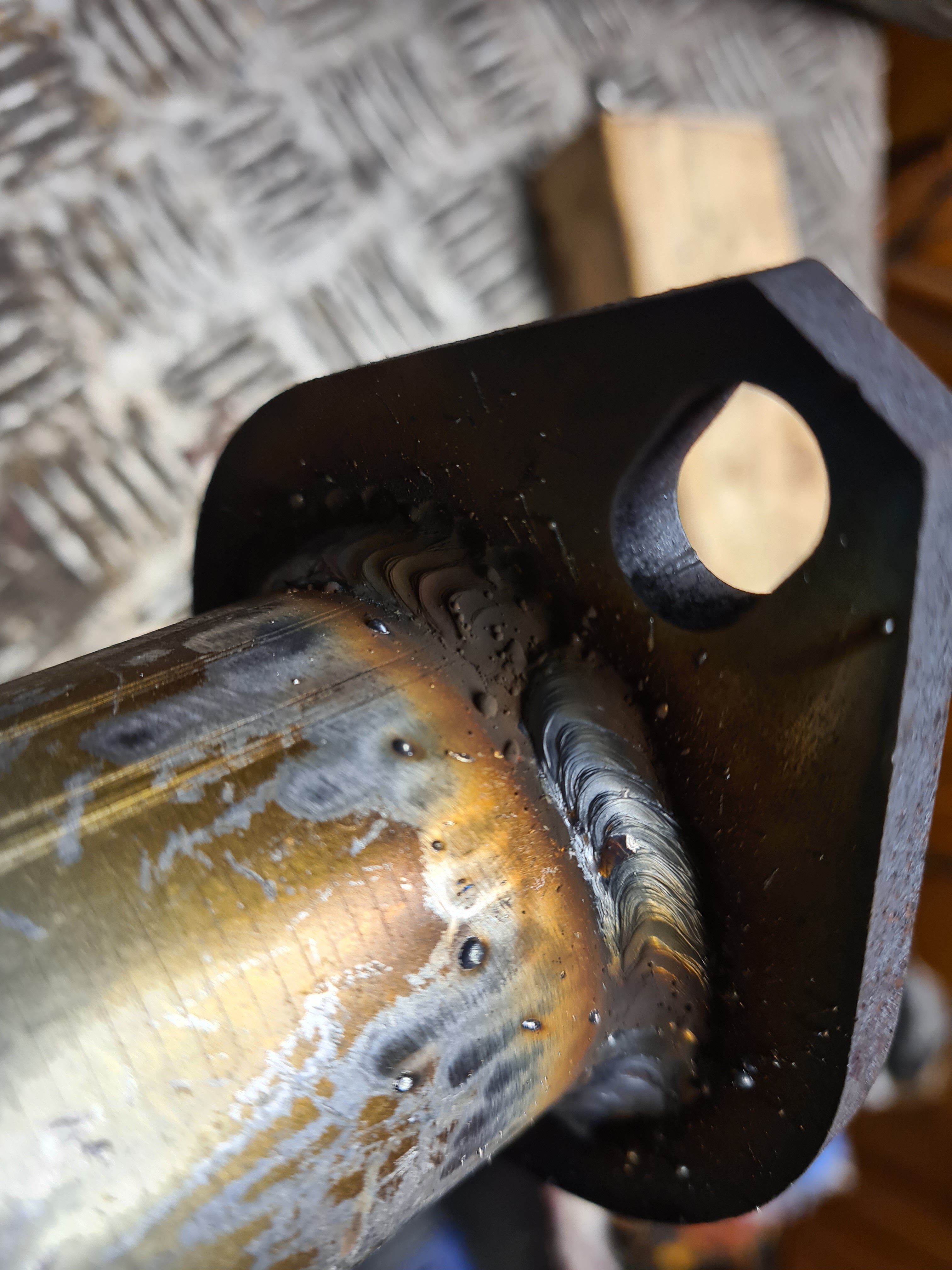

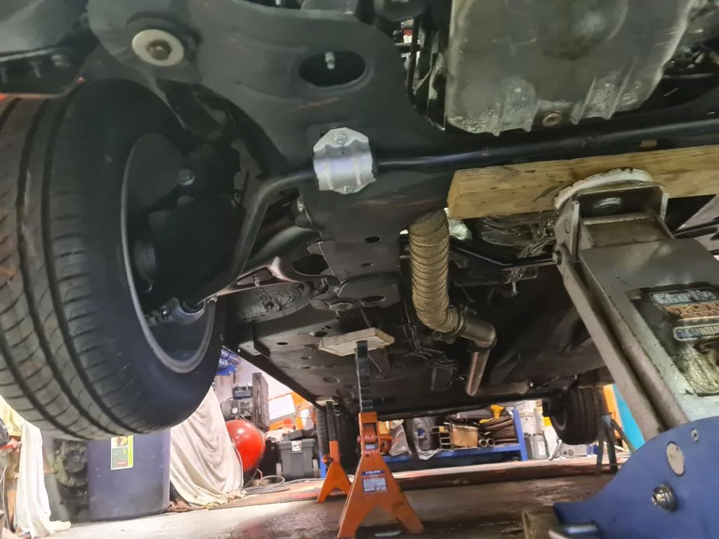

Still plugging away, was flaming cold this weekend and heater ran out of gas so I didnt stop for many pics. However, I did get the exhaust completed, welding in a gasketed flange join for the back cos a really hate sleeve joints.
new downpipe gasket / old downpipe gasket

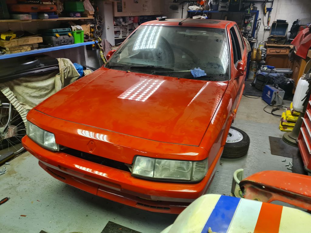

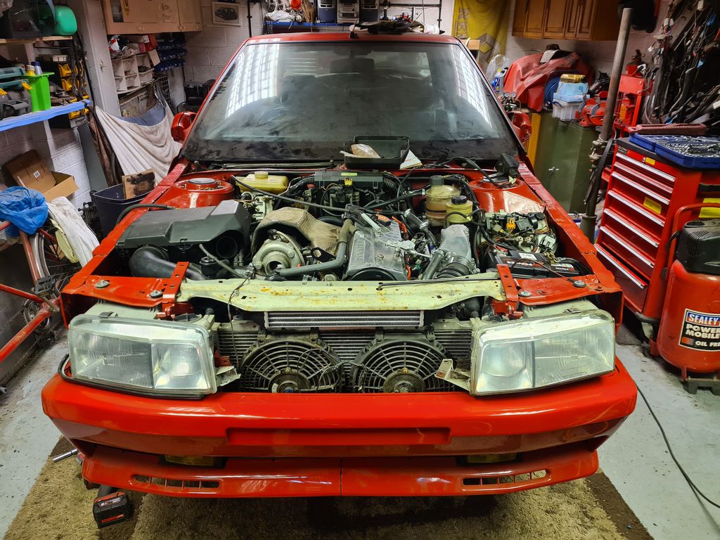

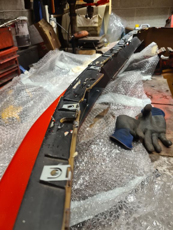

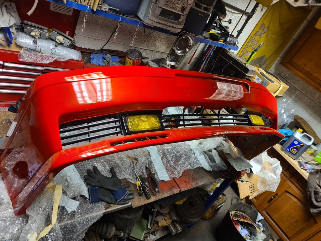

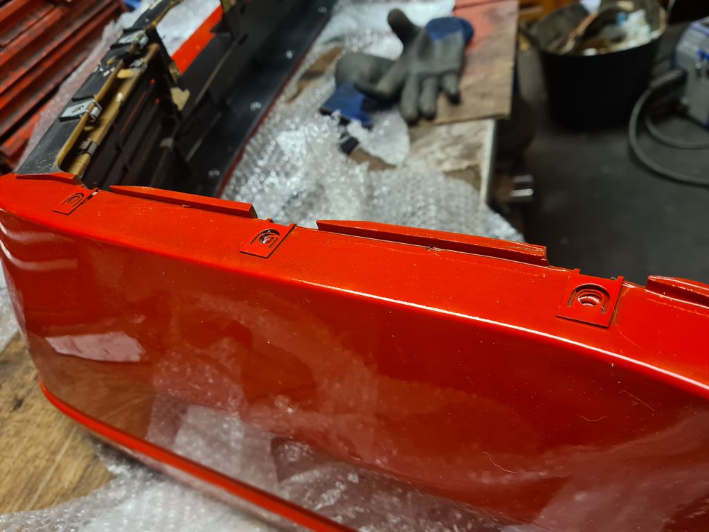

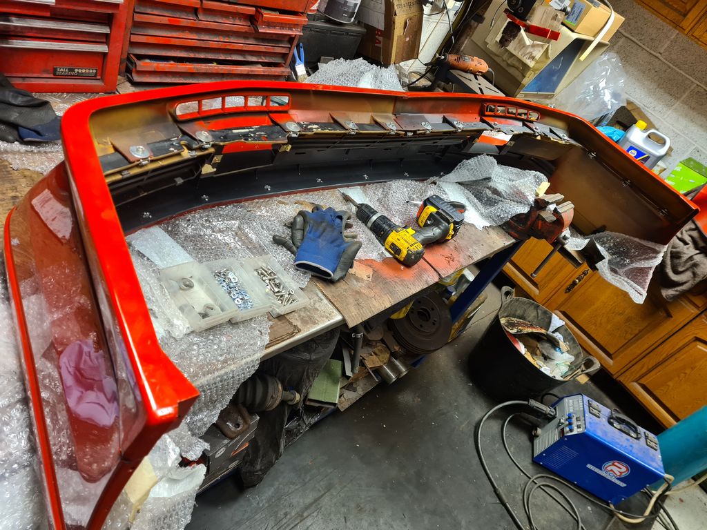

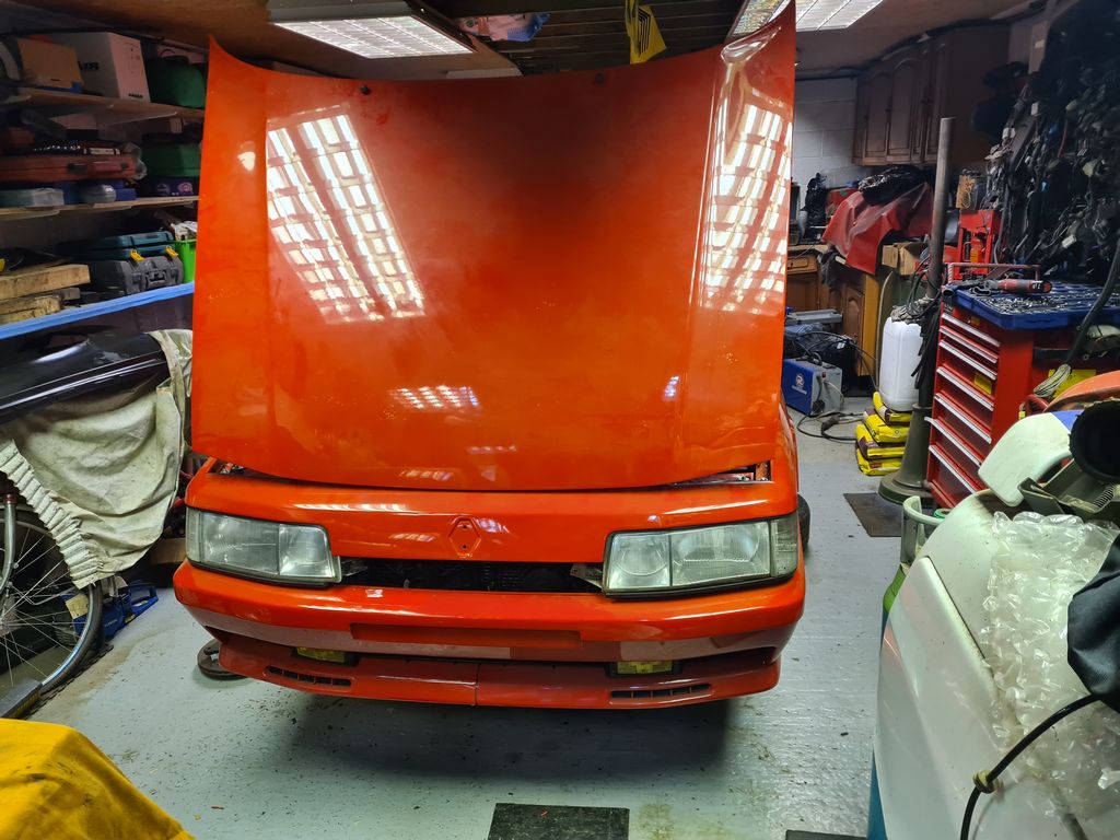

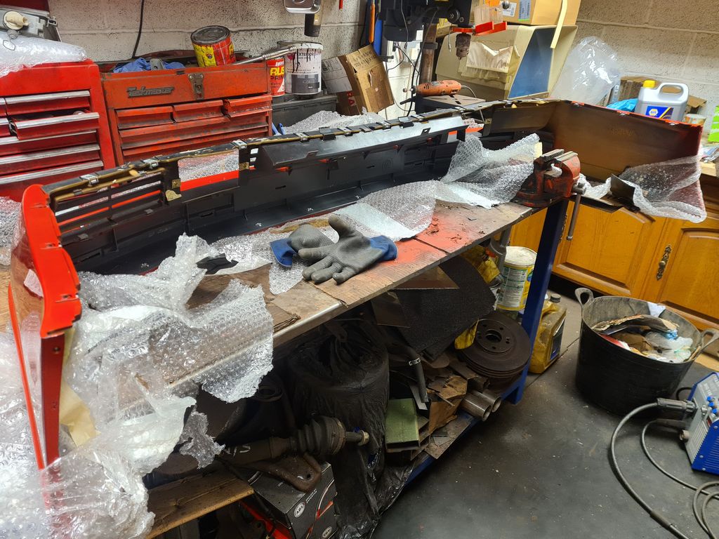

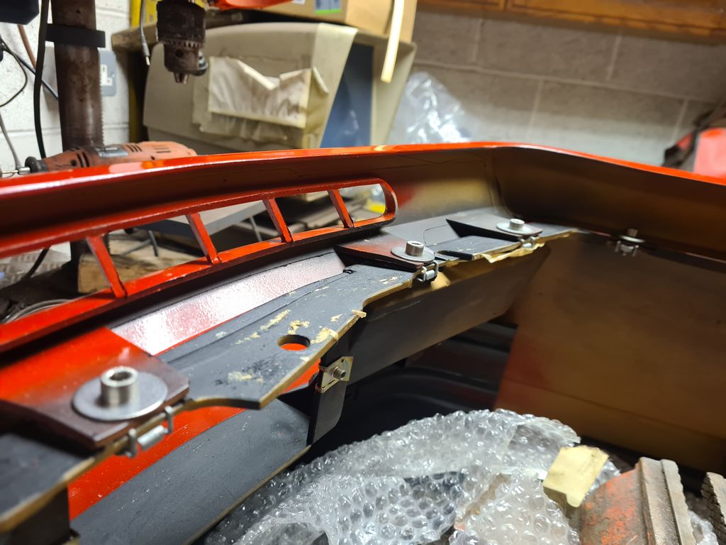

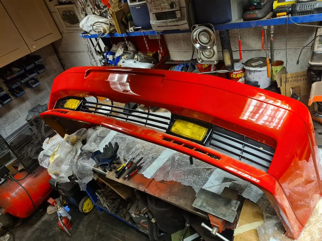

Got a bit frustrated with the front end of the car so decided to see how the (brand new!) bumper and splitters would fit up. Well, it would seem!

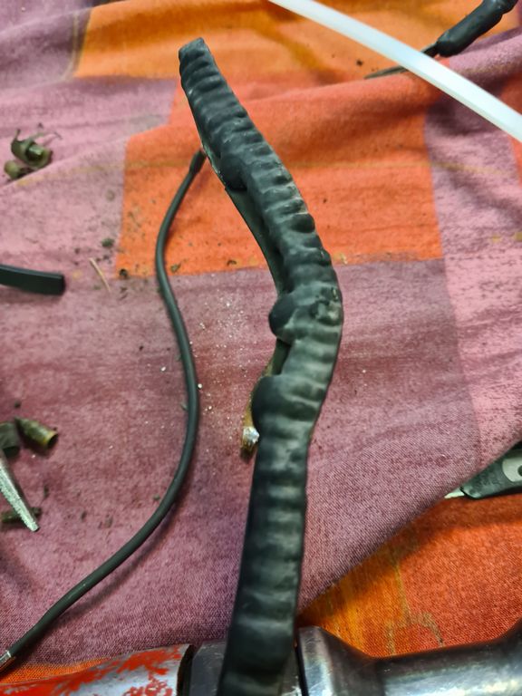

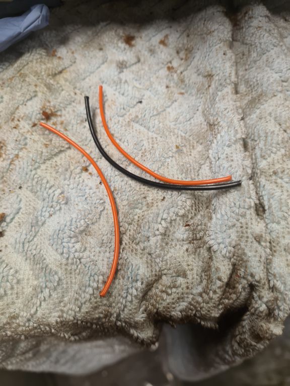

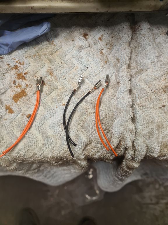

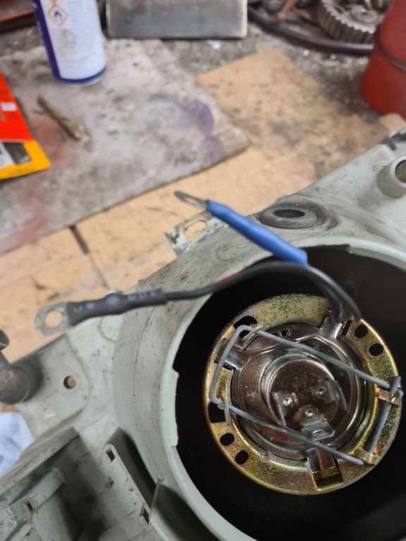

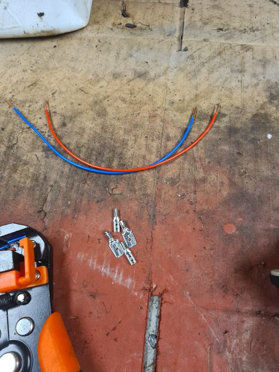

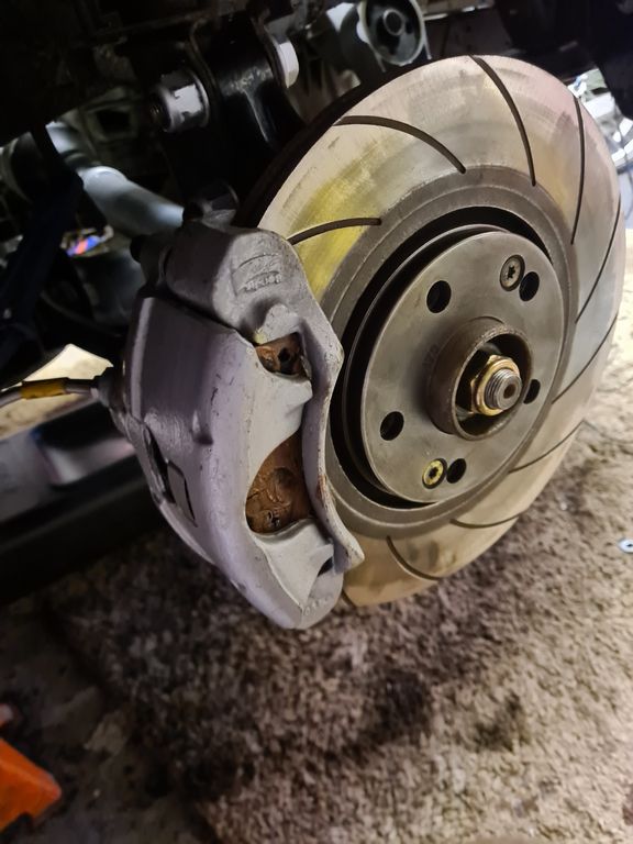

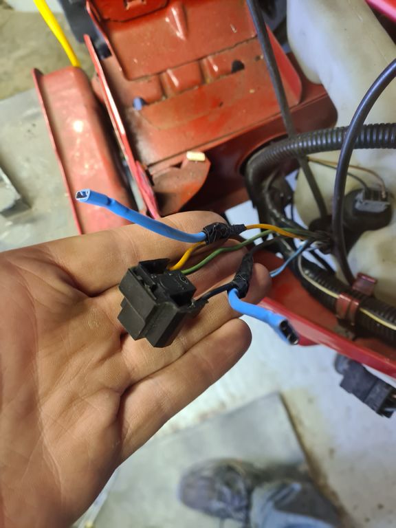

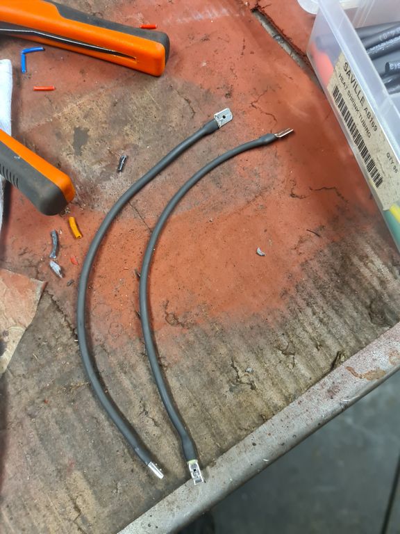

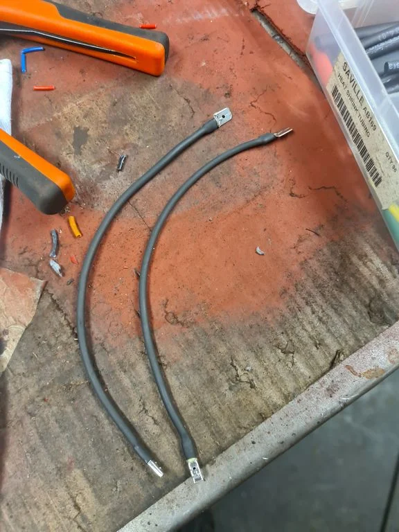

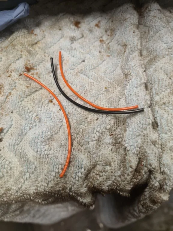

Sourced some new front discs & fitted them, wasnt happy with used ones. Then made & soldered in some little patch looms for the headlights, for some reason the blocks that adapt in to the headlight bulb connector to run the main cells were missing.
After that I made another little loom to replace the missing one from the front indicator main harness to the front indicator lens

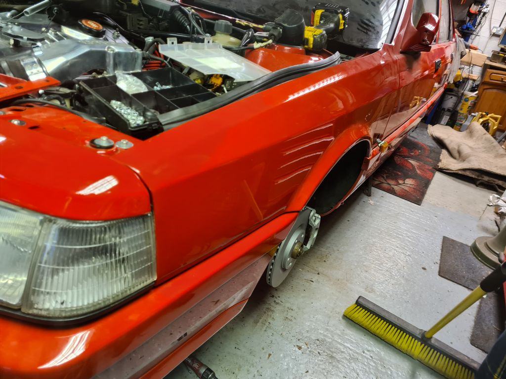

I got the front arch liners in place and fitted up the front wings. I had to take the whole damn front drivers door off to adjust the hangers to stop the door trim catching the wing as it opened! Pain in the arse but got there eventually. Then headlights, nosecone and bumper (for which I had to take the intercooler and airbox out grumble grumble), though the nose will come back off for fan & fog wiring and some new trim around the headlights if I can find the right profile. However, its looking much more like a car!

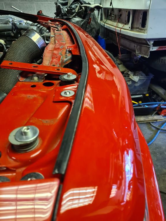

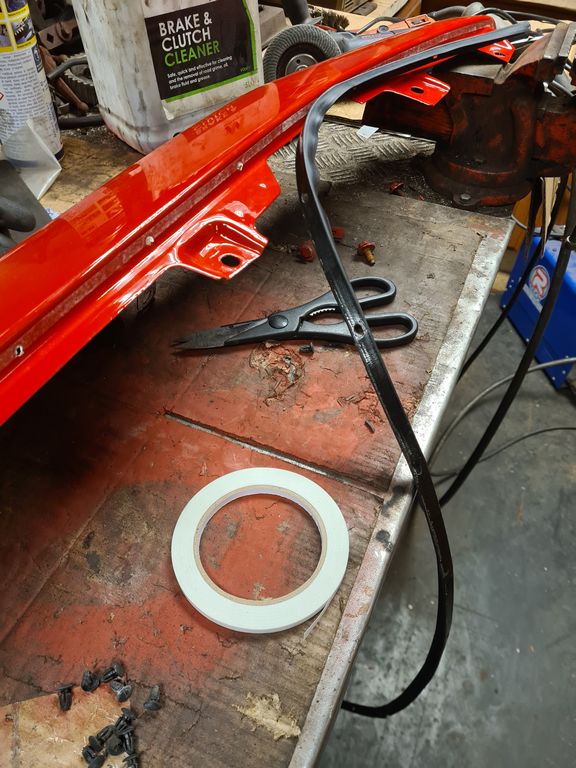

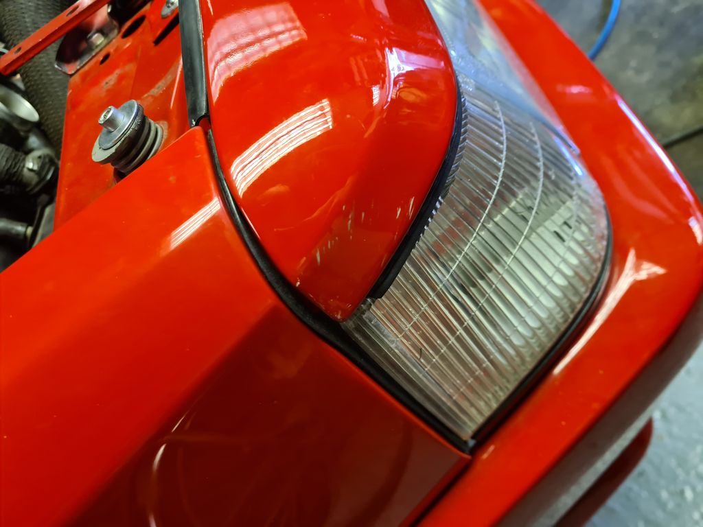

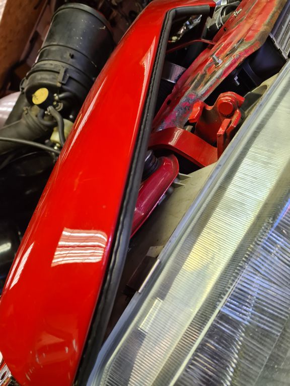

Refitted the rubber trim on the nosecone - if you dont use double sided tape to seat it it never looks right even with the plugs in place.

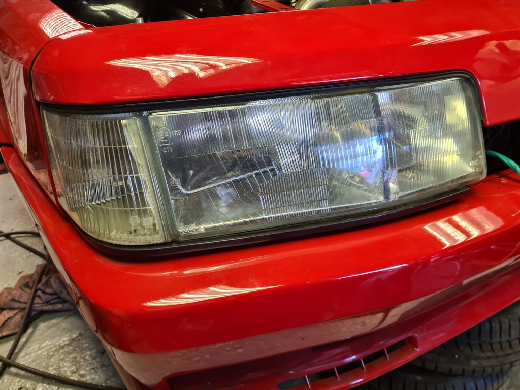

Found some trim to replace the headlight rubber seal, its not an exact match but I think it'll work. Old ones are all bubbly and horrible.

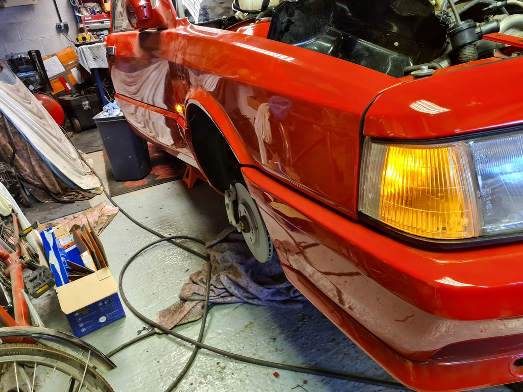

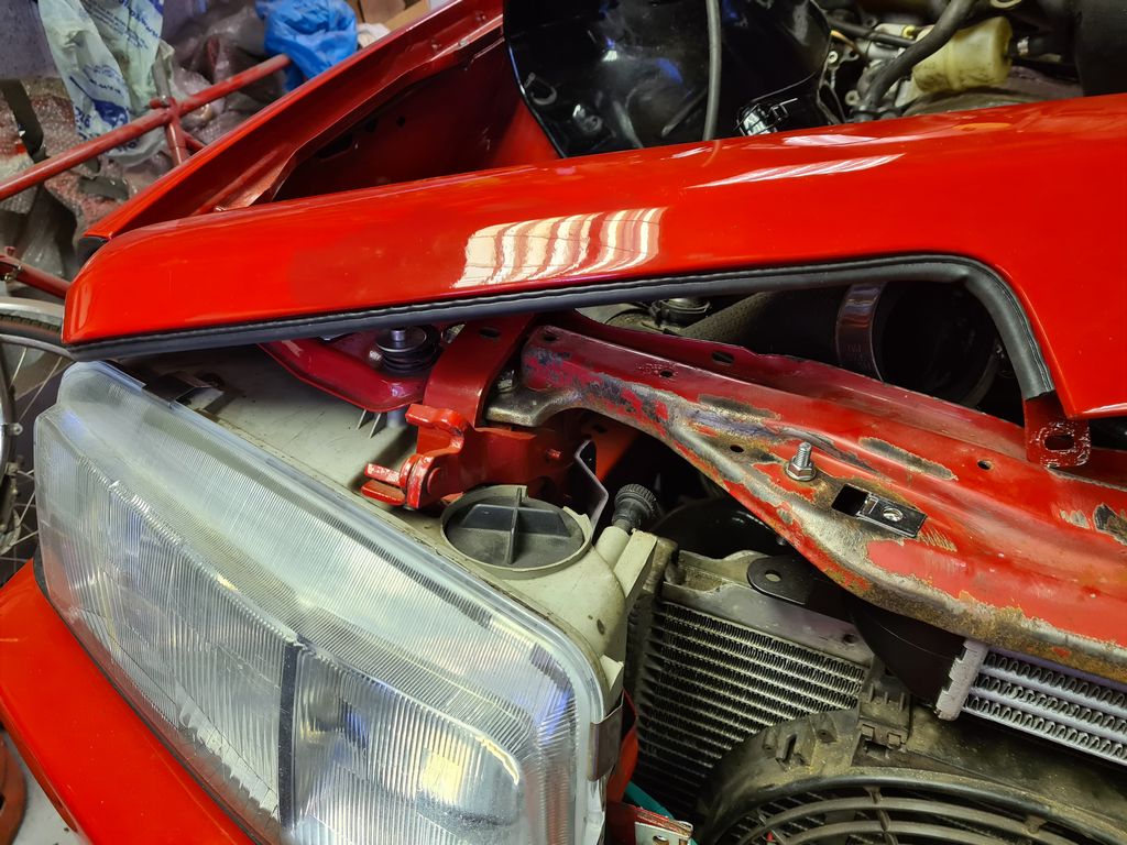

MUCH better, also got some new trim for the wing leading edges.
Finished off with some brand new side repeaters on the wings, wink wink!

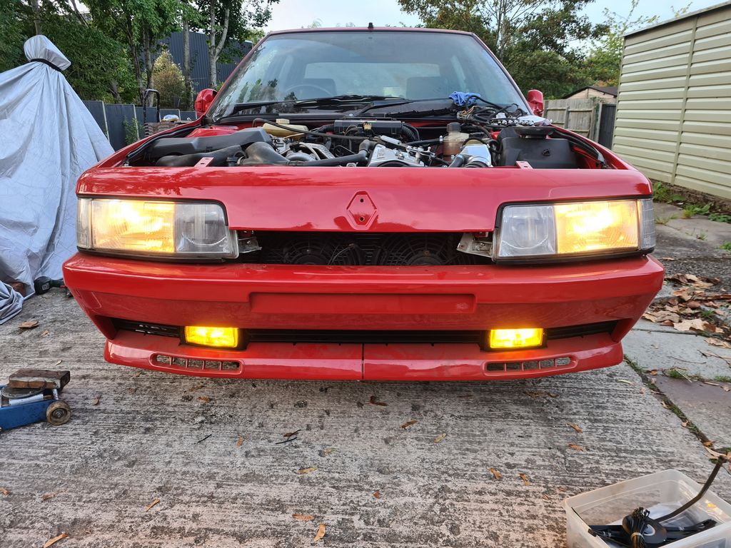

Dragged this thing out of the garage so I could get moving on it again, its been a while...too long! I've got a fair bit of cashflow tied up in it now so I need to get it done and gone.

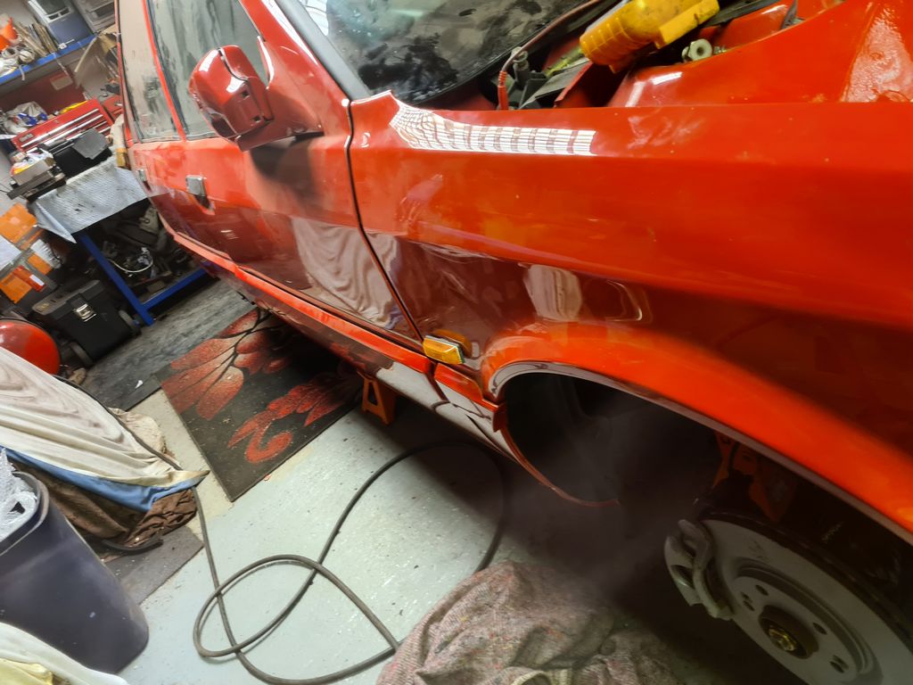

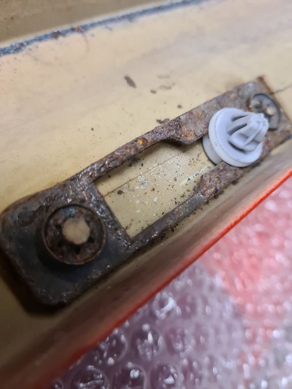

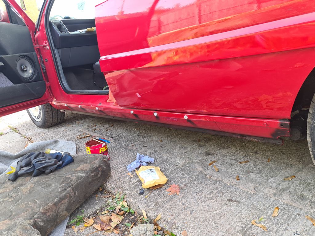

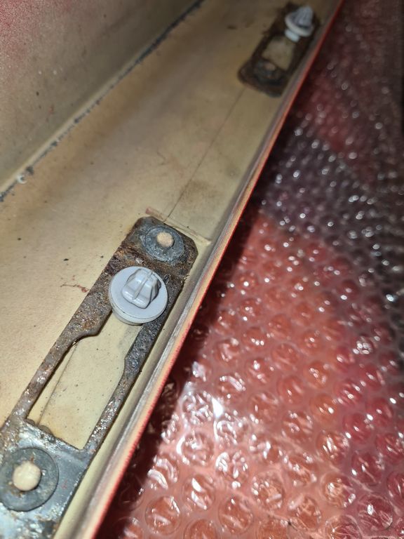

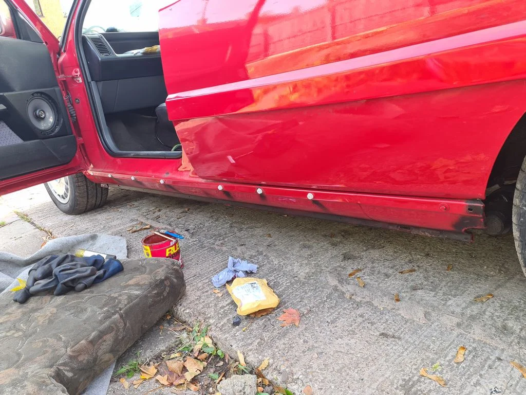

Managed to get the sideskirts sorted, the clips aren't available any more but I found some that were close. I had to drill the holes in the sill out a little tiny bit, protect the holes, knock the clips in, and then mod the brackets on the sideskirts to make them a little bit wider - once that was done and they were painted too it all slotted into place! Even better the new style clips are plentiful and readily available on eBay.

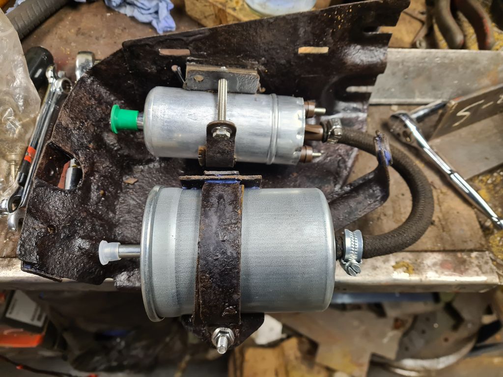

Fitted the new pump & filter, drained the tank of old fuel while I was there.
Of course the bracket studs snapped so I had to drill those out, and replaced some fuel pipe.

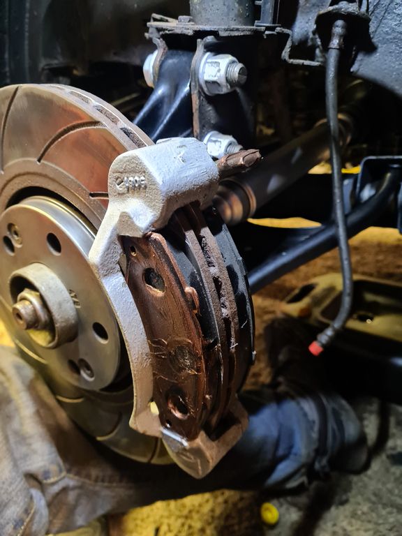

Despite the entire handbrake system being new and the calipers rebuilt as you saw earlier in the thread, the handbrake wasnt working. I traced the issue to the OSR caliper, the lever was just moving and not binding the brake on. Tried to fiddle with it in place but ended up taking the whole thing off and stripped the caliper down...again.
Couldnt find anything wrong, so reassembled and refitted and this time set the piston as close as I could to the pad/disc (no free play). Then put the handbrake on first, and then bled and hit the foot brake. This worked, and the handbrake is now sweet :)

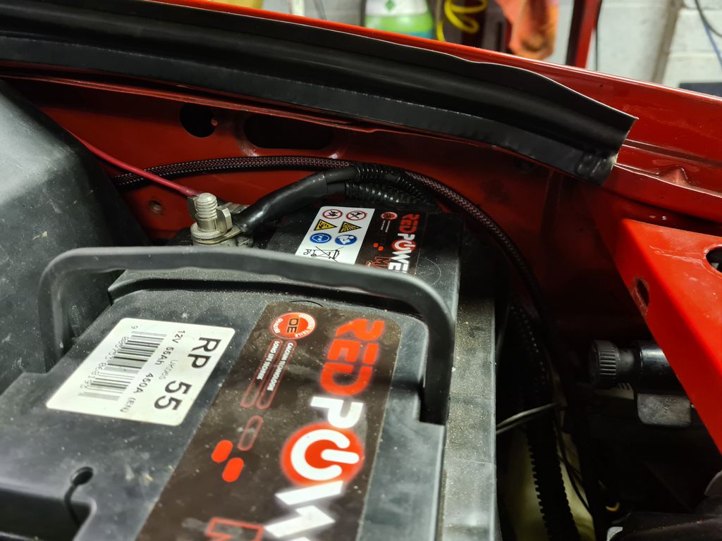

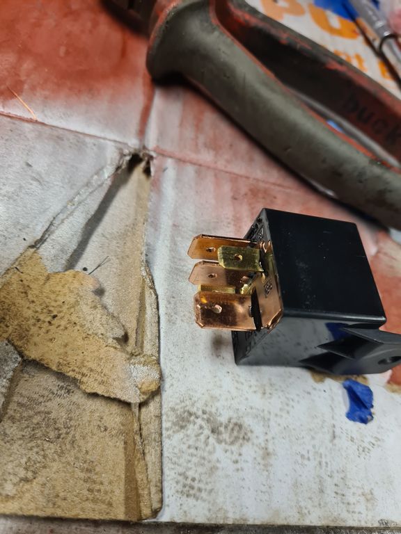

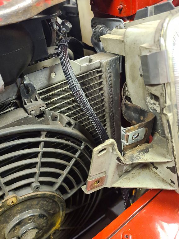

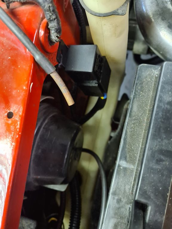

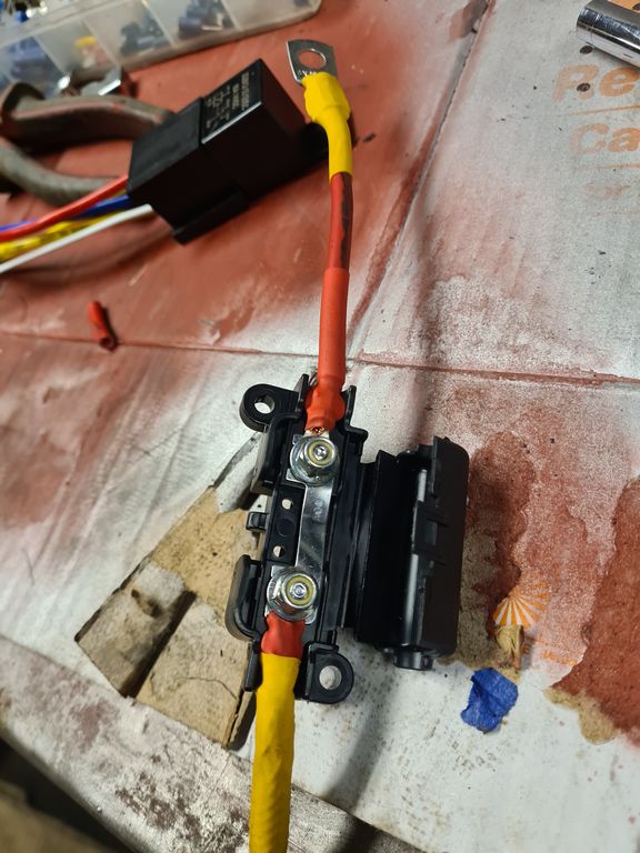

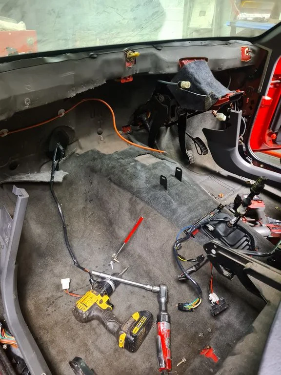

Then I fitted the new fan switch and made a whole new fan loom with a beefy fuse and 80amp relay, the terminals are massive! I used the 80 as its one relay for both fans.
Tucked the wiring away

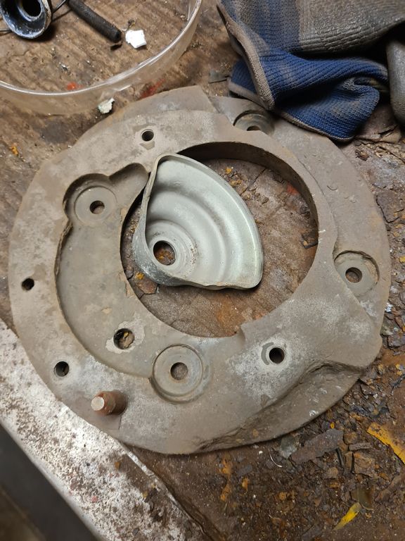

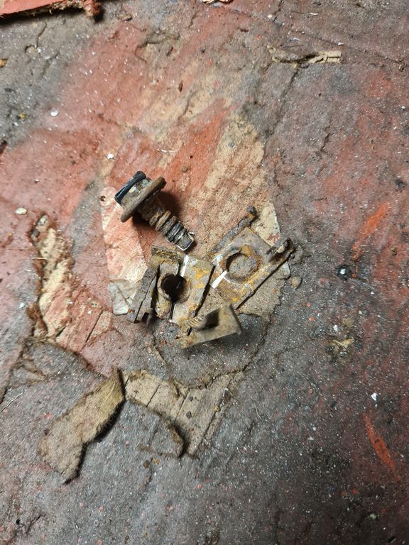

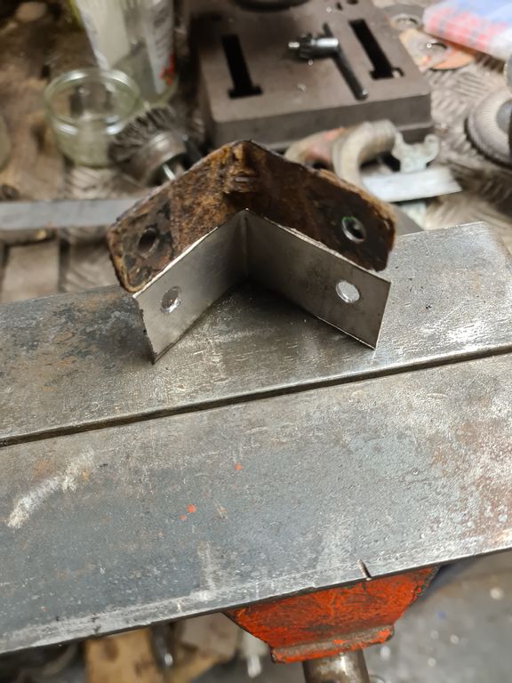

Decided to refit the brake cooling ducts and trim, this meant dealing with the rusty crap that was stuck in place
And also remaking the brackets which had done a fairly good job of disintigrating, I did triangulate the corners to reinforce, pics later when I paint them.
Refitted with new spire clips - these will have to come off again though as I spotted a few crusty bits under the wheel arch I want to deal with before final fitting.

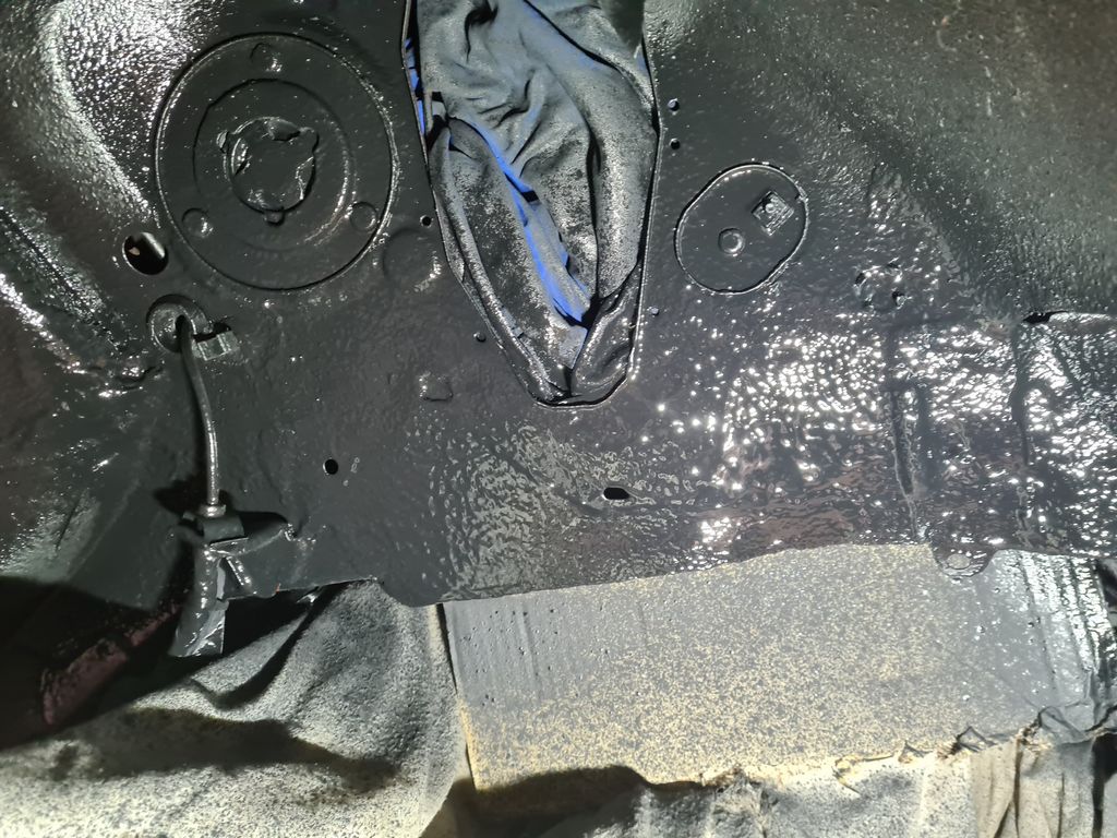

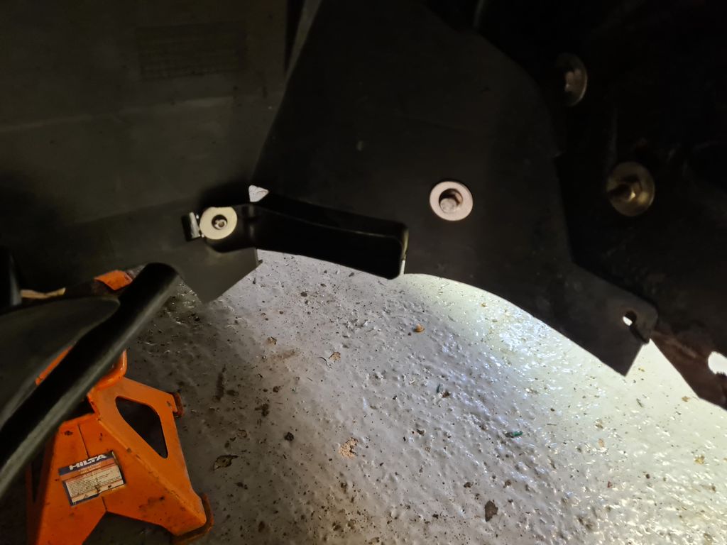

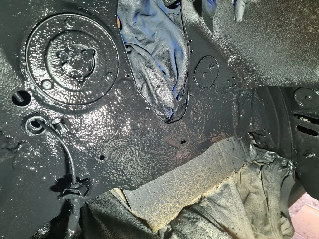

Gravitex on the inner arches - repaired areas looking nice now. NS
OS

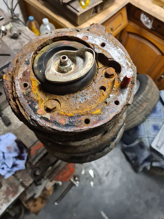

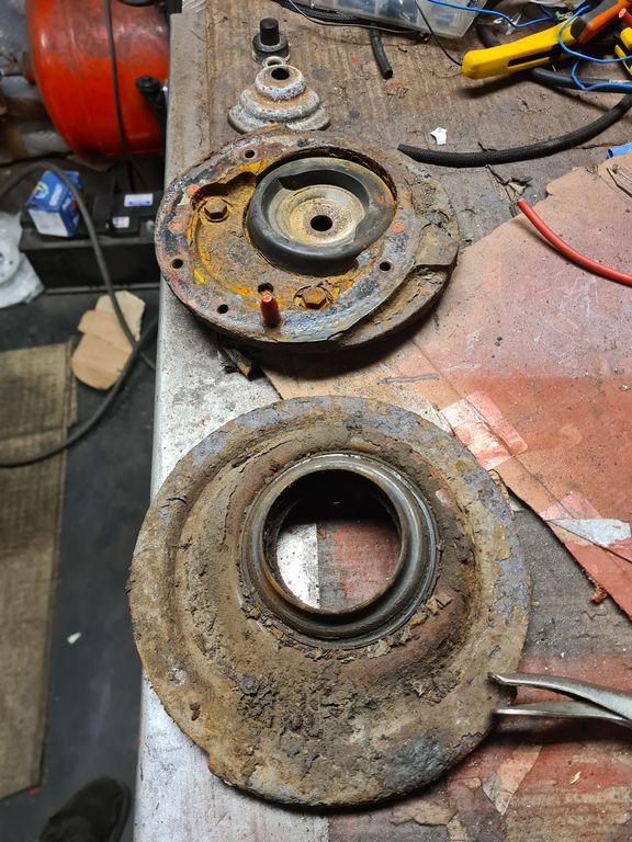

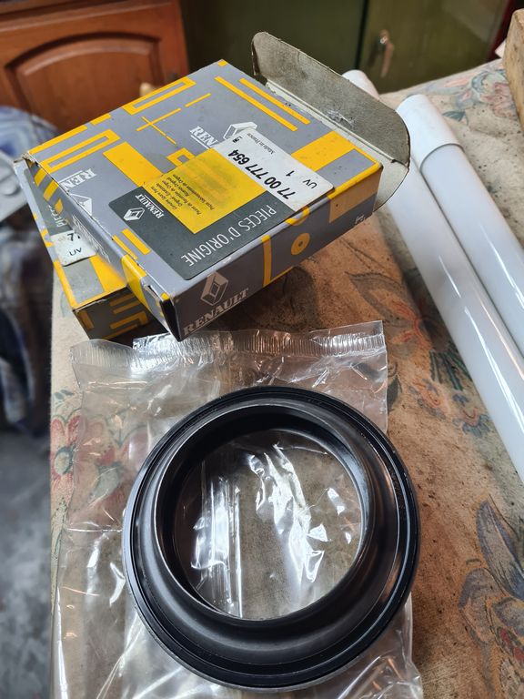

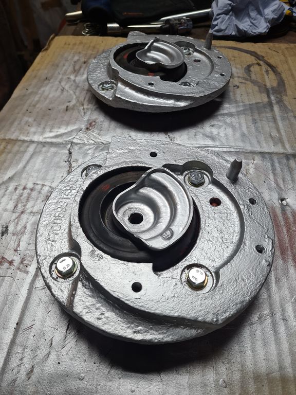

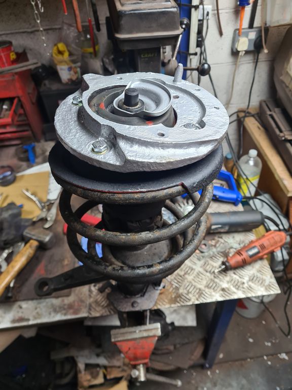

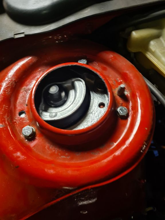

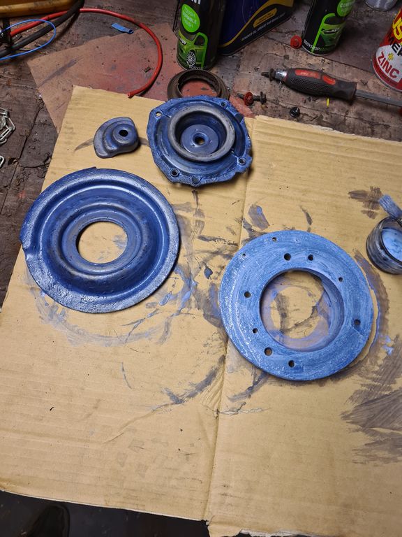

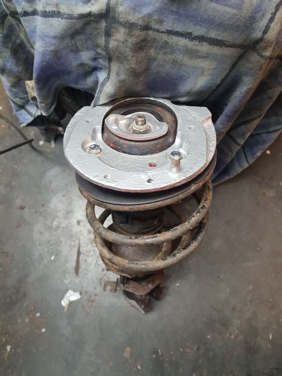

Painted up the topmount retainers, topmounts etc, reassembled with new bolts and bearings
And refitted, along with all the brake vents and stuff, then wheels. Ready to come off the jacks now, possibly for a short test drive!

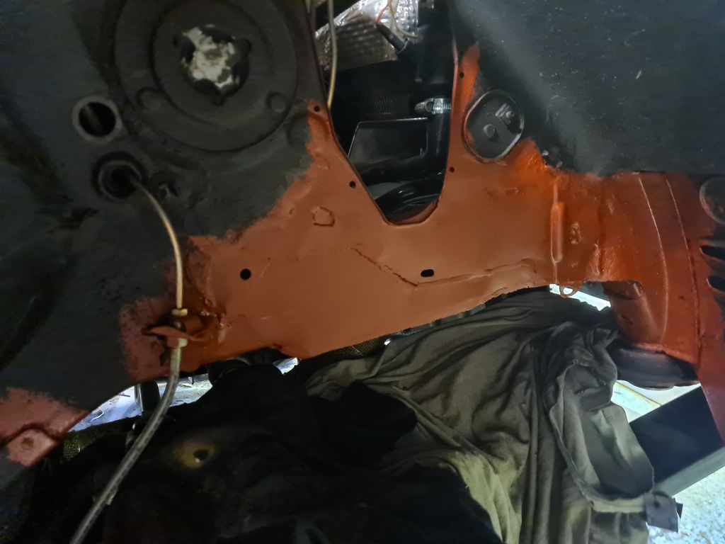

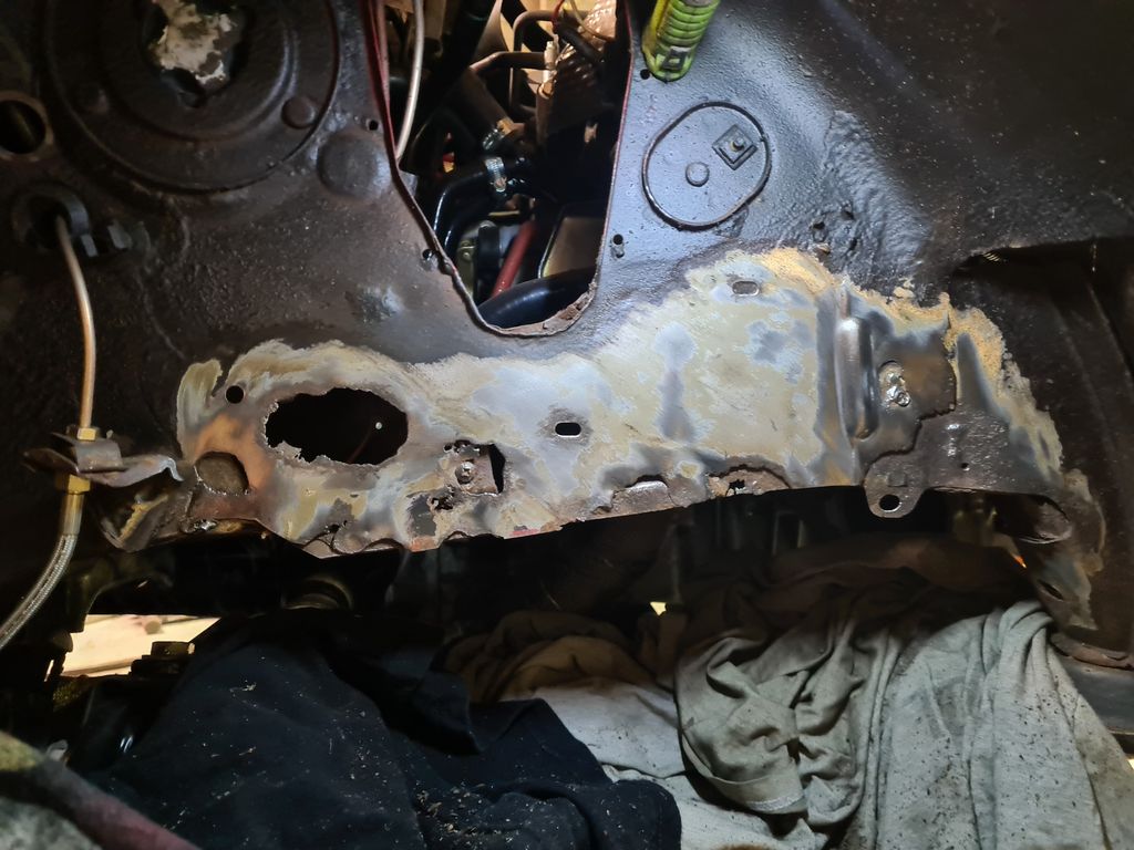

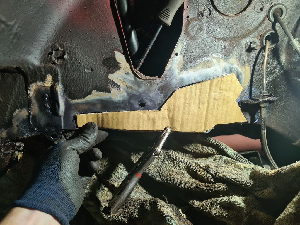

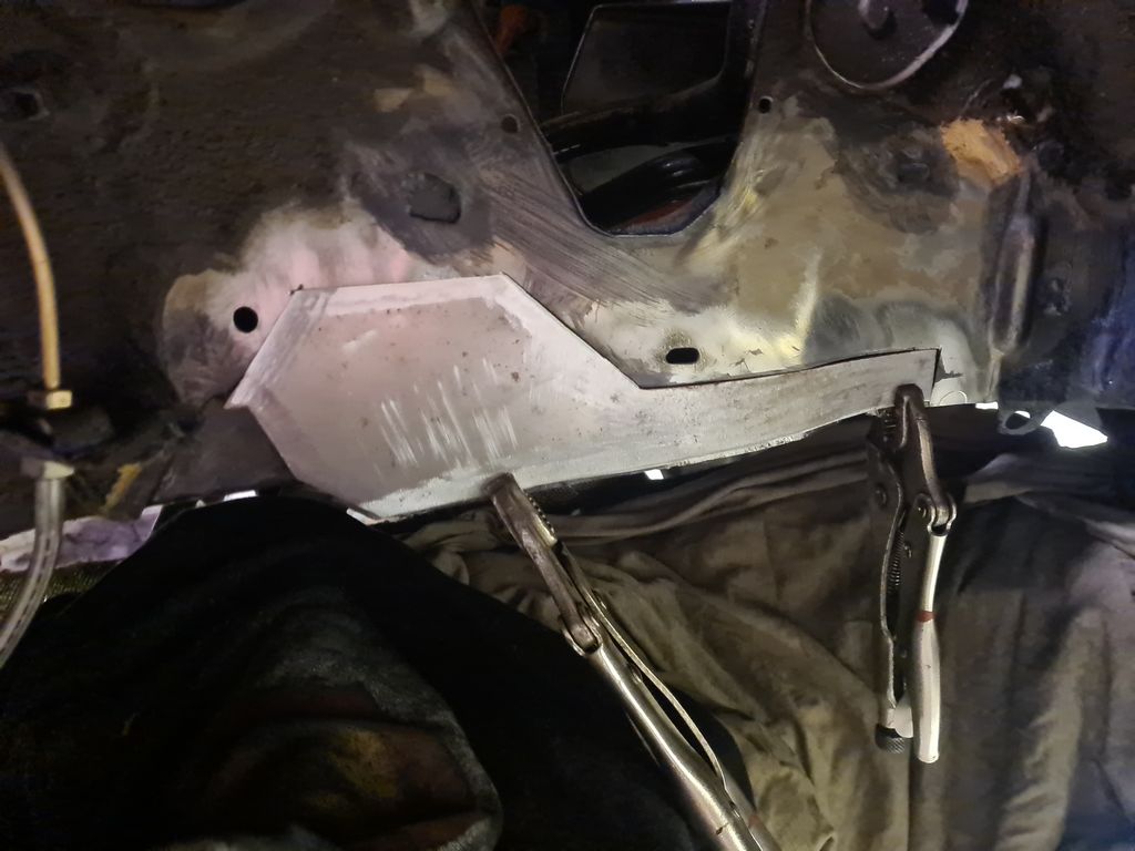

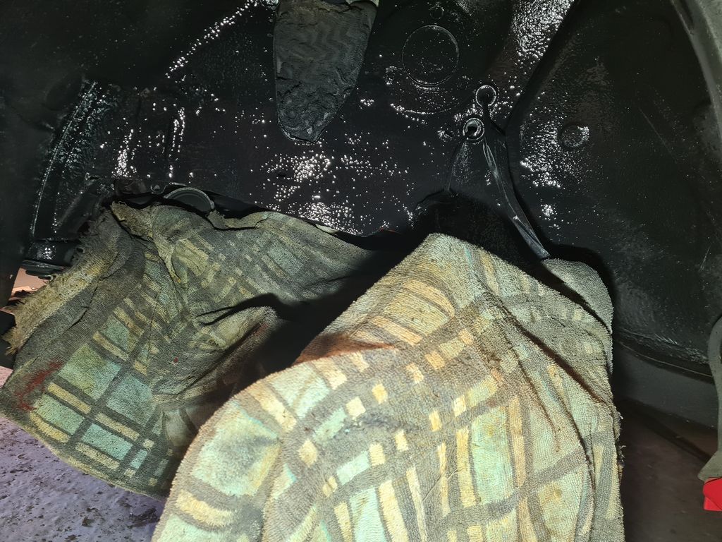

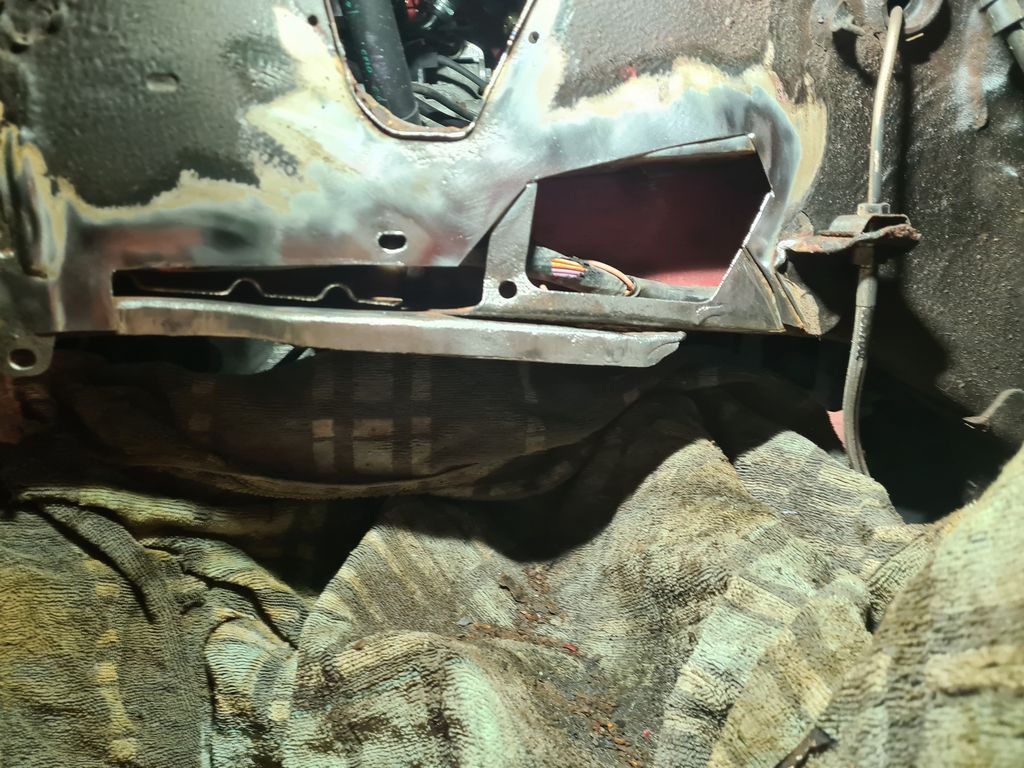

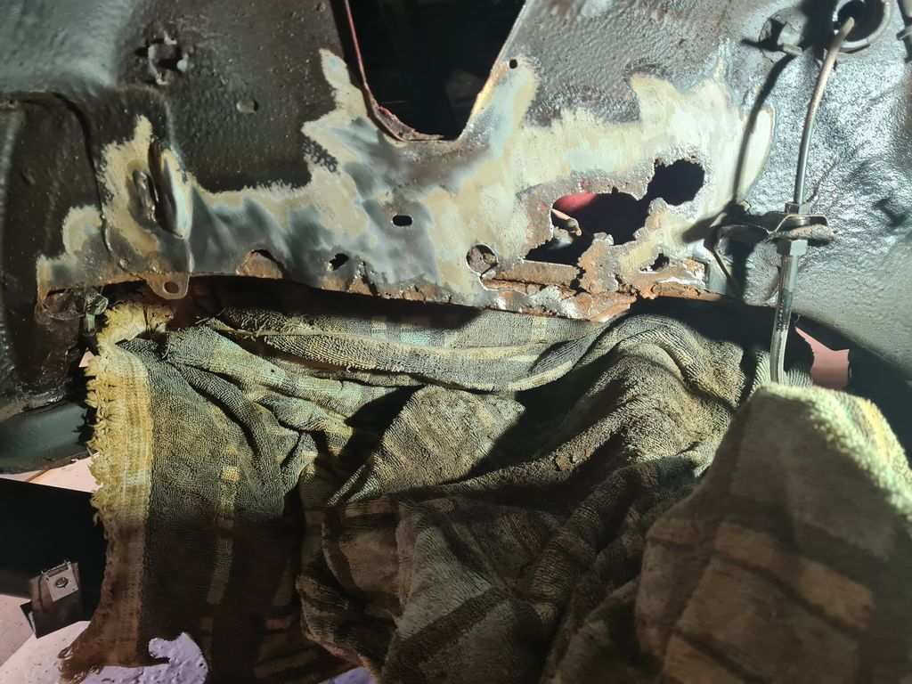

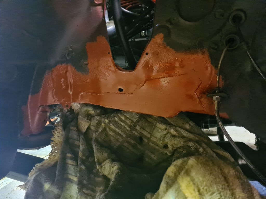

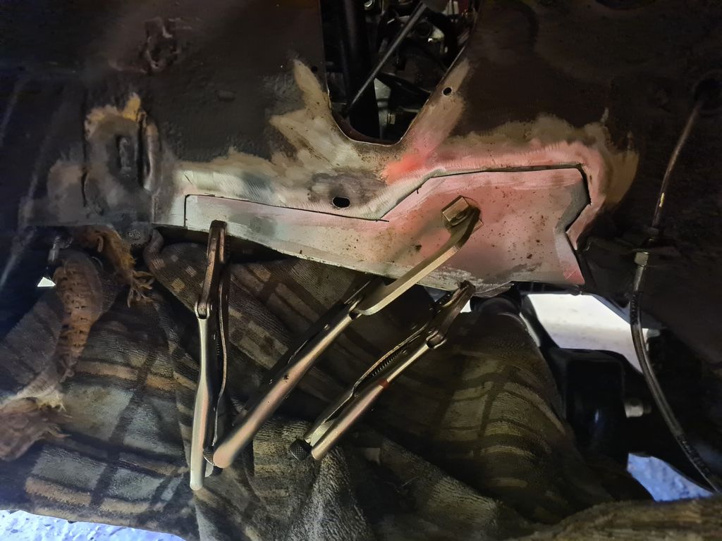

Oh, looks like I missed the inner arch repairs, so the above wont make much sense! This is what I discovered under the inner front arches, behind a fairly poor attempt at covering it with underseal lol
NS
Grinder action
Templated
Replacement cut
Welded in and primed
And the OS

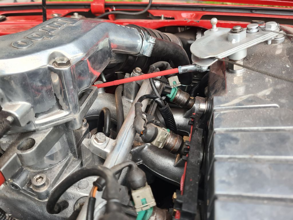

Right, now where were we. Throttle linkage fell off (and on investigation fell apart)
So had to make a new one

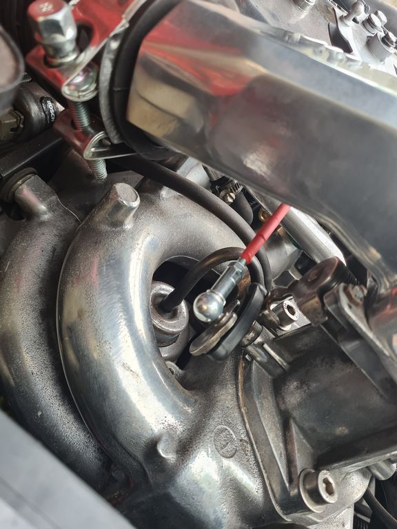

Fixed the water leak and tightened the actuator up, went for a slightly longer test drive. Engine is really nice and picking up boost as it should now.

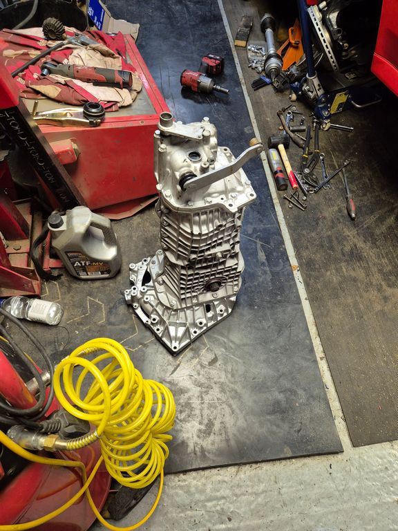

I'm not very happy with the gearbox, it crunches into third and theres a funny whine on decel in 2nd. So now thats going to have to come out for a rebuild!
f***s sake.

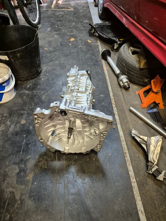

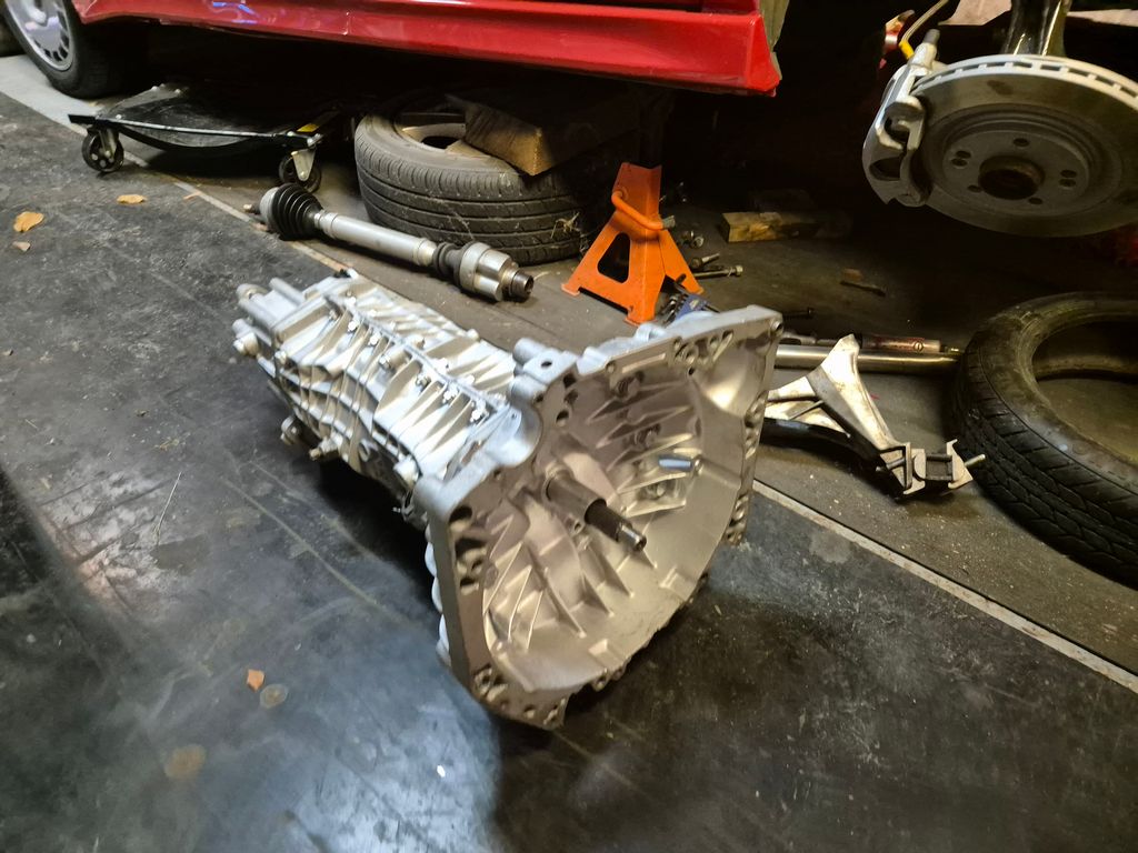

Box is back, turns out there was a whole load of issues inside with mismatched gearsets - whoever rebuilt it didnt really do it very well!
Now reassembled with a lower final drive and a longer 5th gear from a R25V6 Turbo :)

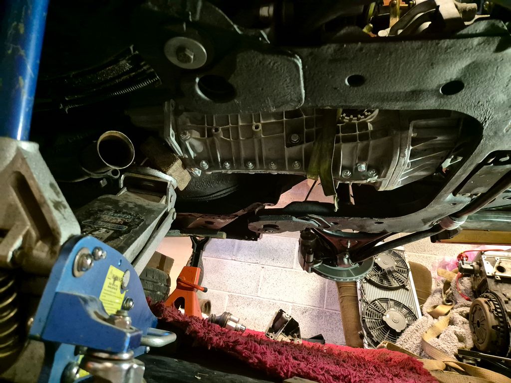

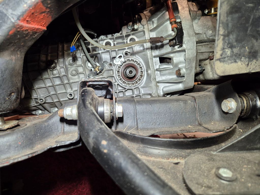

Managed to get it in place and bolted in on the engine and box mounts, hoping to have it all reassembled this weekend.

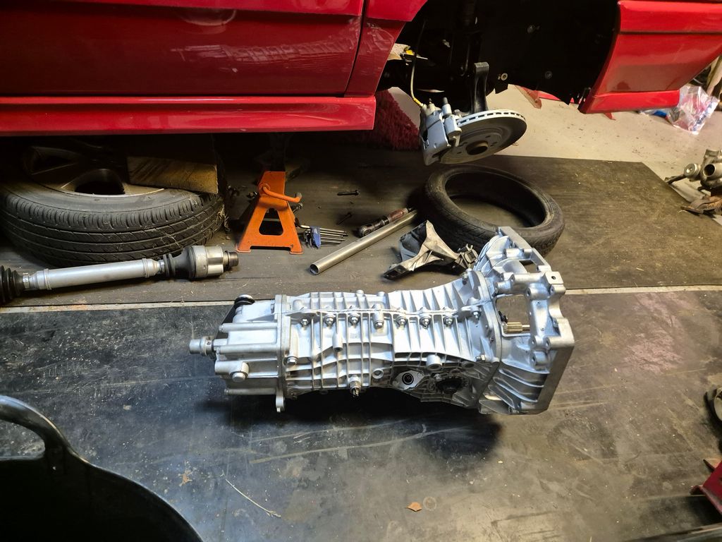

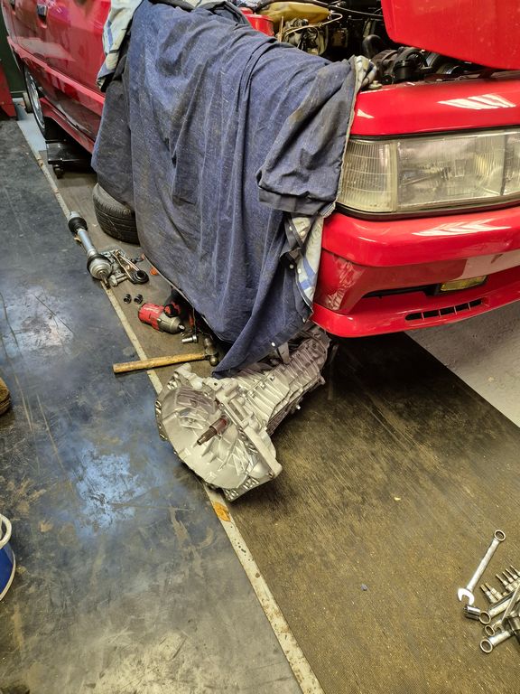

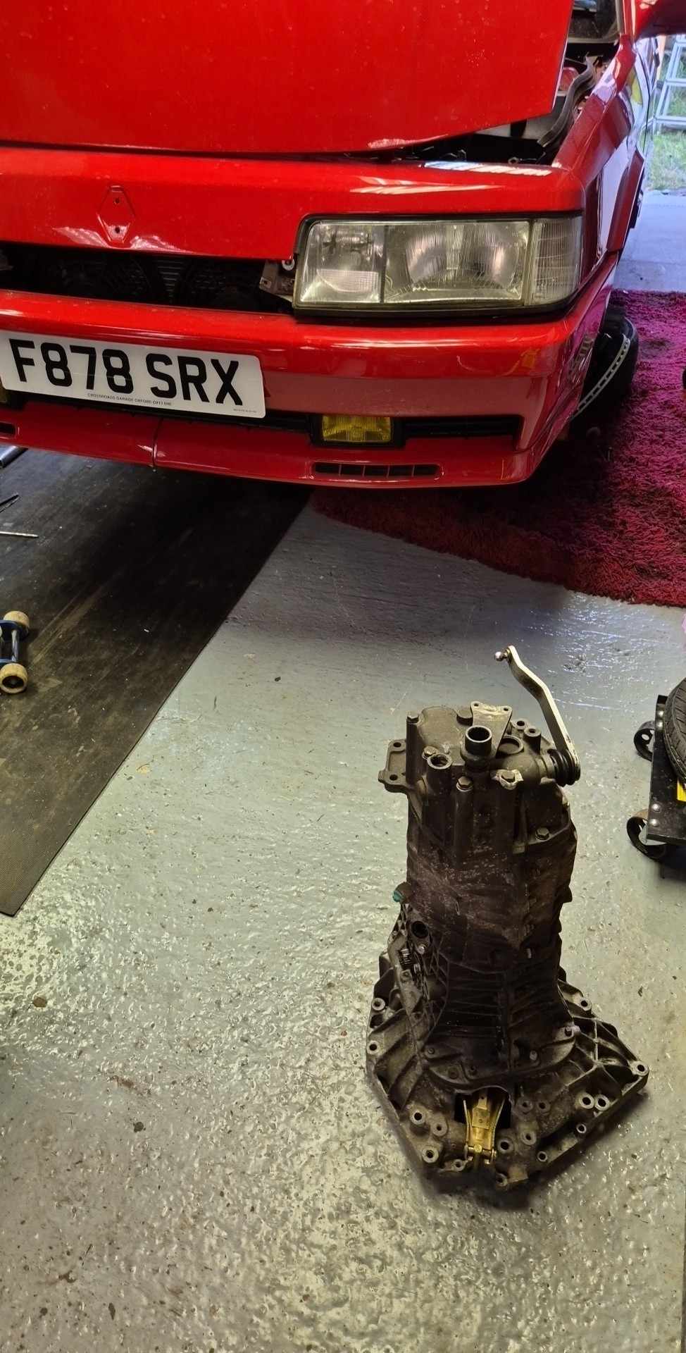

Got it all bolted back together at the weekend, filled with oil, fired it up while on ramps to check it was OK.
No second gear.
Absolutely fuming.
Got it back AGAIN. Refitted it, 2.5 weeks after crushing the end off my finger in a log splitter (doh). It wasnt easy but I got it in.
Reverse - fine
1st gear - fine
2nd gear - fine (phew)
3rd gear - fine
4th gear - fine
5th gear - not fine :(
No 5th. Exact same symptoms as 2nd, just with 5th. Absolutely fuming.

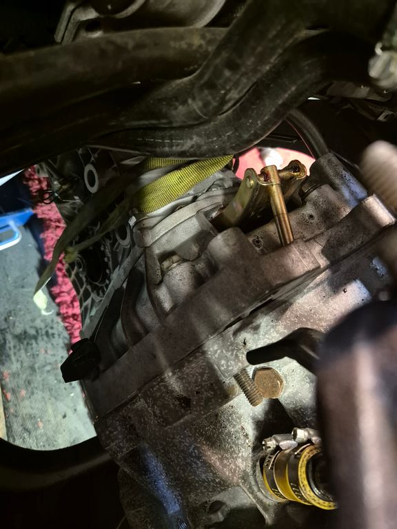

Back out again
So an extra ball was found in the 5th gear detent ball and spring setup.
OK - fine. Box back in again
Quick selector rod refurb as the bushes were pretty crap
Connected up the minimum and tried it, slots into 5th. Win! - or so I thought. Rebuilt basically everything save putting the wheels on.

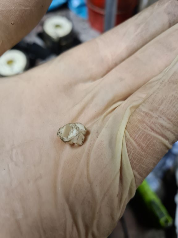

the secondary shaft nut has come off the back of the shaft and machined its way through the housing :( this is ANOTHER mistake by the gearbox guy, thats three errors in 2 rebuilds now. Obviously hadnt been torqued or the soft edge knocked into the flat on the shaft to stop it coming undone. The primary shaft one was done OK, but not this one. No way was it done up with the immediate issues with 5th. It only spent the time in 5th you see in the video.
So. I cleaned up everything, rethreaded the damage on the nut, refitted it and torqued it up to the specified 200nm (!), then bent the locking tab over. Refitted the housing - that took a while until I figured out how the selectors worked and how to align them! But it was refitted and then I left it to let the sealant go off (yesterday). Going to flush some oil through it today and then test it out, if it only gets it out of the garage for a car move around then thats OK. I have another 'box coming shortly with any luck. Gonna have to replace that housing anyway. I covered the hole with a bit of steel plate and some oil resistant sealant for now. Gearboxes aren't pressurised so it'll be fine for the time being.
