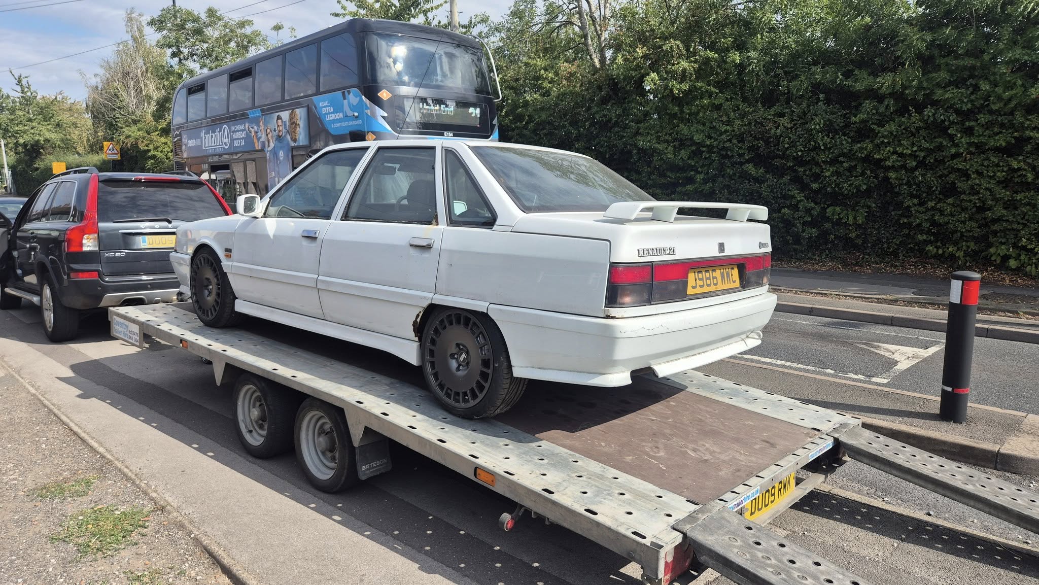

Brilliant! Haven’t seen one of those in a long while. What condition is it in?
Very cool! I imagine very very rare too being quadra? I didn’t even know they did them in 4x4.
Mechanically good but unfinished. Runs and moves under its own power...just.
Bodyshell good, weldng done on the mostpart. Sills, jack points, arches and so on.
Paintwork tatty - not good at all. Blemishes and rust spots everywhere.

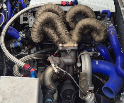

Engine looks interesting! How good is the drivetrain in these? Can they take decent power?
Never known a rear diff or prop to go, the box itself will manage up to about 300 brake before it throws in the towel usually. The issue with these is that although they look like the 2wd UN1 with a viscous coupling strapped to the back, inside they are quite different in a number of ways. Because of this, with low production volumes parts and upgrades are basically non existent. I was musing over a whole new transaxle for mine, possibly DSG, if I could find something to take the power I want.
...and this is another reason I have bought the car because the gearbox & clutch is just as juicy as the engine. More info to follow!
