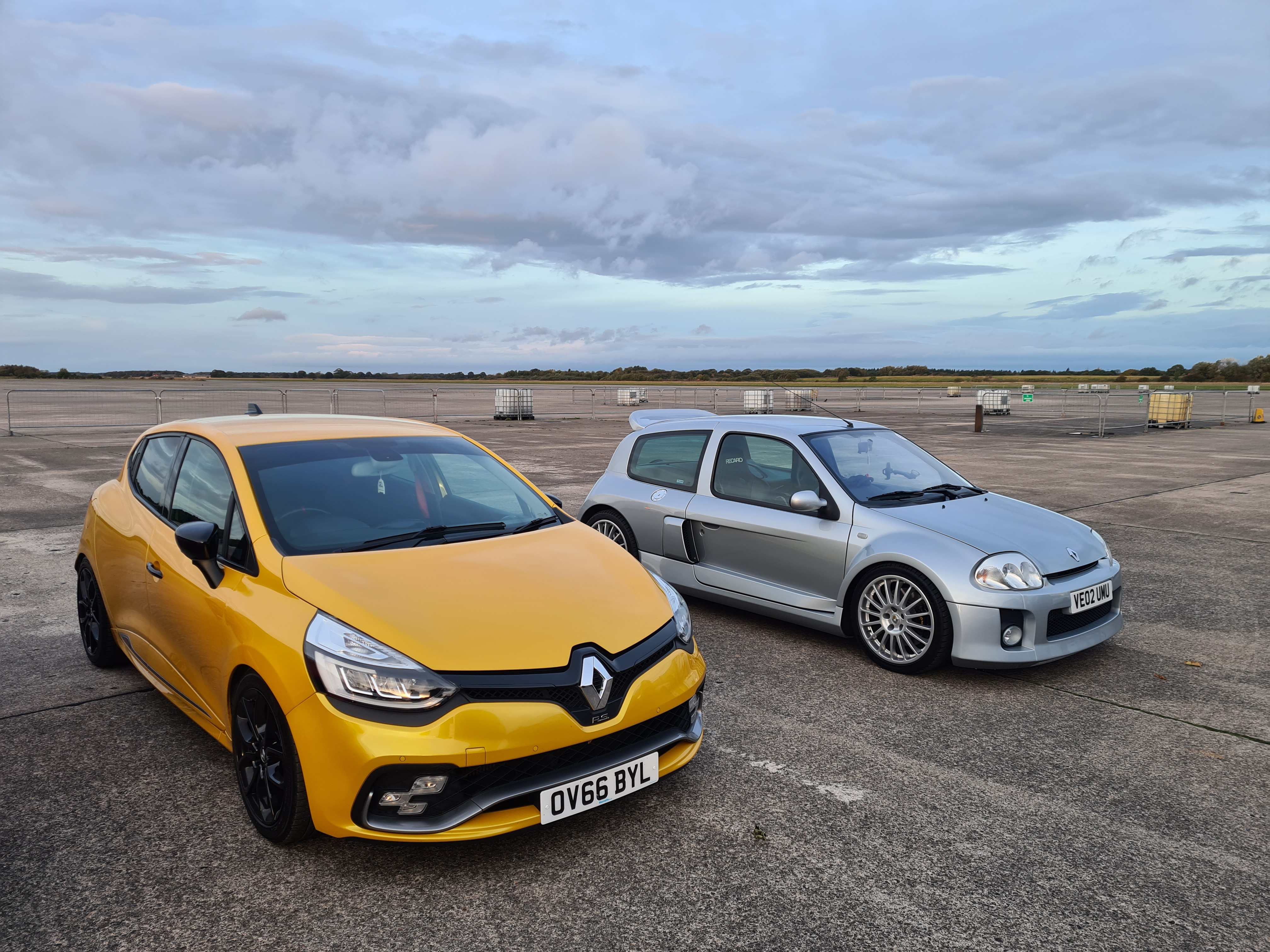

Pictured here with my other Clio <3 (both are due to appear in some YouTube films quite soon, preview here )

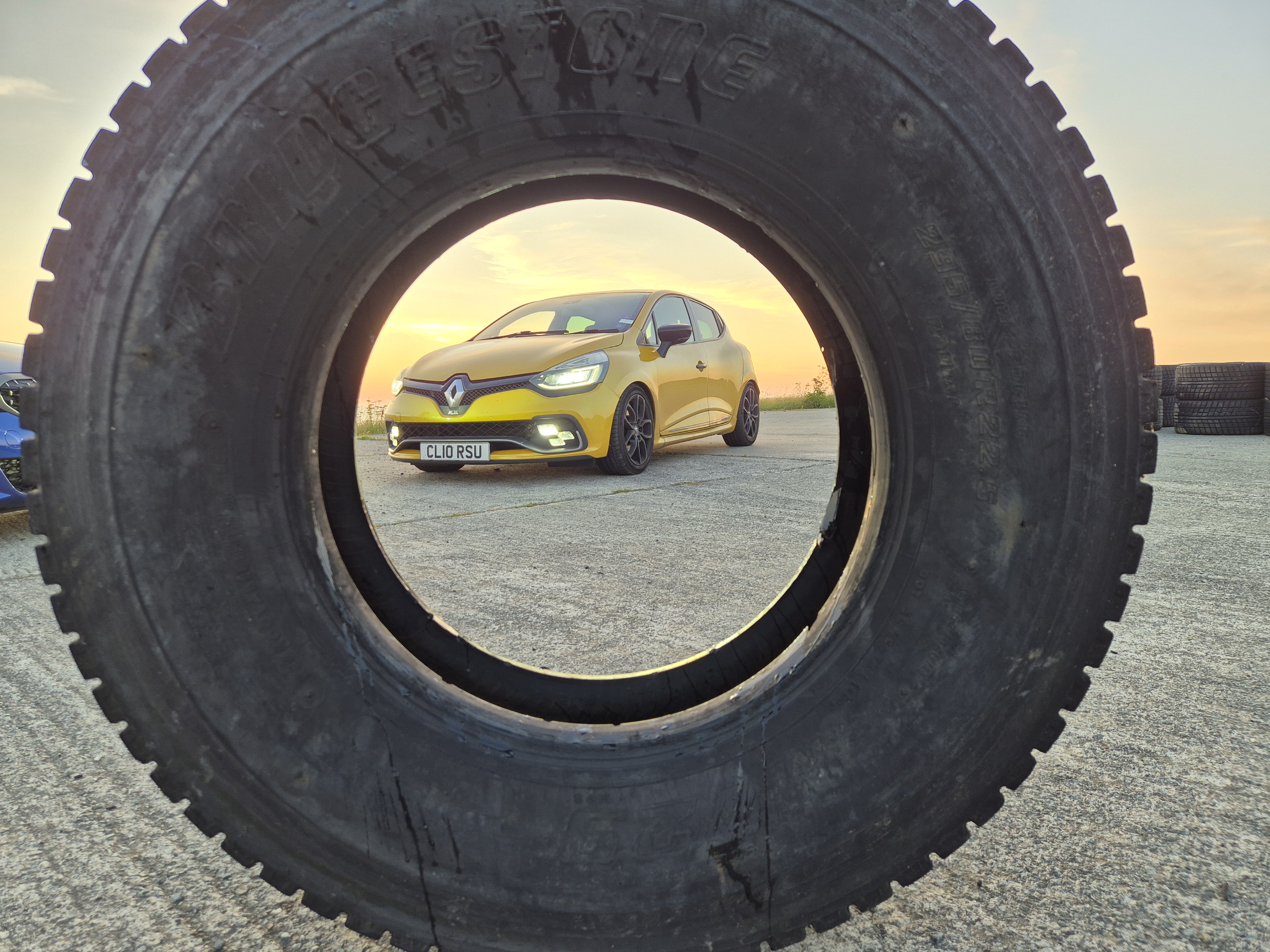

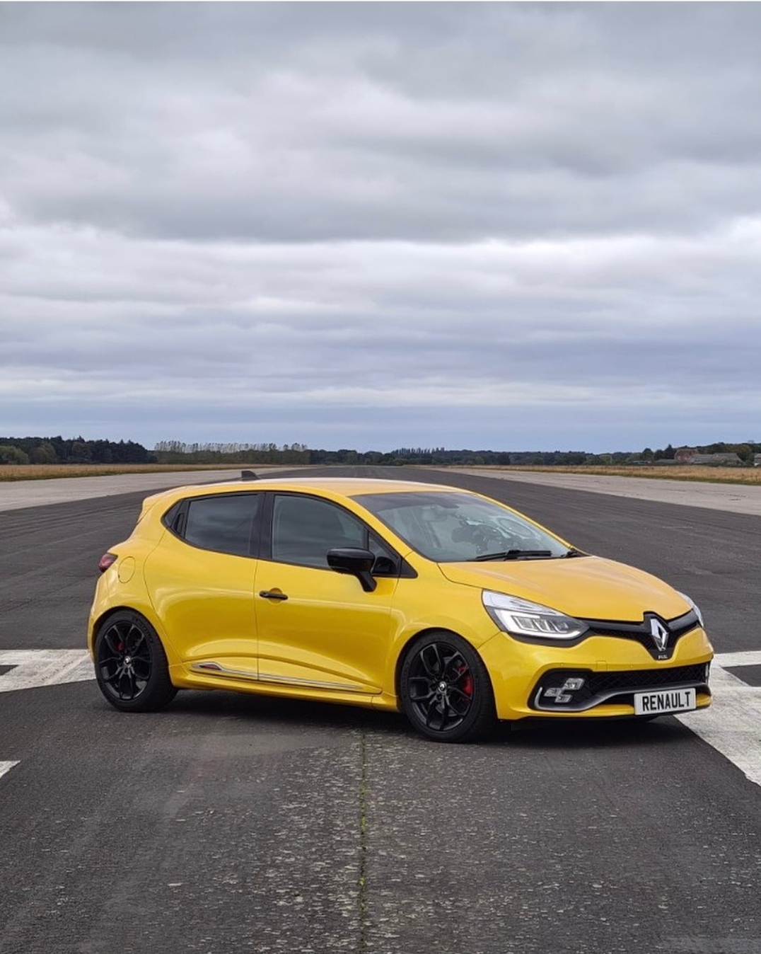

Credit to Renault Connected for this image :) (which was a lot harder to get than you might imagine haha)

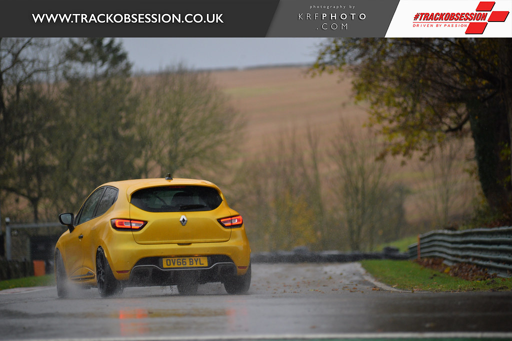

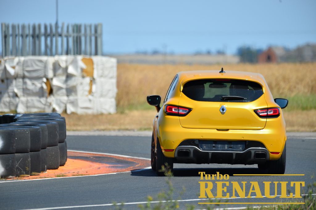

I chucked some performance brake pads at it and took it to Cadwell for a bit of experimentation - it's simply too fast to explore the limits on the roads properly.
What a car! These things are unreal.

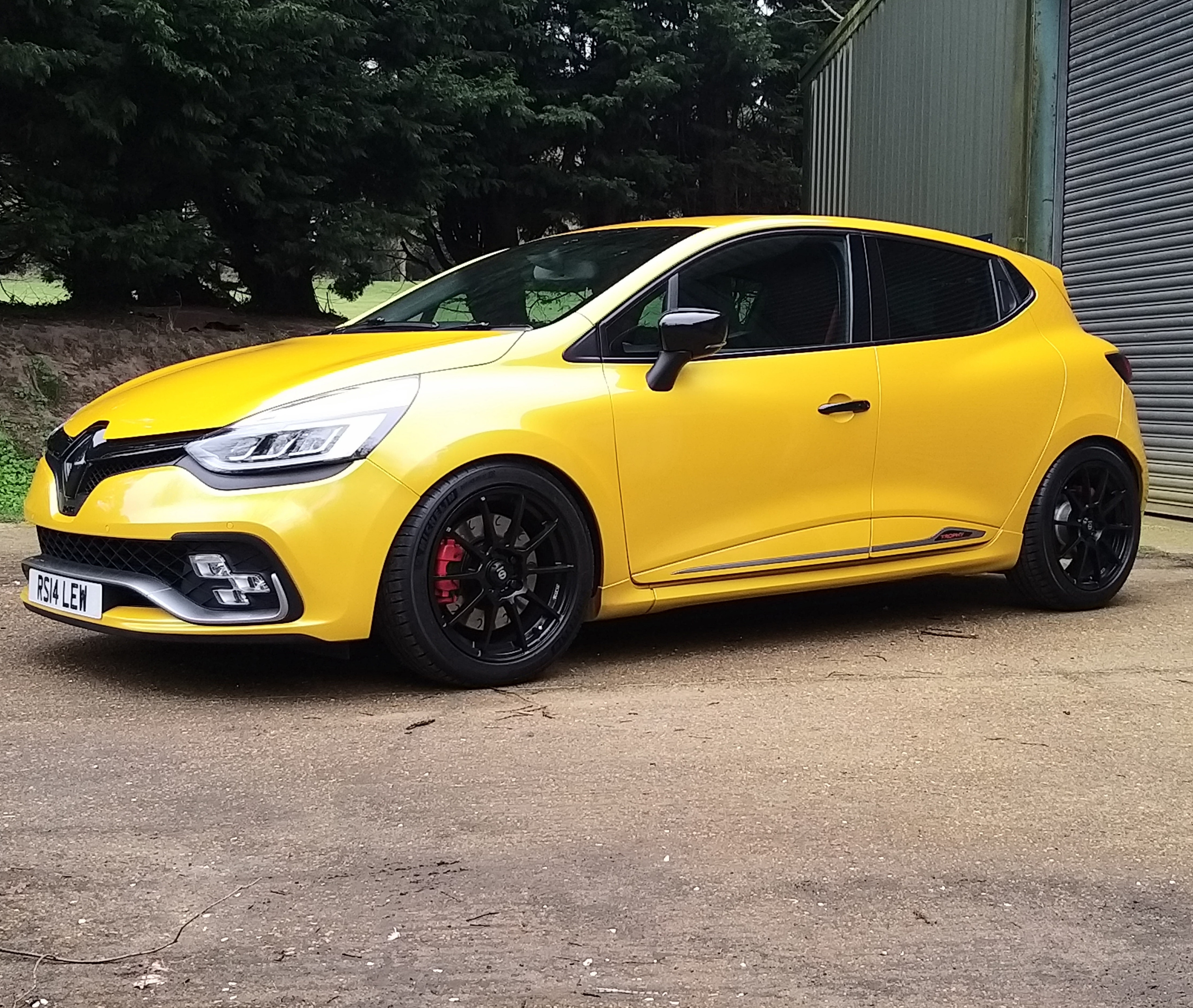

Shame @Lewi86 sold the briads! It looked epic on them!!

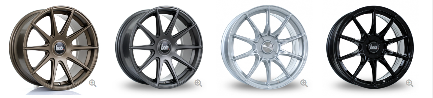

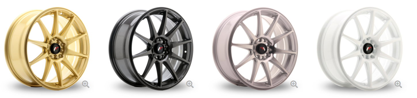

You know what, i'm not keen on em personally. I've just bought a set of OE 220T wheels for some sticky tyres, I like the ones on it now also but maybe I'd like to try something like this in the future... I like spokey wheels :)
Mmm yeah they look better off the car than on. The assetto gara? wheels suit them as do (annoyingly) turini’s. Really want to track a set down some day! And I hated them on my 172!

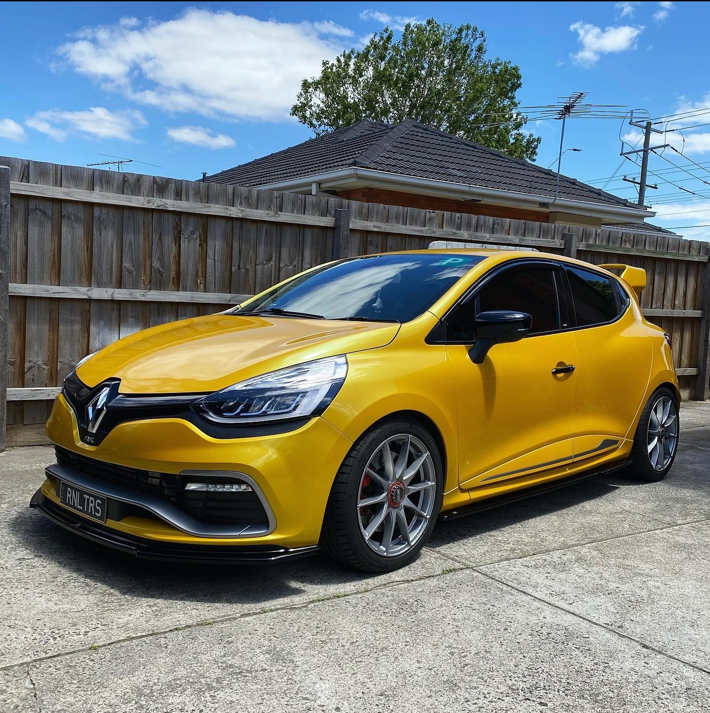

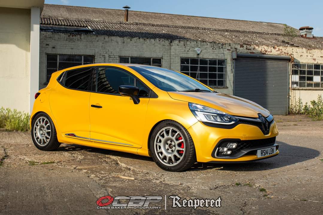

This was it on assetto garas...Nice wheel also light so good for track..but every man and there dog ended up having them so got rid.

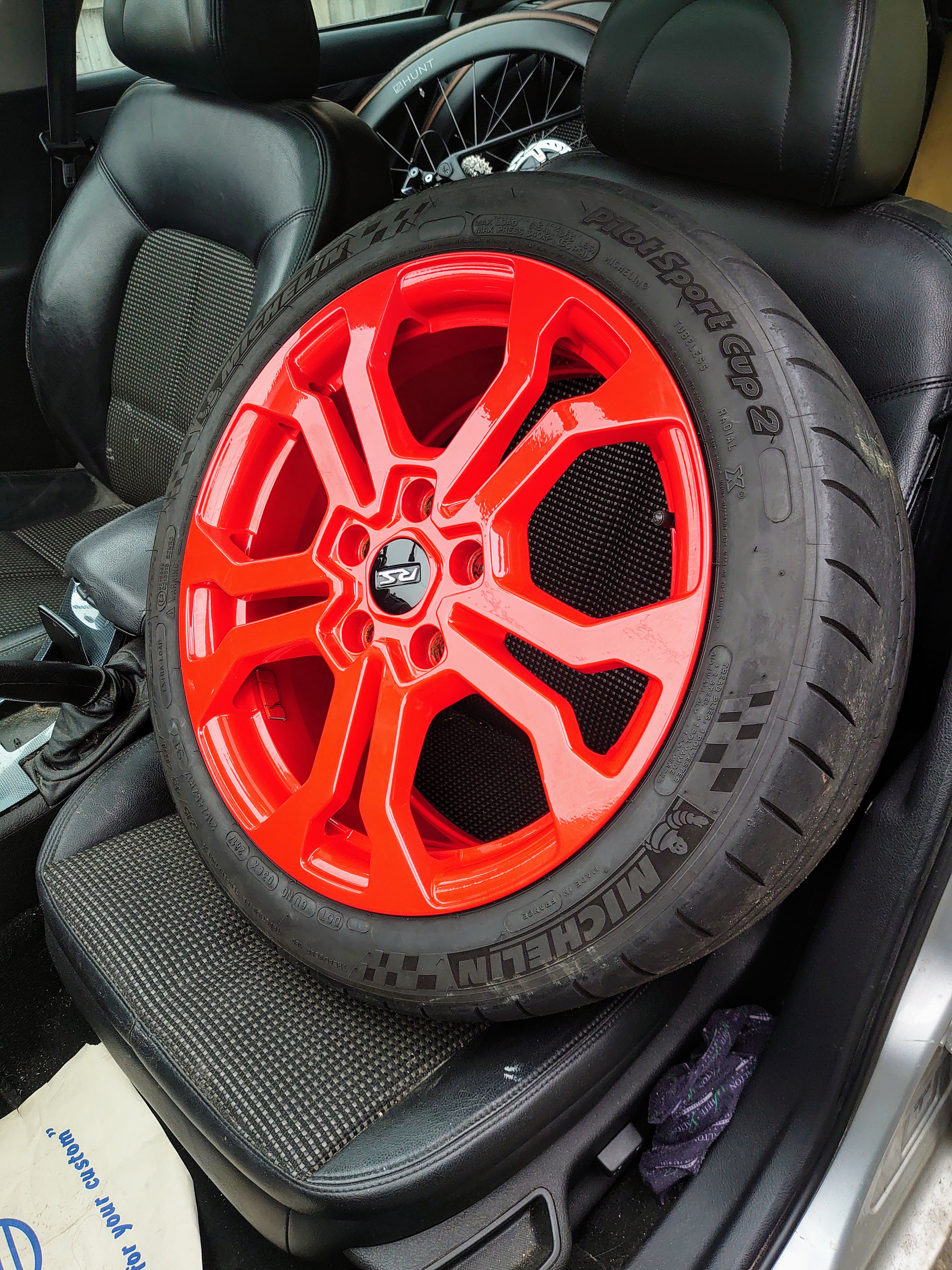

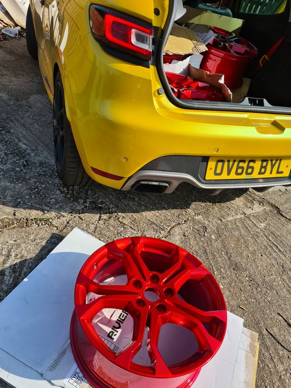

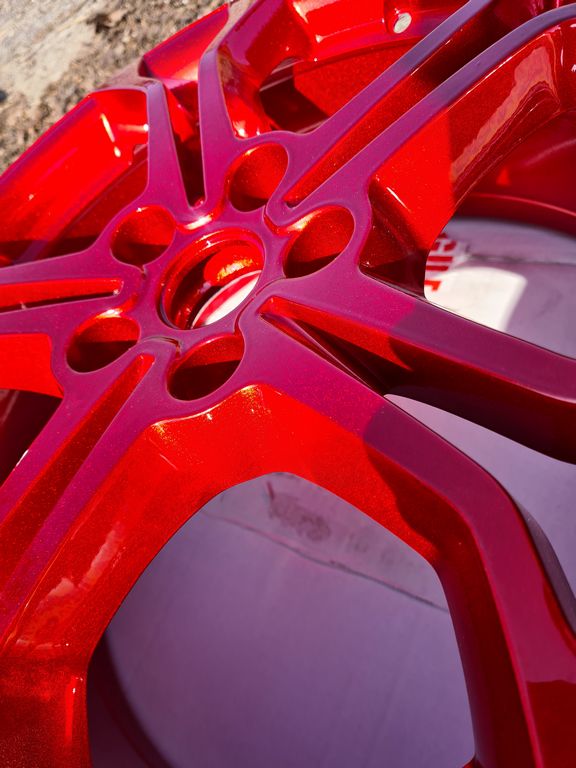

I bagged a set of the OE 18" wheels to put some nice sticky tyres on, and seeing as I was taking 2 sets of wheels for refurb anyway I thought it rude not to add these in at the same time.
The plan was black.
So anyway.
The answer to "can you get 12 wheels in a 220 Trophy" is yes btw :) - i'd usually use the XC90 but the Clio is clean air charge exempt and the place I use is inside the Birmingham one in Digbeth.
The plan was black.
So anyway.
Just to be an arse if yours is a facelift 220 Trophy these aren't the OE wheels, these are the 200 pre facelift wheels optional extra.
I dont like the later 18" ones, I think they look like someone financed a set of Fox racing wheels from Halfords and didnt choose the right offset.

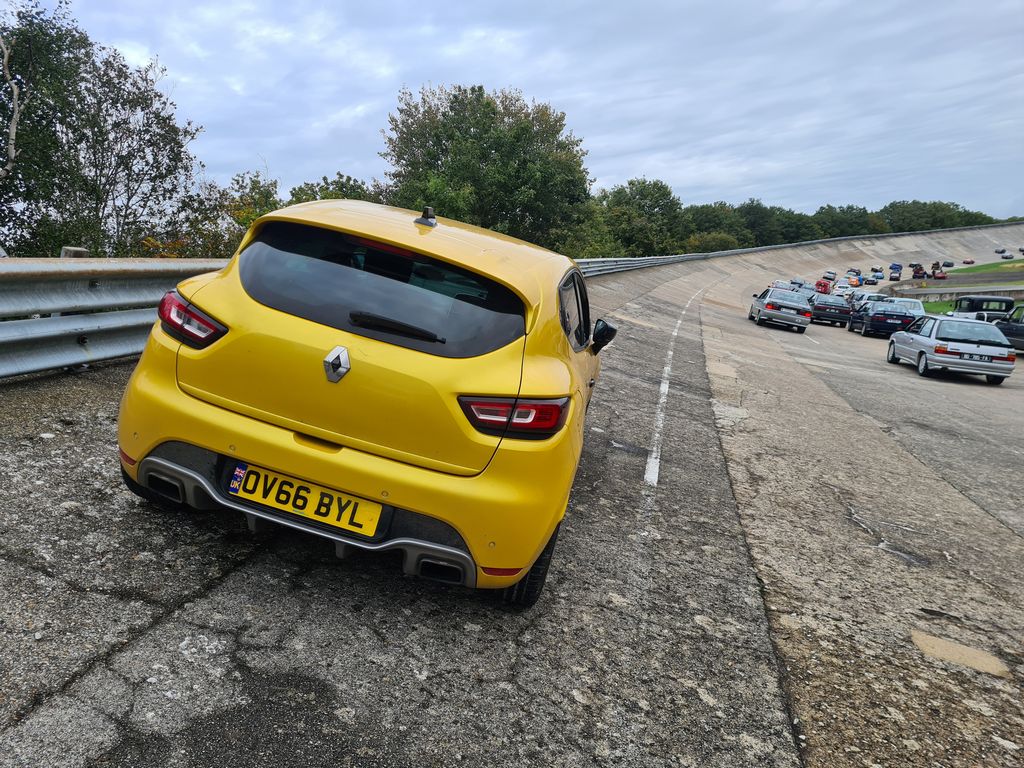

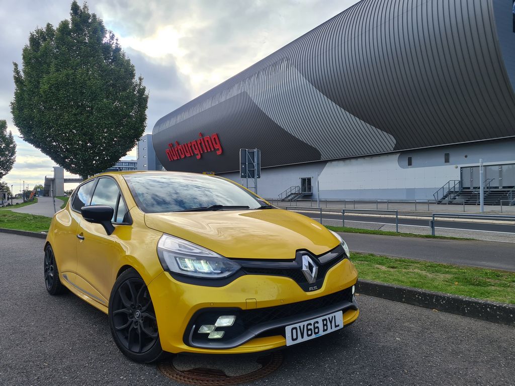

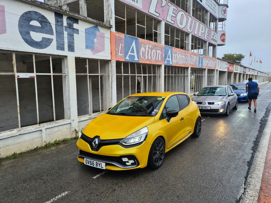

The Clio has been an absolute delight to use - can't believe its nearly a year since I bought it! We went for a bit of a jaunt to Montlhery & the Ring :)
Even popped by Reims.
I had a work trip to Portugal on Tuesday afternoon, so I left the Pistenklause at 8:30pm Monday night and was back to Calais before half 12 :) Did Adenau to Coventry on a tank and 2/3rds, considering we weren't hanging around thats pretty amazing.
What a machine.

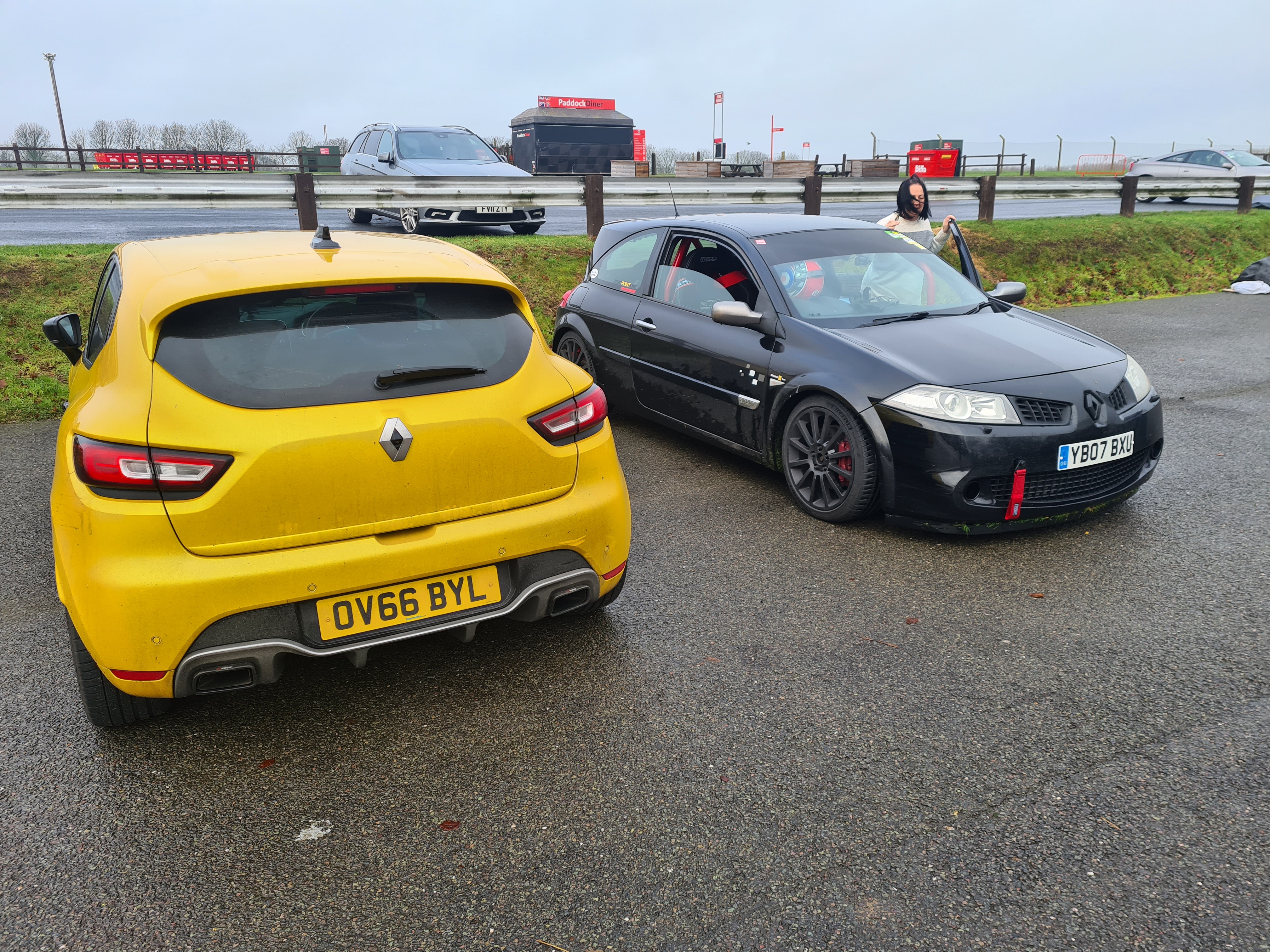

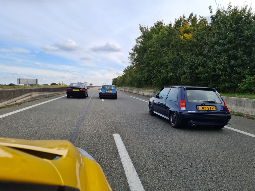

Last group shot before I engaged warp factor 12 across Germany, Belgium and France.

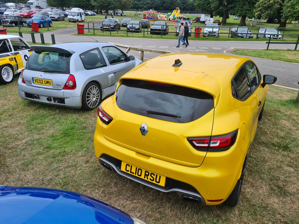

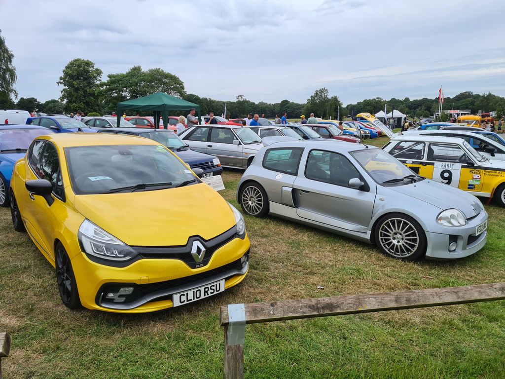

Took it to Oulton with the Vee for a static show. The first and last of the RenaultSport Clio's.

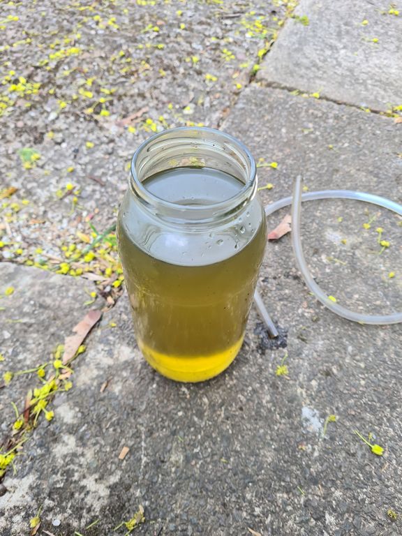

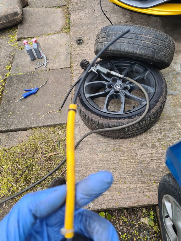

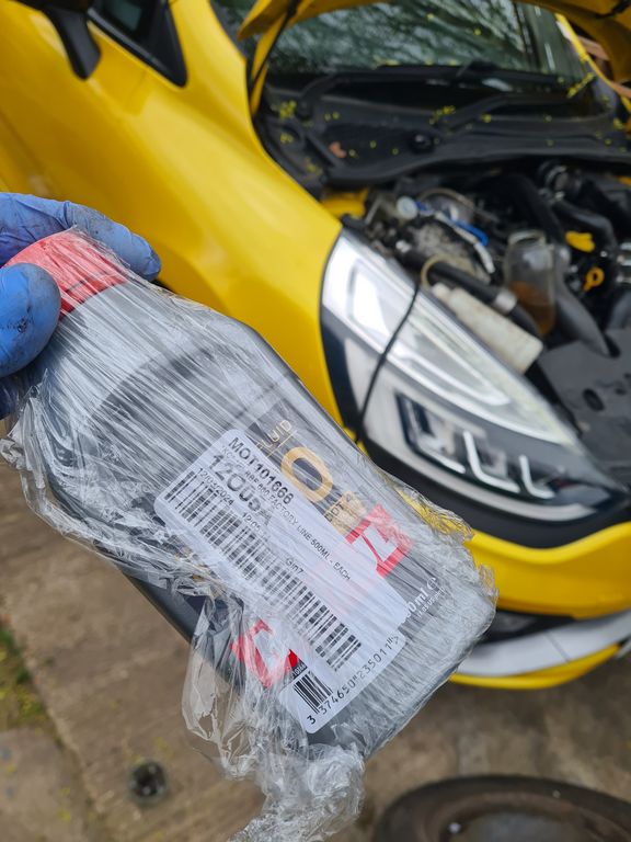

Still absolutely loving this little tarmac terror. I hadnt done the brake fluid or gearbox oil since I bought it so... I did those.

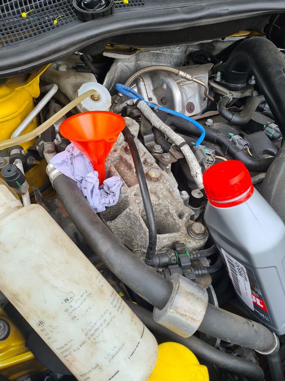

Sucked the old fluid out of the reservoir with a home made syringe thing, needs to be thin to get right to the back
RBF 660 and an Eezibleed, no issues really, it all went swimmingly
Old stuff wasnt too bad at all.

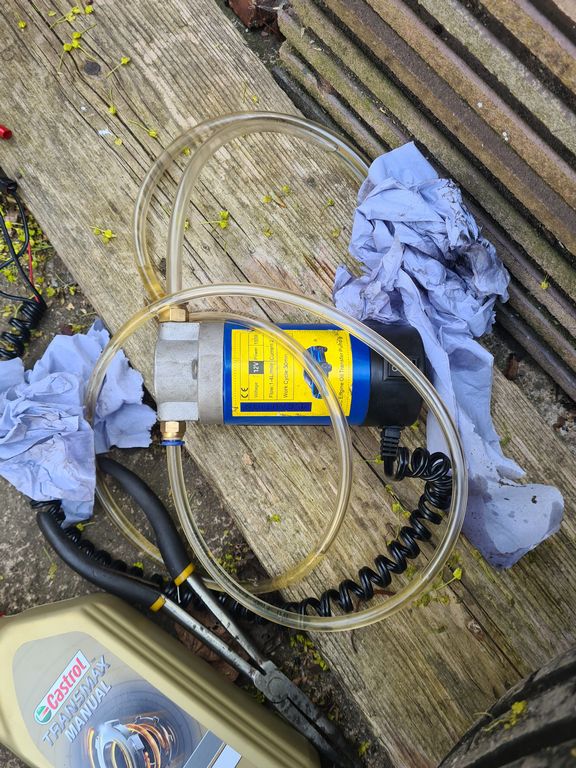

Anyway. I digress, dropped the undertray and drained the 'box oil. Fairly simple. Used my pump to pump in the prescribed amount (these aren't fill-till-it-comes-out apparently, though after I filled it I could see the oil level through the hole so its about that level anyway. And if you dont have a pump for filling gearboxes you SO need one. Makes it miles easier. Was about £20 off ebay.

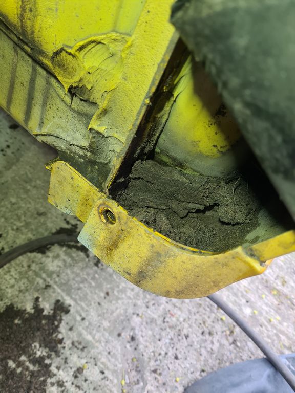

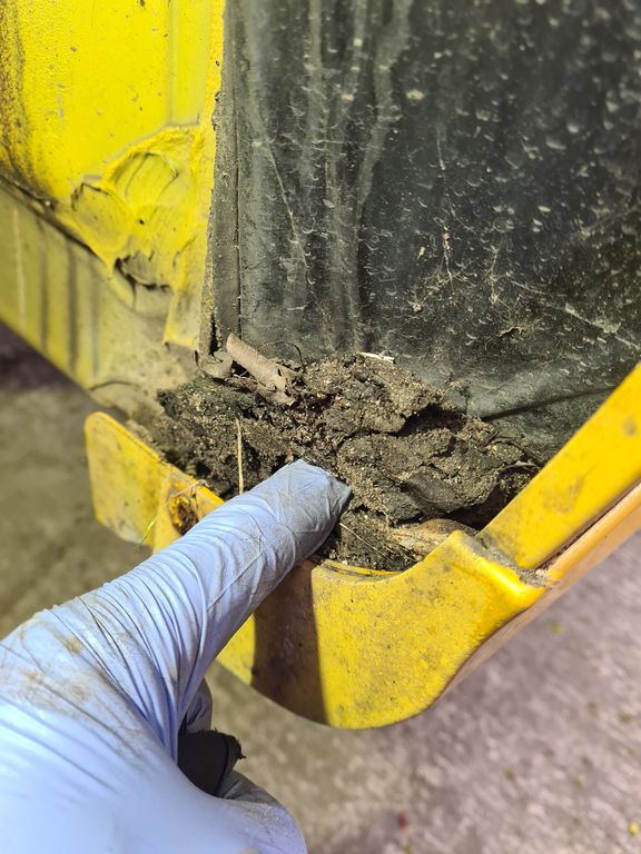

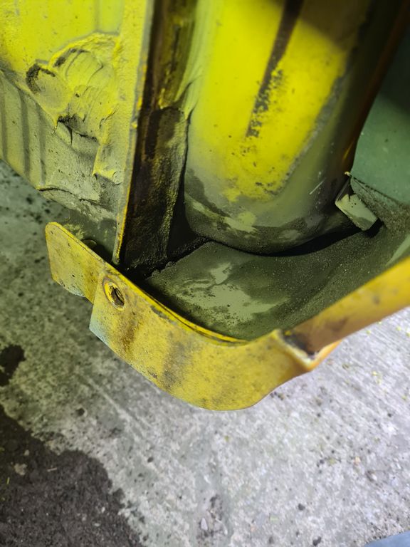

Noticed while I was under the wheel arch theres a bit of a dirt trap around the back of the arch liner.
Even under the sound deadening
Cleaned it all out, must have been half a kilo of crap in there! And damp. Glad Renault have sorted the chassis protection out, 20 years ago and that would have been a hole in the floor by now!

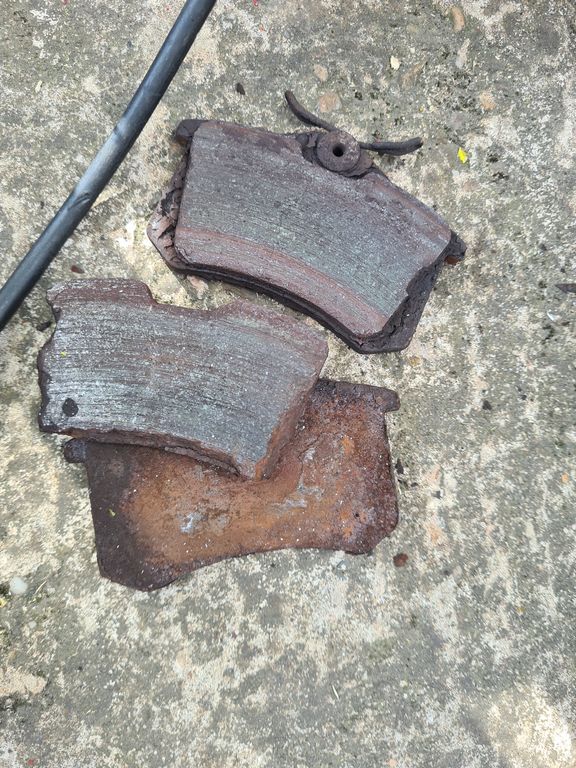

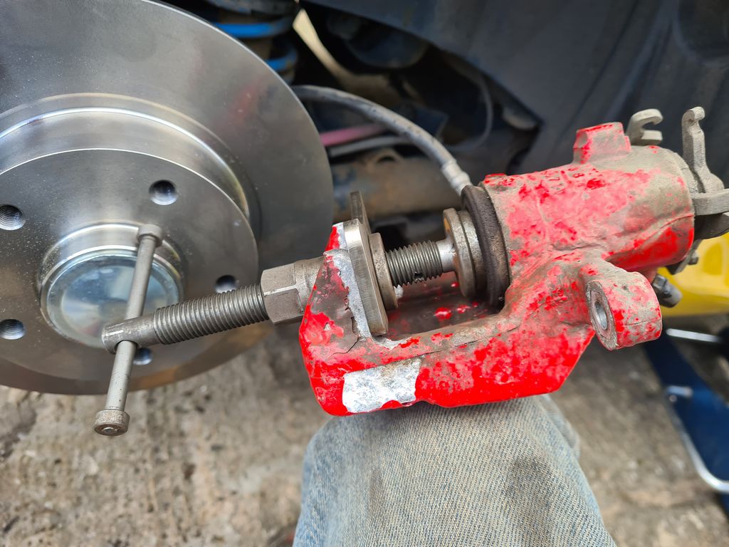

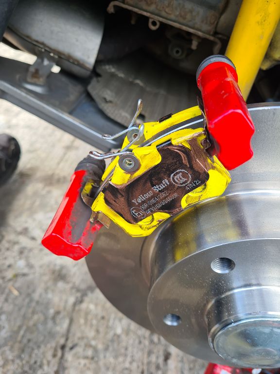

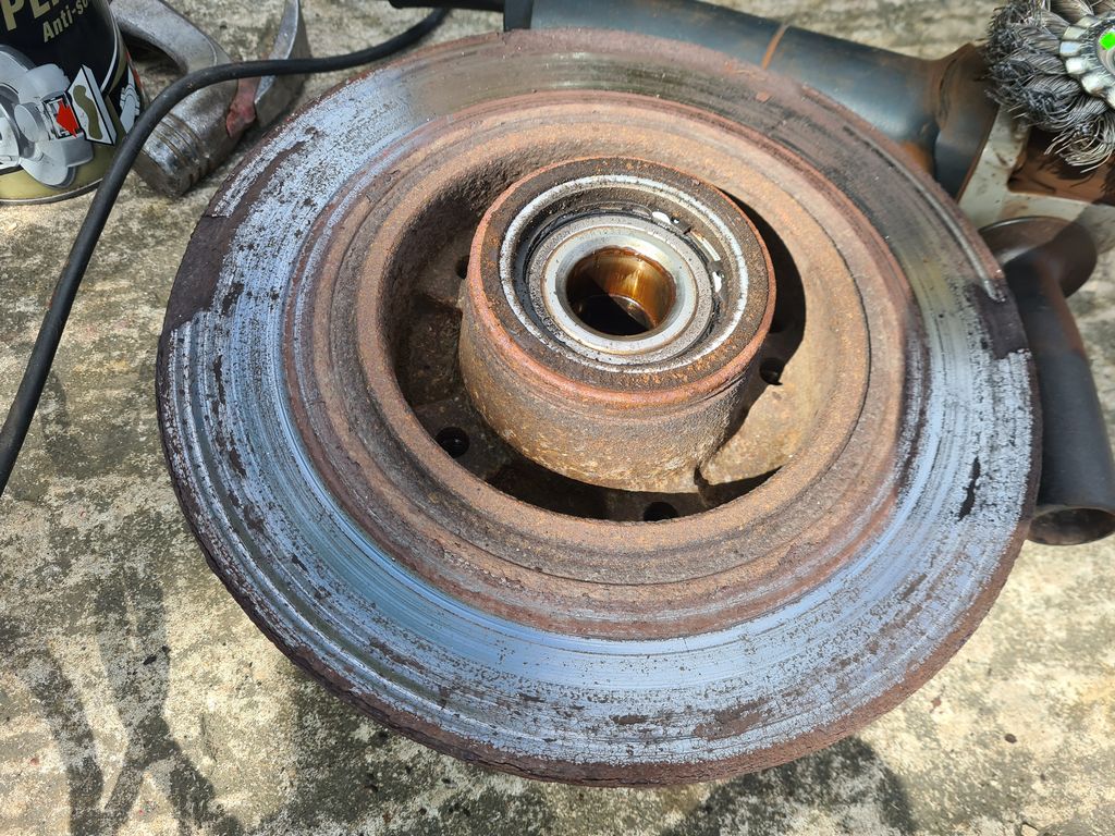

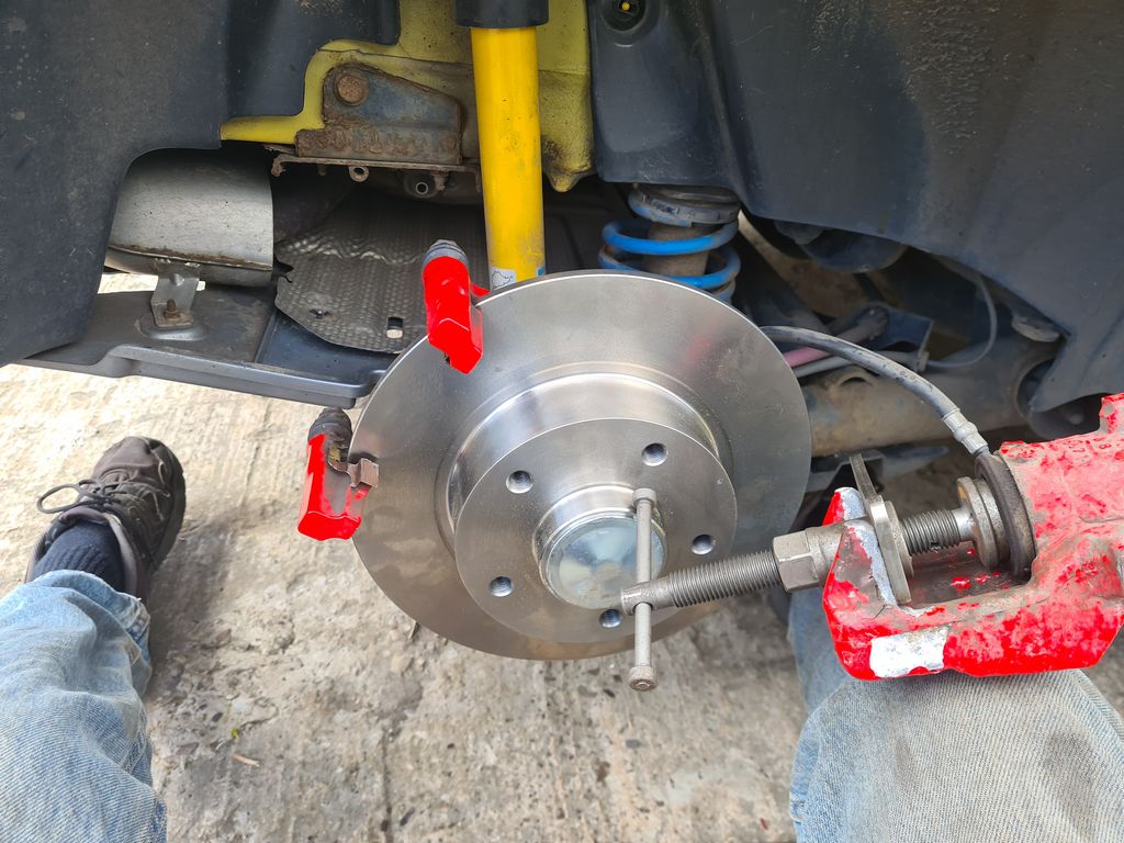

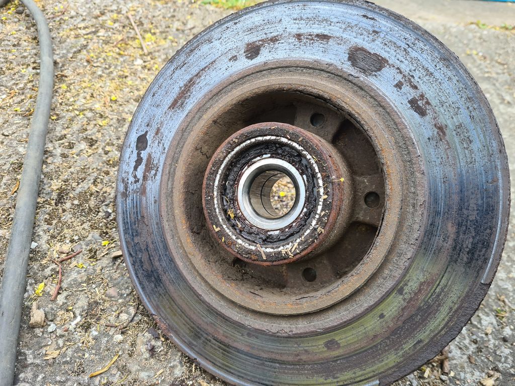

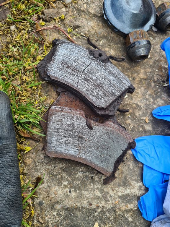

New rear brakes, the rear discs looked dicey at the last MOT on the insides so been on the list to get done.
Not good at all
Brembo discs/bearings and Yellows refitted, fairly straight forward. Caliper wind back tools rock.

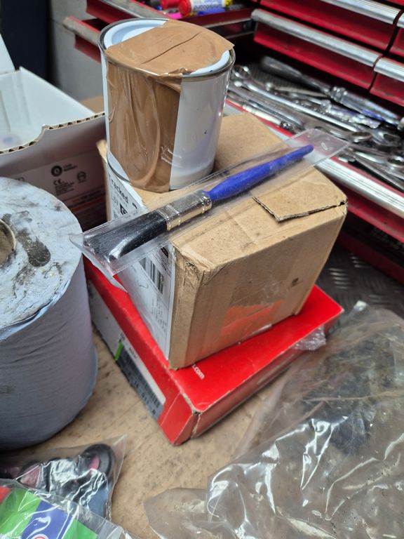

Sounds like a nightmare with the wishbones. Mine had an advisory on the mot for rust on the sump when I bought it, so I managed to get the garage to replace it for a brand new one, so a great job using the rust inhibitor.
Great progress mate! I too really fancy a 220 Clio. I really fancy a Meg 300 but I’m a tight c*** and the price for a 220 is an easier pill to swallow
Its quite common on a number of models, on my Clio V6 the side of the sump is exposed to the rear wheel arch a little and they go regularly, mine will need welding up at some point as you cant get L7X sumps any more. Daughters 0.9 did it too, also seen a number of R21 steel sumps rust through. Its just one of those things I think. Might gravitex it next time i'm under there.

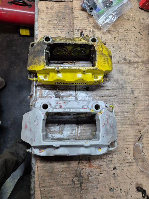

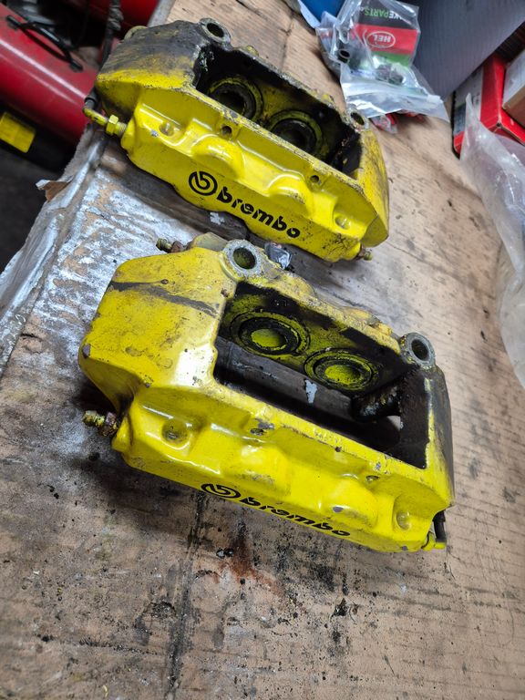

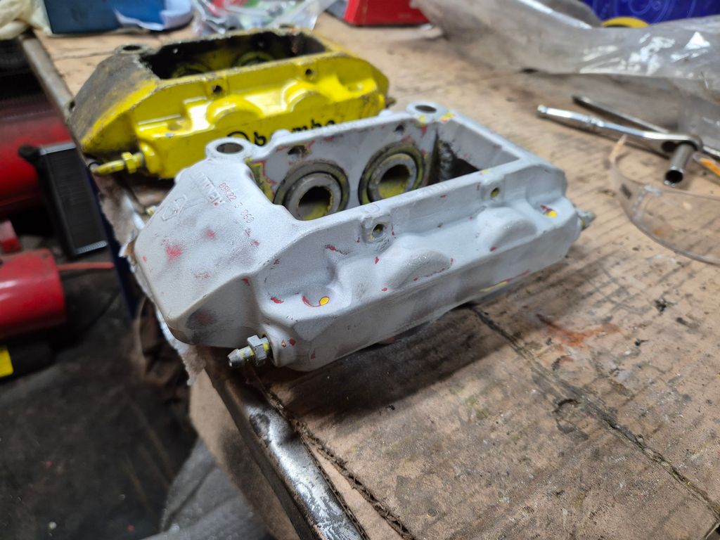

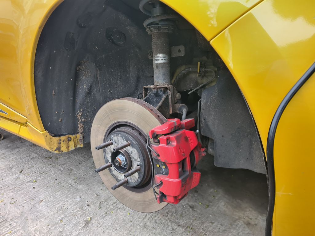

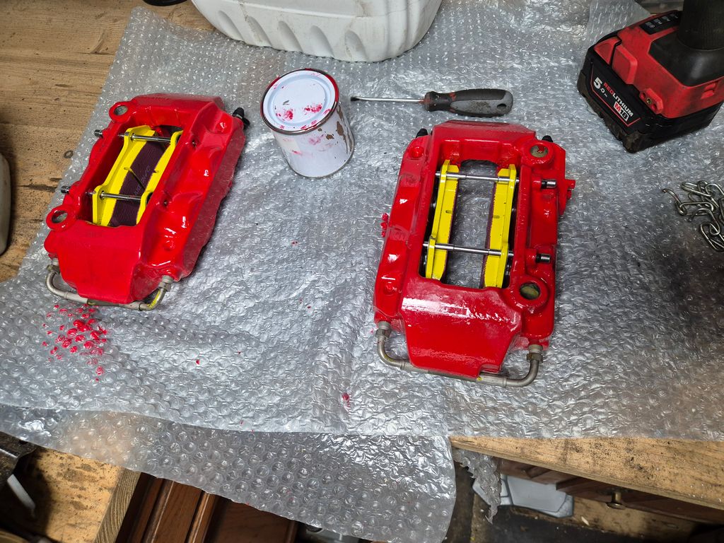

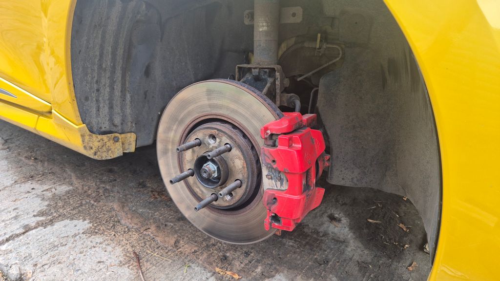

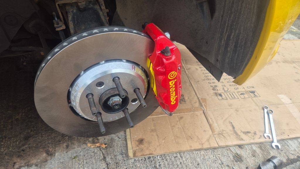

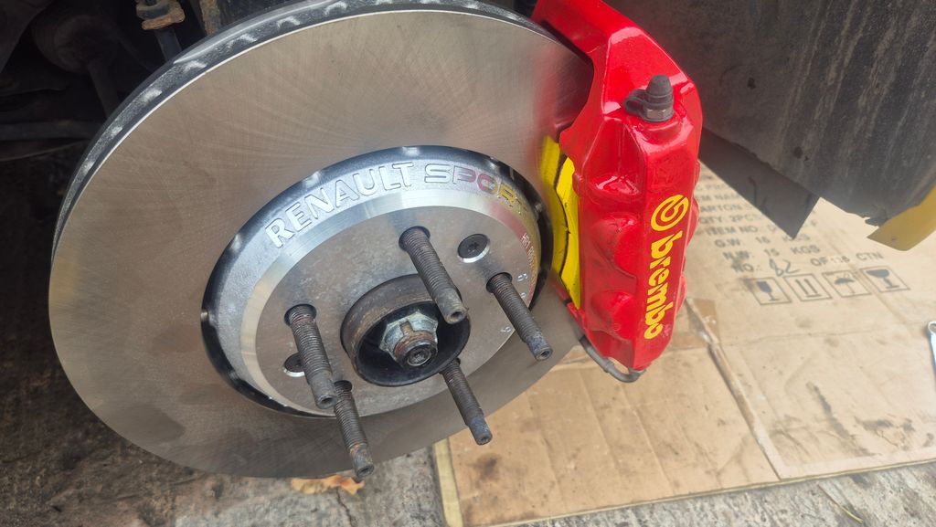

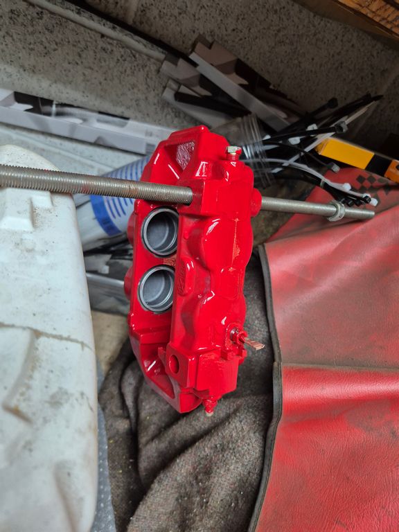

I wanted bigger discs but after months of looking for options and finding nothing cost effective I got my act together and bunged the Brembo upgrade on with RS bimetallic discs. I hoped the Meg 340mm dicsc would fit but the offset is miles wrong. Nobody does a bell/rotor unless you buy a full big brake kit. Bespoke bell/rotor was mega money.

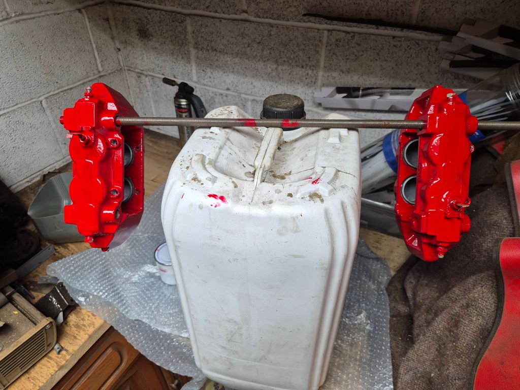

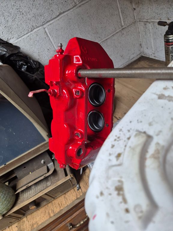

Pure hanger kit and lines I picked up for half price from an abandoned project, a pair of free calipers I refurbed myself for £100, used spacers I think were £50ish, and RS Bimetallic discs which is the only thing I paid full whack for...£380! Ouch.

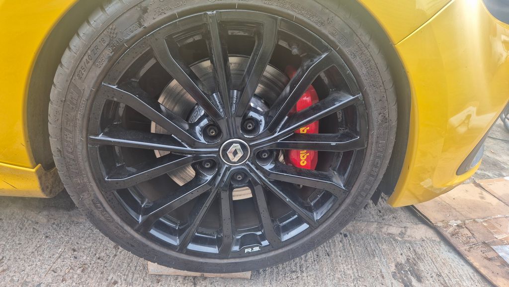

Added a set of the OE trophy wheels shod with PS4's. Didnt think the 17's would clear (but apparently they do!)
Before
After
Megane 3 Brembo calipers not fit these?
The radial mount hanger kit is made for the Meg 2 / Clio 3 calipers - i'm sure you could fit Meg 3 ones but I went with the bolt on/no faff option, I have enough projects ongoing as it is lol
