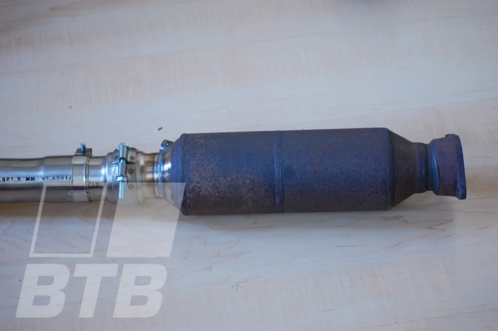

I'd get BTB to do it if I were you, their work is awesome:
yeah I've seen their work, it's awesome but they're about 2500 miles away :D
I recognise that photo ;) When did they rip that off the forum? Yeah runs great with the wider CAT exit. Joe at BTB recommends it over a Decat. Might make it a bit more boomy, but not much if you're already running a 2.5" centre section anyway.
