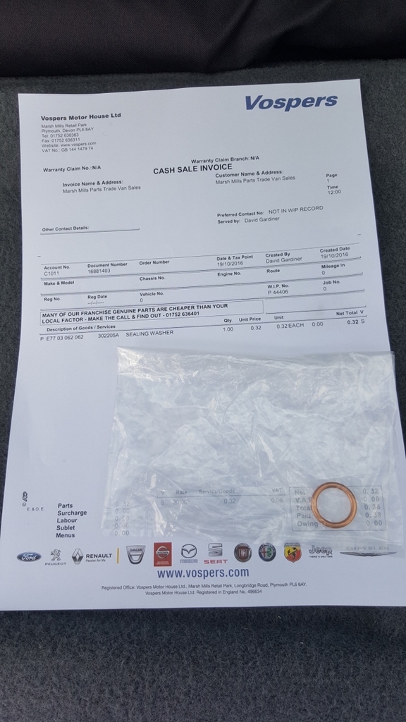

Ok great cheers @Budgie , I had a brand new Renault exchange box fitted 12 months ago and planned changing the oil every 12 months anyway...:up: So i definitely don't need any other bits...?!
Nope, an hours work. nice and simple.
You could replace the hub nuts if you want it to be proper spot on, but no real need if the old ones come off cleanly.
One of these
