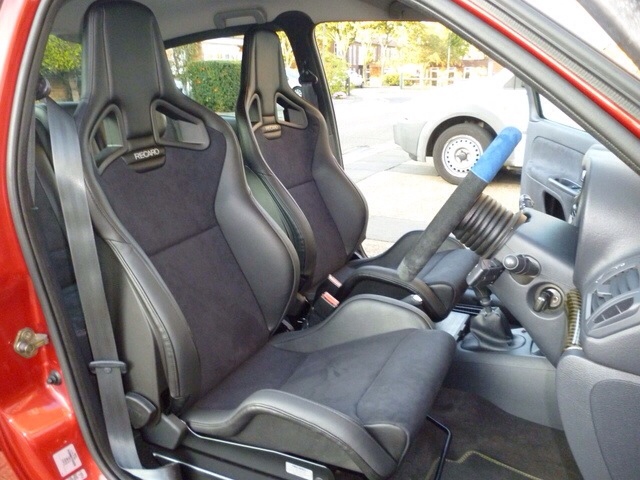

The seats Steve used in my flamer were straight from capital seating with correct frames for 172. Weather the ones in 197 are different or not.
They look good! they'll come straight from my 200 to the 172

Clio 200 and 197 seats do not fit
you have to fabricate rails
my ones were from c.seating 1.7k with
the frames for a clio 172

Am I right in assuming that if u get subframes from Capital u will be able to fit the 200 Recaro's in a 172?
Colt the Recaros from the 197/200 have a height adjustable mechanism in the frame so they sit too high to physically fit in the 172/182 cabin. By the time you have butchered the Clio197/200 frames (making them unsellable), then paid Capital Seating for custom frames for a 172 fitment you will be no better off/saved any money compared with just selling the Clio197/200 Recaros for £££ and sourcing a non-Renault pair with frames from Capital Seating in the first place.
