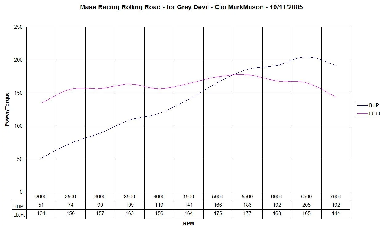

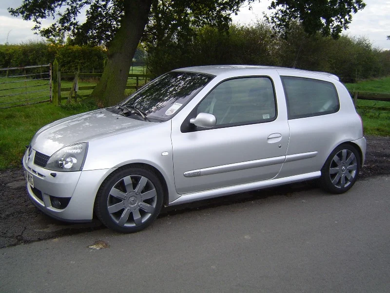

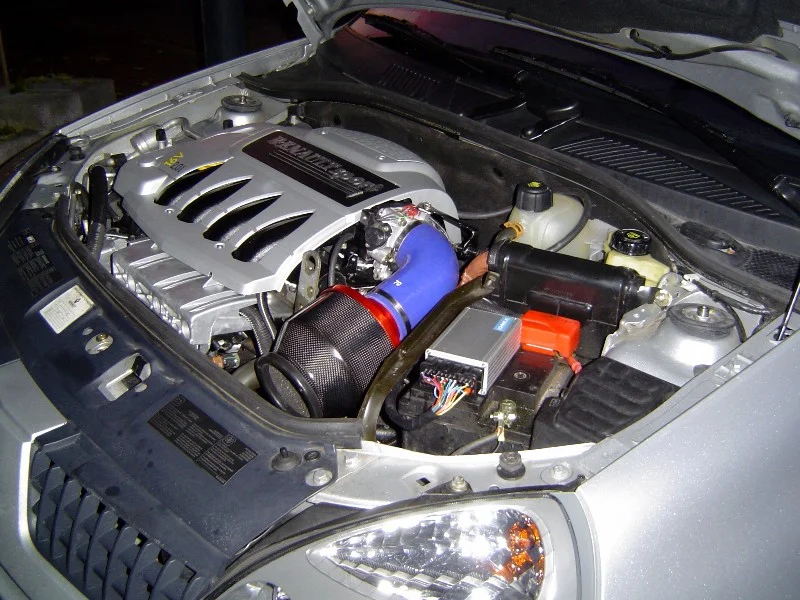

Heres mine,
Work done by GDI/AWT, exhaust by MIJPerformance.
205bhp, 177lb/ft.
Spec is,
AWT billet cams
AWT stage 1 manifold
OMEX 600
172 ph1 cable throttle body
viper
sports cat
2.5" custom single exit exhaust
silicone bend
Leda coilovers

Sweet guys.....hey markm what have you had her up to with the mods on? Who is AWT and how far are ther from Brum? Love the engine bay man....sweet sweet sweet!!
Is the throttle response that much better from the cable on the Mk1 one than the digital on the later mk's to warent a change?

its significantly better, the FBW setup is just poor.
