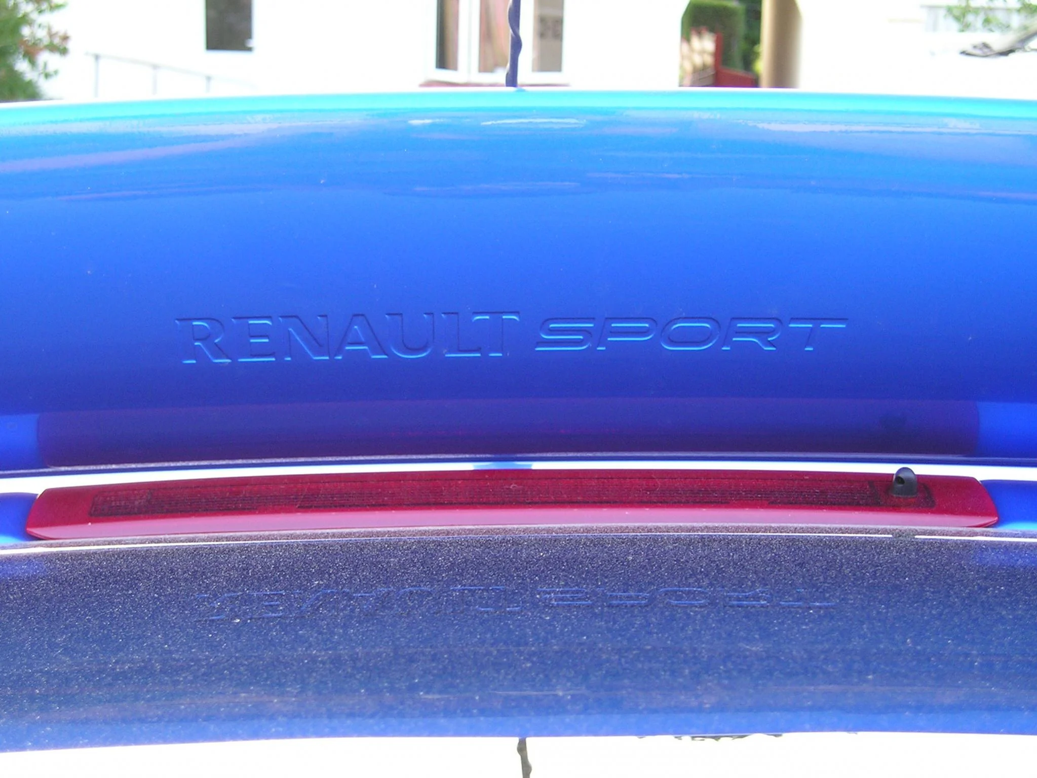

I fitted mine to my old 197 it should not touch the break light. iirc there should be two bolts and 2 self tapping screws holding it.
See attached an old pic of mine I found.

cheers mate
thats much more of a gap then mine i did tell them that that is what it neede a couple of self tappers but there come back was renault didnot supply them with some and there was no pilot holes or instructions telling them to fit some !!!!!!

When I fitted mine it had a paper template for the screw holes, its deffo one hex head bolt and one self tapper per side. I did have some pictures of when I fitted it but I can't find them.

Sounds pretty poop mate, they have mounted it in the wrong position really, they need to elongate the holes and bring the spoiler away fromt he tailgate then re-tighten.
