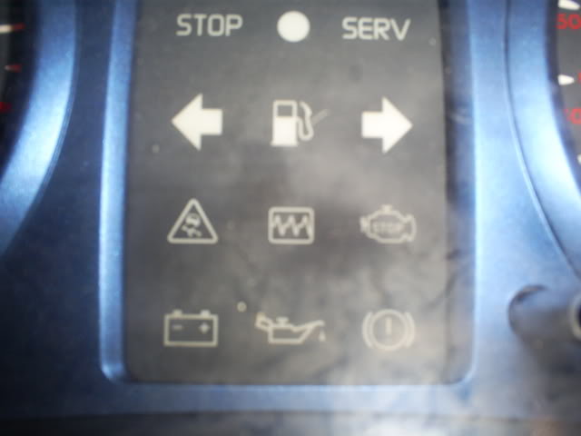

When i unplugged the multi connector the light below the petrol light came on (the light with the square and squigly line through it) and went off once throttle pedal plug was connected again ;)
Ant the revs shot up again
This is a stolen pic (from Ecka) of the light that came on when i unplugged throttle pedal multi plug connector.
The one below the petrol light.
ok this isnt helping me now :rasp: that light must mean more than one thing :(
Lol sorry mate :D
I think that light basically means theres an electrical fault somewhere when it lights up on a petrol clio and wants you to investigate it and on a diesel it means there is sommething wrong with the engine preheat (meaning the glow plugs).
I amy be wrong though :S
