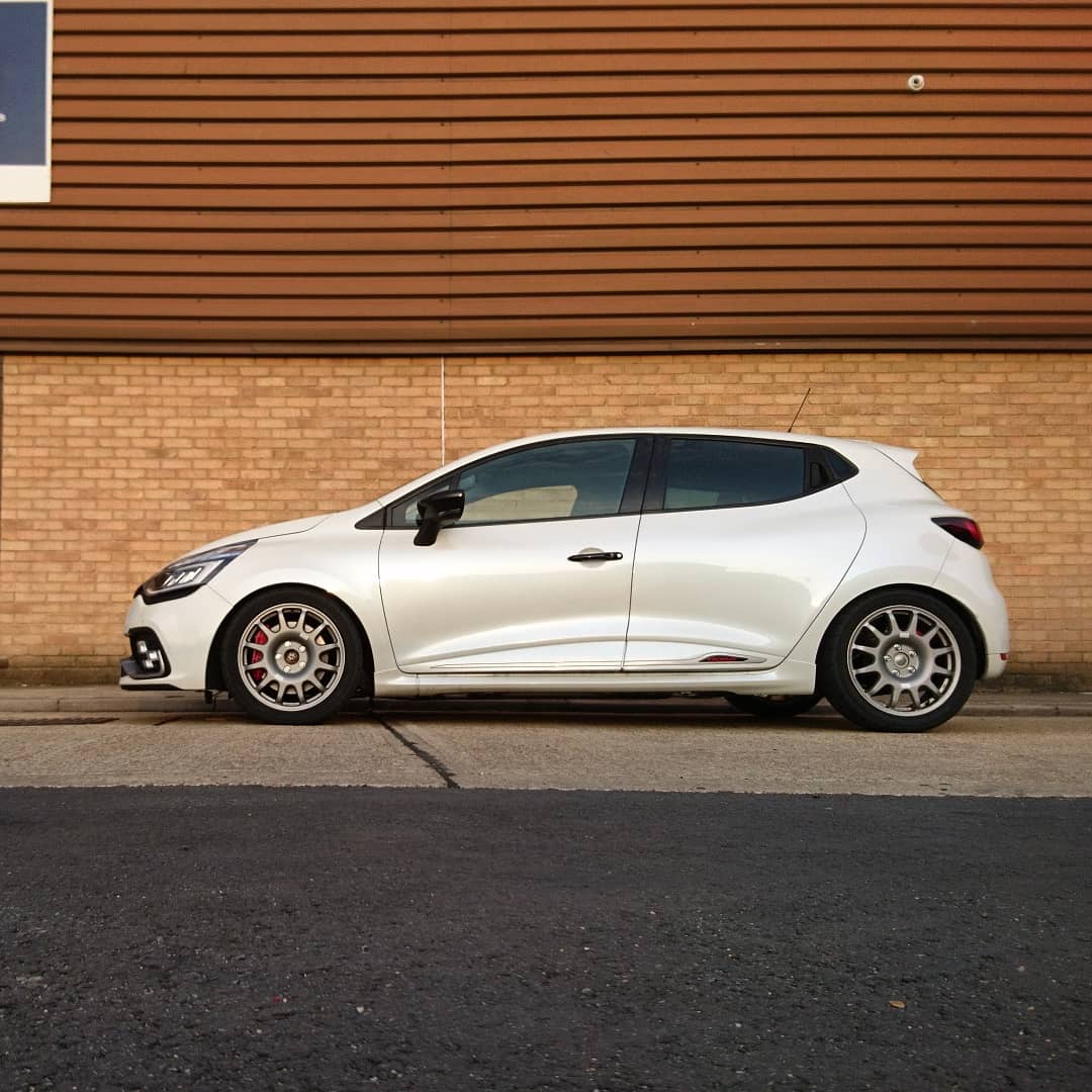

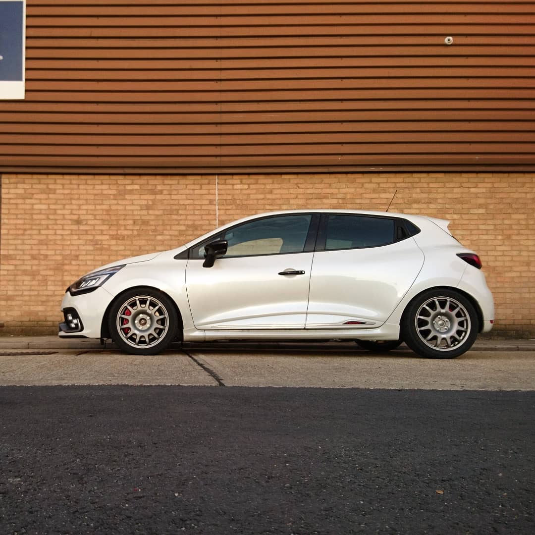

Pro Alloy is better, I had an Airtec before and it was losing too much through the intercooler. RS Tuning IMO are the go to company for mapping, I had 250hp and 260 torque, tracked it and had absolutely no problems whatsoever, however if you track it often I'd recommend the Pro Alloy radiator, and try to retain as much plastic shrouding to deflect air into and not around the rad.

Was that stage 1 or 2 that took you to 250? Was it a noticeable difference? Lovely Clio by the way!
