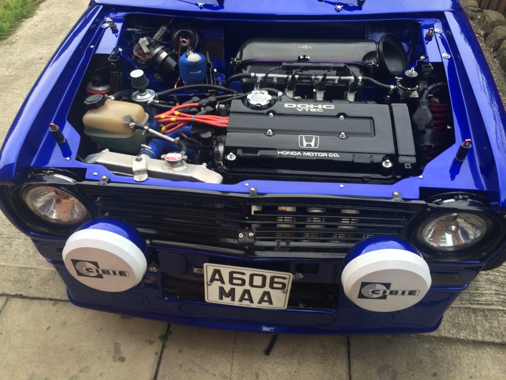

well after my second blow up i was pretty p***d off but decided to find out what my problem was and it turned out i had read the cam info wrong and basicslly set them with way to much overlap and the inlet and exhaust valves were tangling with each other :(
once i sussed that out i bought anoother engine sent it off for reboring and fit the high compression pistons again, then did my diy headwork and refit the skunk2 pro valve springs and titanium retainers and along with the stage 2 cams, with alot of help from a honda guru i got the cams dialed in correctly with the degree wheel and dti guage and needless to say they were no where near where i had set them the first 2 times.

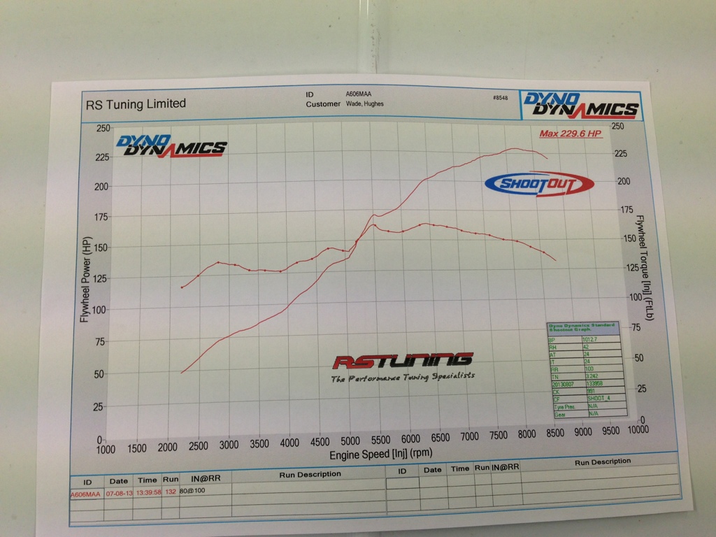

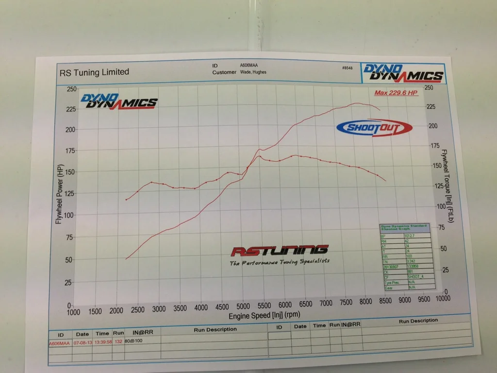

i got it running on the sunday did a few miles then paul@rs tuning did his magic again and i was more than happy with the result as it made 229.6bhp and 163ft lbs torque

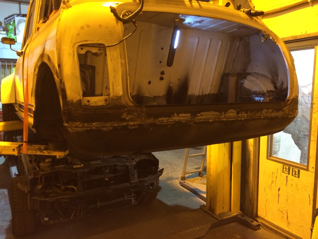

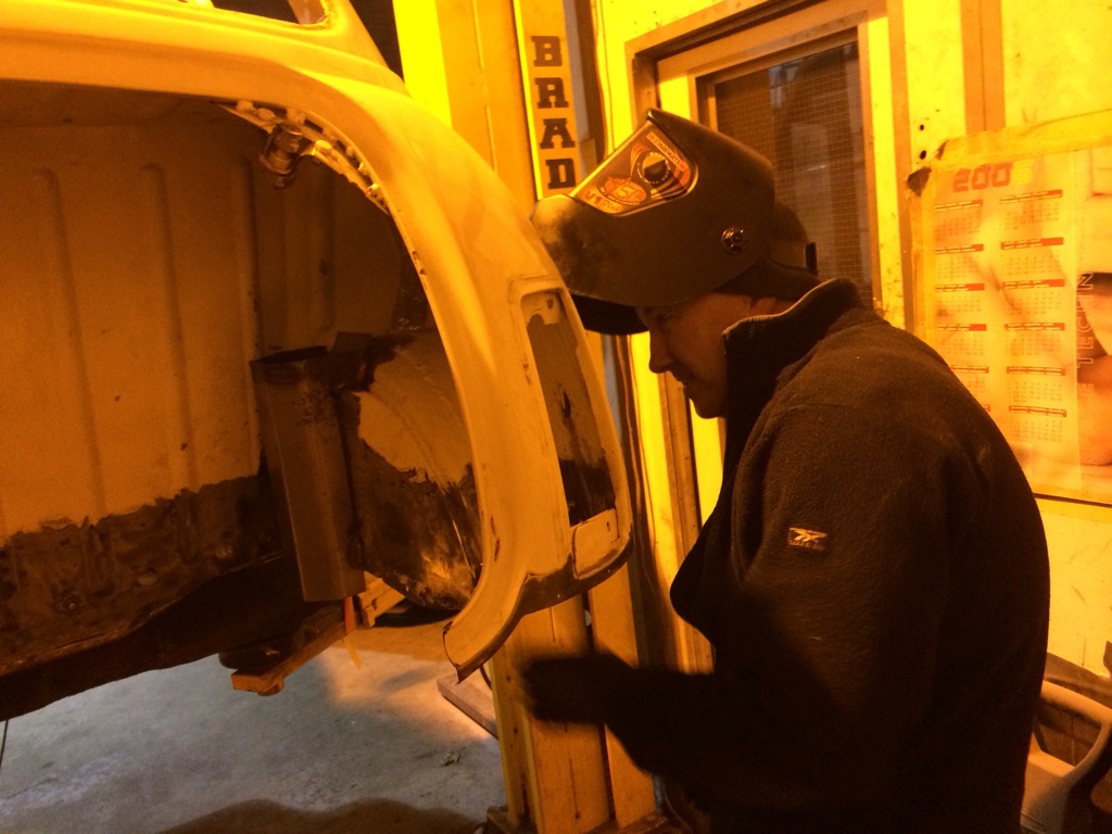

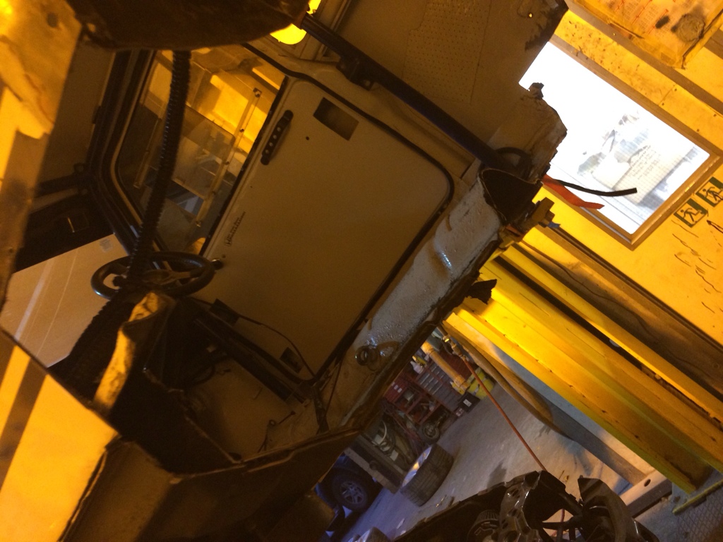

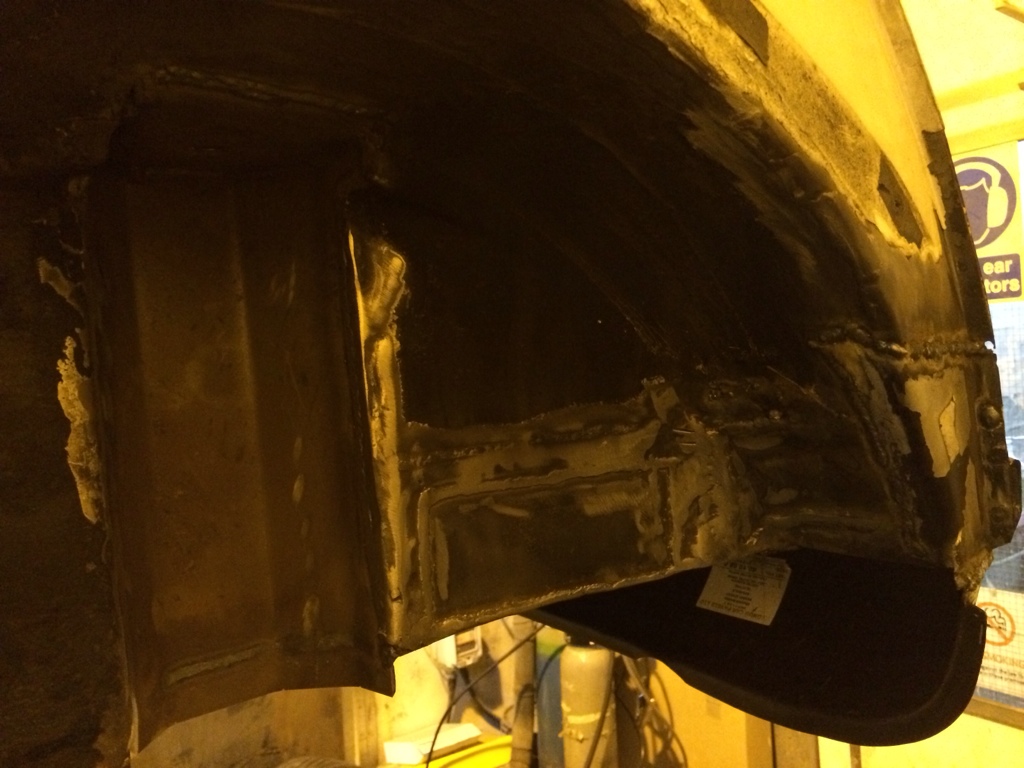

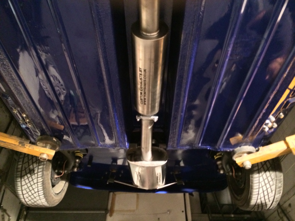

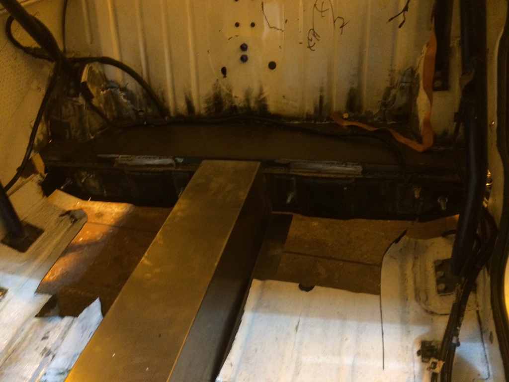

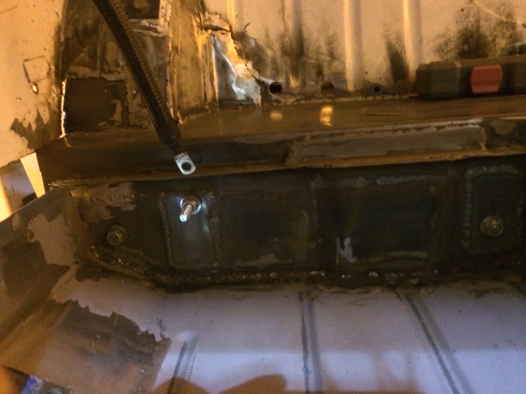

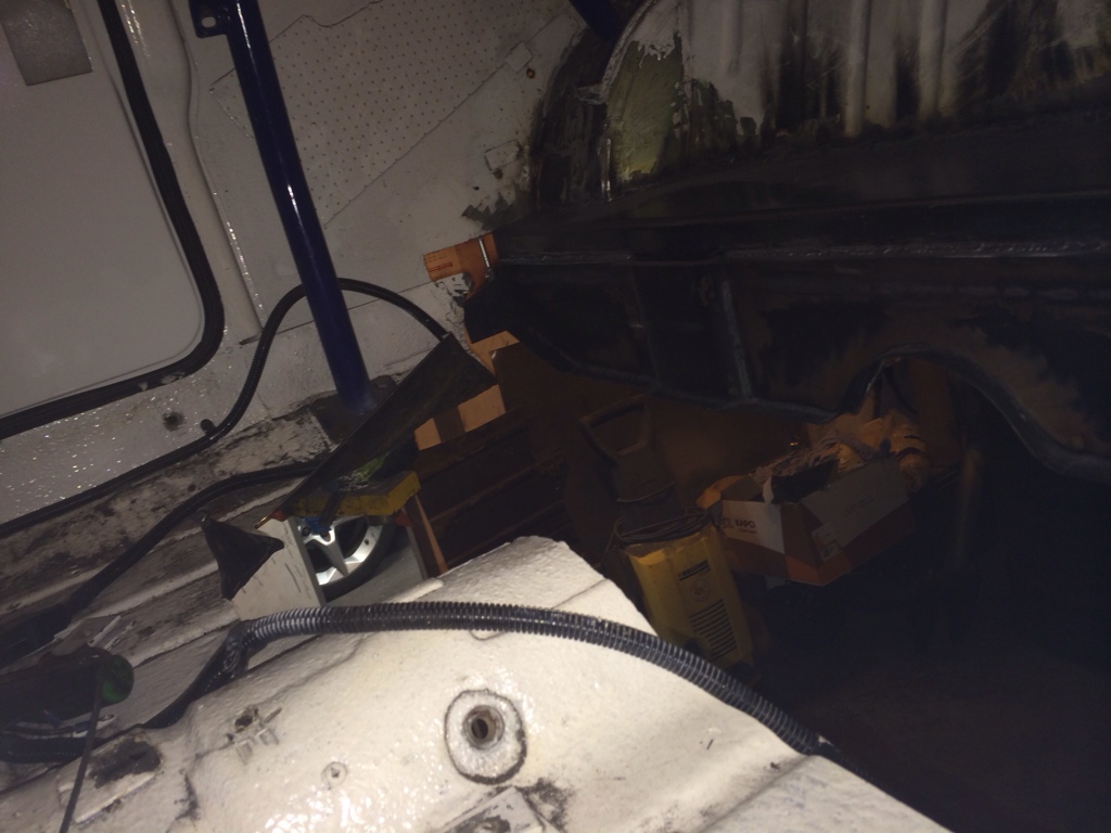

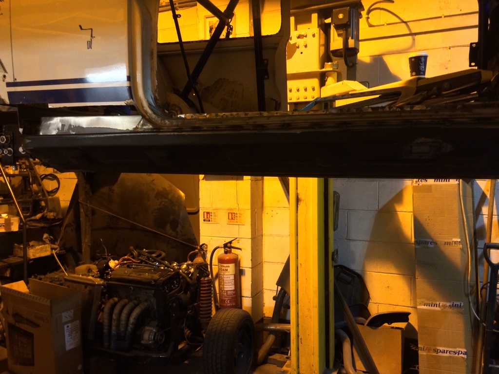

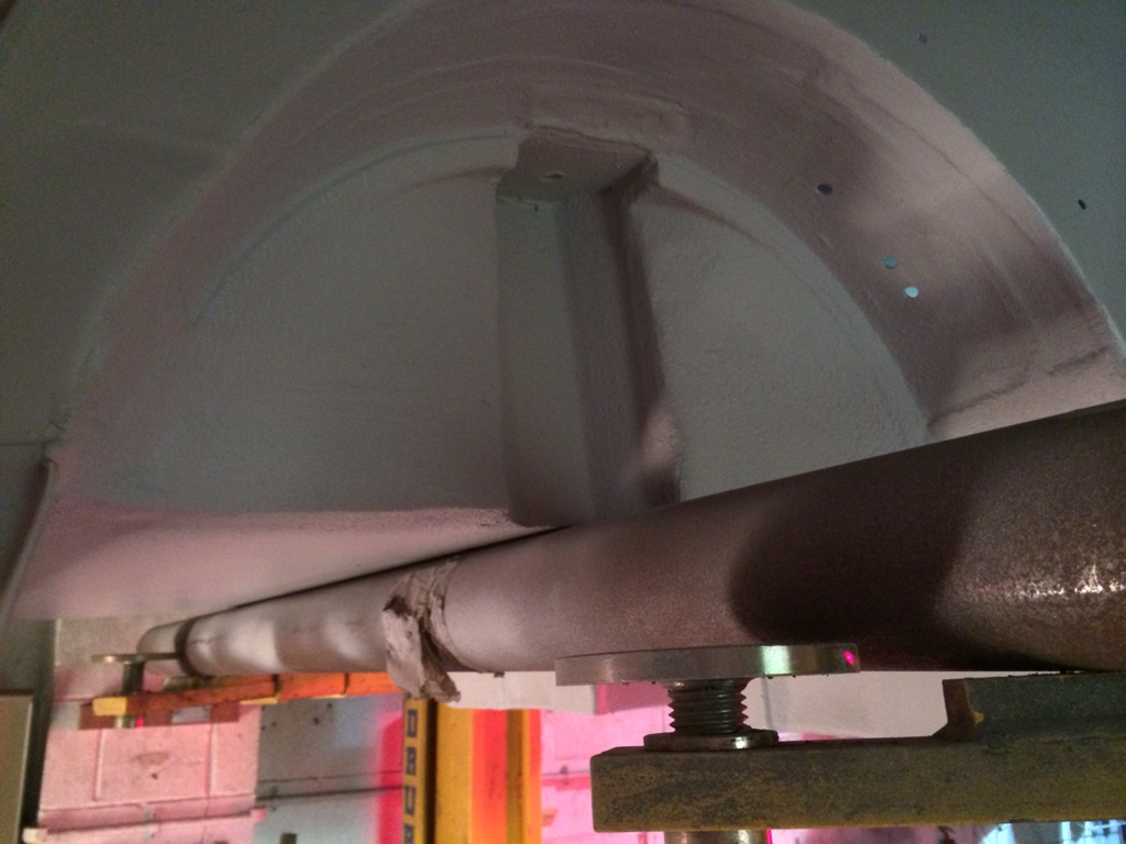

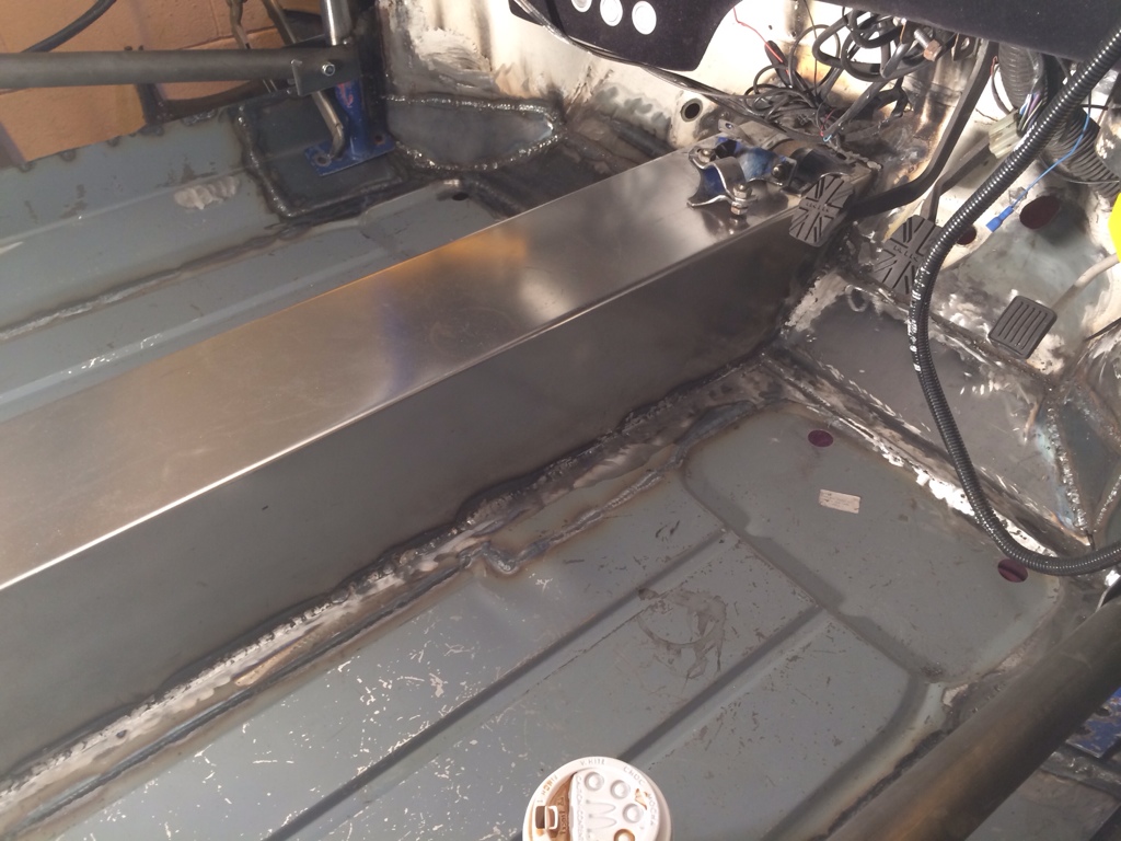

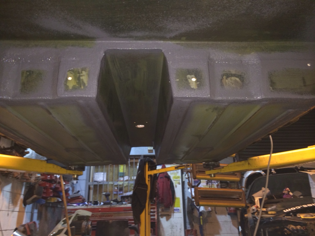

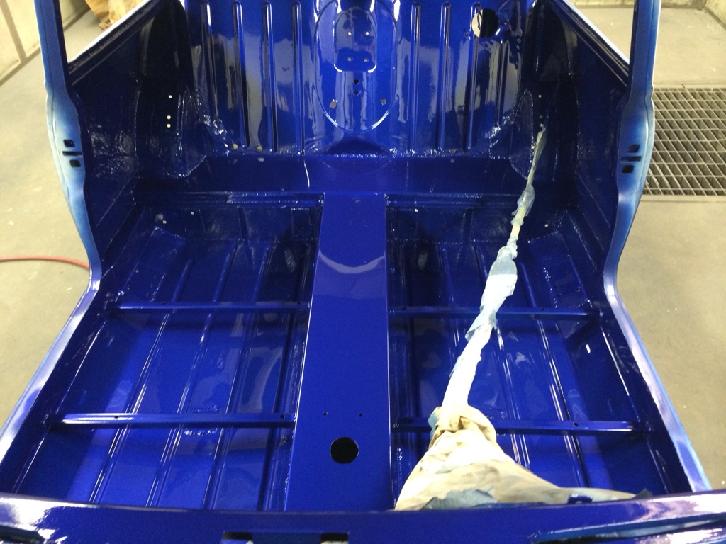

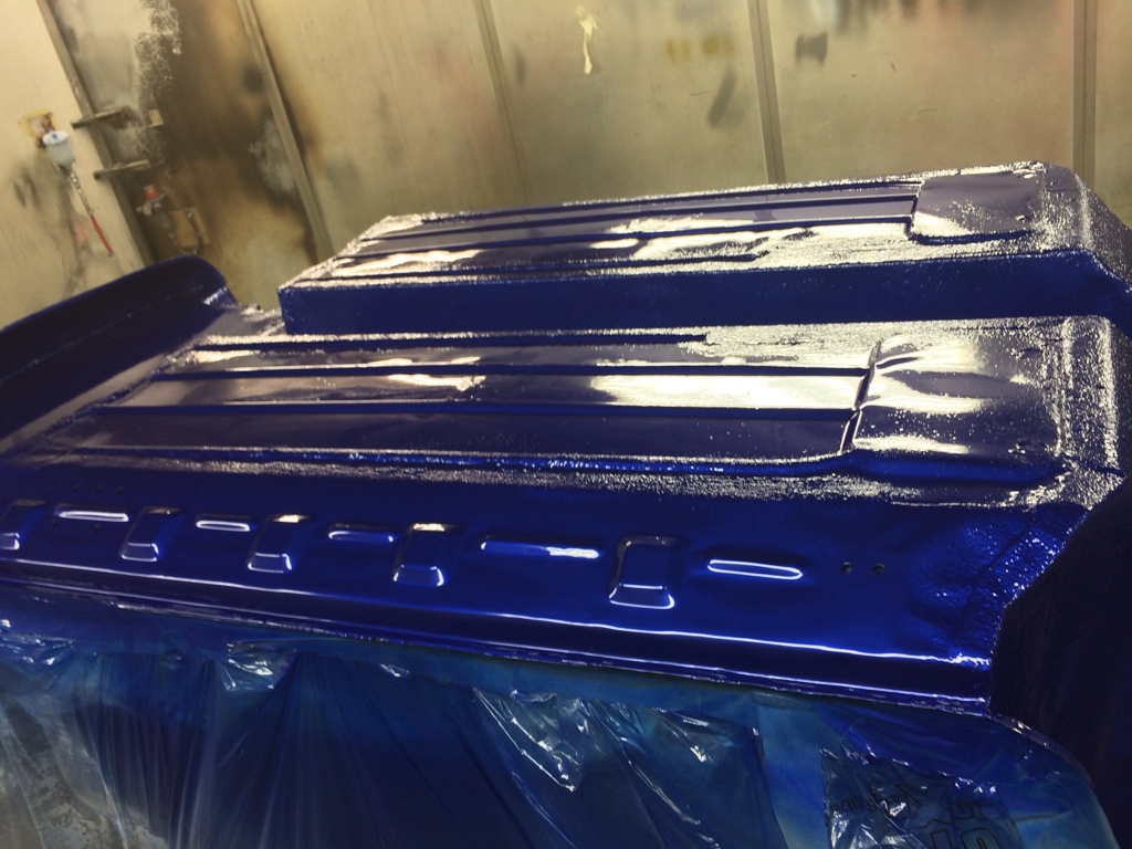

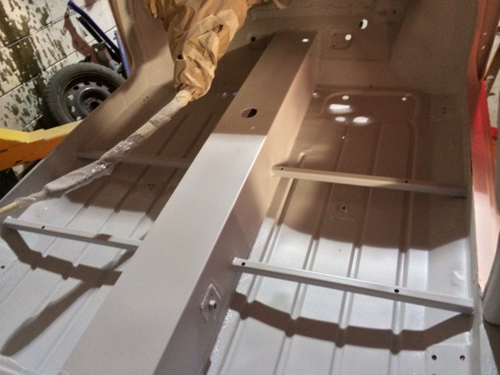

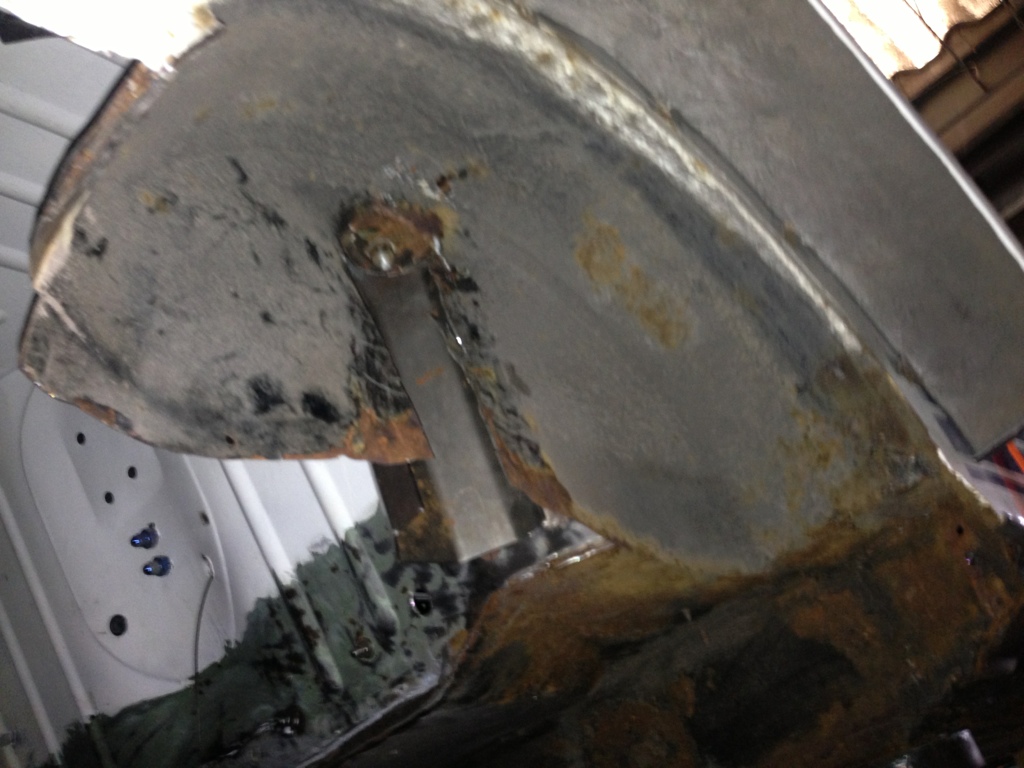

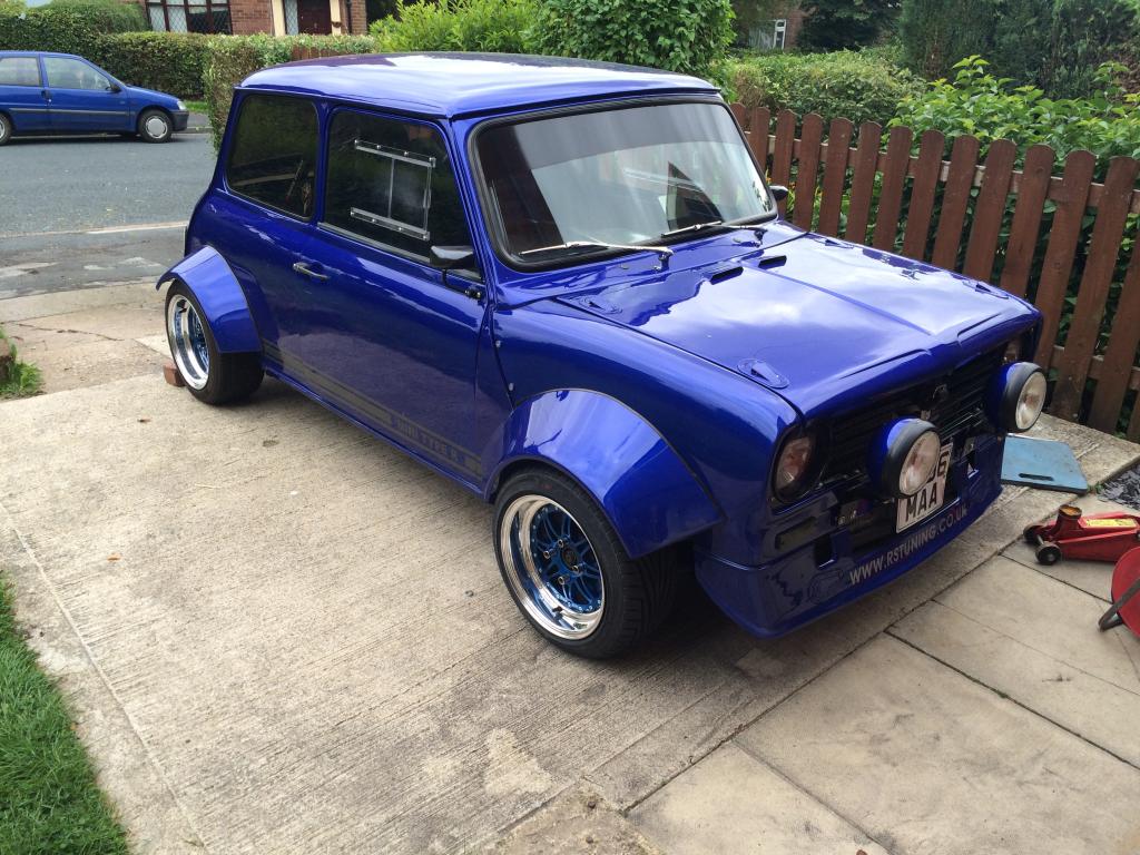

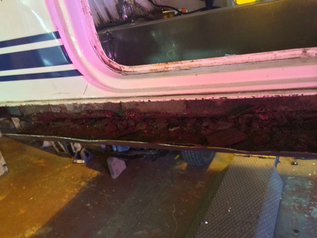

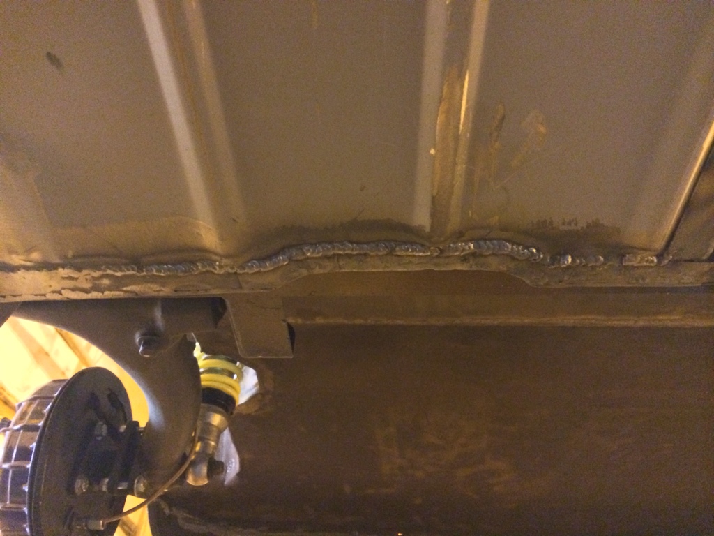

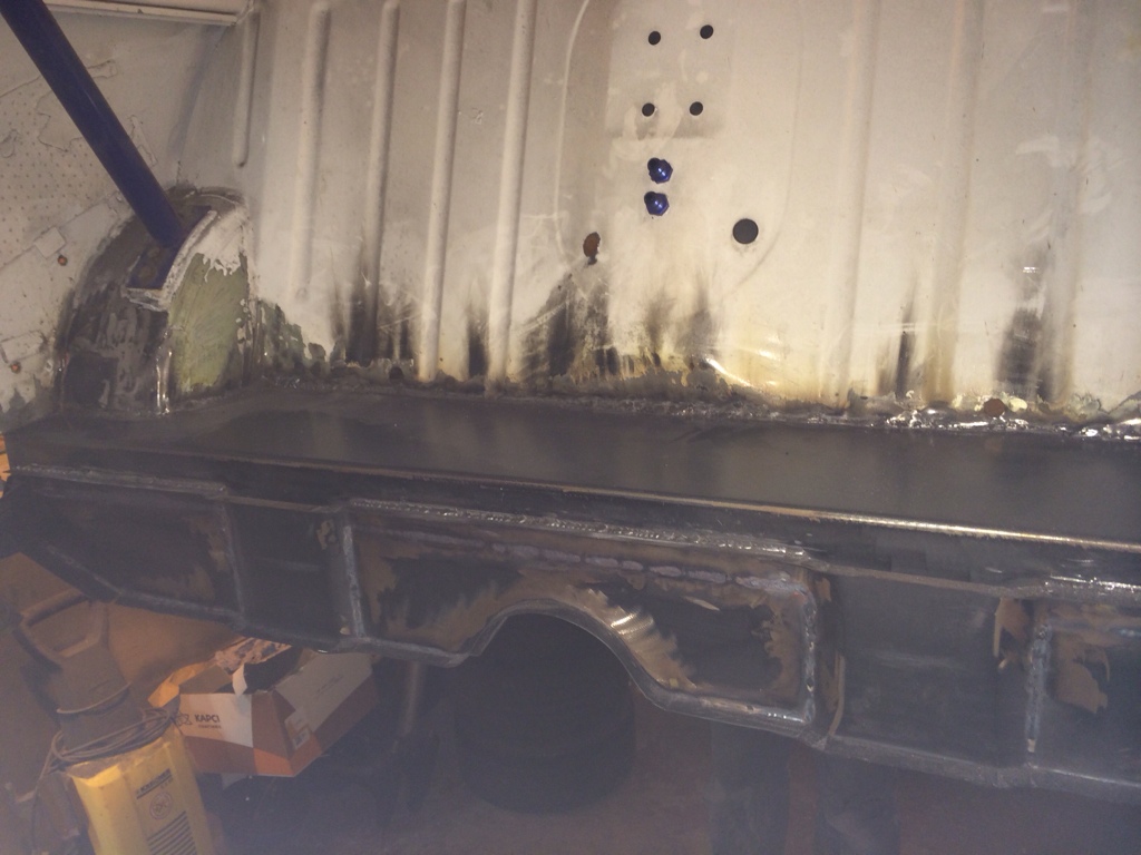

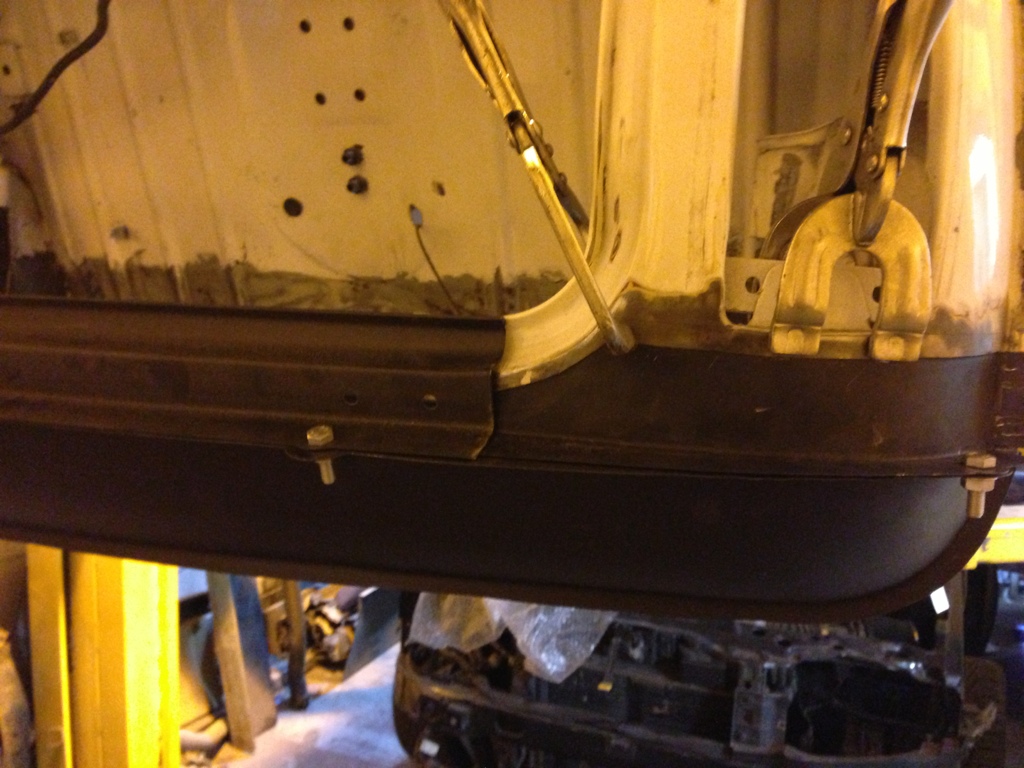

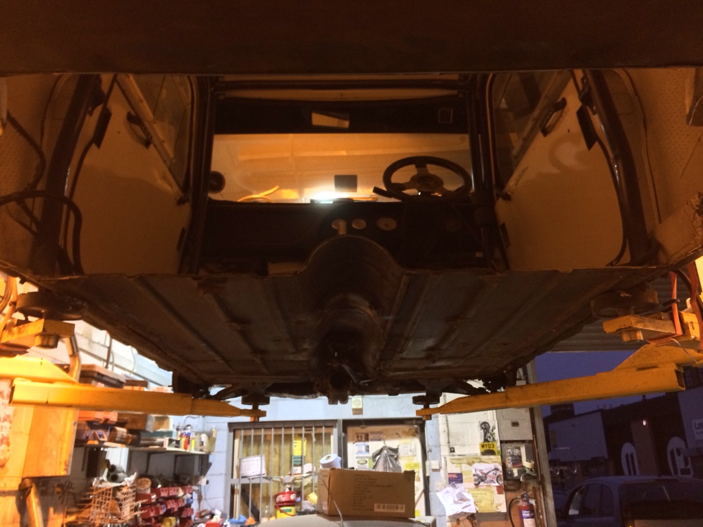

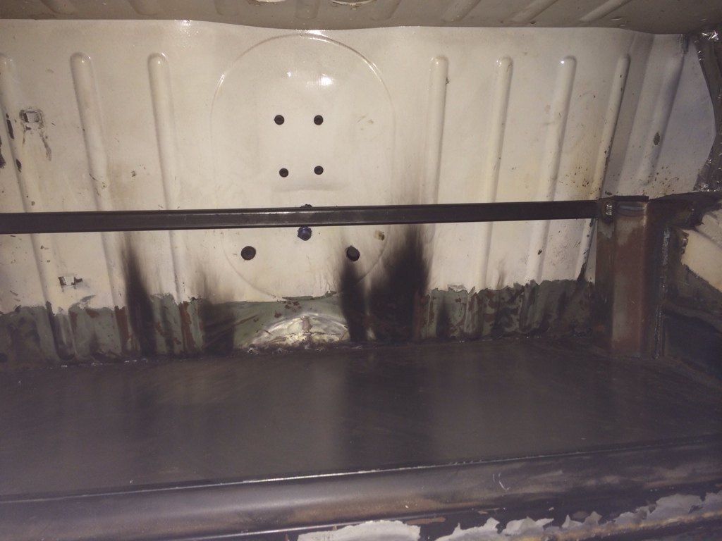

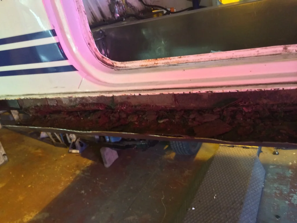

Well it's been a while since I last updated this, we took the mini off the road last year to do some minor welding only to learn it was rotten and was tearing itself to pieces, so we decided a full restoration was in order and replaced every single part of the floor,inner and outter cills, a panels, a larger stronger transmission tunnel, we strengthened all the mounting points with 2mm steel inside and outside 12" around.

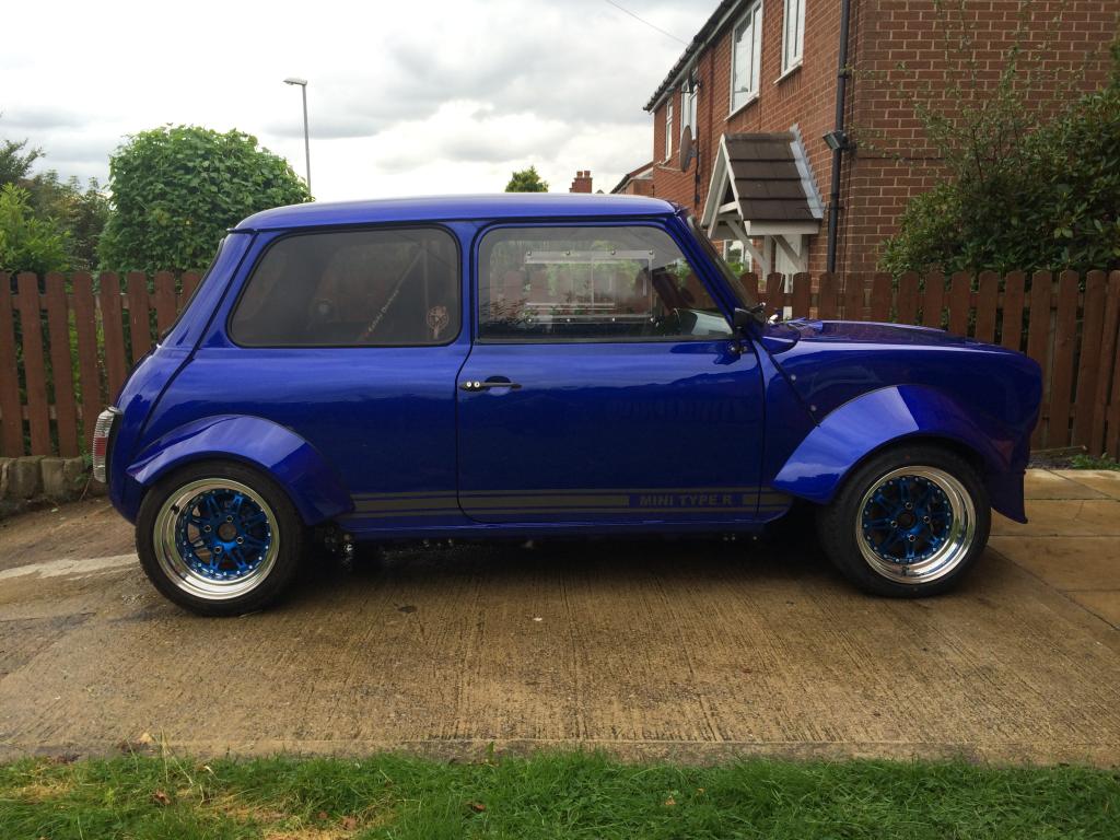

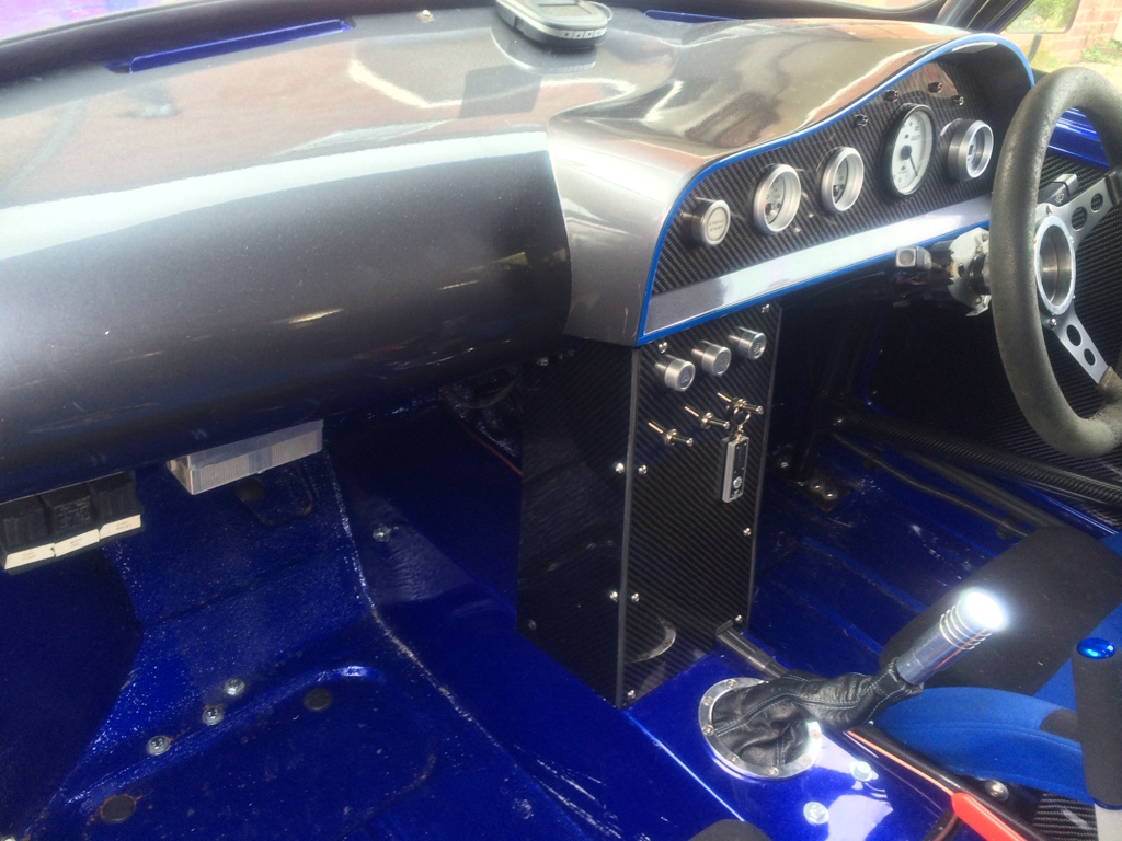

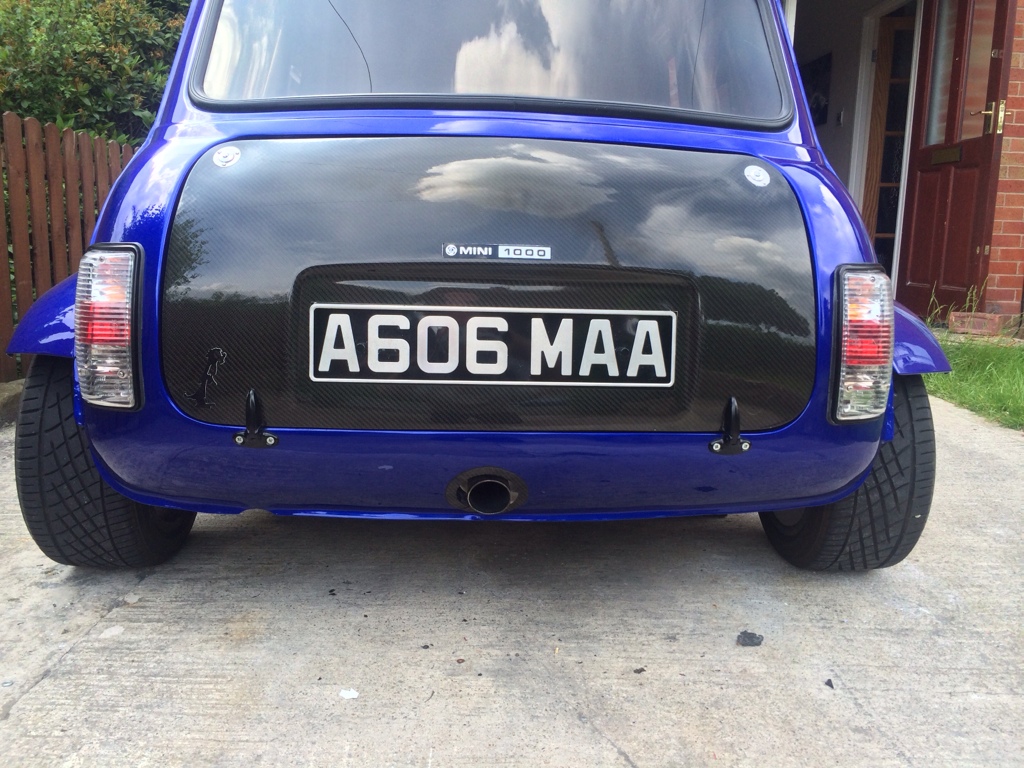

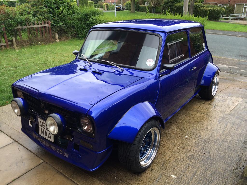

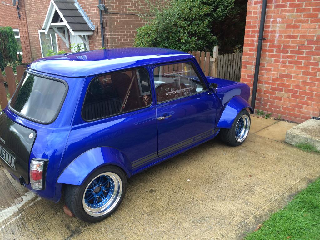

after that I decided on a colour change to Yamaha r1 blue which I think was a good choice and goes really well with the new force racing 3 piece split rim alloys :-)
hope you like
Looks stunning! Well done.
But it begs the question; didnt you/previous owner/whoever built it think to check for rot before starting all the work first time round??
The first time I built it was 3 years before hand and it wasn't bad at all but with over 5 times the power the car was designed for it didn't like it and had started to split some of the welds that hadn't been done so well ( not by us) the car wasn't as bad as I'm making it sound but I had the opertunity of the garage and the facilities so decided to take advantage of it and went to town on it.
also I drove it through winter in snow when my bmw wouldn't go anywhere lol
