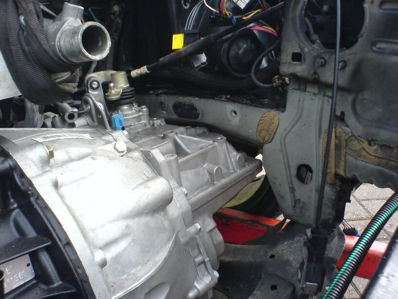

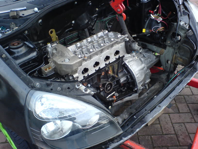

Surely tho it is a fairly possible conversion, if you are prepared for...
1) the fabrication of engine mounts ( how many, who knows, maybe fred could shed some light)
2) you may have to go standalone ECU (omex or suchlike)
3) Custom drive shafts, would you need these, i am guessing yes!
4) gearbox size - is there not a 5 speed box that would fit? (maybe from a deisel model?)
I guess the hardest part would be sourcing a 225 lump tho, as they seem rarer than rocking horse poopy!
  clio 200 F4Rt
oh and...
5) The fitment of a pedal box, or at least a clutch pedal to deal with the hydrolic clutch.

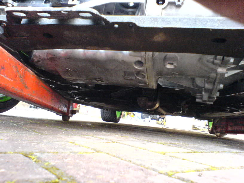

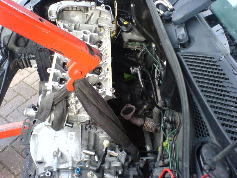

answers are as follows
1) 4 main ones, but i think it'll need 5 all in, only 1 off the shelf renault one fits the clio and the megane
2) yup OMEX
3) yup GKN motorsport custom made
4) nope only one that fits inside the engine bay is the ND0 6speed megane RS unit (its a bit tight!)
5) pedal box - yup uber sexy Tilton one (you can bodge it and do it pikey)
engine sourcing easy! MATT BLACK has 20 of them brand new for £1500 + VAT (new gearbox is £750 + VAT IIRC)

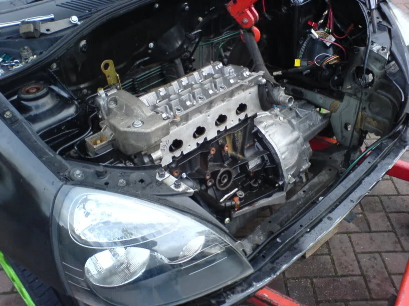

i see that top left hand mount fits.
i pressume thats the only one?
did that mount come with the engine, or is it from the original engine?

Originally the car was a 1.2 the mounts probaly one of the mounts Fred had lieing round. The 1.2 mounts are different than that one.

thats a 172/182 mount, the ONLY one thats the same/fits

are the rest of the mounts on a 1.2 the same as the 172/182?
certanly looks like an interesting conversion (from a mechanical problem solving point of view)
  Lionel Richie
no the 1.2 mounts are different, but they use the same chassis fixing points as the 172/182 (hence why you can drop the 172 engine in with no problems!)

u tried the turbo and exhaust manifold on there?
enough clearence between bulk head and block?
what sort of intercooler you planniong on using?
