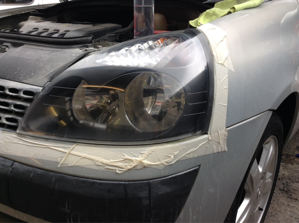

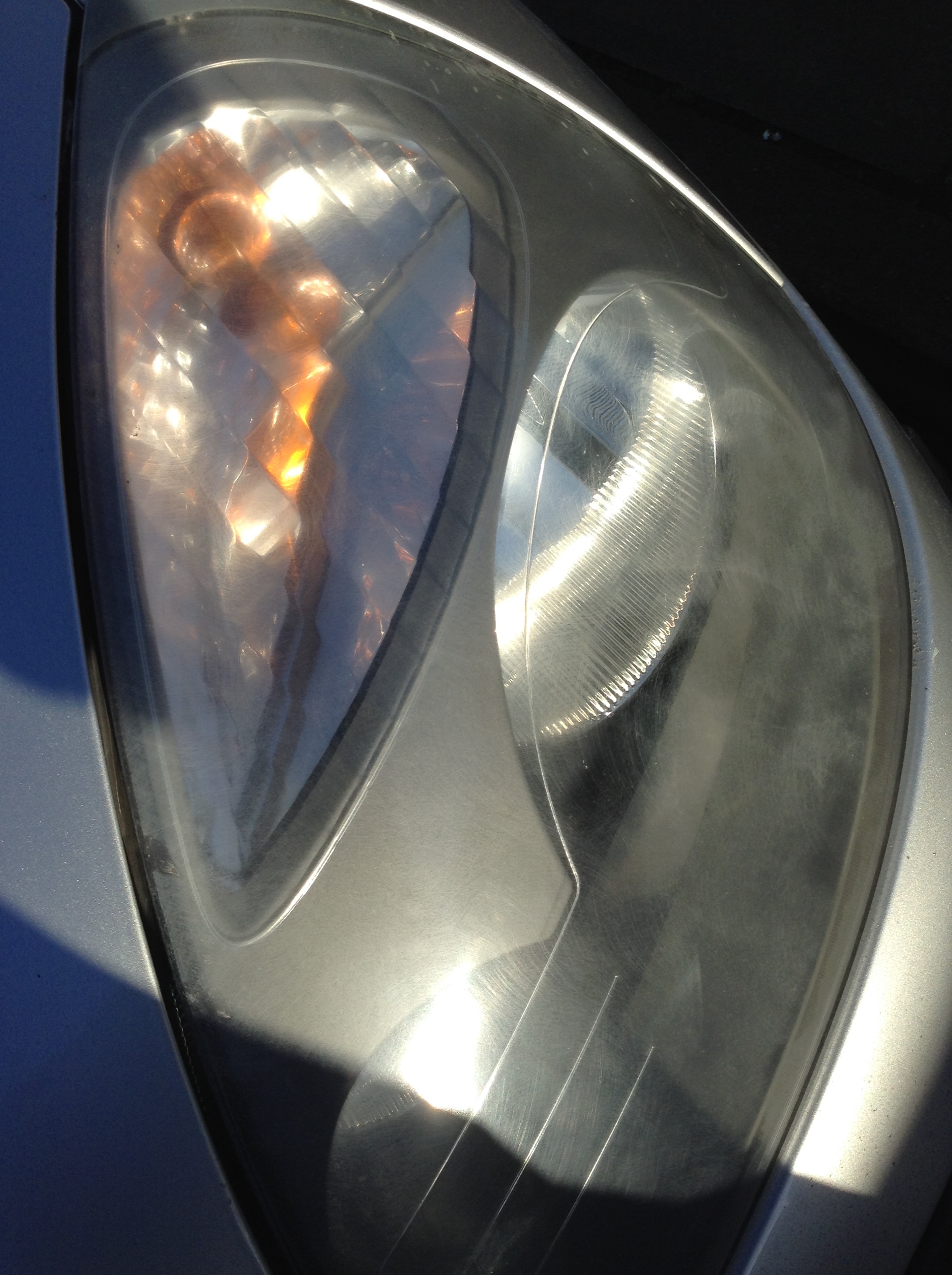

Can someone pls tell me what i did wrong i followed all the instructions luckily i have an other kit so i can have another go but want to know what i did wrong first??

You haven't done it properly
Not used the paper for long enough then not used the pase for long enough

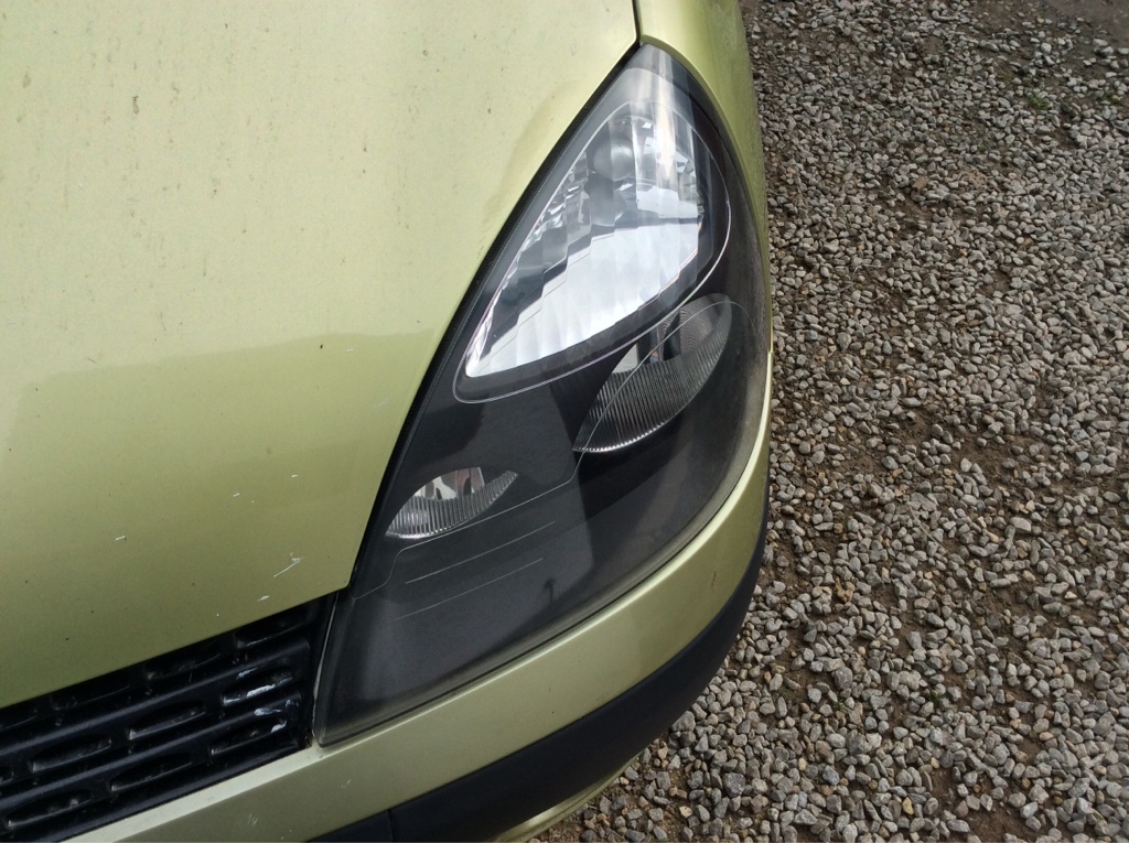

I don't know what's int he kit but as I used to do these by the boat load, I've a pretty good idea where you went wrong...
You either went too hard on the first stage, or didn't spend enough time on the refining stage. You need to take your time with this as the plastic gets very hot and scratches easily. I found that using plenty of water helps loads.
A couple of my efforts to show anything is possible!

Looks like it needs to be worked a LOT more with a high grade paper, and then polished

i used a drill and spent about 2 hours doing both lights, i does say usedlight to medium force is that right?

So what are we saying just go at it will all i've got ?? Bit of a wuss don't wanna make them worse :/
How long did u spend on it?

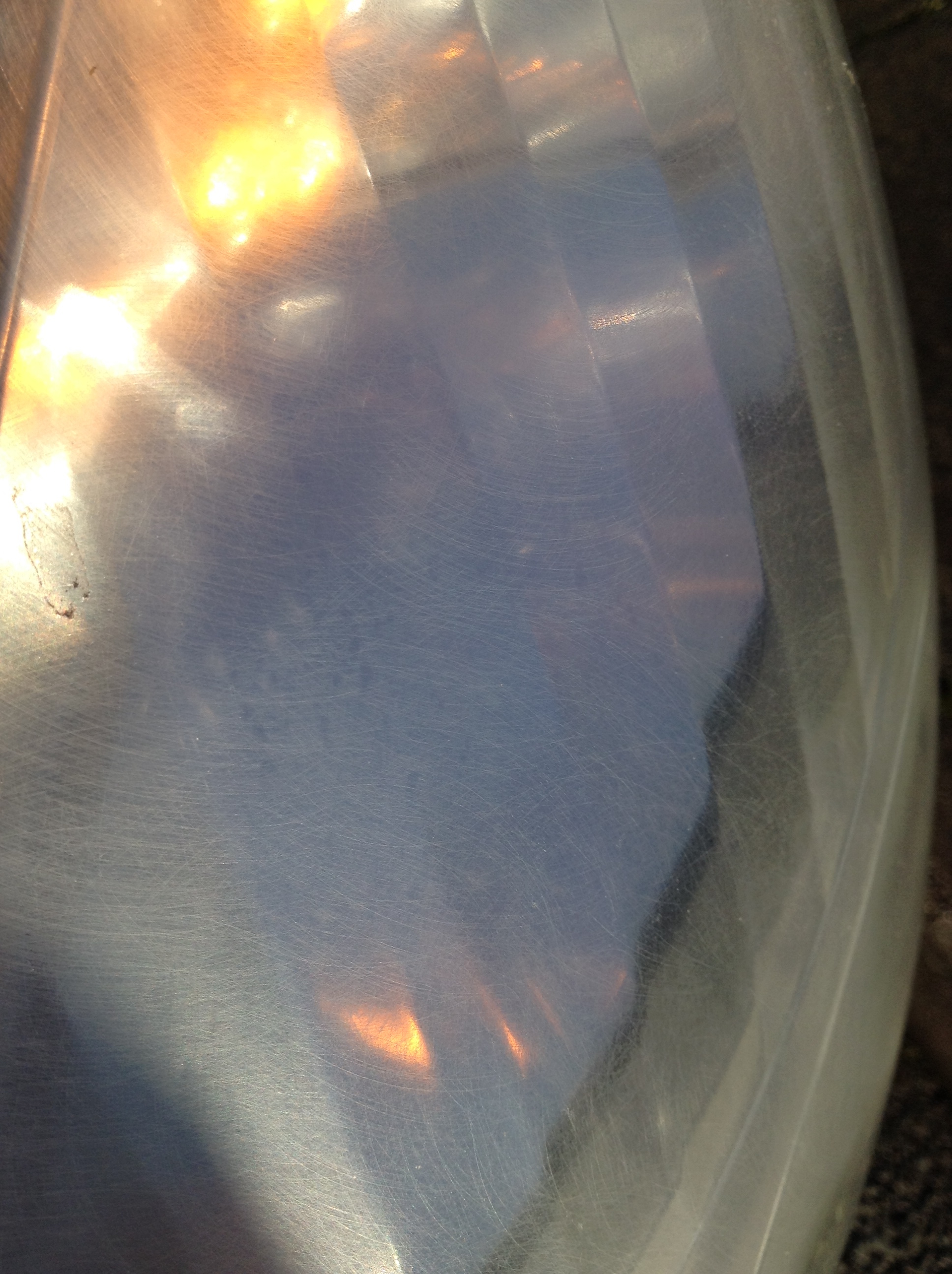

If it helps I use 1200, 1500, 2000 then polish with G3 scratch remover.
You can go up further through the grades if you like.
Never thought of G3 have some might try it before having another go tbh

500 and 800 are ridiculously over kill and 800-3000 is far to big of a jump.
G3 Scratch remover is my go to sanding mark remover though.
So if i give G3 a good use i might maybe get away without having to re-do??

500??! Unless you're sanding down brake calipers, leave that in the garden shed. Jesus!
  clio 172 cup
give it a good rub down with 2000 and then the g3 should bring it up
mines wern't that bad i just put g3 on the machine polisher and worked it that way
Jekyll
500?! That's way too harsh! 800 is too far really. Might be worth going down halfords and getting some wet & dry (1200, 1500, 2000) and going through the grades. There only cheap and you get a few sheets in each pack. In fact, I'm pretty sure you can get a various grade pack in there, but I'd defo start from 1200.

I don't rate the 3M kit, though I know everyone else does. Much prefer doing it all by hand... takes a bit longer obviously but worth it.
Only thing is however shiny and fresh they end up looking, it's back to being dirty again about 12 months later :( still, some effort once a year ain't too bad in the scheme of things.

Same here, I did my old mans ones (which looked like the car Daniel showed) they came up like new, it did take me a bit over an hour from start to finish, that was a while back & they still look new.
I did 1000, 1500, 2000, 2500 and then 3m fastcut, polish and wax on mine, probably spent a couple of hours on them and they were perfect. looks like you've used too coarse a grade (800) and then jumped to something too fine (3000) to remove the scratches left behind and then simply not polished them for long enough to remove the small scratches from the 3000

Im a sausage fingered oaf who never does anything remotely handy and even I got mine looking good. Just take it slow and steady and half a bottle of water nearby to pour on periodically. Job dun.
