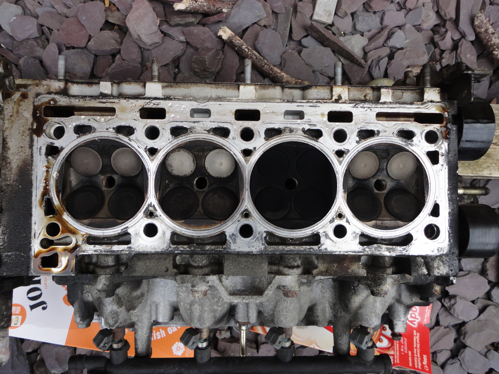

so i was driving along in front of my brother a few nights ago, all of a sudden car starts stuttering, my brother said a little puff of smoke came out the exhaust. almost sounded like it was runnin on 3 cylinders. so ive taken the head off and this is what i found! any idea what the problem is????? thanks in advance!!

can you get closer pictures of the chambers on each cylinder, and of the pistons in the bores please

are the valves all opening and closing ok and try the petrol in the head to make sure all valves are sealing properly.

-Inlet or exhaust valves not seating correctly. You can carry out the petrol in head chambers to check the seating is ok. If they are not seating ok, any witness marks on the top of the pistons or on the valves to indicate they have touched?
-Head gasket. Any sign of failure on the gasket itself when you pulled it apart? Again unfortunately a leak down test might have been able to rule this out as well. Was it using any water? (From what I understand head gasket failures on RS's are very rare)

so as i said it was a good reason to take it apart and do it all properly. theres no marks on the pistons or valves. i shall carry out the petrol test on the head tomo. all honing marks are still visable no scoring marks wat so ever.
