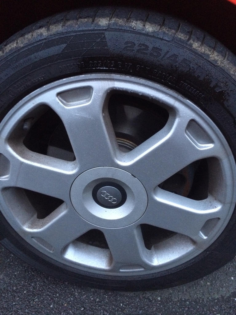

Repeating myself a little, but these one piston sliders couldn't lock up my tyres;

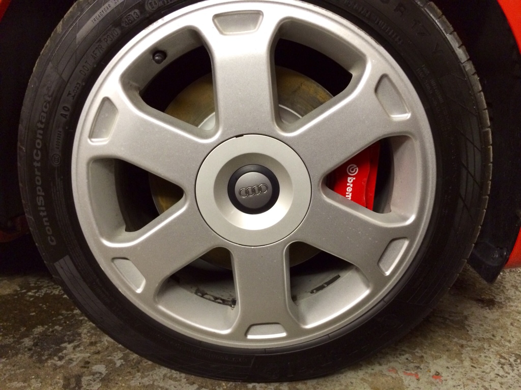

These do;
