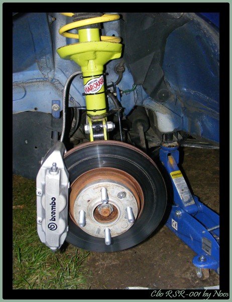

4 pot brakes.
:evil:
Not sure how many will go under 15" wheels, but most should fit 16s I would have thought
Well Actually .... to have the same set-up than mine
I Could provide bracket kit to fit the megane 225 and clio197 Brembos onto clio 2...
To use the original disk, you 'll need about 190 quid for the bracket and you'll need Brembo race Clio R3 mud spec calliper like mine, about 170 a piece and some nuts and bolt that you should be able to get in any good Renault dealer ...
there is also option is to upgrade for 300mm disk then you can use any set of Brembo of 197/225, still need bolts and stuff from you Renault and of course an other specific bracket ....
:rasp: Mp :rasp:
ps: OZ F1 in 16 inch can fit with that kit on, just need a 5mm spacer.
