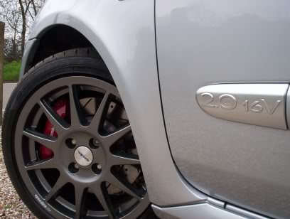

For one application...
all the talk of locking the wheels up etc, yes its true that standard setup can lock the wheels at say 20, 30, 40 mph but they wont do it at 100mph like a set of powerful 4 pots will.
Not that you want to be locking your wheels at those speeds mind!
Many people are quick to dismiss 4 pots when they have never tried them. And many dismiss them as a few 'experts' claim you dont need them.
But for the ultimate in braking power, in a clio, you cant beat a good set of 4 pots.
This isnt me trying to sell kits either, its just cold hard facts. The whole reason we had the kit made as at the time there was no 4 pot setup that would run behind 15 inch wheels.
carry on...
