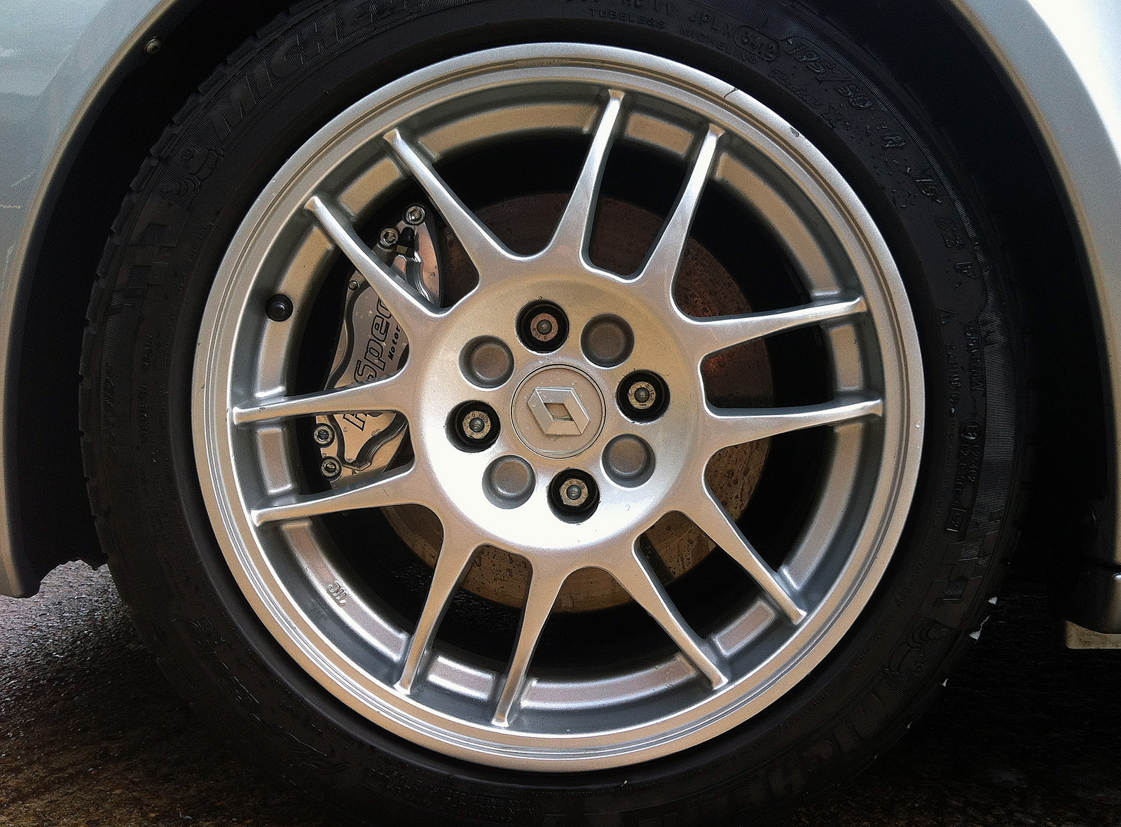

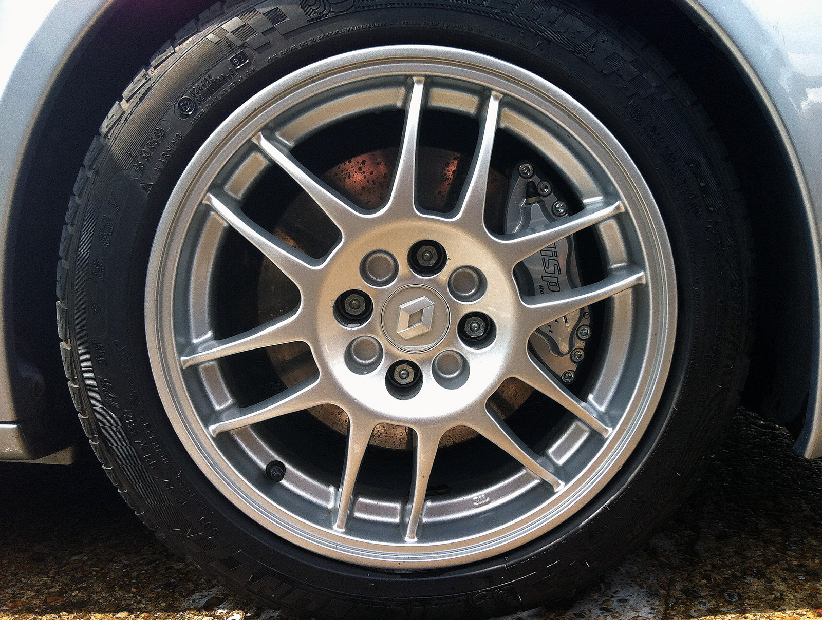

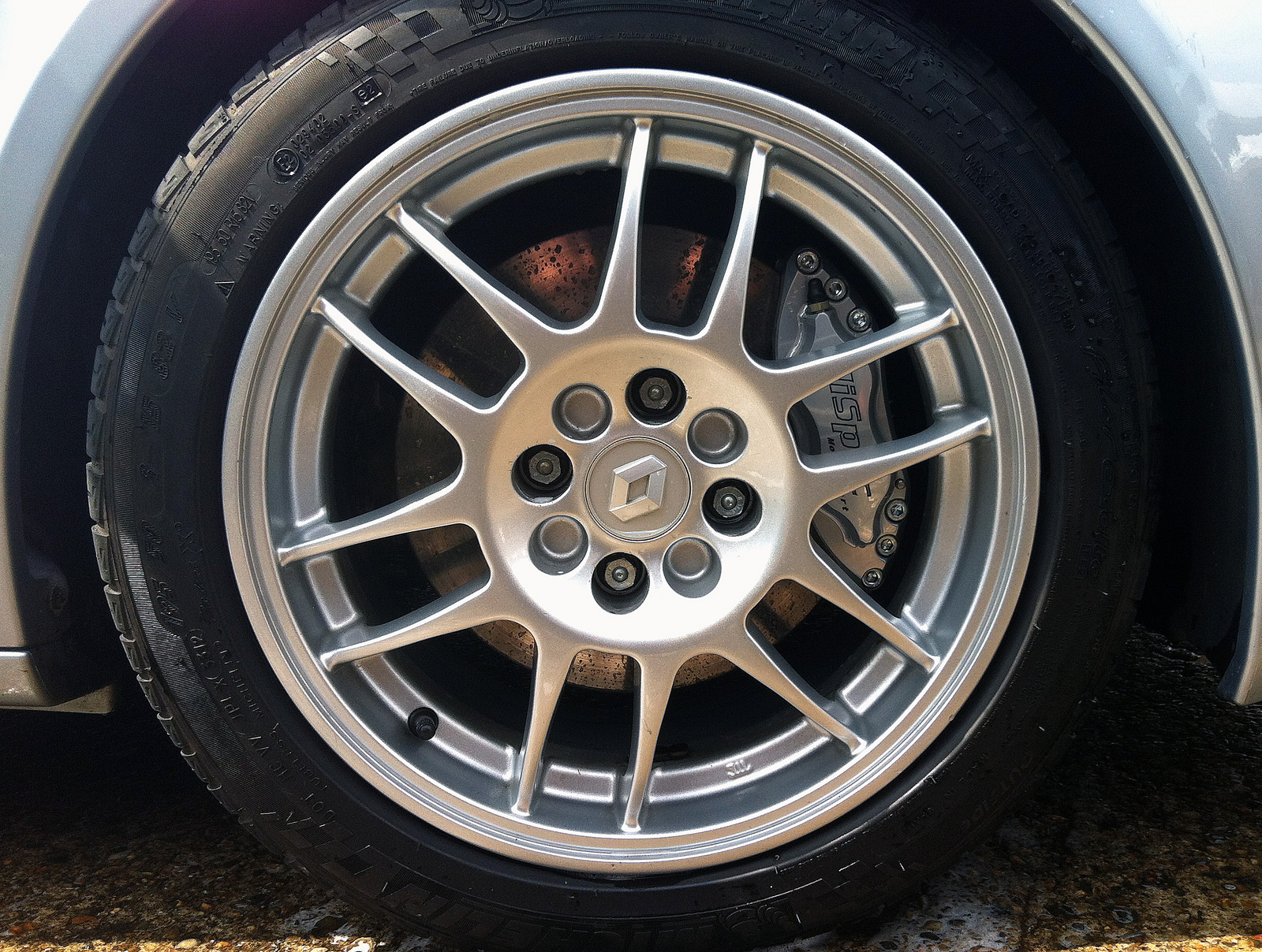

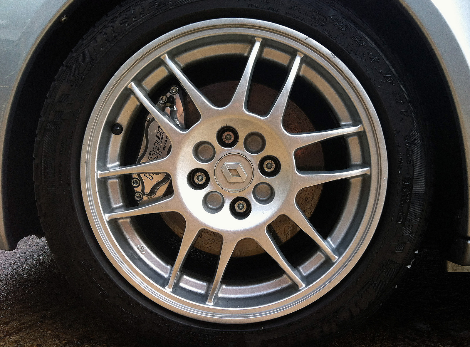

If you fail, you can always look into his-pec and jamsport as they do off the shelf kits. Hi-spec use 280mm discs and have there own adapters and sell you a array of pads, jamsport use a 295mm and have there own adapters with ds2500 pads from memory.
Both come with braided lines and fluid.
  dan's cast offs.
Th
Thought they got a bad rep for flexing ?
looked into that a few years ago, think a lot was to do with them either not set up properly and the lug mounted ones flexing quite a bit. fitted a few sets over the years and no one has complained about them.

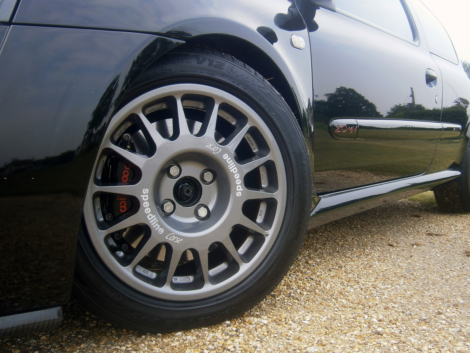

I've got speedline 2118's et35 and Oz eagle F1's not sure on their offset though. Also got 16mm spacers on the front as well.

My 2118s we're et43 (most are unless in white, which are et38) and f1s was et43 also. I had 20mm spacers on the f1s and 5mm spacers on the BG, but I think you'll get away with having none. But you have 16mm anyway so you'll be fine on both.

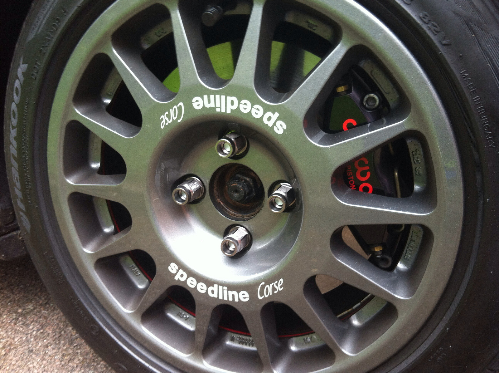

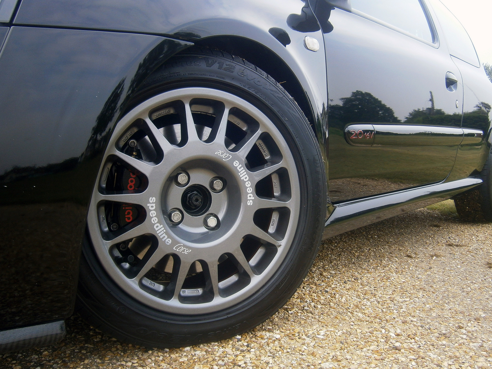

Also been reading @pule333 build thread and ACS motorsport got him a kit with brembos, 2 piece bell and J hook disks and brackets. They had to take a bit of thickness out of the calipers but they managed to fit them under 15 inch laggeras
RuskiWeldFab
  Clio 172, RS4 B7
And under Td1.2 but both with 15mm spacers. Very tight

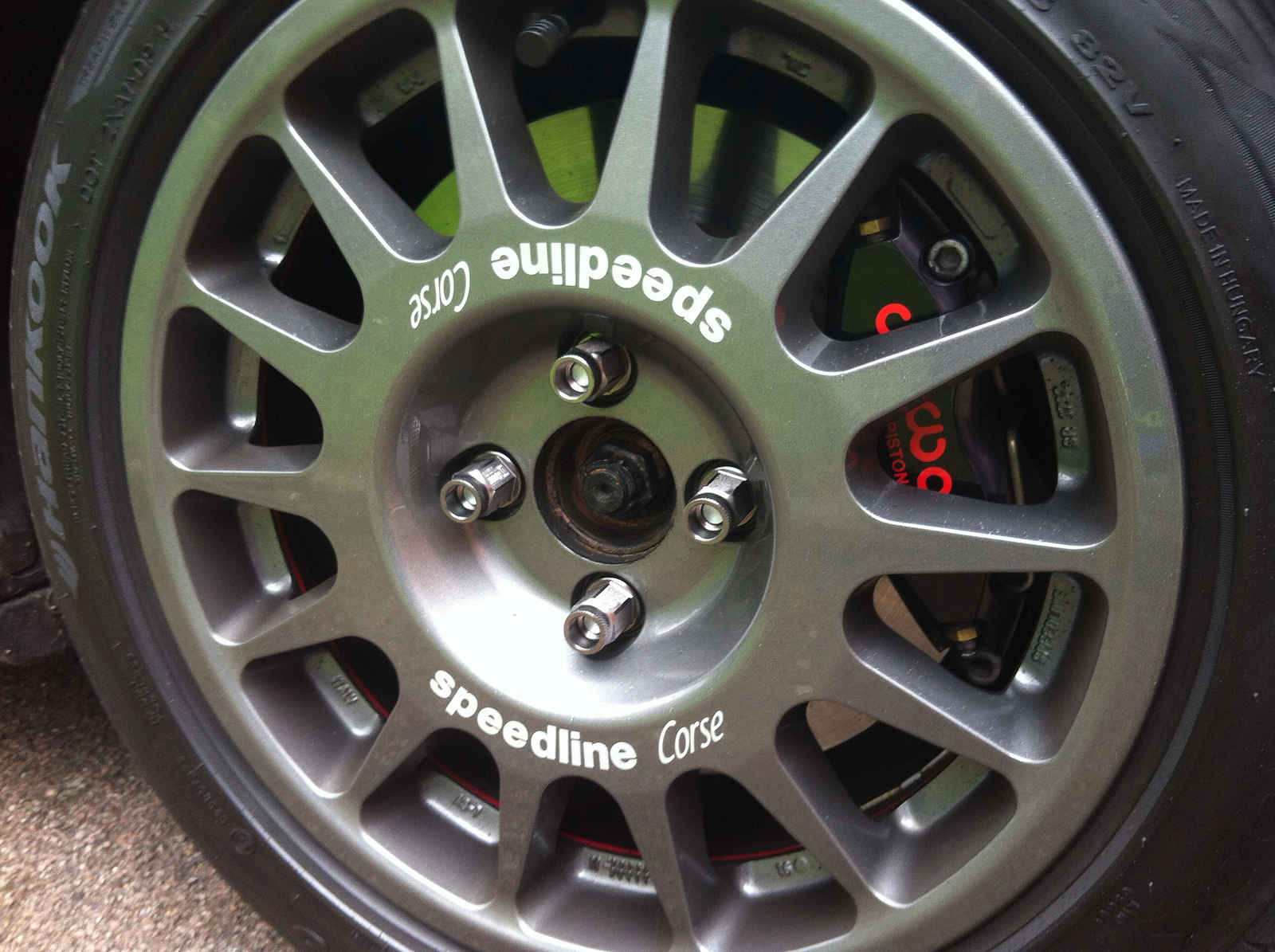

I had 4 pots under et38 2118's with 16mm spacers, 4 years no issues they need milling first tho.

The calipers were meant for his own car that he never built. They were brand new so I paid the price. Discs were done by Godspeed (he knows the guy well)
Honestly don’t remember exactly how much it was because he did more setting up and helped fit them so I paid for everything together. Can be done cheaper for sure if using used calipers. I believe Kam Racing started to sell those discs now.

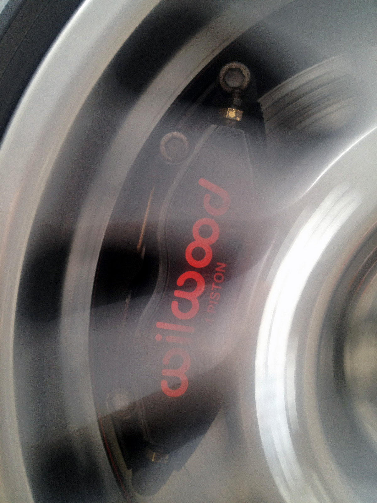

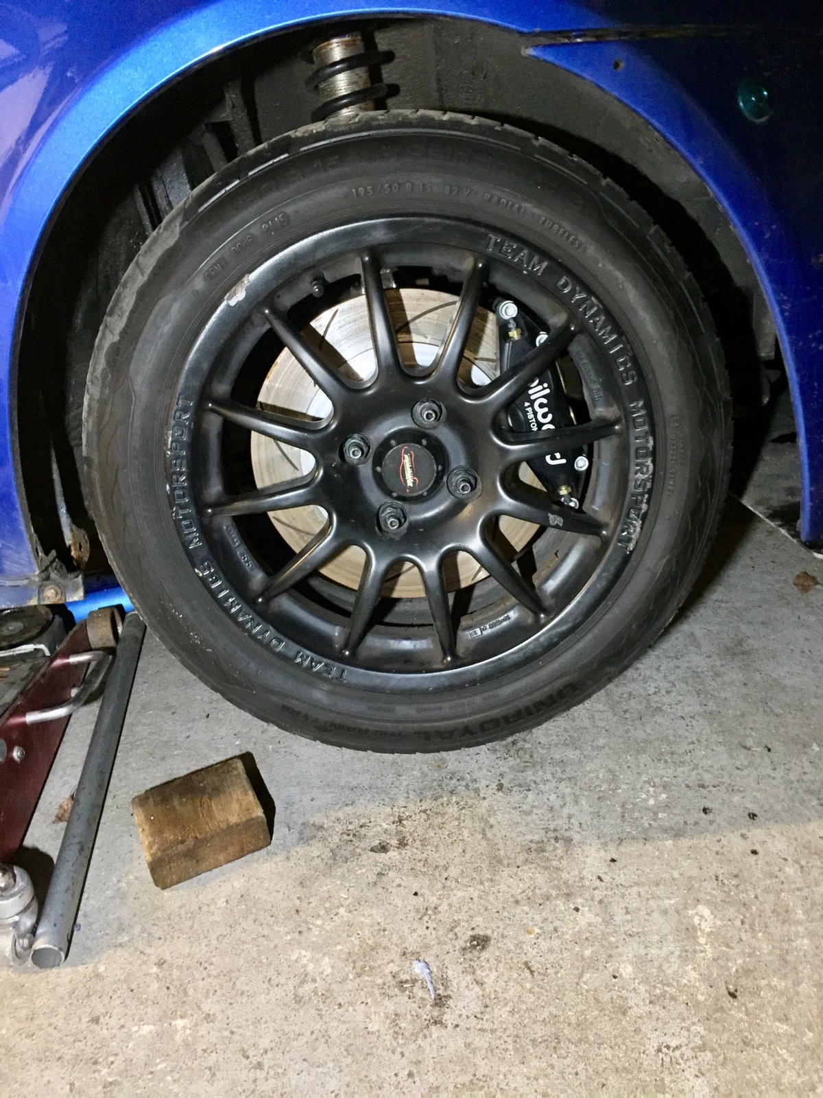

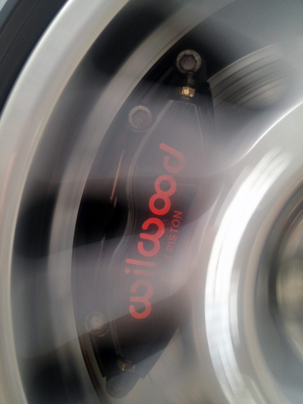

I run the jamsport wildwood kit under 15" no issues, all the wheels I use are ET36 however but no spacers required.
Kev@KAM
ClioSport Trader
  Badass Toyota
The Compbrake kit is great for track use but I'd swap out the pads for alternatives for road use. The discs have curved vanes which is not often an option for the Clio
We do these discounted. With the benefits of the 4 pot and larger disc heat capacity they are quite a lot better than the standard setup. I've never done back to back testing with Brembos on overall performance but its a slimmer setup and the pad shape is not so expensive.
https://www.kamracing.co.uk/car-tun...e-kit-295mm-renaultsport-2-0-16v-172-182.html
  dan's cast offs.

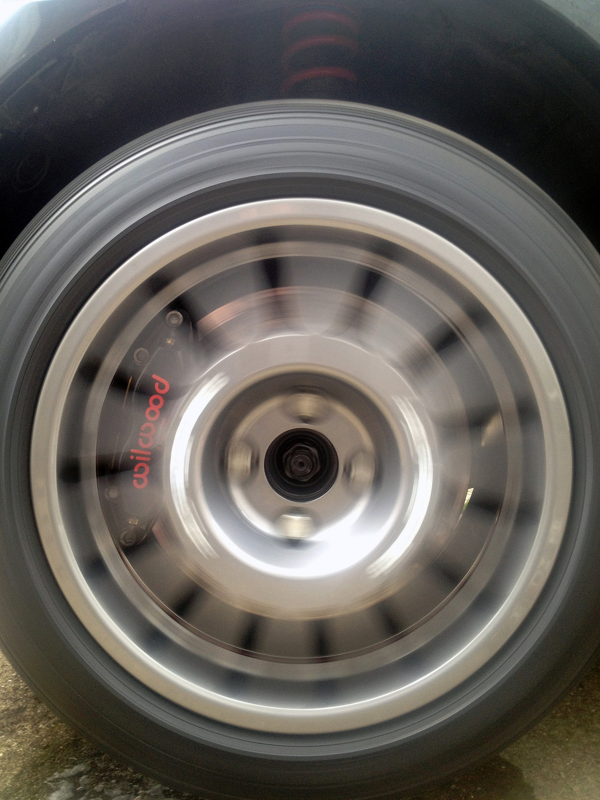

wasn't a bad kit but it's a copy of the smallest wilwood caliper, can't remember the model sorry. know plenty of people who've ran them over the years and no real complaints.
