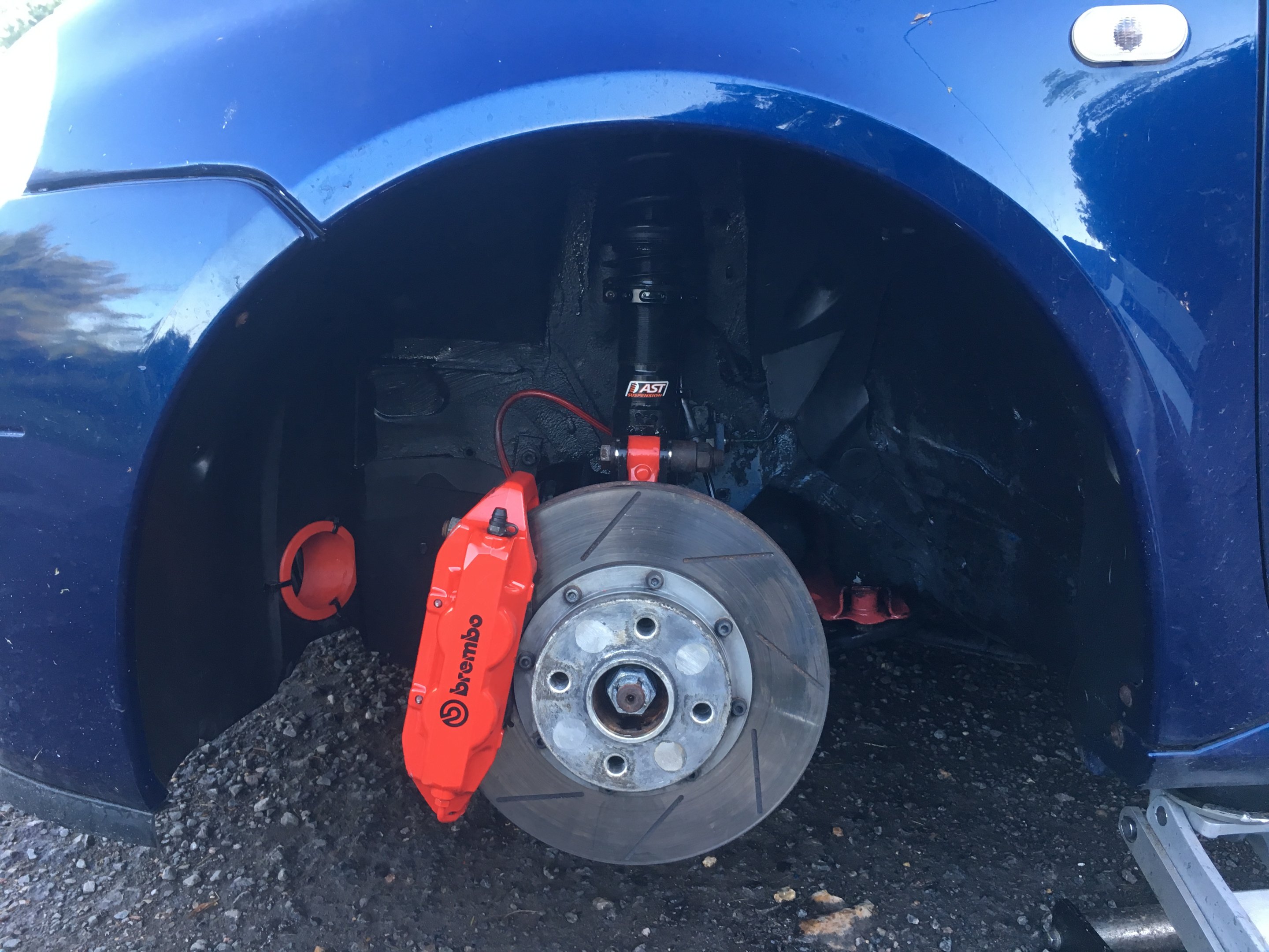

4 pots under 15's?

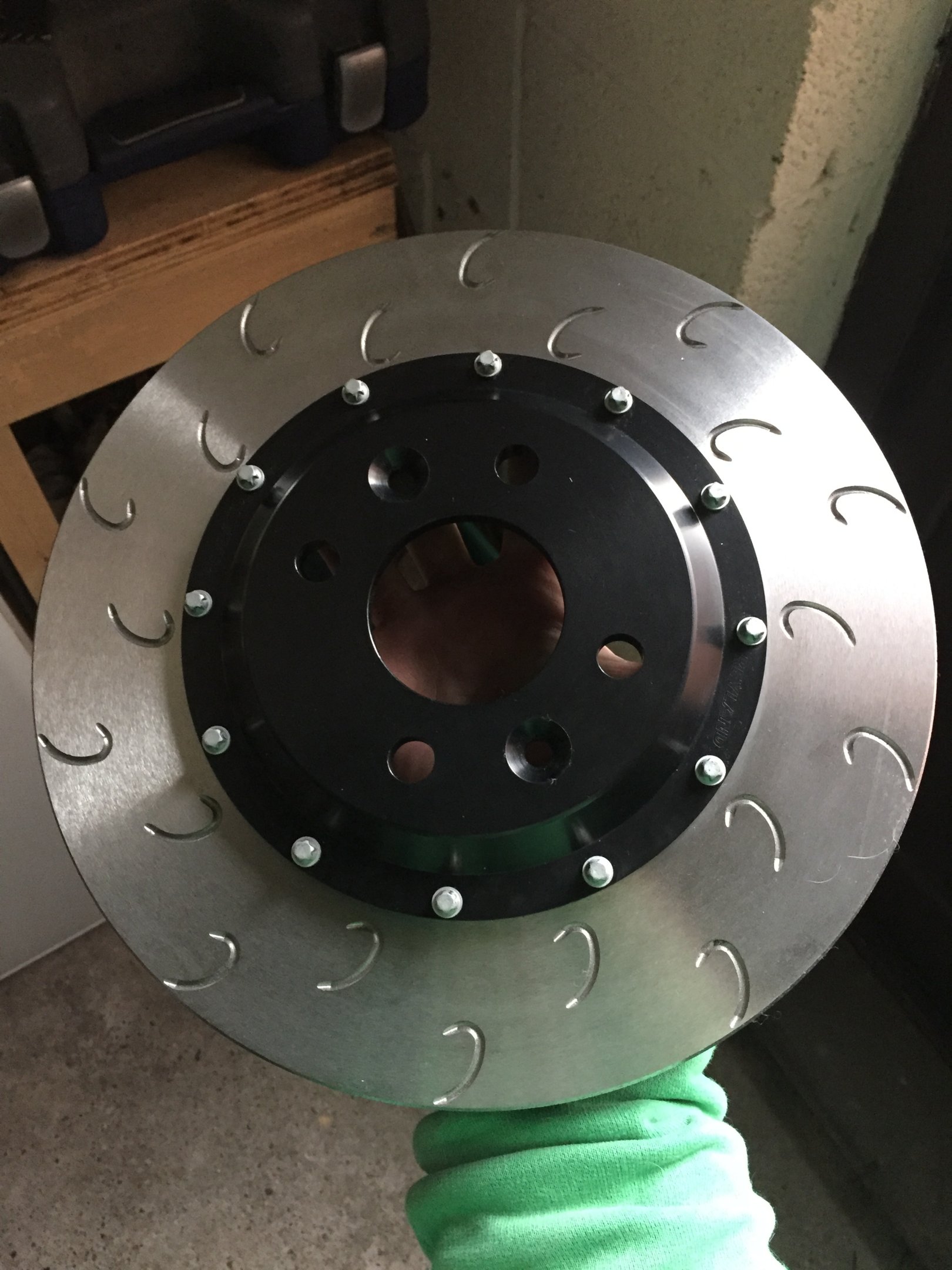

It’s the jamsport kit. Was somewhere around 1695 or 1795 iirc. The AP rotors are expensive but can get cheaper version if you the know the size and PCD of the bell bolts.
Not sure if jamsport do the AP rotors any more as I looked at buying a spare set a few months ago.

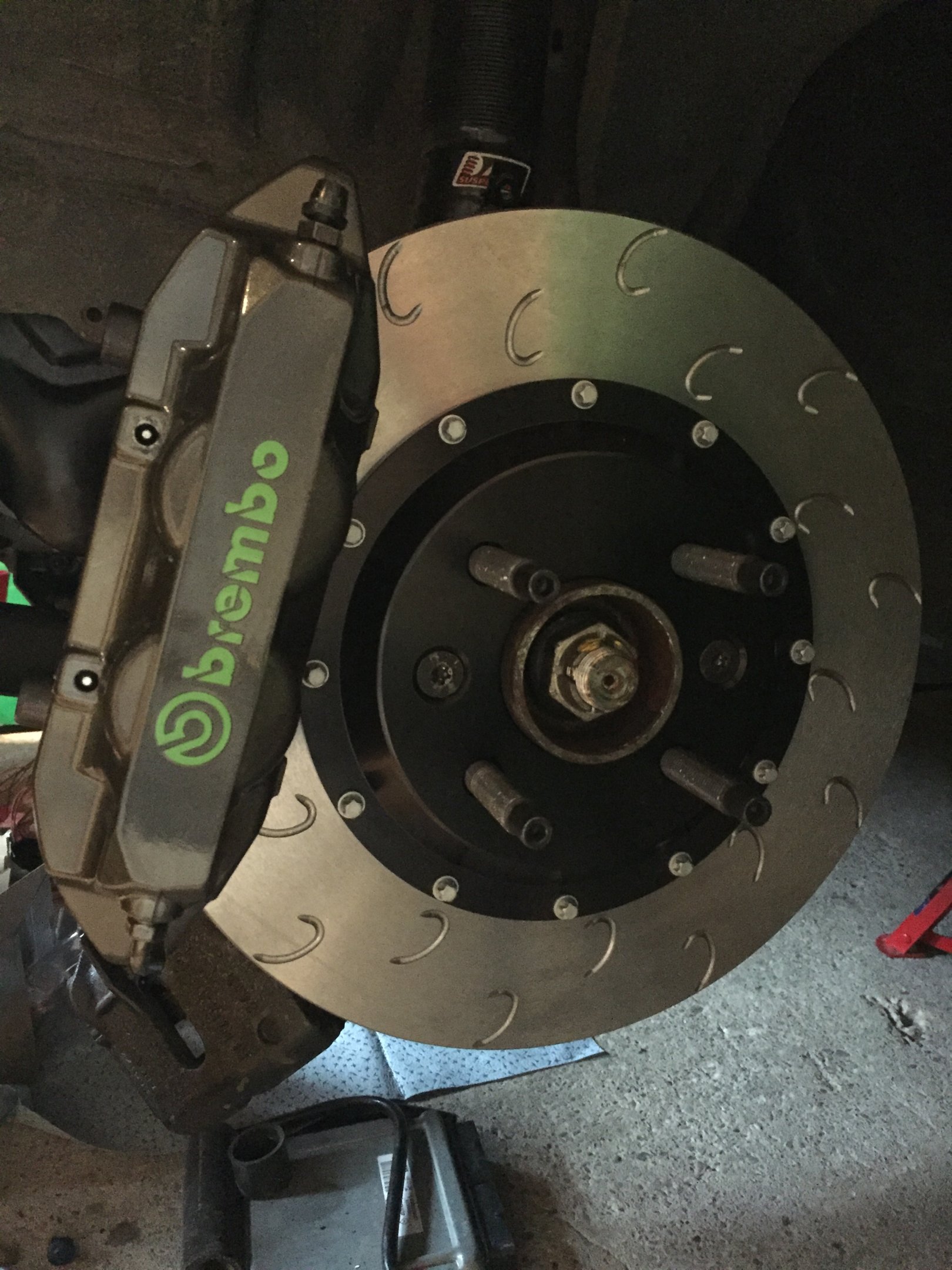

This kit didn’t fit under 15’s as I ran 16’s, but it was a custom 295 bell and rotor setup. 2.5mm machined off the brembos to accommodate the 295 disc using 300mm brackets.
The bell and rotor setup will set you back around £500 ish if you know where to go.
This is my setup.
I’ve tried to find the PDC measurements but for the life of me I can’t find them at the moment.
The alloy bell I got from eBay of all places and the rota is a Hi-spec 283mm and Chris’s adaptor brackets with 5mm machined off the caliper, running d.s 1.11 pad. All under 15” ultraleggera’s et38 with a 15mm spacer.
I’ve been running this for a couple of years now with no problems. I’m still using ABS and I know Mike had to change my ABS rings but I think that was because I changed to 182 cup hubs. The PH1 brake peddle is slightly longer as well, I m thinking of changing the master cylinder to the 197 one to see if that helps.
