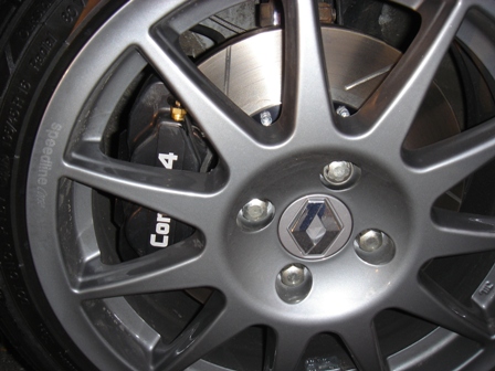

I've run these for nearly 3 years now. Great stopping power once up to temp, and so much better looking than the standard 1*2 set-up.

By no means are they needed and, to be honest, they're overkill on a clio...but I love mine! :evil:
