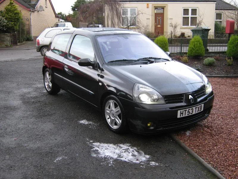

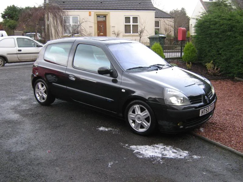

60mm springs ruined the ride on our DCI - not sure what they'd be like on uprated shocks though.........
shocks and dampers are the same thing buddy, its not impreitive to buy them but it is the Best bet as the standard dampers are designed to work with the rates & height of the standard springs so putting springs that are half the height wont do them much good.
40mm or there abouts, eibach sportlines
