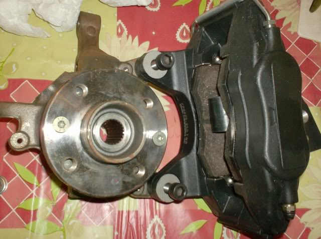

MY ten pence worth : I have the older style calipers on my cup, there were a kit supplied by godspeed brakes originally, Seem ok, but then i don't track it etc!!
There certainly much better than the standard setup.:)

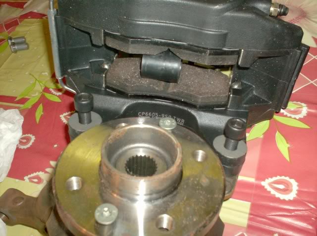

I'm far from a brand snob so wouldn't use them primarily because they are 4 pots and have Brembo written on them. The pad retaining pins came out with one tap, all the pistons retract easily and they offer MILES more pad/disc area than the standard set-up. 24 hour racing isn't really a fair compromise to a road car doing the odd track day, although I see what you mean with regards to the actual quality of the caliper.
The Calipers we run on the current spec 24 hour car ARE road car calipers - just with the dust seals removed. They are exactly the same caliper as any 197 road car, straight out the showroom has.
Pad/Disc area is fine but look at the Piston area as this is what actually does the work of getting the pad onto the disc. Put it this way how much difference is there in the brake pedal height between the original single piston calipers and the 4 pots - of course this does assume the orignal kit was in good nick and bled correctly.
I'm not knocking them just for the sake of it and you'll potentially get slightly more even pad clamping loads at low pedal pressures but don't think you need 4 pots or that the standard calipers are no good. Standard single piston sliding calipers can still lock up hot slicks on the nose of a Cup Race Car quite happily!
Keep an eye on the retaining pins as well. The first time the pins are removed it takes the anti corrosion coating with itand then the steel pin/ally caliper casting react accordingly making it an arse ache to remove after 12 months or so and a bit of road salt.

Yeah I'm going to copper grease the pins before they go back in.

Yes, they're an old design and maybe only give me a 10% increase in overall performance BUT They've cost me a VTS axle, and £70 for discs so far. I've probably saved a few grams and I've got bigger discs to help with fade. On an RS wether or not average Joe thinks they are worthwhile is negligable but I was only running 259mm discs beforehand.
