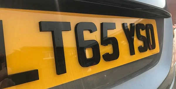

Anybody seen any cars with these on?
http://www.demonplates.com/platebuilder.php
If you click on 4d perspex it shows an example and claims to be road legal. I'd like some just because they're a bit different and I quite like them but have a feeling I'd get pulled over for them on the basis that a copper probs hasnt seen any like it before. Looking through the legislation I can't actually see anywhere that they would break the rules but I've seen a lot of stories of people being pulled over even for 3d gel plates

I'd buy them because I personally like the look of them, I get they won't be to everyone's taste but my issue is more the legalities of it. They claim to be road legal etc and I know there are some people on here who are MOT testers etc so looking for insight as to whether or not police would have any grounds to pull me.
If they are road legal and have the name/postcode of the business that has produced them for you stamped on them, then from a legal point of view you should be fine. As the police would then need to seek further clarity from that business.
But as said, if they’re a new option for plates, they’re going to draw attention as I can’t imagine every copper will be 100% up to date with the latest rules.
I want to see some in person first before I order any because never seen them before but really like the idea
I have seen them on a couple of cars & they look terrible.. both cars had crappy private plates on. Nuff said!!
They do look a bit gash in person, i'm pretty sure if you wanted to mock it up there used to be a seller on ebay selling the actual '4D' letters you could stick over your own plate...
I'm not sure just adding the words 'Road Legal' to a description actually makes them so... lol
That said, I have seen the carbon fibre-style moulded plates on cars and they have been sold for a while.

Overall, I think it's a bit of a grey area - you'd probably have to argue that they do not make the font less legible or interfere with reflectivity, and therefore would pass the requirements of the legislation.
Might be expensive to test that in court, though...
I recall that fancyplates did 'cut-out' plates for a while, with the letters cut out with an 11mm border round them - the legal minimum. I think they passed the letter of the law but not the spirit of the law, hence they are no longer available.
