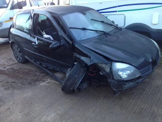

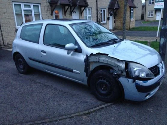

Everything pretty much went of fine until December 2013. Coming home from seeing a friend, wasn't really driving to the conditions. Tried entering a roundabout a bit more aggressively than my Toyo T1Rs could handle. The roads were wet and greasy and I had savage under steer, ended up going through a sign and 2 trees. The second tree was to much for the Clio and stopped me and ended up spinning me around. Police arrived and took me to the local hospital and was given the all clear from the doctor. Remember the police officer looking at the car and looking at me and saying how lucky I was as he was surprised I has no injuries. The only thing that haunts me to this day is straight after the impact and I had come round, I could see smoke from the bonnet and could feel my leg pinned. Personally I felt like that was the end of me. I know it sounds a little stupid now but when you have just hit something head on at 60mph and had a face full of airbag you think of things like that. Typical me before trying to get out, I had to climb our the window, I sat there looking for my phone hoping it wasn't broken, just wrote of a 3k car and I am worry about a damn iPhone.
The Crash....
The Curse...
Anyways enough of my little sob story. Seen as I was the only one involved, the Police didn't charge me and I decided to not bother going through the insurance as it was my own fault. Didn't fancy losing my 2 years no claims so took it as a life lesson. A lesson that cost me a lot of money, so I decided to break the car for bits. Engine I got from Dan was still good so I sold that on. Seems a bit of a cursed engine that. Went for about 3 month without a car in the end.

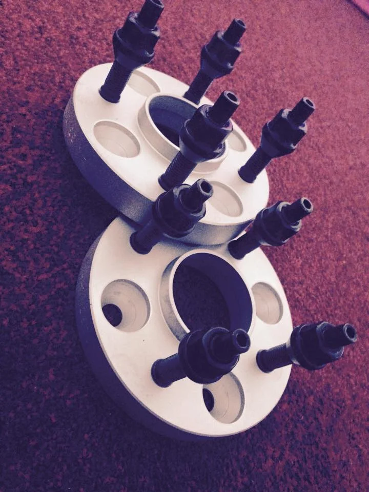

  • FK 20mm Bolt to Hub Spacers
  • 10mm PMS rear stub spacers
  • MAPS Conversion Kit.
Spacers and studs...

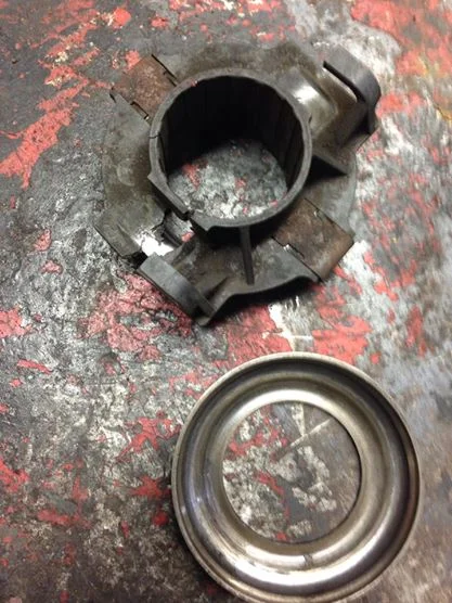

Thrust bearing decided to die about 5 days before the big CSOC meet at TRAX so was a bit of a mad rushing trying to source parts. Me and a mate fitted it on the Friday night before the event. Whilst we were at it I changed the lower ball joints as they were knocking and the steering rack bushings for some Powerflex ones
I think it is broken...

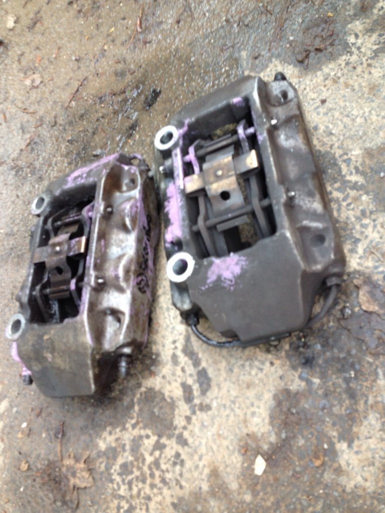

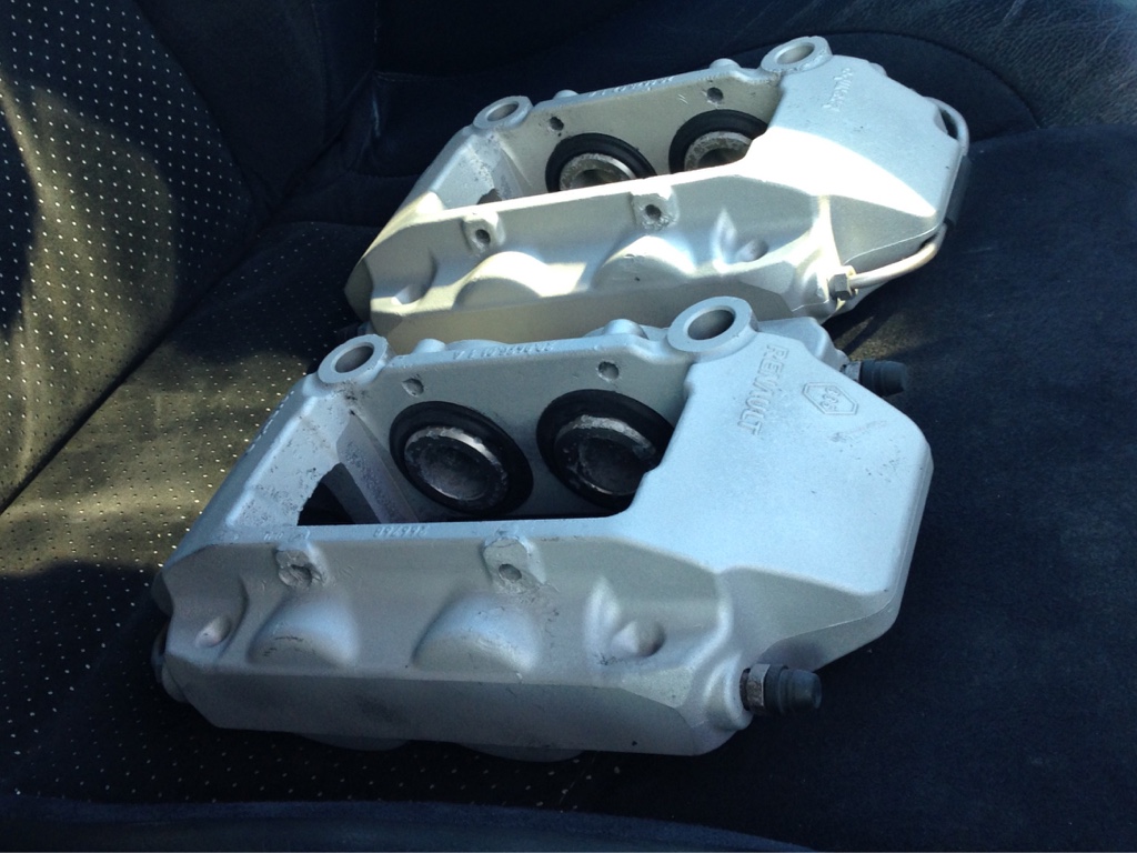

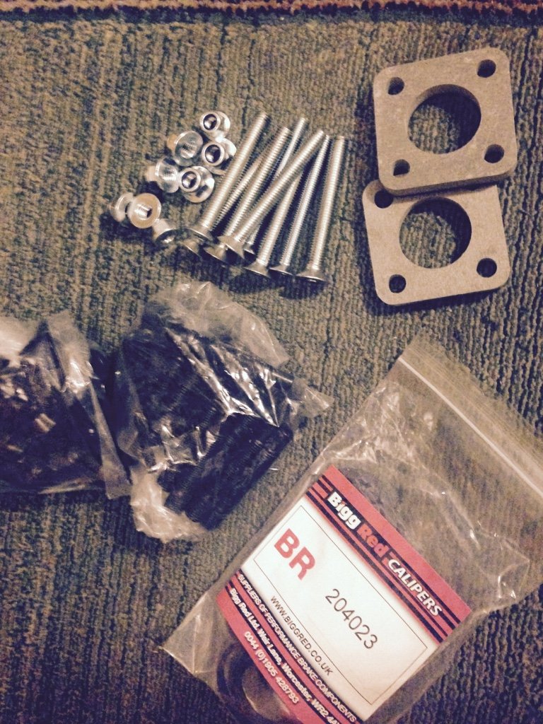

Picked up a set of Megane 225 Brembos for 80 at the local scrap yard so a bit of a bargain. They are currently getting dipped to remove all the grime and paint so they can be rebuilt and repainted and fitted to the 182. I will update more on that as it happens.
On the list at the moment is to fit the parts I have, finish the Brembos, Replace inner and outer track rods and hopefully get my hands on some 15 inch 1.2 Team Dynamics.

Enjoyed reading your first post! Always great to see another BG on the forum [emoji12] £80 for the Megane brembos is brilliant [emoji1] How much do you think it will be all in to have them fitted?
Yeah I didn't really want another but couldn't really refuse so ended up with one.
Umm as a ball park figure I would day around £400, that's including the calipers. I got a rebuilt kit and retainer kit for Christmas so just need brackets, lines, painting with new disks and pads. I can rebuild them myself, I am just in two minds as to have them powder coated or just rattle can them. They are currently away getting acid dipped and possibly blasted to clean them up
Condition I got the Brembos in ...
A couple little bits waiting to go on and the rebuilt kit for the Brembos...

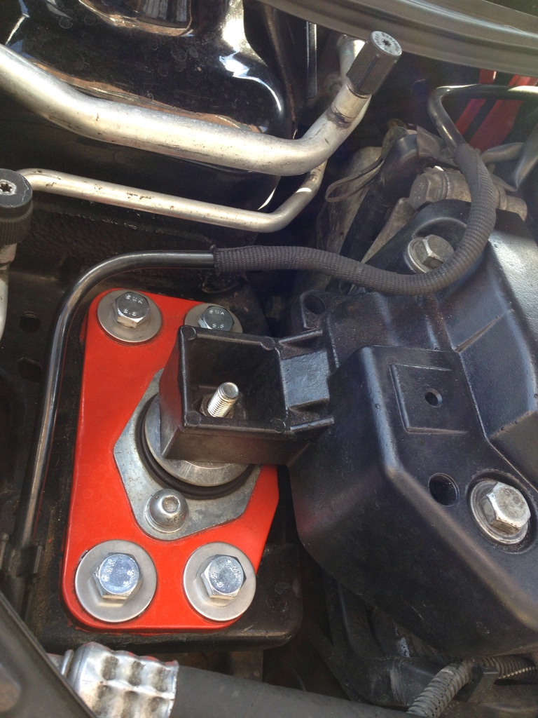

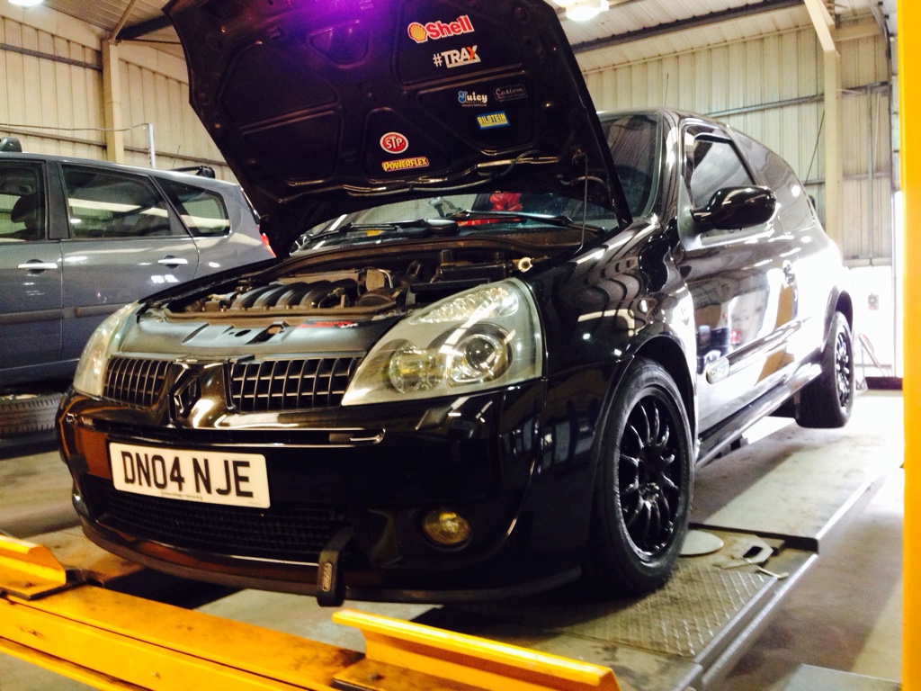

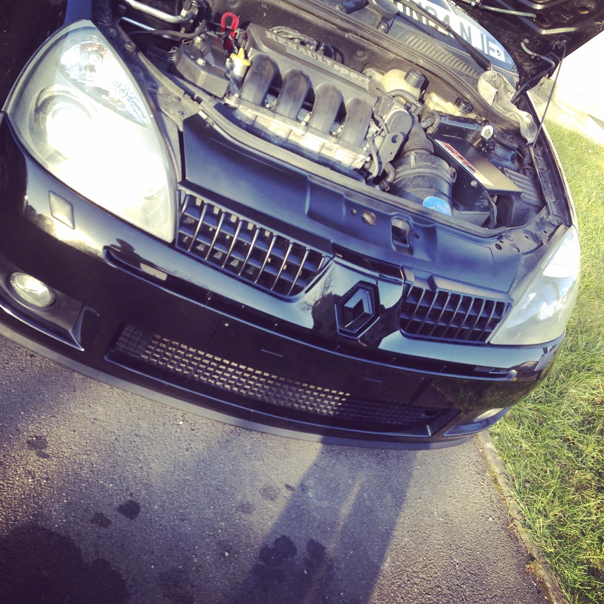

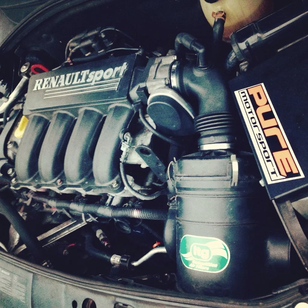

The bay.. Forgot to mention in the mods list the Vibratech upper engine and gearbox mount along with the Powerflex Black Edition dogbone...

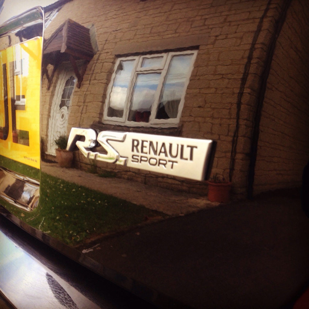

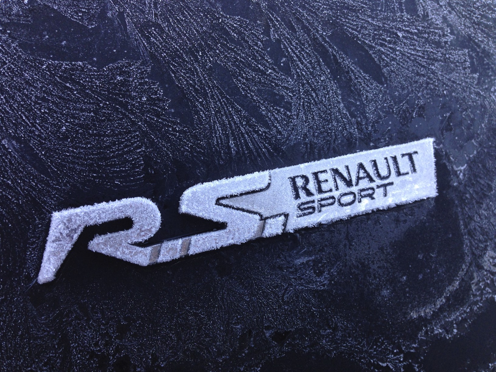

One the first things I did was put a new style RS badge on it ....

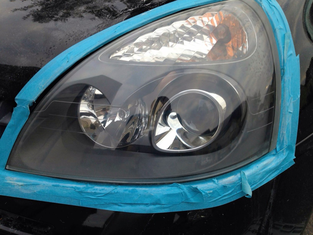

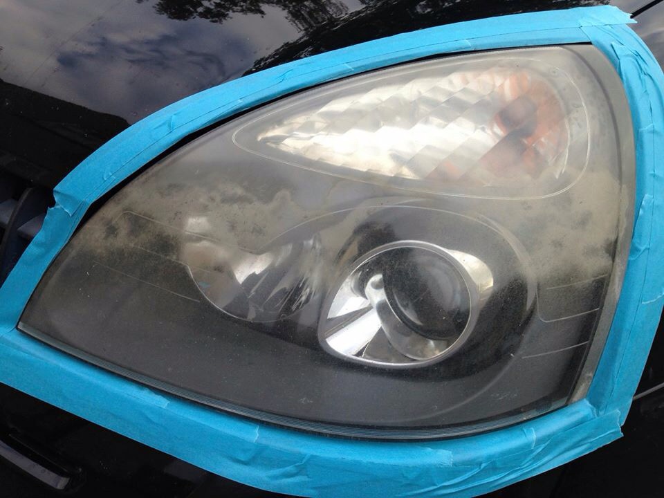

Headlights were really badly hazed so have them a go over with the 3M kit..
Before...
After....

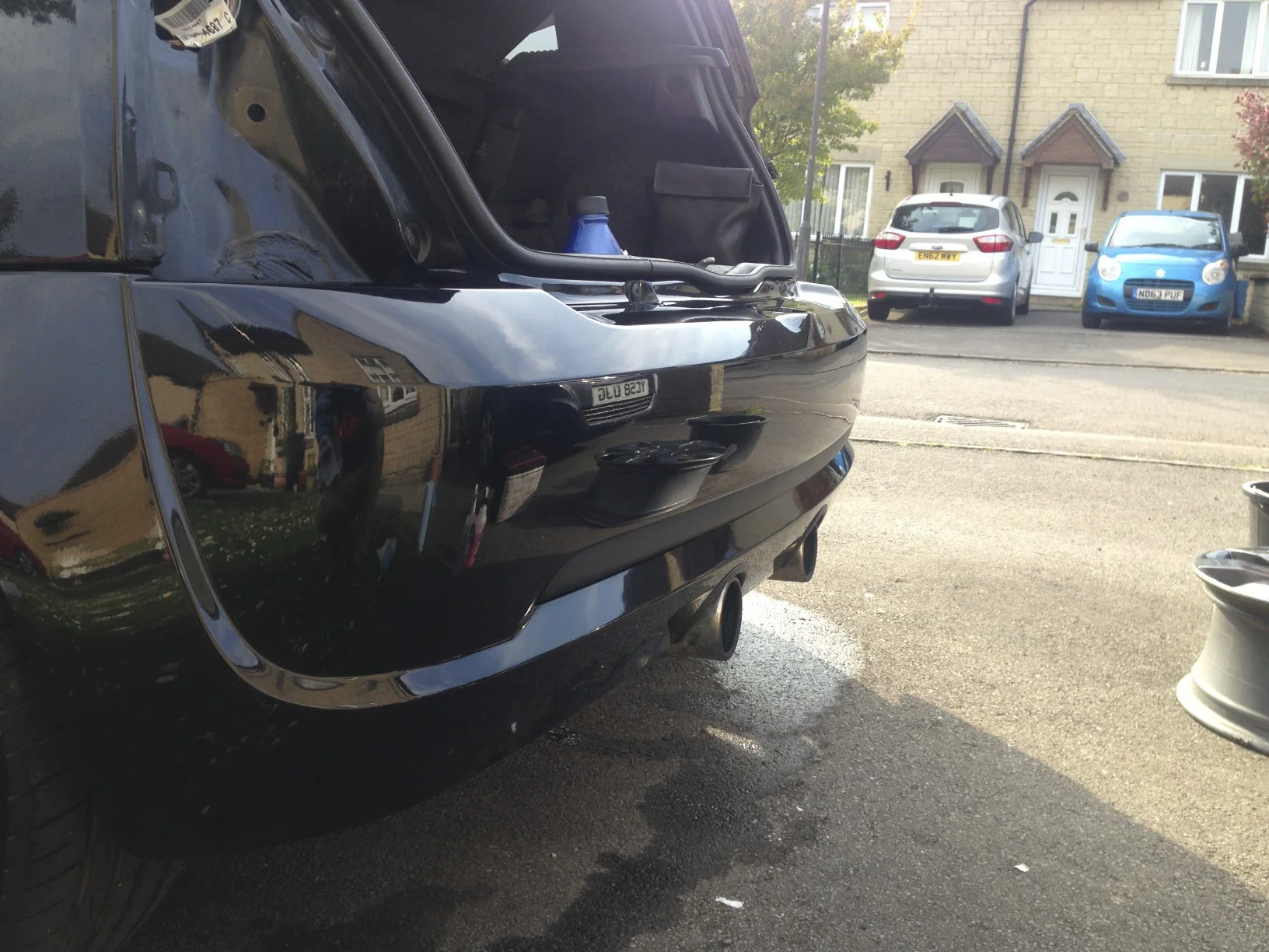

Just a little update. Decided to get a video of the exhaust, still needs to be booked into infinity to have all the joints V band connectors welded into place but I'm happy with it as it is ....

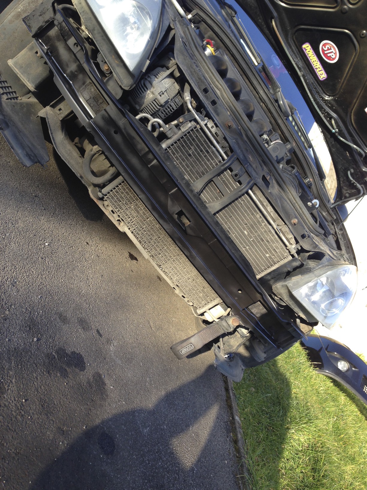

Took a trip over the bridge to get me a new front bumper. My old one was pretty stone chipped and didn't really want to go down the painting route. Cost me £65 and it come with a cup pack splitter so bang on. Spent the last couple days with the front end in pieces whilst I clean the bumper up and spray the grill in satin black.
Car is going up on the ramps tomorrow to have new inner track rods, track rod ends and some Powerflex outer arb bushings.

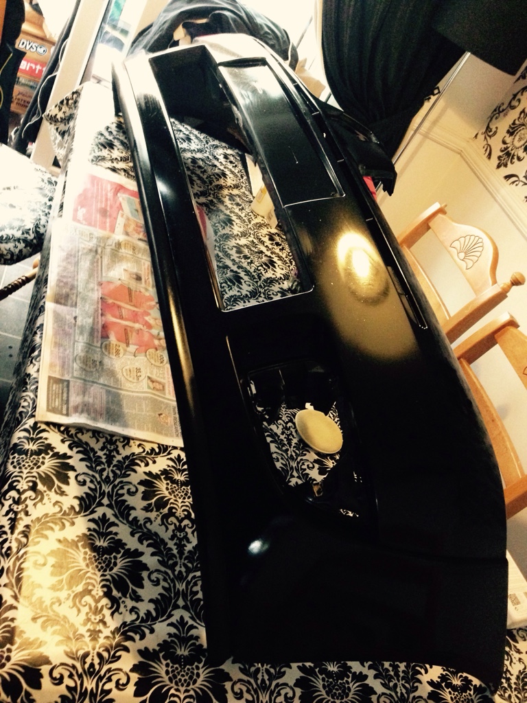

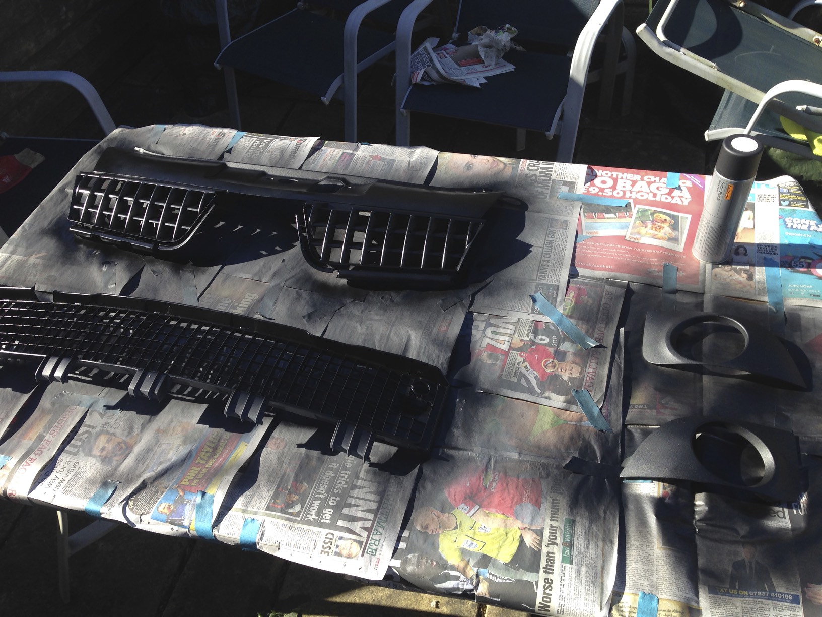

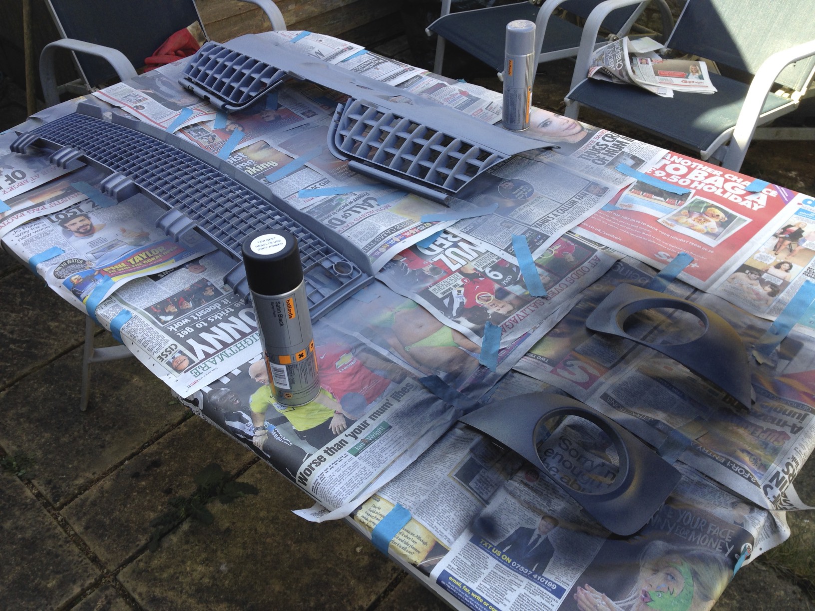

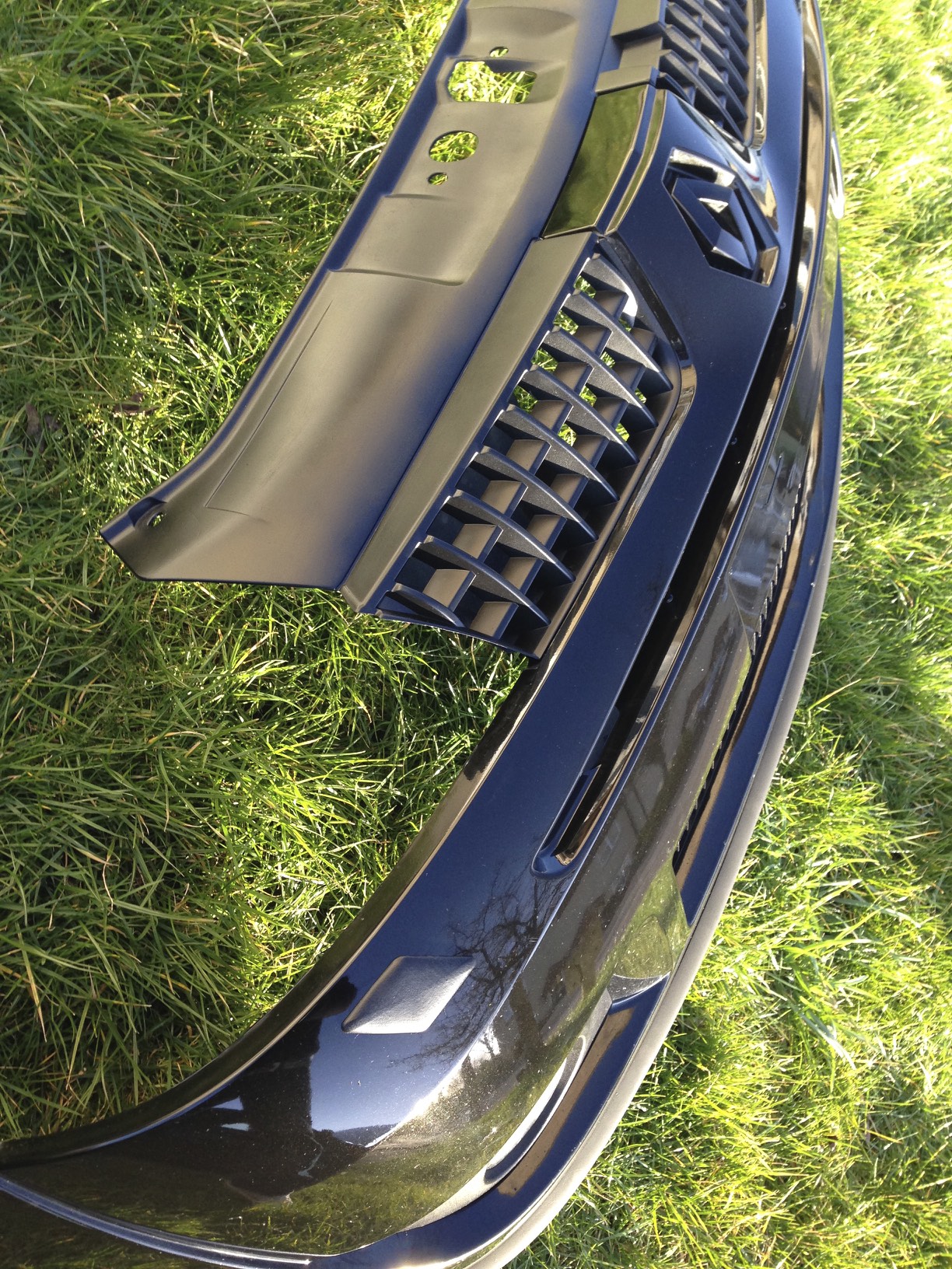

After spending the best part of the morning in the garage I decided to finally crack on with painting my front grills. After struggling for a little bit on the Friday night trying to remove them, they finally gave up and come off. Got plastic primer and satin black from Halfords. 2 coats of primer and 2 coats of top coat was what I did as I had completely ran out of both, personally I wanted to do maybe another coat of satin but its ok as it is. I was surprised at how fast that stuff dries, was pretty much 10 minutes between coats and even then it was dry to handle. left them an hour before refitting.
Just finished with the primer (I had done the fog surrounds the night before so they were on the first satin coat)
Final Coat...
Before refitting the bumper I decided to spray the front slam panel just to protect it a little bit and tidy it up. Had some matt black stove paint about from doing my upper inlet so went straight on.

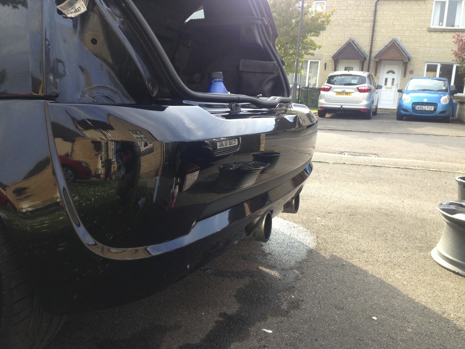

Slight oversight was the fact I have no velcro pads left to put on the bumper for the numberplate and didn't want to start drilling it. Currently the plate is in the window and will get some velcro pads when I back at work on Tuesday. I had been up and working on the car since 9am and it was no getting close to 6pm so just wanted it finished but luckily the weather was on my side so managed to get it all done. The upper grill does need adjusting slightly as the bonnet catch is catching on it when you try and open it so have to push the grill down to get in.

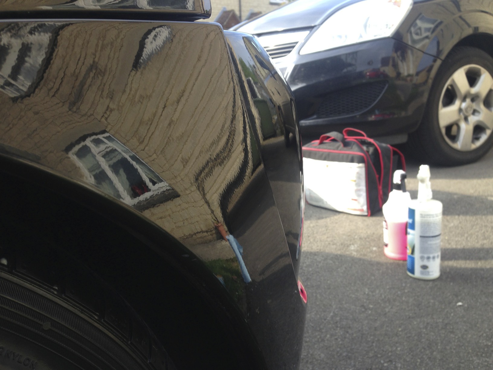

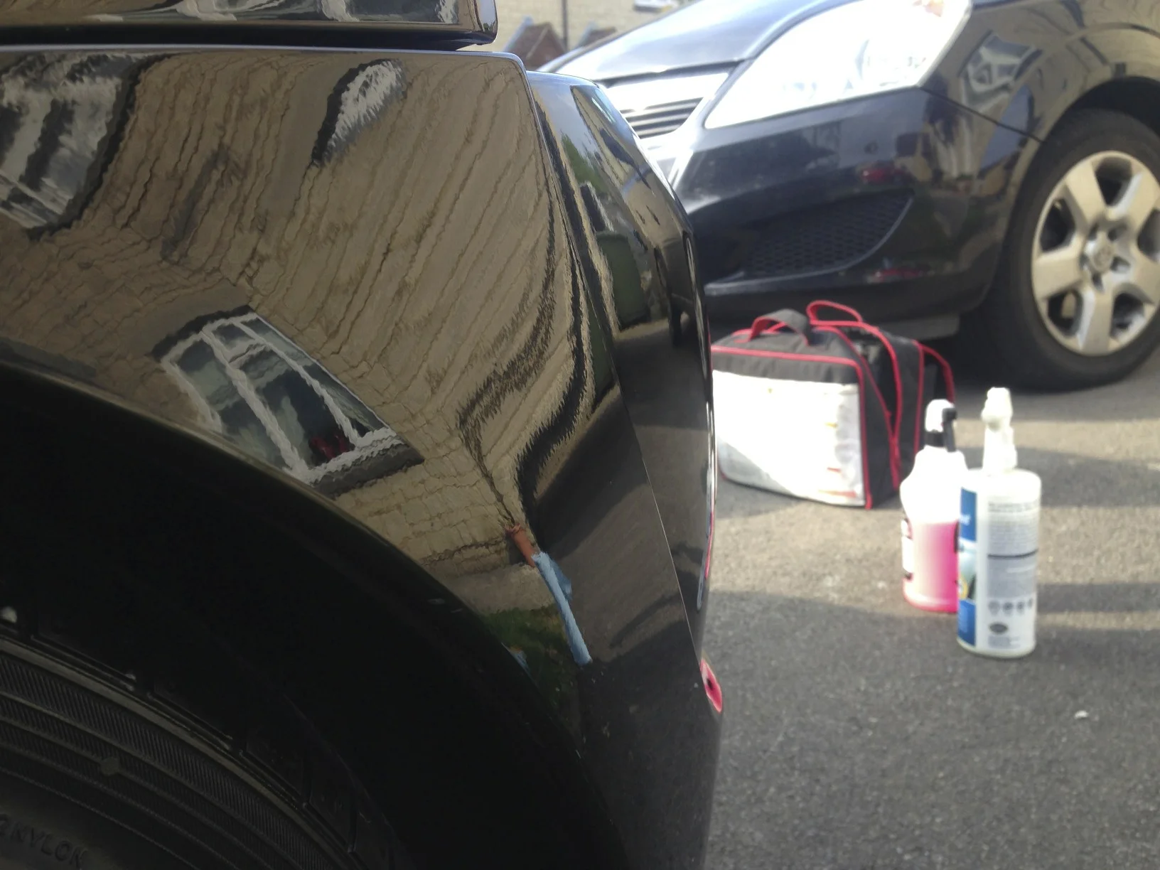

Gave the car a complete decontamination and a good clay.

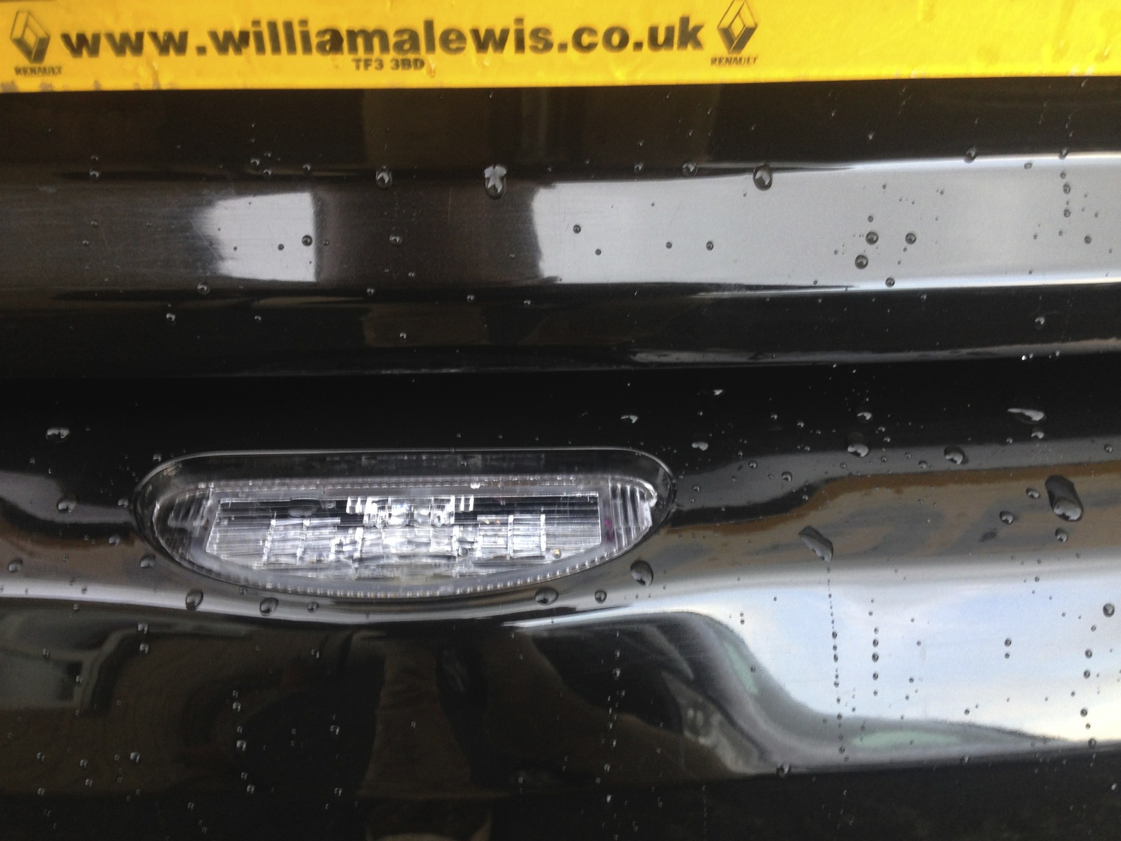

New rear numberplate bulb holder

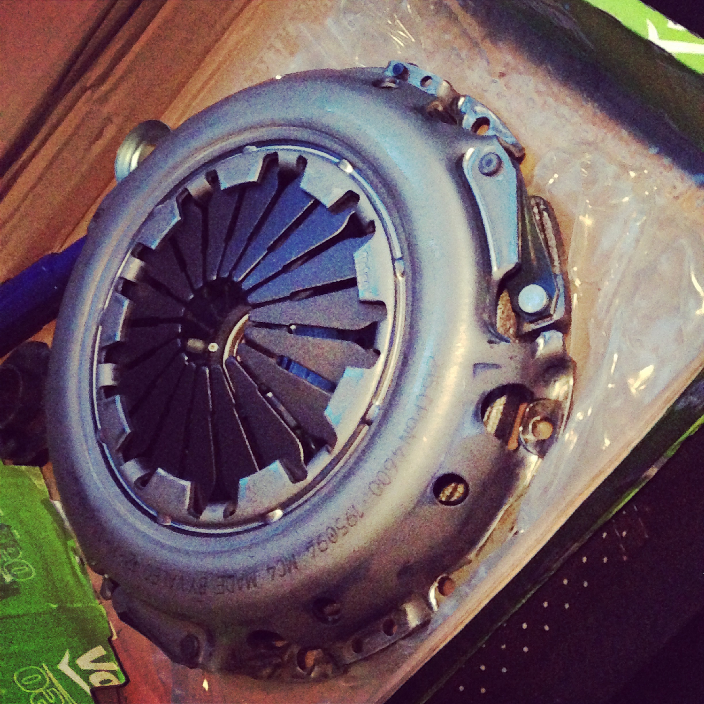

New clutch before it went in
New Style RS Badge In Winter

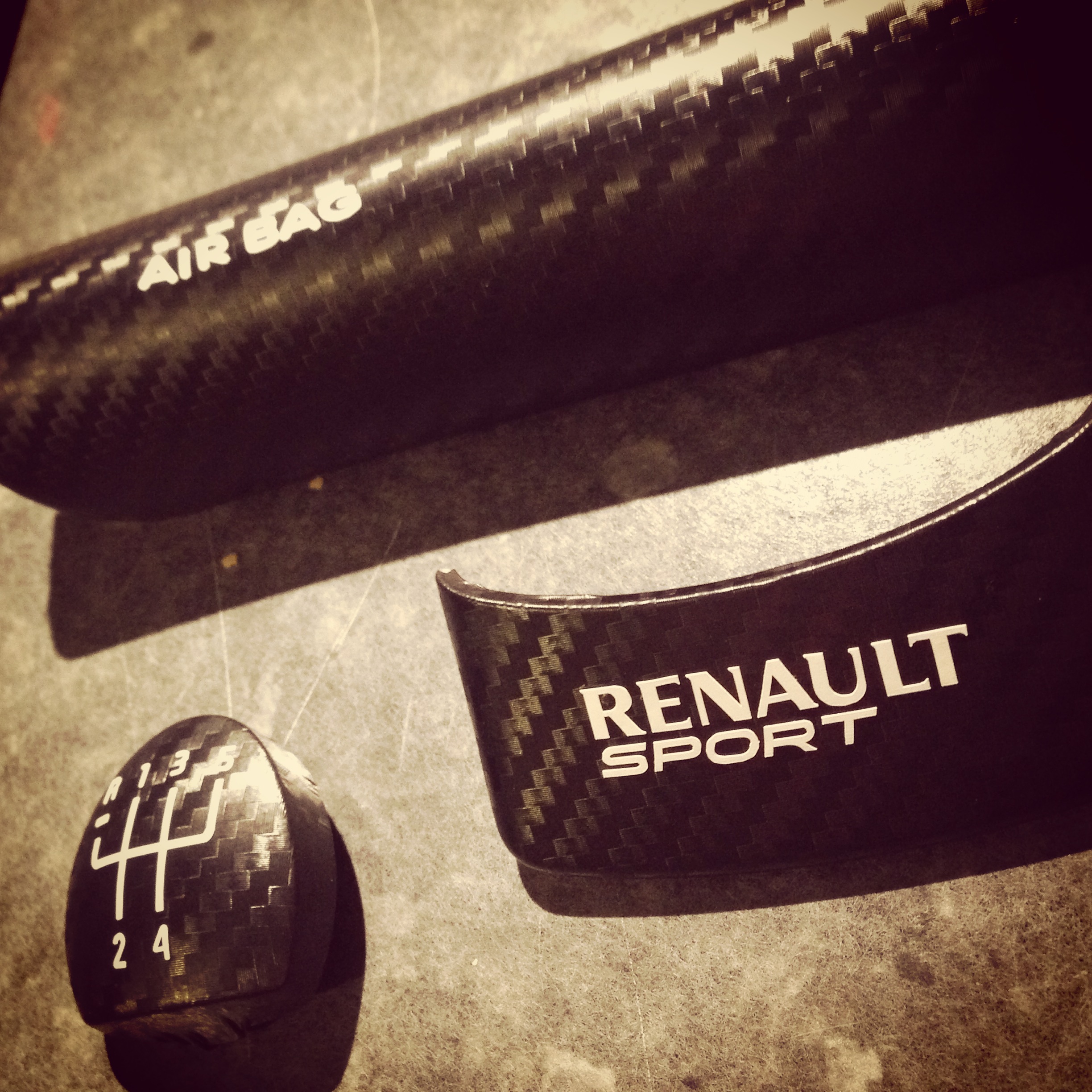

Carbon Fibre interior trims with decal

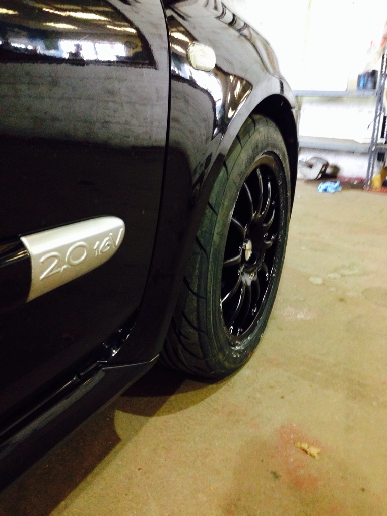

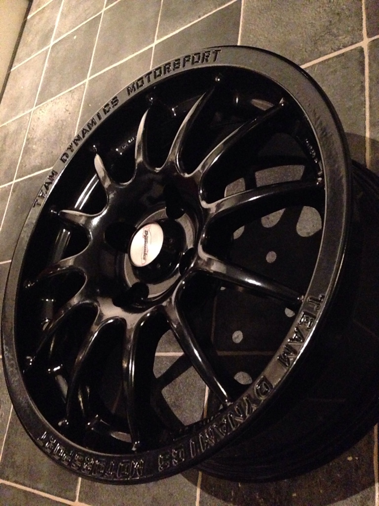

So after searching for months for a set of 15" 1.2 Team Dynamics I come across a set on eBay that had been put up. Instantly messaged the seller and offered him £230 cash as he was only in Wales, ad was for £250. He accepted and arranged to collect them on the Monday evening. Like a kid waiting for Christmas all Monday I was so excited, just wanted it to be 6 so I could go get them. Met him in a service station just off the M4. Looking at the ad they were described in as new condition, once I seen them in the flesh they were brand new. Not a single mark on them, never had tyres fitted. He purchased them for a kit car but decided to go 13" instead. The guy turned up in a 13 plate Mercedes and didn't even count the money once I gave it to him so explains why he just wanted them gone. So yeah £400 wheels for £230.

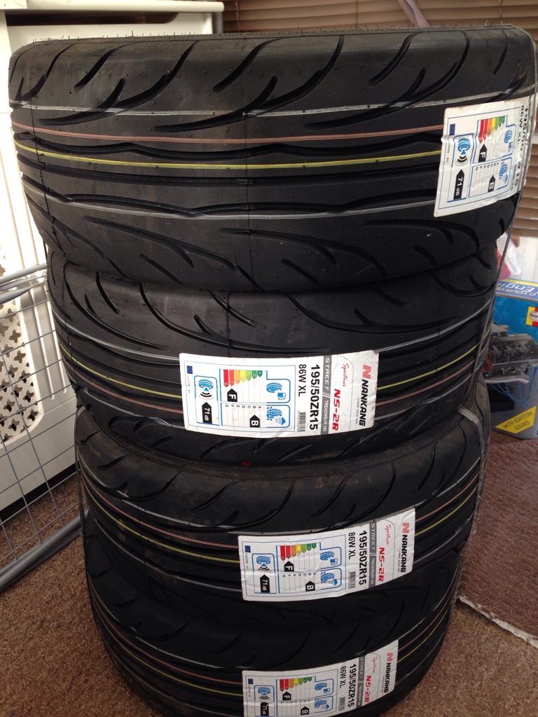

Once I had to wheels I went onto tyre leader and ordered a set of 195/50/15 in some Nankang NS-2Rs. With bank holiday weekend coming up I wasn't expecting them before the weekend as they have to come in from Germany but I was in no real rush for them.
Spigot rings got delivered but I ordered 74 - 60 what appear to be fractionally to big so have re ordered some 72 - 60 so hope they right....
Got home from the gf house on Tuesday and was greeted by my DPD delivery of tyres. Taking them into my mates tyre place to have them fitted possibly Thursday.
I have come to the conclusion that the 20mm spacers will not fit as if the wheels standard are ET35 + 20mm spacers you will be looking around ET15 so may have rubbing issues. TD don't stamp the ET on the wheel for some reason. Plan to fit wheels on their own and see how they sit, the studs can take 12mm slip on spacers so that may be the route I end up taking I think.

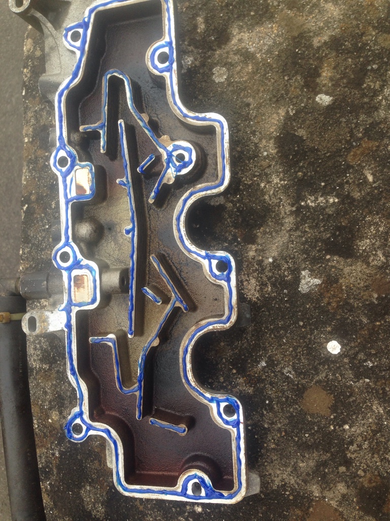

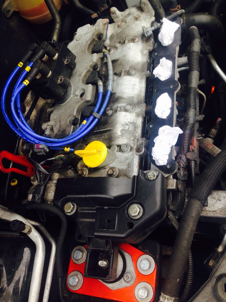

Spent the weekend trying to fix a leak that appears to be coming from my rocket cover breather plate. I noticed that one of the bolts on the rocker cover is actually snapped off so isn't ideal. Took it all apart and removed the steel gasket that is in there. I read that apparently the bolts are a bit soft so purchased some new ones off eBay.
On removing I noticed it had a bit missing was isn't a good start. I cleaned off the mating surface and re sealed it with some of the Renault sealant Resin. I wasn't overly impressed with the stuff as now after it has been back together a couple days the resin goes soft once warm.
Put it back on and tightened up the bolt and all seemed to be ok. None was oozing out to much anywhere.

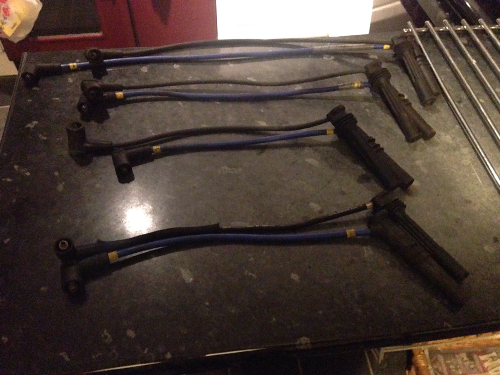

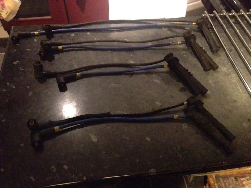

Decided now would be a good time to fit my magnecore leads. Fitted them was fairly straight forward, I didn't like how they clipped onto the spark plugs it felt like it wasn't a proper good connection. Went to put the upper inlet on and the no 3 lead was too short. It would plug in but was really stretched. Removed inlet to check if it was caught but was all fine. I ended up running number 3 under the inlet what wasn't ideal but wasn't squished by the inlet. Put it all back together and took it for a drive and I had a mis fire at idle and under load. Thought the coilpack may be playing up so swapped it over and still misfire. Pulled it all apart again and put the old leads on and now it is running fine. Was kinda getting annoyed as I been out since 10am and was now closing in on 6pm so I had had enough just wanted it running. When I next get a chance I want to swap the leads over but run the standard no3 lead and see if that makes a difference.
These are the leads, as you can see no 3 it is just too short
This was sort of the stage I was at but currently now running back on standard leads for now until I can sort them out. I checked them all over and none have any visual damage. I payed £25 posted off eBay second hand so no big deal.
Still appear to have oil on the inlet so I'm now starting to think the oil is coming out the snapped bolt hole. Not sure how I am going to seal it as my belts are not due for 3 years so don't want the rocker cover being pulled off. Might just see if the bolt can be extracted.
Little Update
Spigot rings turned up today, after 3 sets I finally got the right ones. 73 - 60 is what I needed as they a snug fit.
Put getting my tyres back till Monday now as the car is in for an MOT so going to do it all at once.
Also cleaned upper my rocker cover with some brake cleaner and no oil appears to have come back so at the moment my fix is all good. Will eventually get round to painting it silver. I have spray I just need to find the time.
