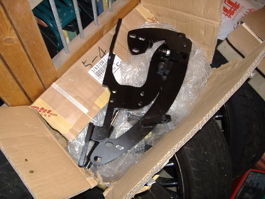

No i havnt finished my lambo door conversion yet but here are the hinges...
