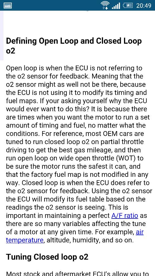

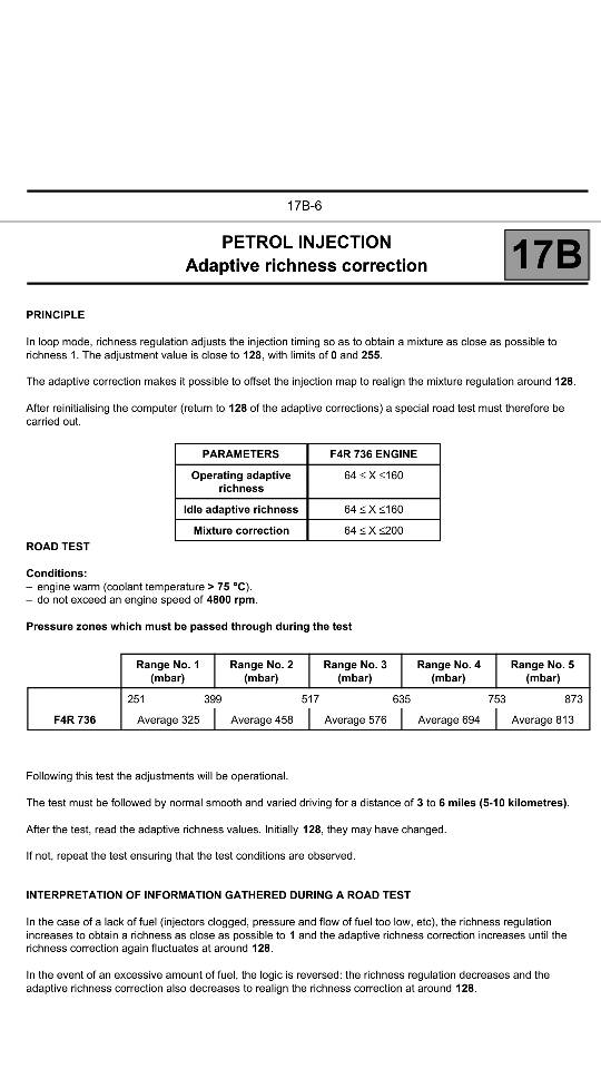

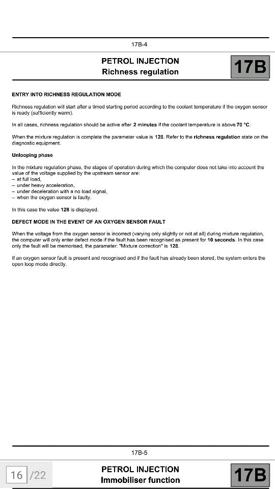

Maybe it's me but the conditions It says in the Renault manual that the Injection computer ignores the upstream sensor seem to contradict what your saying and on the next page of the manual it's states that you do not exceed 4800rpm if you are testing mixture correction.
