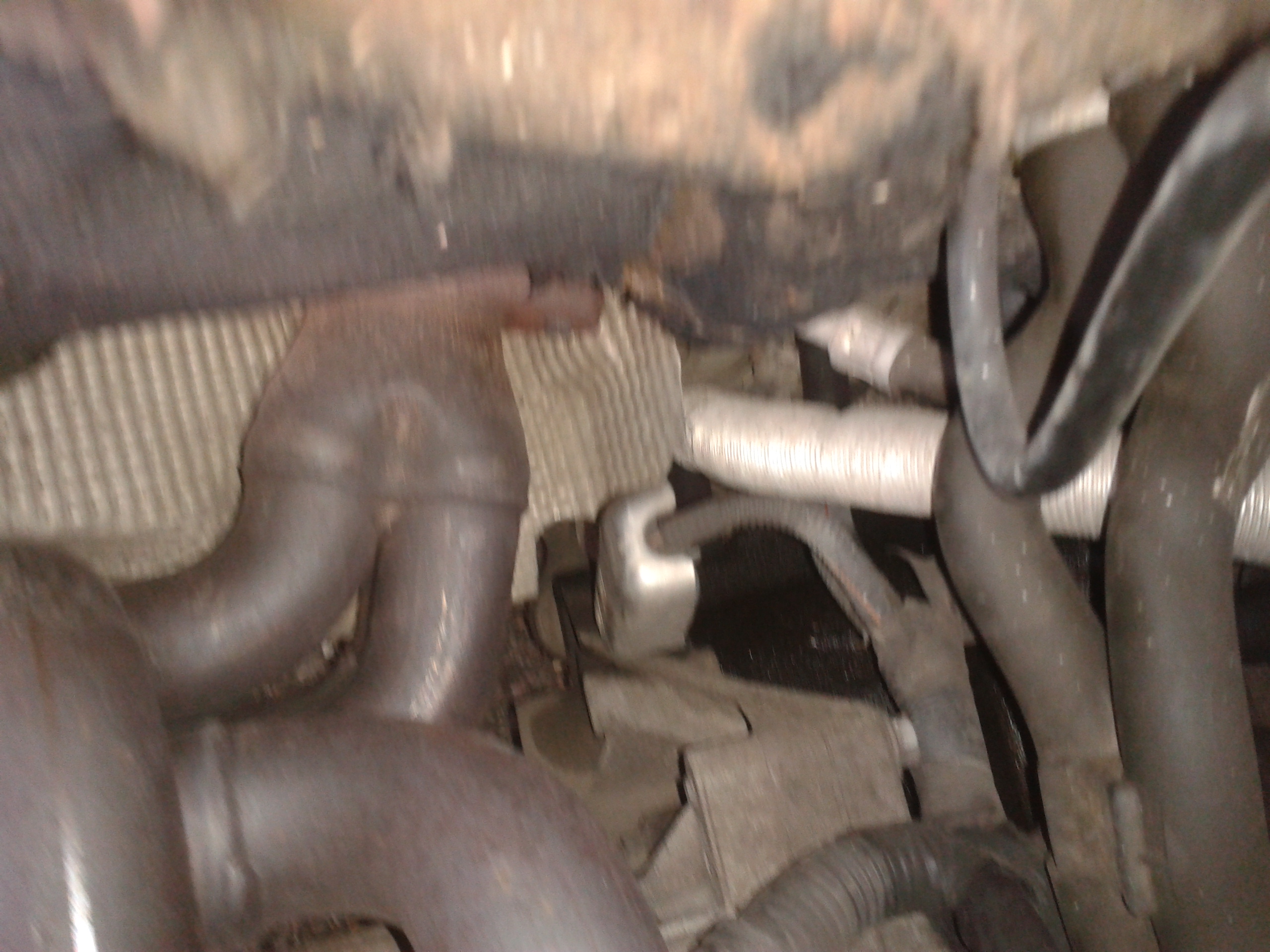

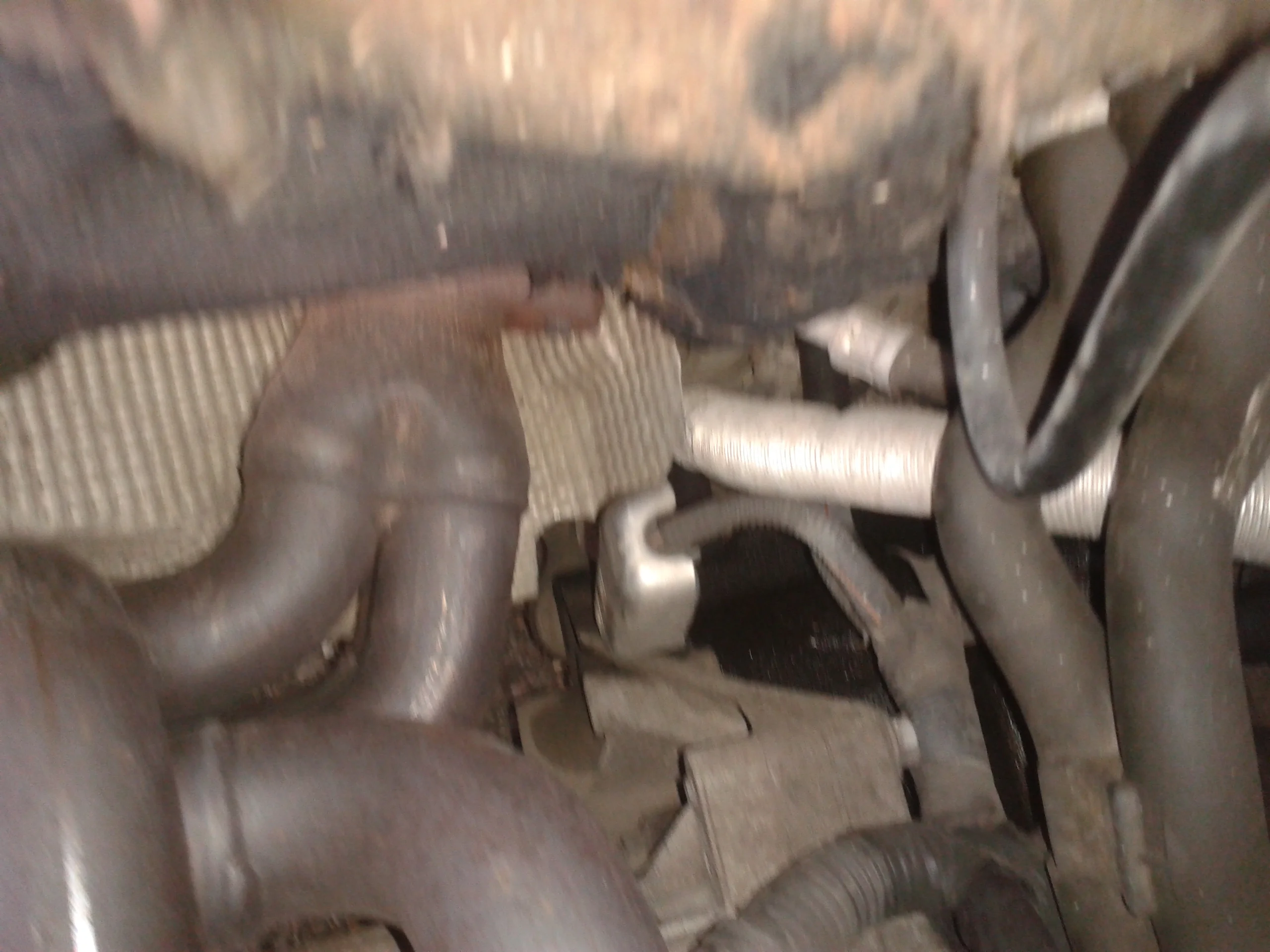

If it has a speedo drive on the rear of the box, it is not a 130.
I spent 7 months last year trying to find a 129, and all the 53 plates were 130`s.

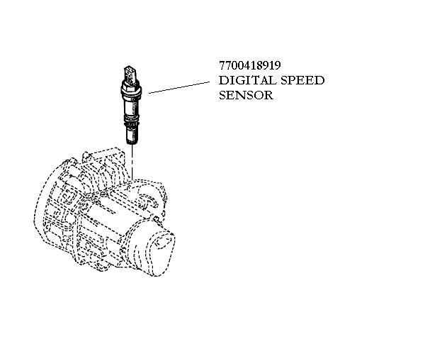

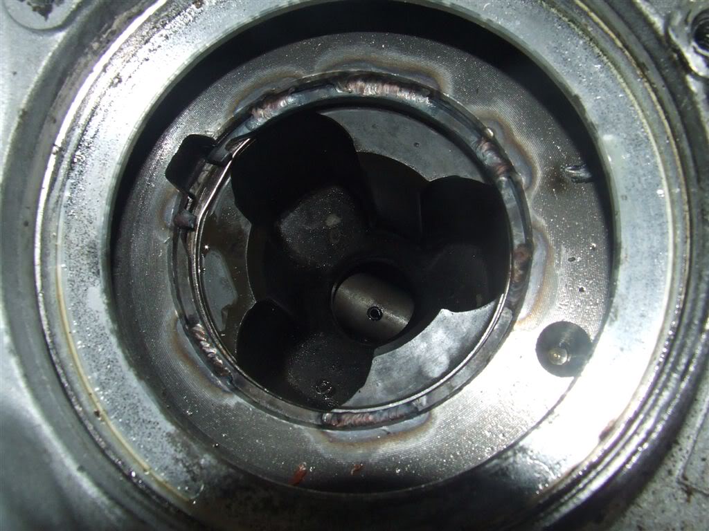

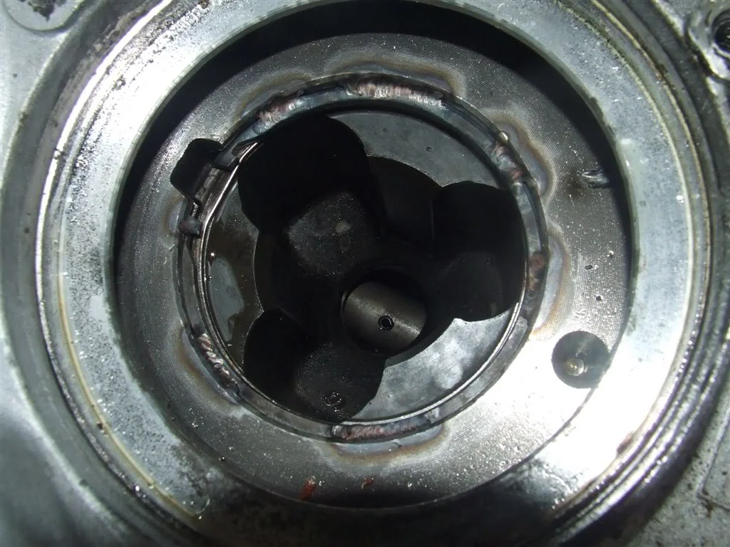

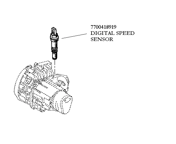

The 129 has the circlip & the speedo drive.
