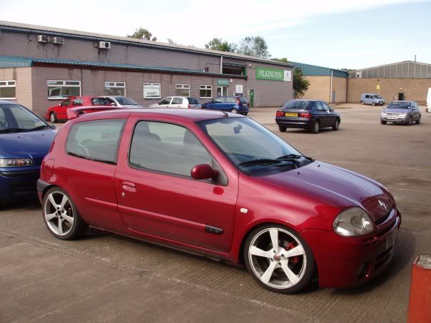

you need the shortened shocks mate, or you'lll wear it out very quickly! there's not enough travel to use a standard shock. here's mine on it's old 17's and a 40/60mm drop.
p.s. i'll be selling the kit next week, it's g-max 60mm shocks and springs at the front and 40mm springs at the rear, putting some eibach sportlines on. :D
