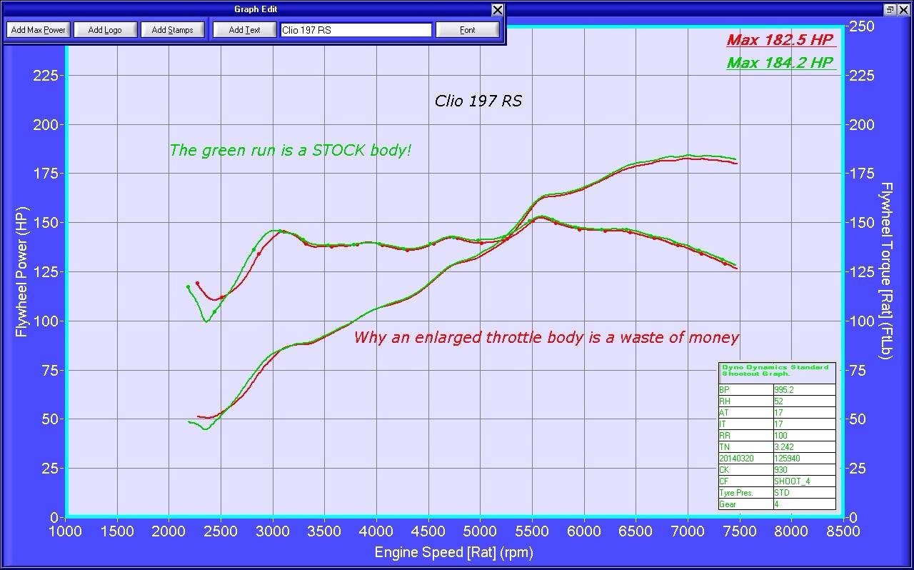

Search for a test that RS Tuning did as the TB is not a restriction.

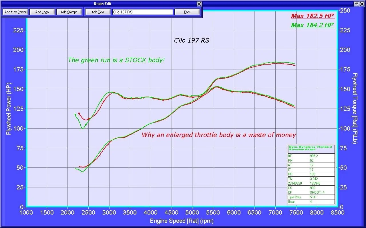

This again... face+palm
Here's the graph.
