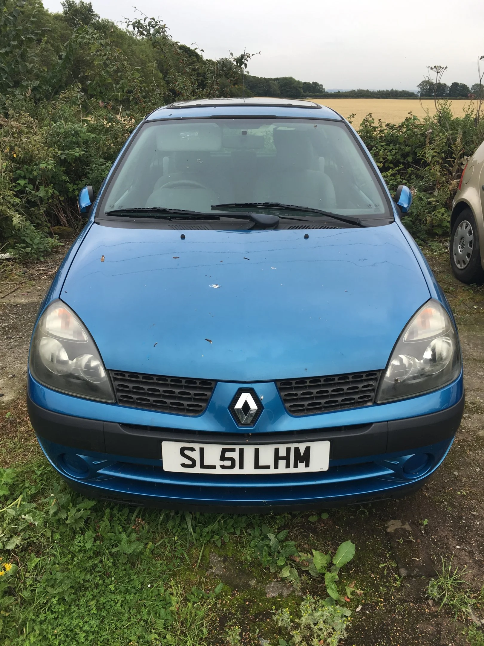

Hi there!
I have owned my little Mk2 Clio 1.5 DCI for just over a month now.
In the time I’ve had it I’ve had a couple of little niggles but nothing too difficult to get to the bottom too.
I’ve had a couple faults one of which was the EGR that I just cleaned out so no issue there however just recently got an injector issue which will need resolved. The engine is blowing black reek out the back and struggling to start on cold start ups. Obviously leaking off into the cylinder when engine is turned off.
I’ll be rectifying that fault when I’m paid.
It’s also just had a timing belt fitted before I got it.
I’ve got a lot of plans for the car:
First will be getting the Injector on cylinder 2 and a service including all the filters.
Coilovers
Wheels and tyres
Intercooler
Exhaust (turbo back)
Updated clutch
Rolling road map
Green stuff pads and discs
Headlights as misted
Bonet as damaged
Stage 3 detail
Could do with a bit of help with engine work on the DCI as don’t have any experience with this specific engine. Is it worth Hybrid turbo etc?
