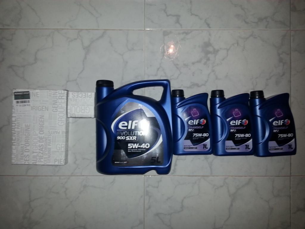

Things I have already done:
- Restore the headlights
- Engine oil and filter change
- Gearbox oil change
- Cleaned the seatbelts

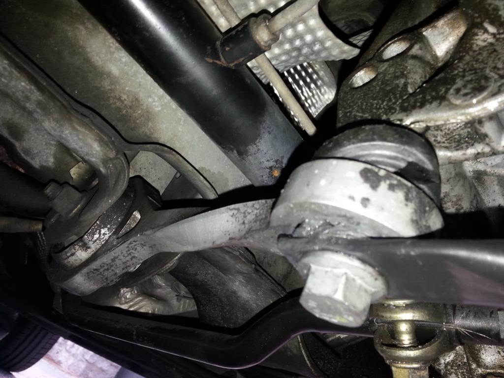

- Change the dogbone for the OEM replacement

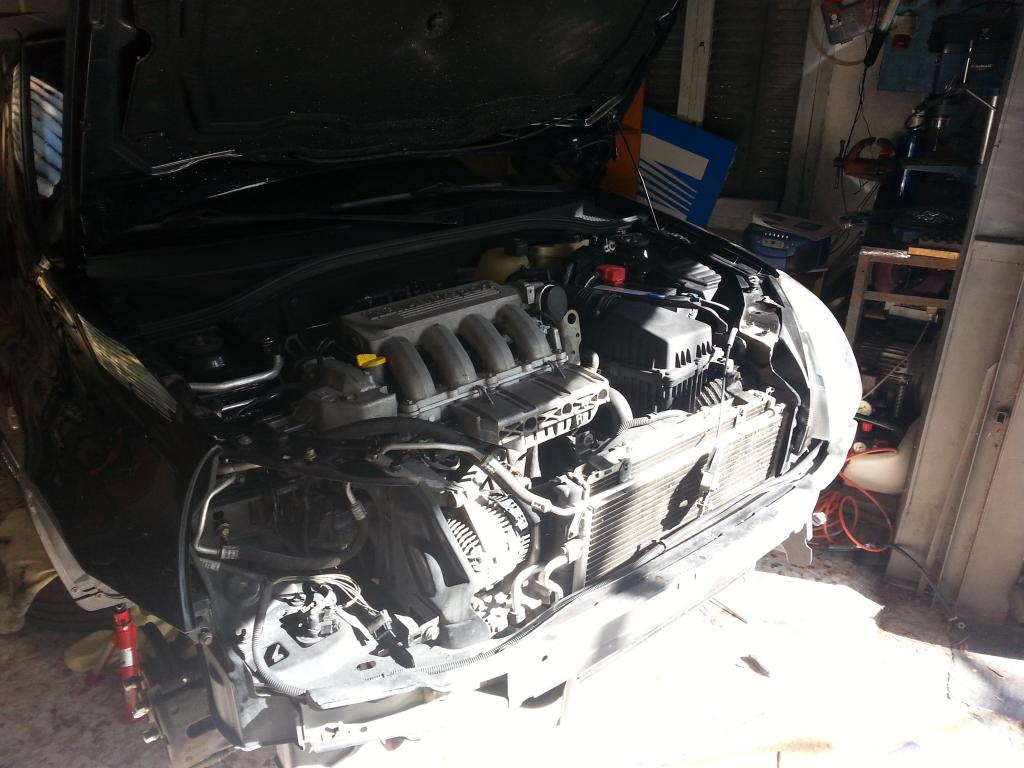

- Change Aux belt and tensioners
- Change ALL engine mounts
- Change rear exhaust hangers

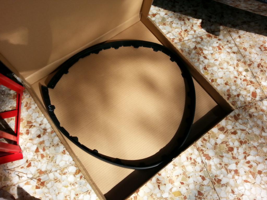

- Skoda fabia vRS splitter
Some pictures of this work being carried over:
The fabia Splitter

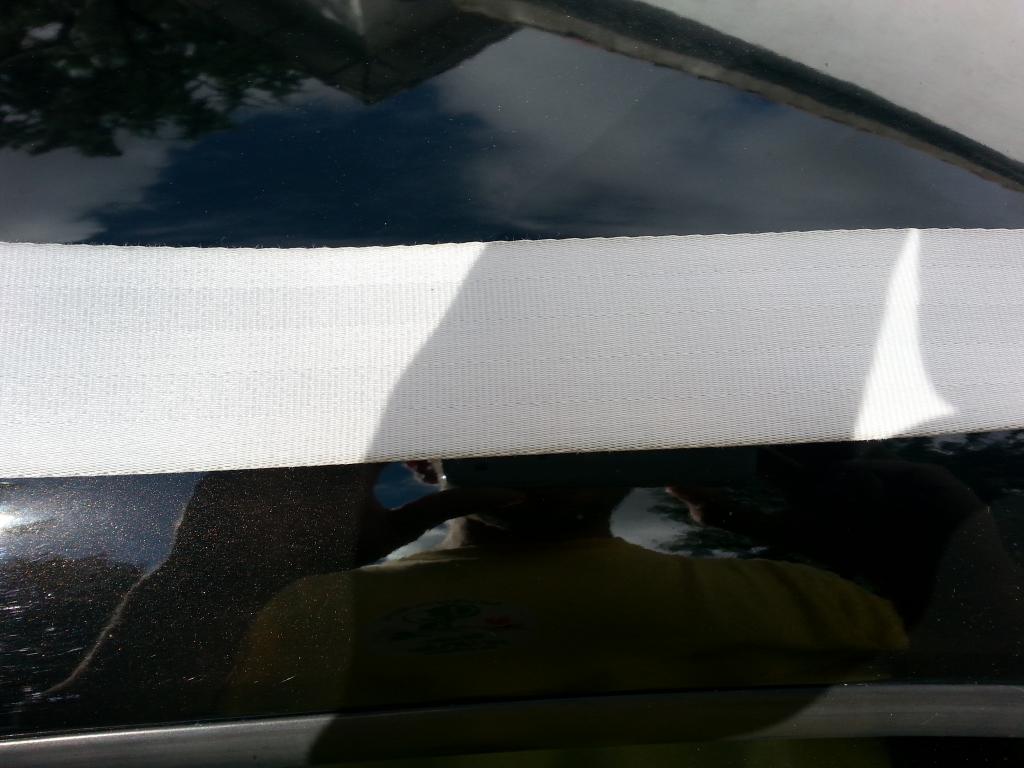

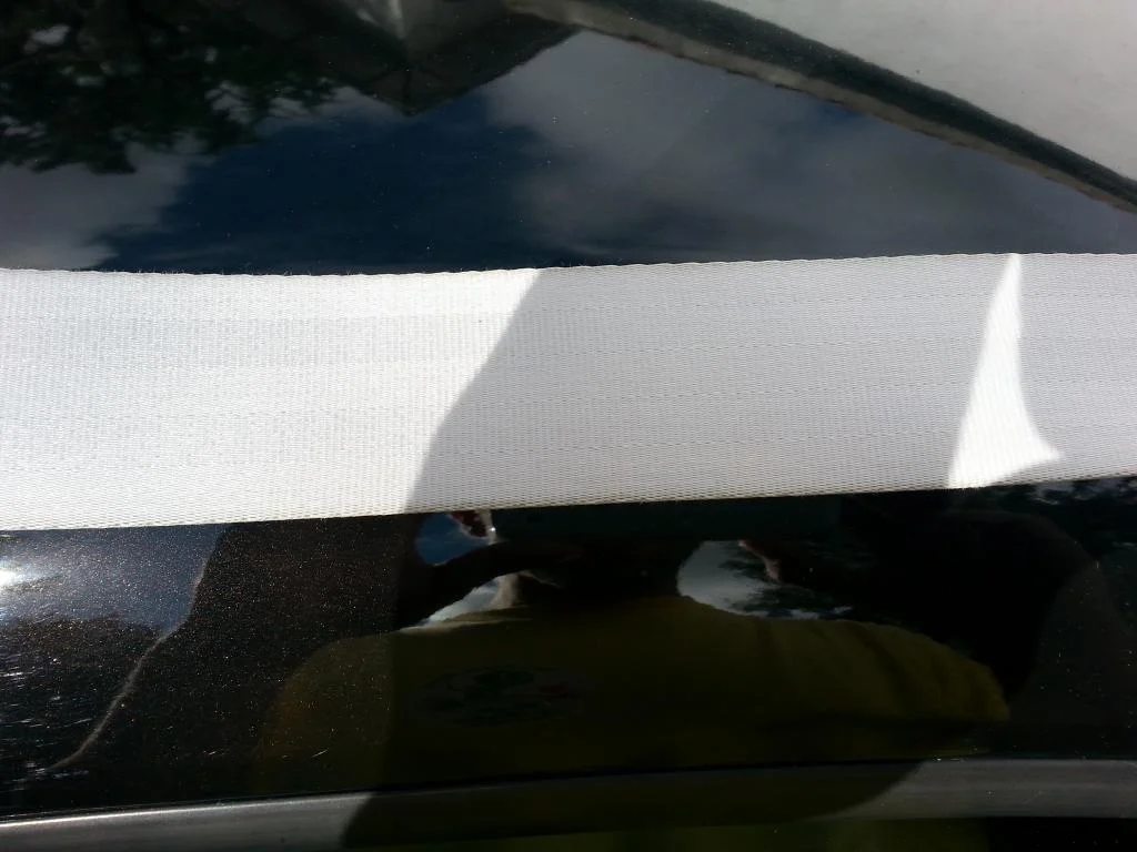

Cleaning the seatbelts:

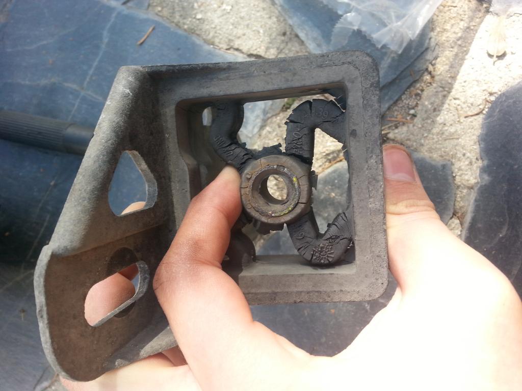

A "dodgy" dogbone

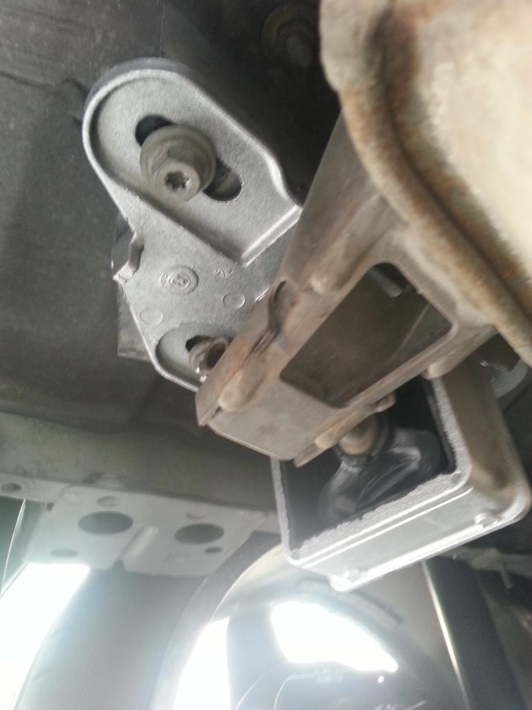

The exhaust hangers
And changing the Aux belt and tensioners and oils and filters

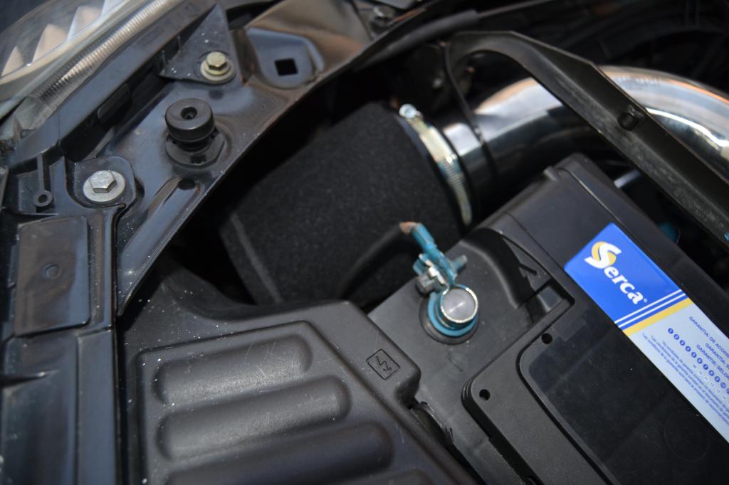

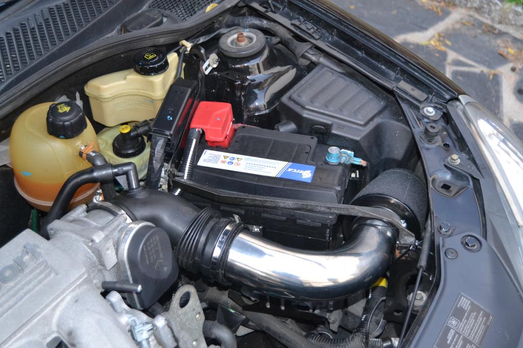

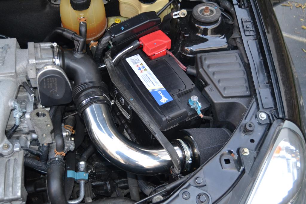

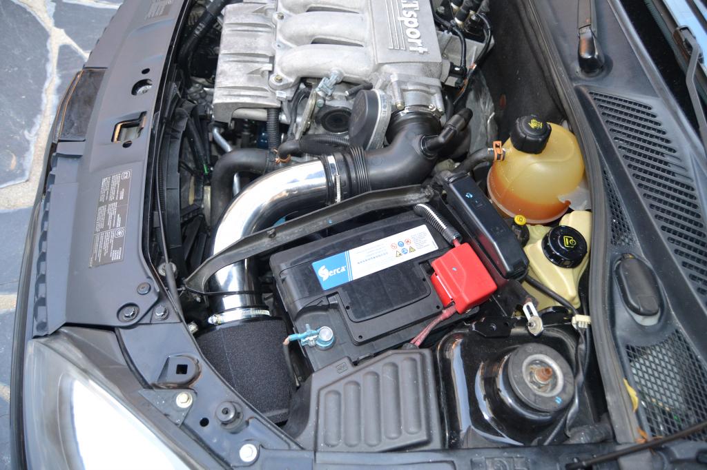

I installed this weekend the IK that The Fatty put together (Link) and everything I have to say is that is AWESOME! The sound it makes when pressing more than half way the throttle is amazing, and when you want to go like Flanders it makes no more sound than the original intake system. Here are some pics of it:
The only "problem" is that I am not sure how to fix it properly in place, but will try some options.

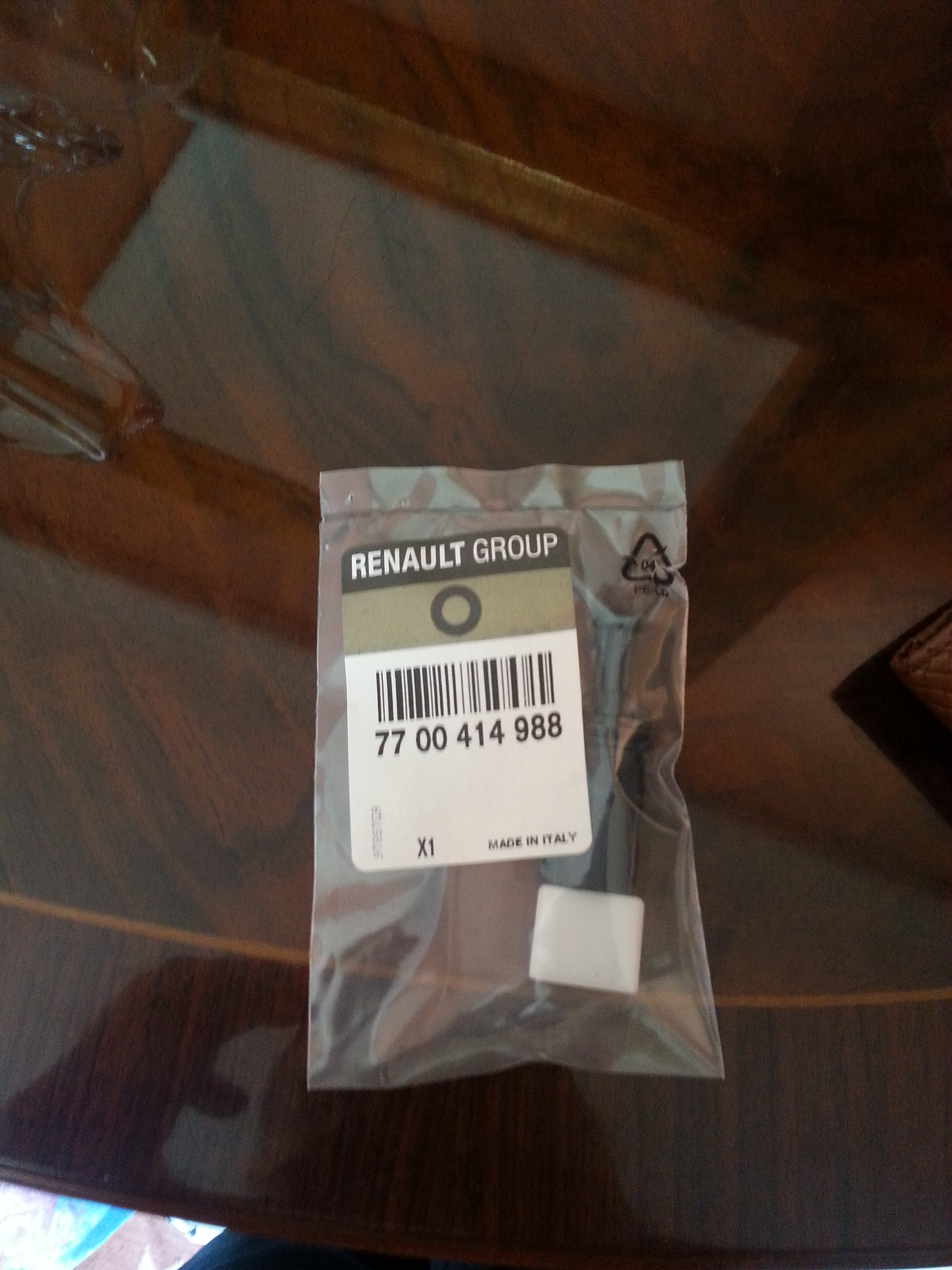

So not much has been going on with the BG, I had the ESP + SERV lights poping up randomly. After some investigation I found that the problem was with the brake pedal sensor and I reset it following a guide on here. That resulted on comfirming that it was indeed the pedal sensor as the lights poped up every time i was driving the car, so I bought a new brake pedal sensor and the lights have not come back again. Problem solved!
The sensor part Number was : 7700414988.

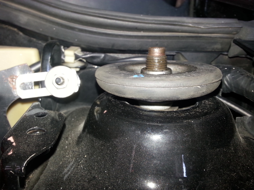

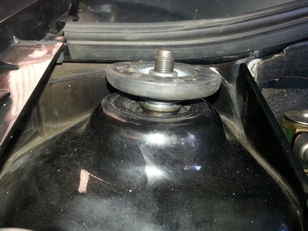

Yes, but not gone very far. I try solving the knocking noise by changing the top mount of the suspension, but I think i have done somethin wrong as there is a big gap between the top hat and the body.
Side with no Knocking:
New Item and still knocking:
The diference is pretty obvious. I have taken it apart both sides to compare and they look the same next to each other. Any help would be appreciated!
