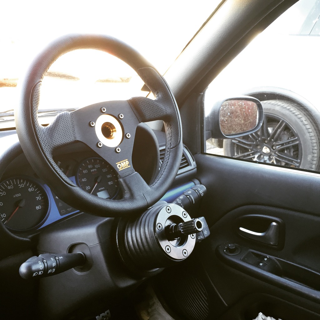

A short while after that I bought a OMP Trecento steering wheel with snap off boss assembly as it was on offer a the time.

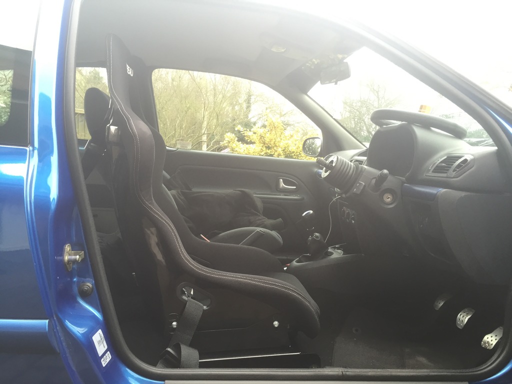

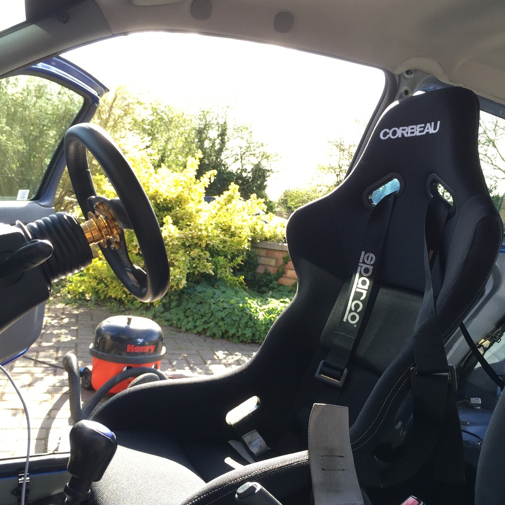

I bought a Corbeau Clubsport Bucket Seat with an OMP Subframe, for the money these seats are is great. Fitted with a 4 point Sparco Harness.

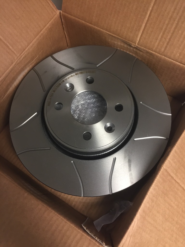

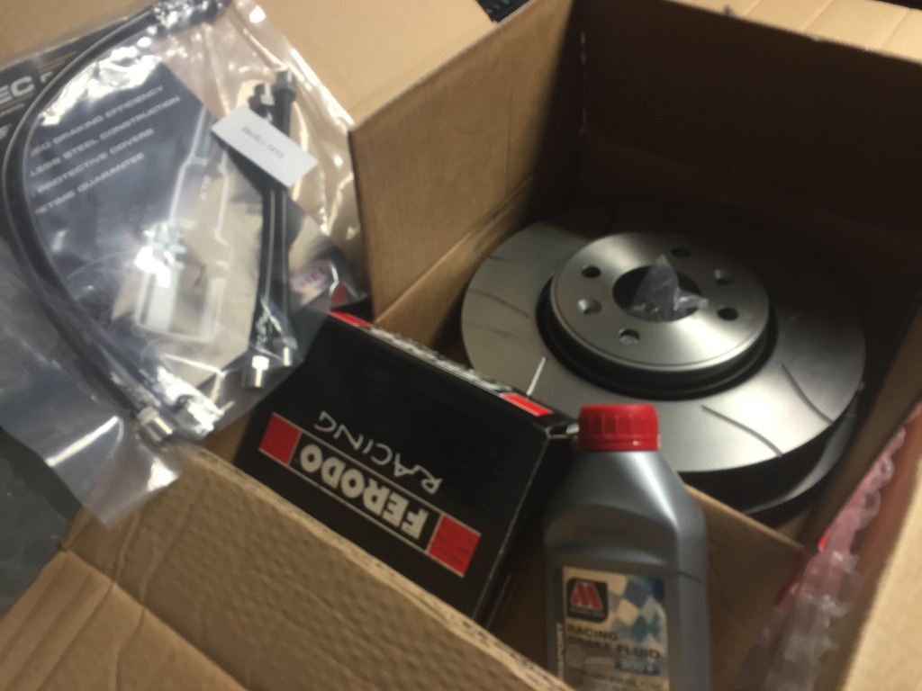

After getting my brakes rather hot one evening at a certain location somewhere in England KTR braided lines, Brembo HC Discs, Ferodo DS2500 pads where ordered along with some higher boiling point brake fluid.

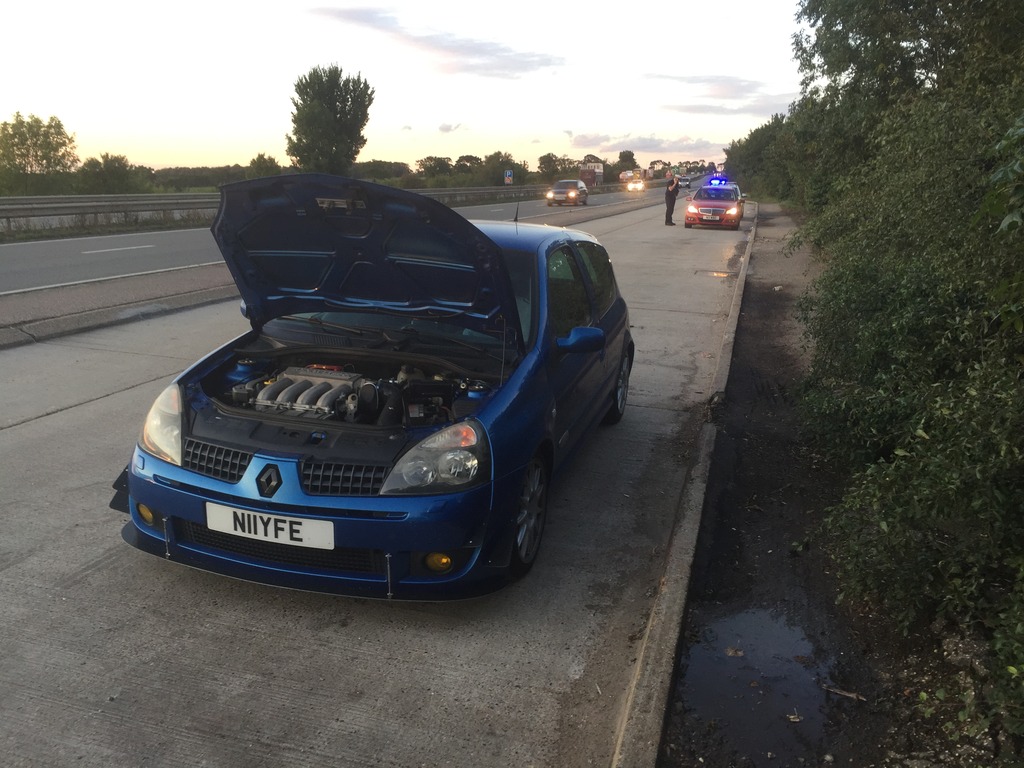

The clio decided it wanted to !@#* itself partially a little bit of my fault, but in short term I "Buzzed" the engine I was gutted. Threw the timing out, bent some valves, clutch decided it didn't really want to be in the right place anymore.
