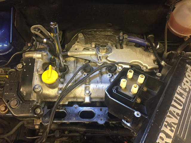

I ran over the road to the garage aftera facebook post or 2 asking for help, he plugged it in and had missfire across multiple cylinders. He wasnt 100% sure what it was. So I ordered new plugs, leads and coil pack.

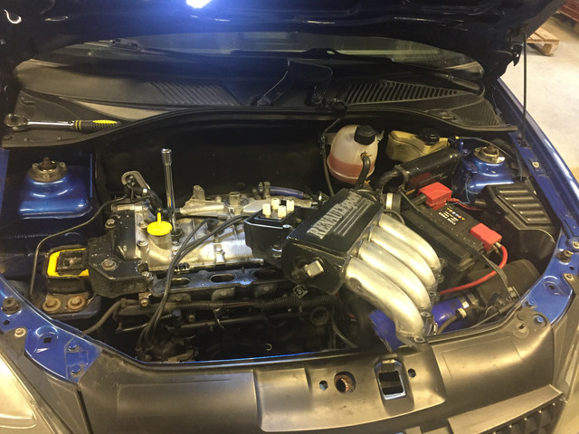

I set to work getting them changed, never done it before on a clio 172 but got there in the end.

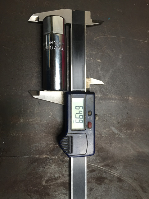

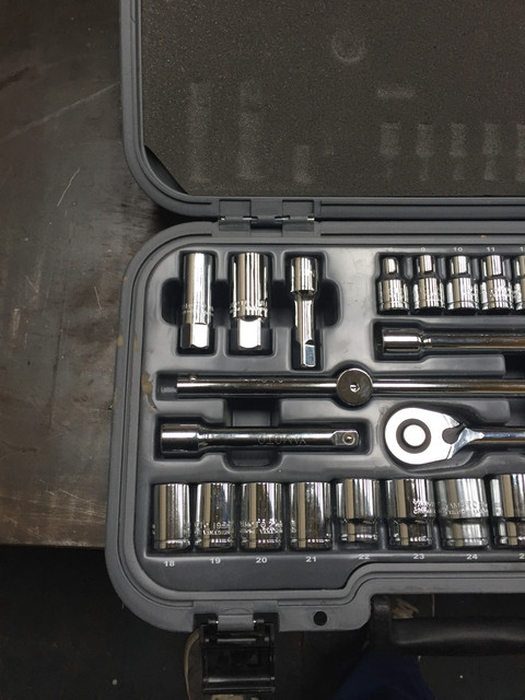

Luckily my socket set has a long 16mm socket required for the job. all the other bolts are the 10mm.

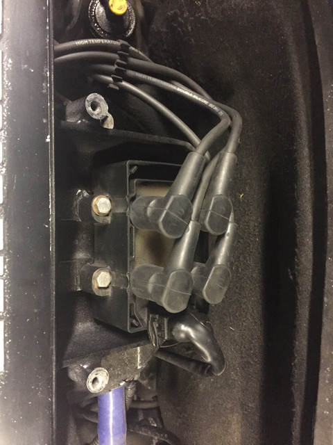

I stripped everything, noticing a few things. My coil pack was held in with 2 bolts only, so I need to get 2 more. I am also missing 2 rear bolts for the inlet manifold, I will get these asap as well.
couple pictures of the job being done:

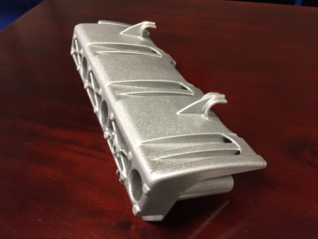

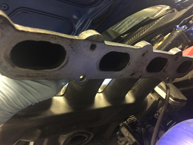

Looking at the manifold id say there has been 0 porting, polishing or matching done to either side, so that seems to have been a lie??
I maybe wrong and will eat my words if so, finish is small pitted like a shot blast / cast / spark erosion finish.

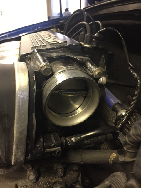

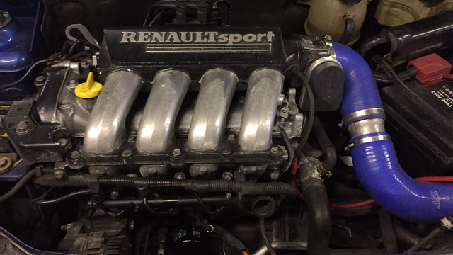

and lastly this is the TB, I am not sure if this is standard or not? If anyone can comment on that or put me straight that would be brilliant. I should of measured but had left my vernier in the other toolroom and was in a rush.

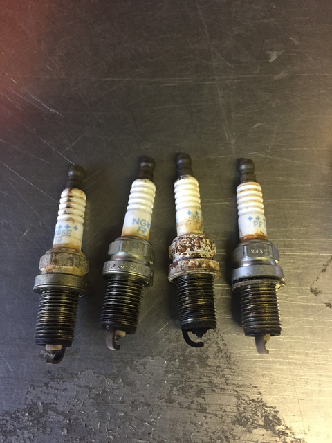

This was my spark plugs that I removed.
I dont know if cylinders are numbered like this but, standing looking at the engine bay from the front of the car, left being 1 then 2 3 4 etc.
Number 3 is very black?! and the shaft is very oxidized or weathered too? could this be a dodgy injector?

Throttle body looks standard to me.

I arrived at RS tuning, they plugged it into there diagnostic and commented the throttle body didnt sound right, it was making a whining noise.
I posted on facebook for a new one within the leeds area hoping to go get it fit it and do a dyno run!
no look but the ol owner saw my post and asked why I was changing the TB as it had a larger TB on. I said it was broken apparently, I also told him what RS tuning had said. This was the TB was standard, the car didn't have cams or had never been remapped as it had 1 flash on the system which would be from the factory. He said its probably runing around 160 bhp.
He could be right, I really don't know. I have never driven a standard one so am not sure at all.

Number 1 is the gearbox side.

You're right, the gearbox is on the RHS. It still doesn't change the fact that number one is on the right.

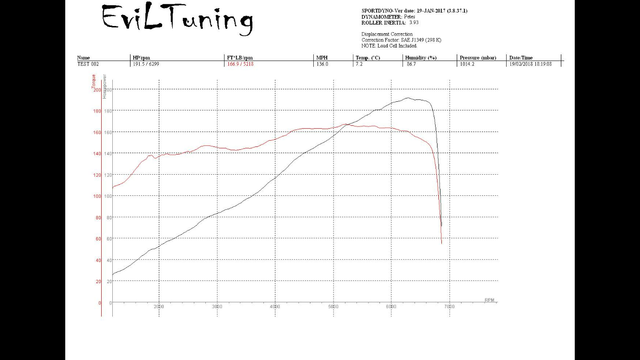

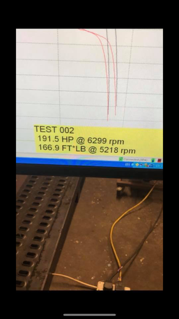

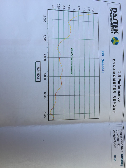

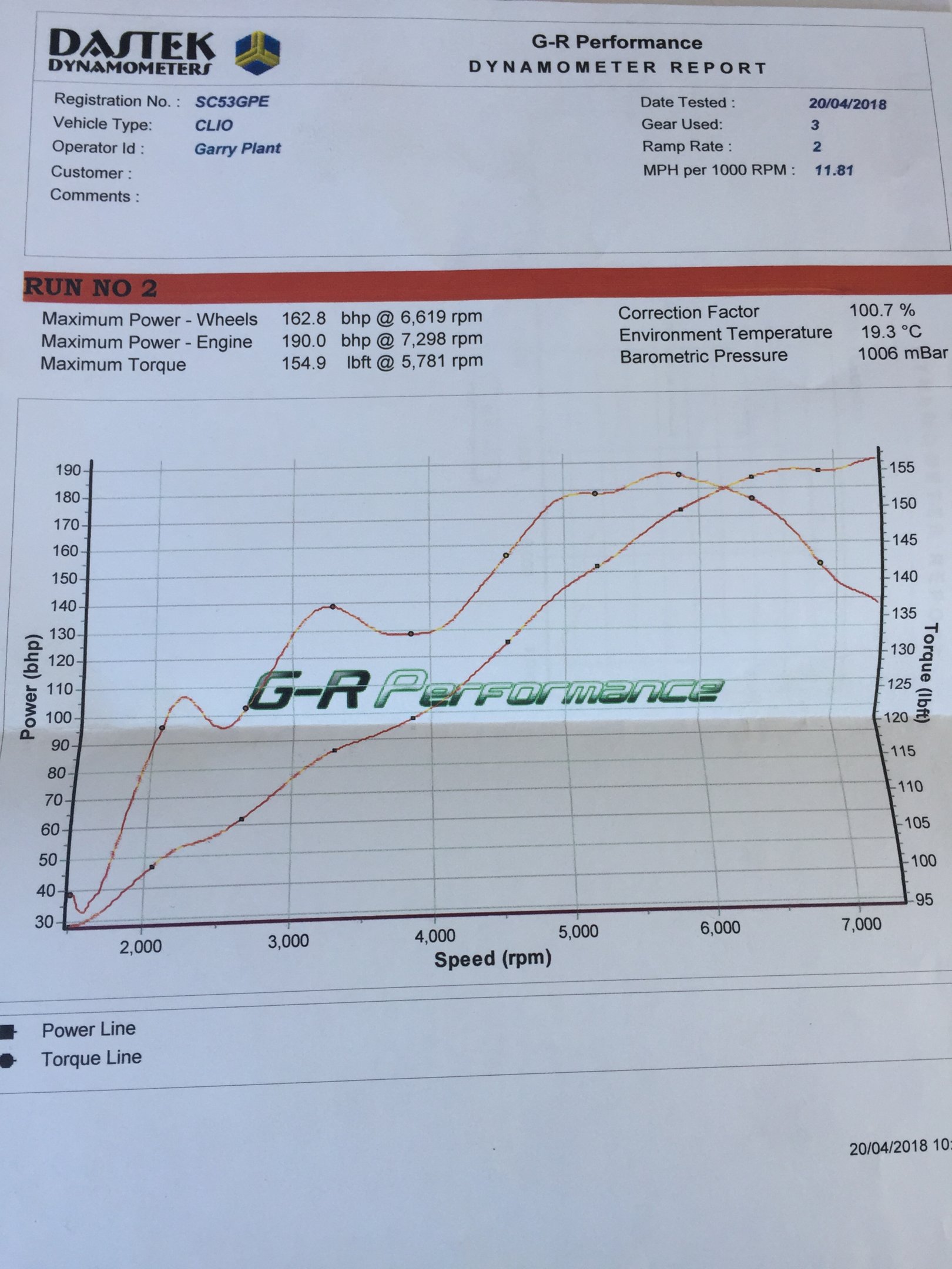

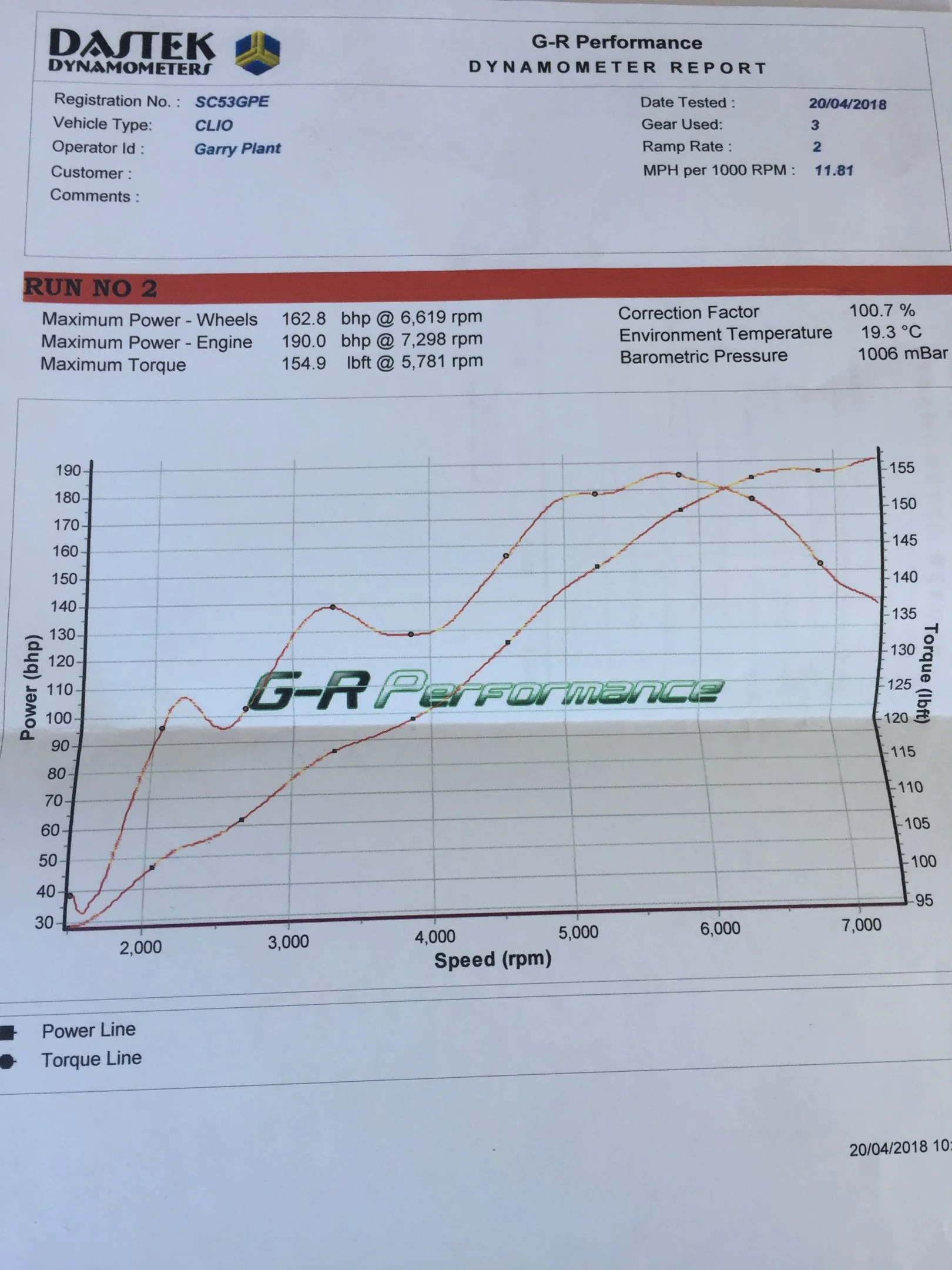

So I went to GR Performance today in Mexborough, they specialize in evos and Jap cars but it was only for a power run and AFR check.
the car made 190BHP, was really happy with the run. I mentioned the old plugs and they said to get either a new set of injectors or have them all flow tested.
at £140 a set its not worth testing and I will just fit a brand new set.
This car according to RS tuning is totally standard apart from an induction kit and exhaust, load of b****cks!

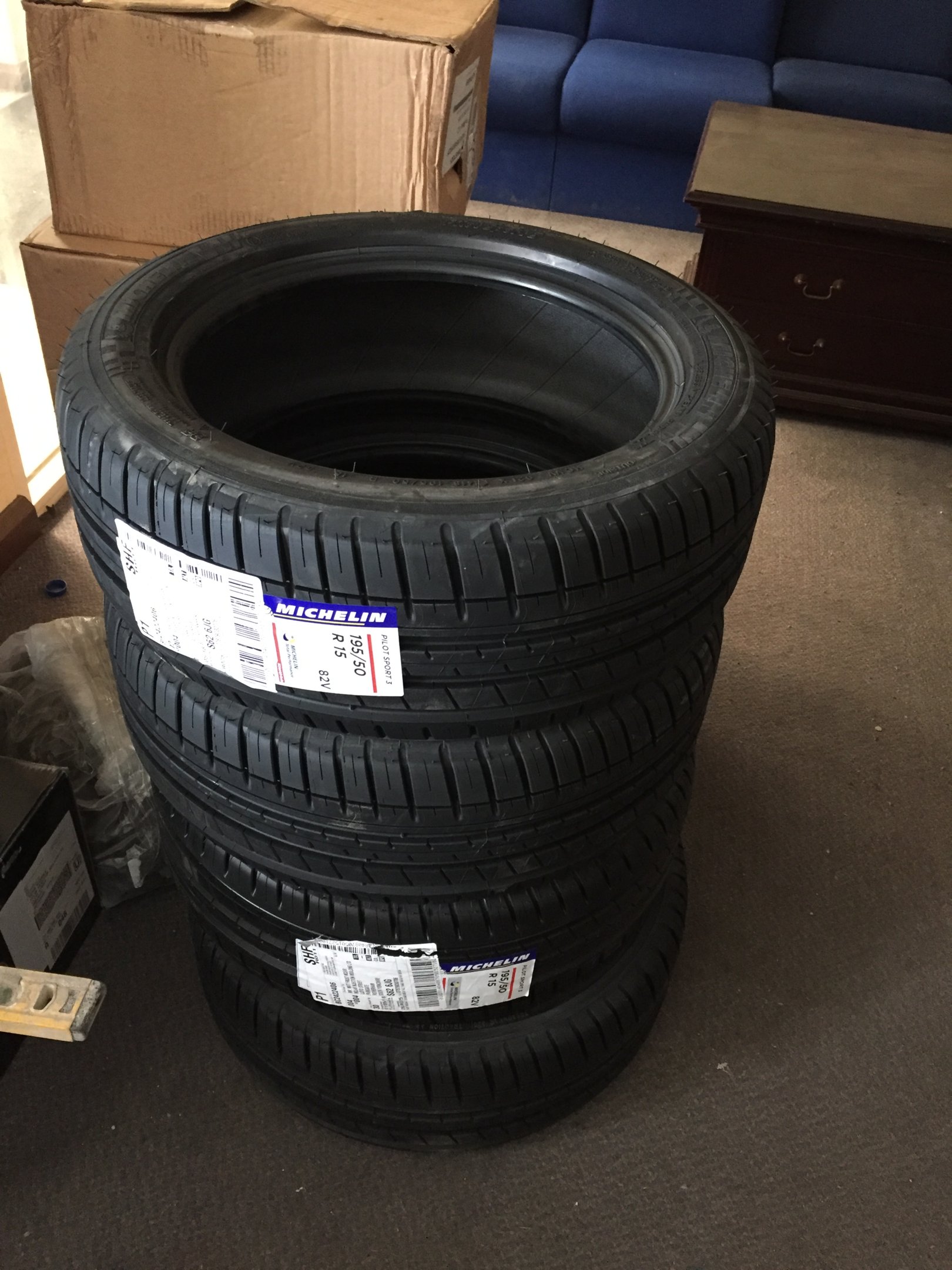

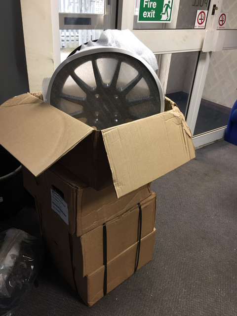

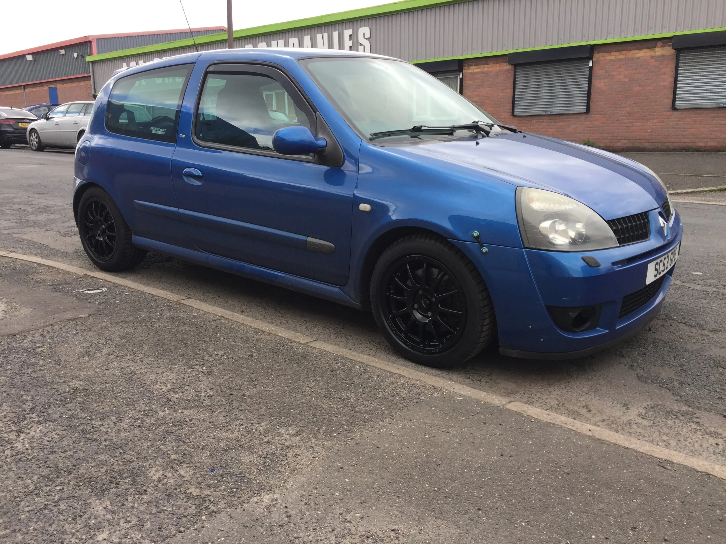

well after a couple of weeks of looking for some 15" wheels and being offered second hand sets with minor marks for £300 I decided to order a brand new set from rimstock with the correct centre bore.
Just need the tyres now!
I have ordered Pilot sport 3's, £220 for a set of 4.
Looking forward to a test day at Curborough in June now!

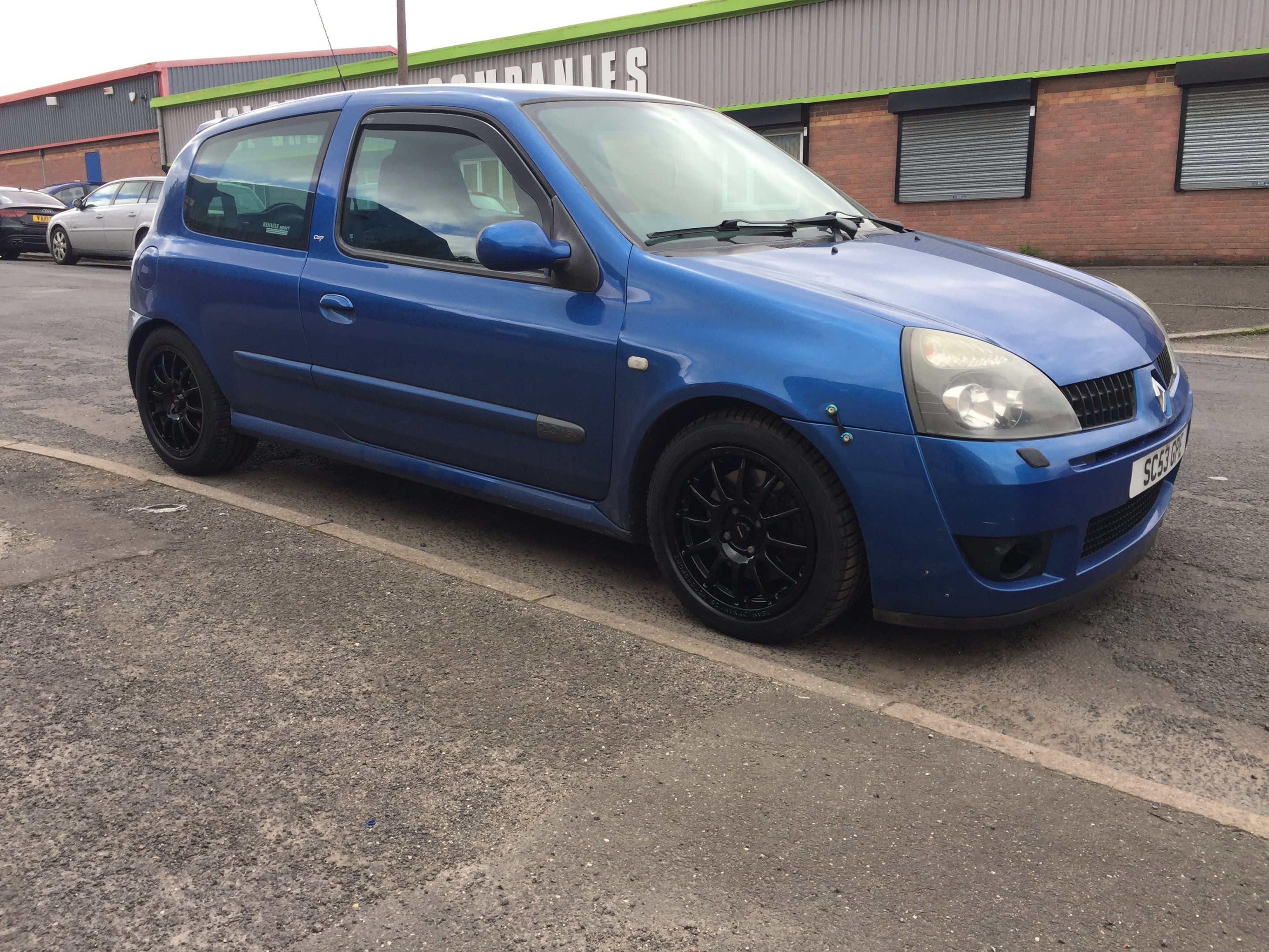

tyres came, so got them fitted and banged on the car!
not a great picture I know, will get some decent ones one day!

So a little update.

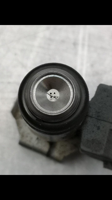

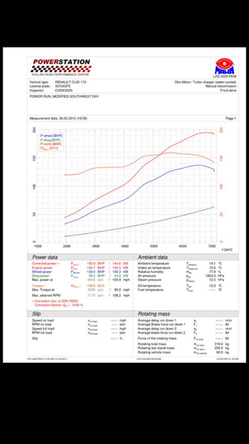

I had the car rolling roaded but the RR bloke said he thought it had an injector issue that might be holding it back a little.
I was still happy with the result, but would of liked to have seen a few more bhp to match the other graphs I have for the car, its only 3-4 bhp out though.
Here is the graph

I then ordered a full set of injectors from Renparts, around £130 so not expensive really, althought I was tempted to change the one I thought was going to be bad anyway due to the spark plug.
Dead easy to fit, I just followed this guide .
The injector I thought was bad, definitely was, it was crack very badly.
It has made it run a lot better, it still has a missfire when cold when on very light throttle around 1500 rpm, I have read on the forum that can be quite normal though!

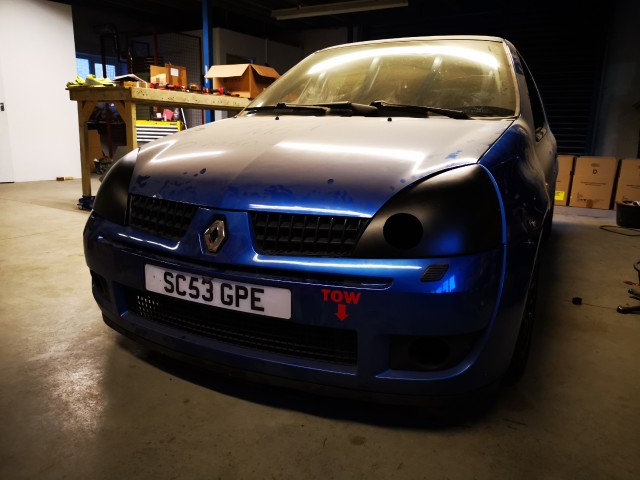

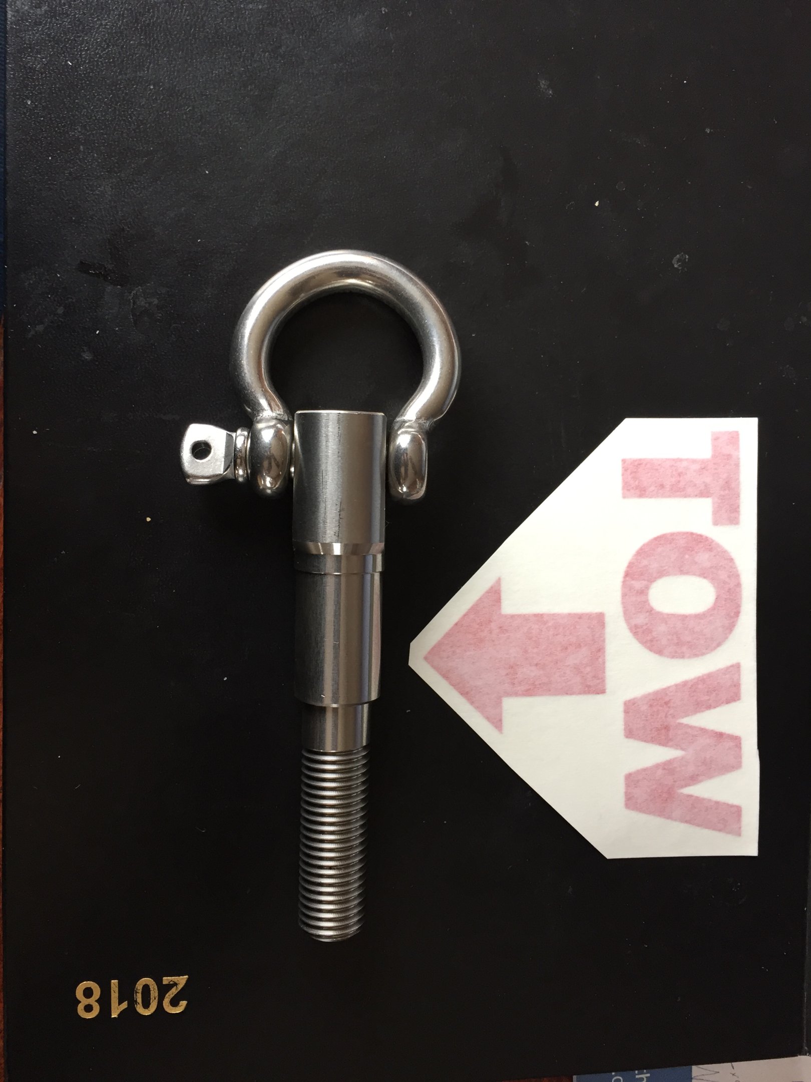

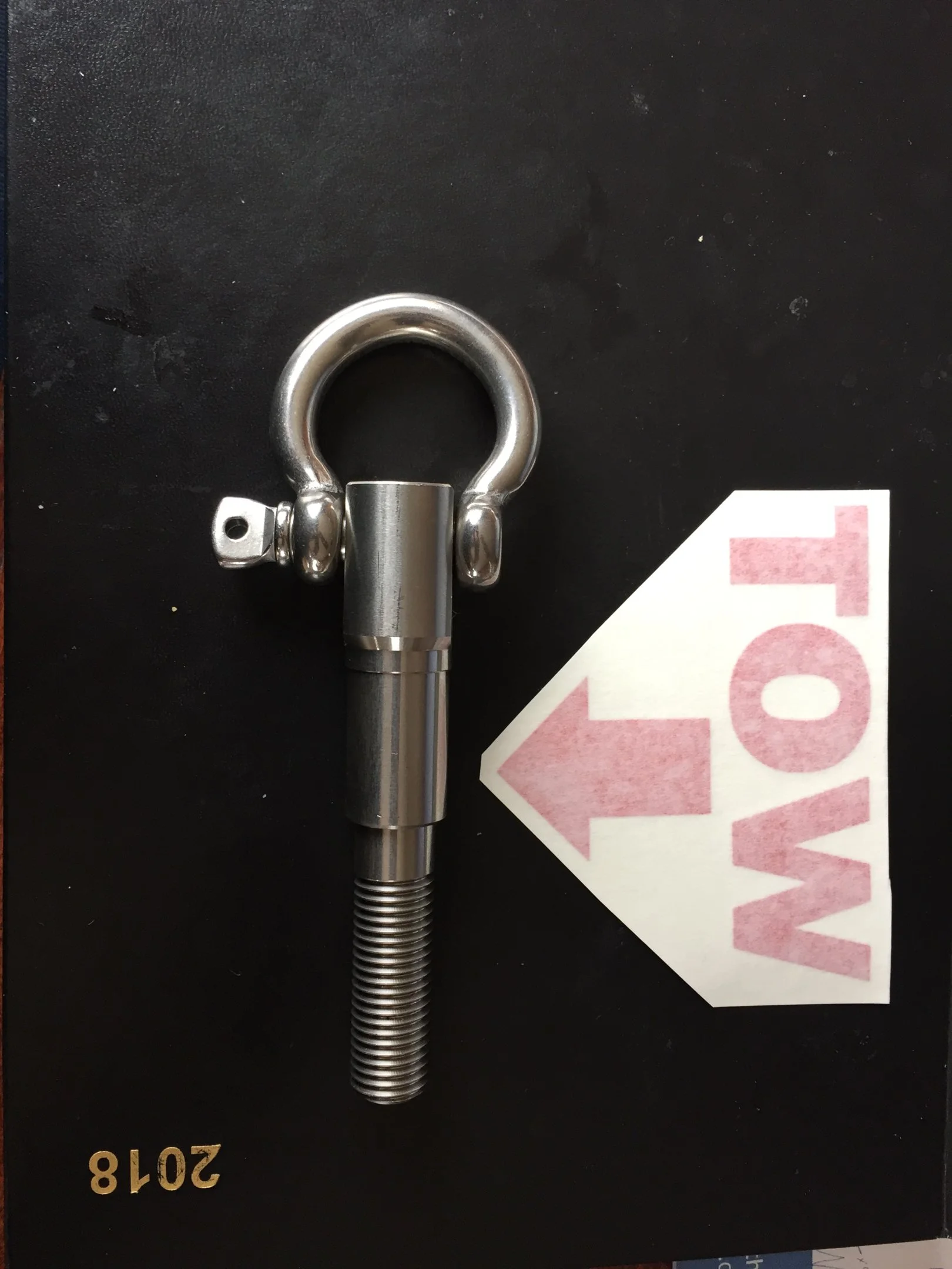

I then fitted the front tow hook and sticker.

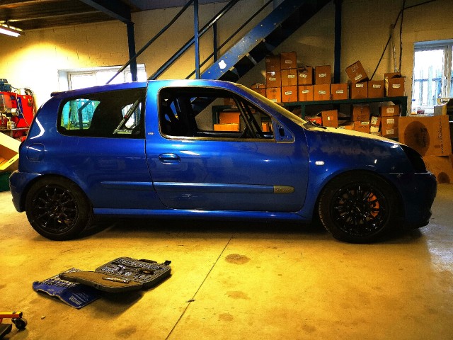

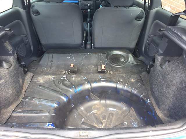

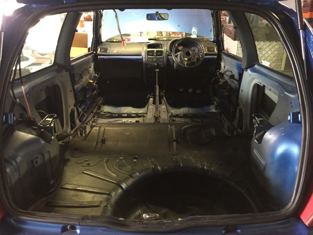

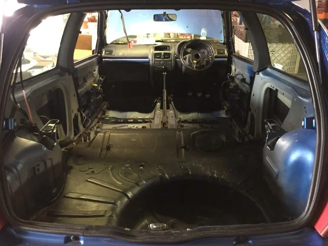

I have stripped the rear seats out, with the aim to fully remove all rear trim and a lot of the front trim.

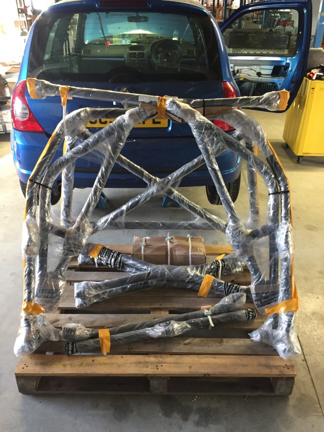

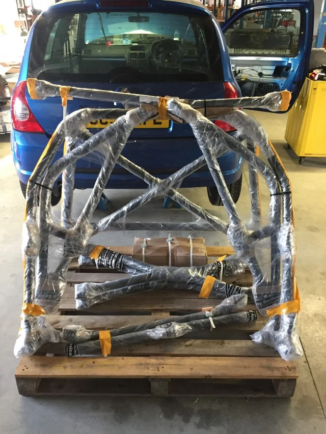

I have just joined the markfish R022 rollcage group buy with a rear cage option 2.
I also ordered myself a set of racing gloves for when on track at I find this steering wheel to be terrible with sweaty hands. I decided to go for these, in blue to match the car!
https://www.demon-tweeks.co.uk/motorsport/race-gloves/sparco-land-rg-3-1-race-gloves

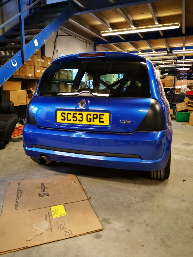

I have just nipped to the lads next door (scrap yard) and had the car weighed. I filled up to the redline with v power this morning so my tank is literally as full as can be, the weight of the car (without my lard arse) 998kg - 1000kg (was flickering between but settles at 1000kg)
Very happy with that, a lot more trim to come out, plus passenger seat on race days.

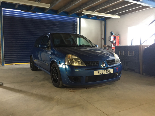

Car is looking like this now

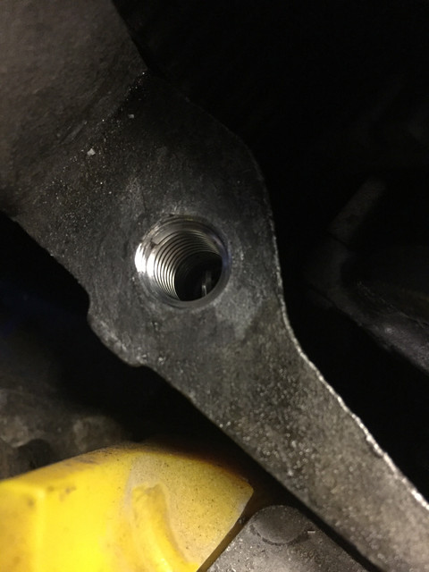

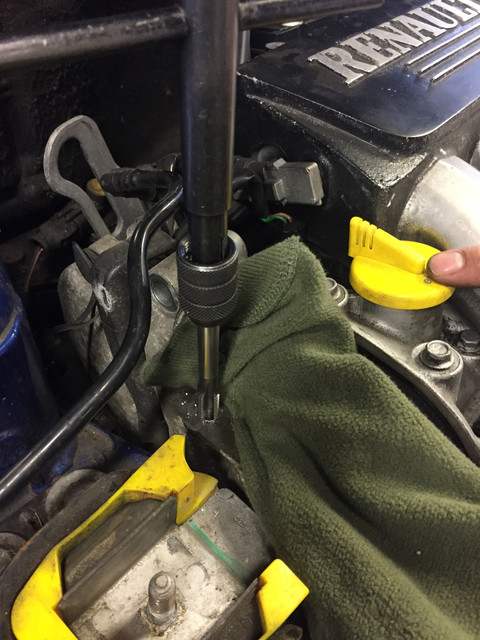

Managed to sort the engine mount.
I put a jack under the sump with a piece of wood to hold it up, I then removed the bolt and engine mount.
Drilled and tapped the hole for the helicoil and inserted it.
Refitted it all and good as new!

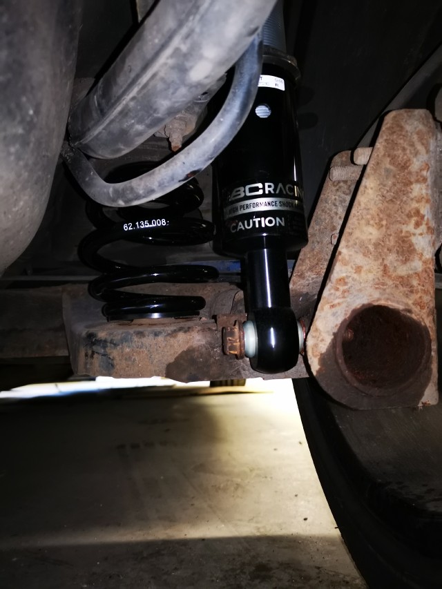

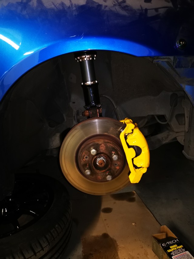

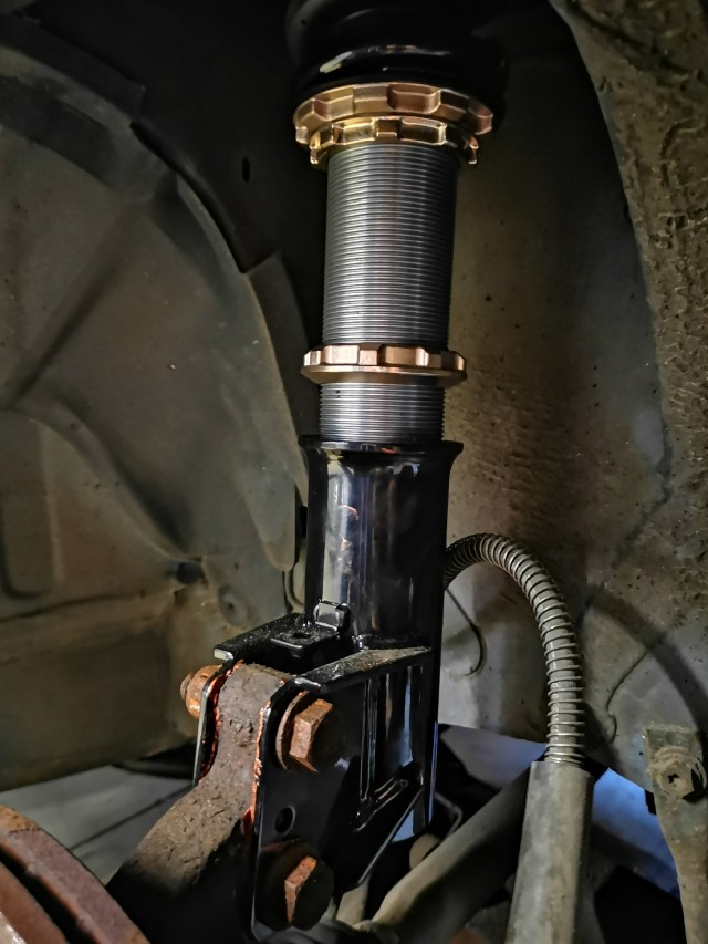

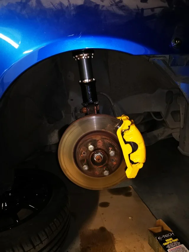

my front suspension look a bit s**t.
not sure if its standard or not but its weeping a very little bit at the top, the rubber cover at the bottom is just doing nothing and could be pulled out etc.

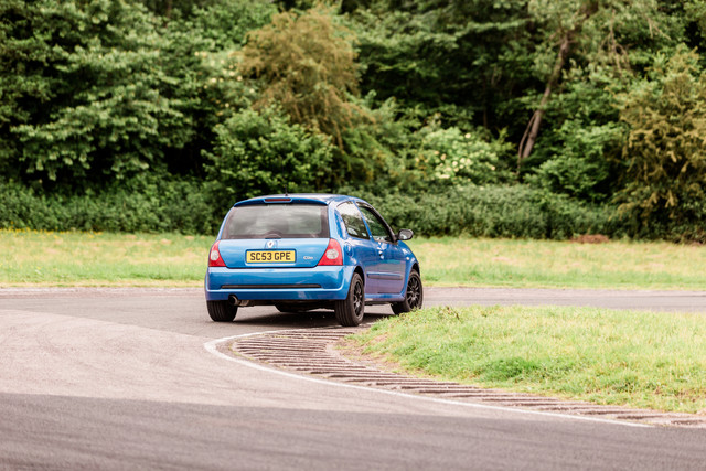

Well this weekend i was at curborough practising.
We have to use the middle gate not the bottom one for H&S reasons, so the times are no use to compare etc as no one does that loop.
The track was a 3 lap with figure of eight, this meant starting at the side gate,
straight into turn one
through the chicane
round the top corner and all the way down the straight
doing the same outer lap again
cross right into the middle
around turn one the wrong way
halfway down the straight
turn left onto outer edge
round the last bend and down across the line.
Cant remember my exact time but I think it was 1.32 something
Fastest thing there on the day was a 500bhp ford KA this was in the 1.31's
I was also beat my 2 x quite new focus ST's, one running around 330 the other 380. they were both in the 1.32's
Really enjoyed the day, great atmosphere and plenty of track time. I think I went out about 10-12 times so 30-36 laps really. Not bad for £70!

First things, new throttle body and car is running the best its ever run (touches wood). I did some speed trap test as comparisons and its only 4mph away from my 340bhp impreza managed on the same stretch of road! god knows how, must just be because its so good to drive and feels planted in the corners!
Thought I would share a couple of pics from the track.
Heres me looking cool as pluck!!
And I think this is one of my favourites, even though it shows nothing :p
Was a great day, just need to watch what i spend for a couple of months now and then I will start getting the rest of the stuff ready for next season.

Since then I have taken the car off of the road to start the work on it. I have removed a lot of the interior, seats, electric windows, wing mirrors, front glass and all carpets.
Hoping to get the dash out this week, plus head unit and airbags etc. They I will trial fit the cage, and look what metal I can cut away from the doors, bonnet and boot lid.
I have also removed and sold the headlights and purchased fibreglass blanks. I will be doing the same for the rears.
I feel a realistic figure to hit by testing in march will be 920KG with the cage and seat etc all fitted.

Here's a pic of the car as it is.

The cage is fitted and finished (just need to under seal where its been welded).
I am making some mounts for the seat as its quite wide it hits the cage so I need to move it closer to the handbrake.
Suspension is here, in the end i went with BC DS with 10kg front 8kg rear springs and the top mounts. They are not fitted yet though.

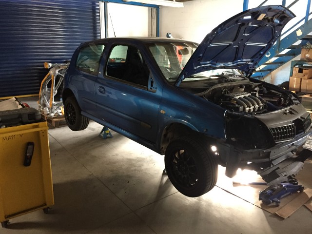

just a few pics for updates.
Fitted the suspension
Cleaned and painted the calipers just so they look fresh and I had a spare hour.
Sprayed the fibreglass headlight blanks fitted
Also cut a hole to let air get straight to the filter.

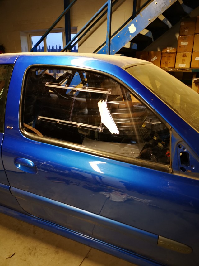

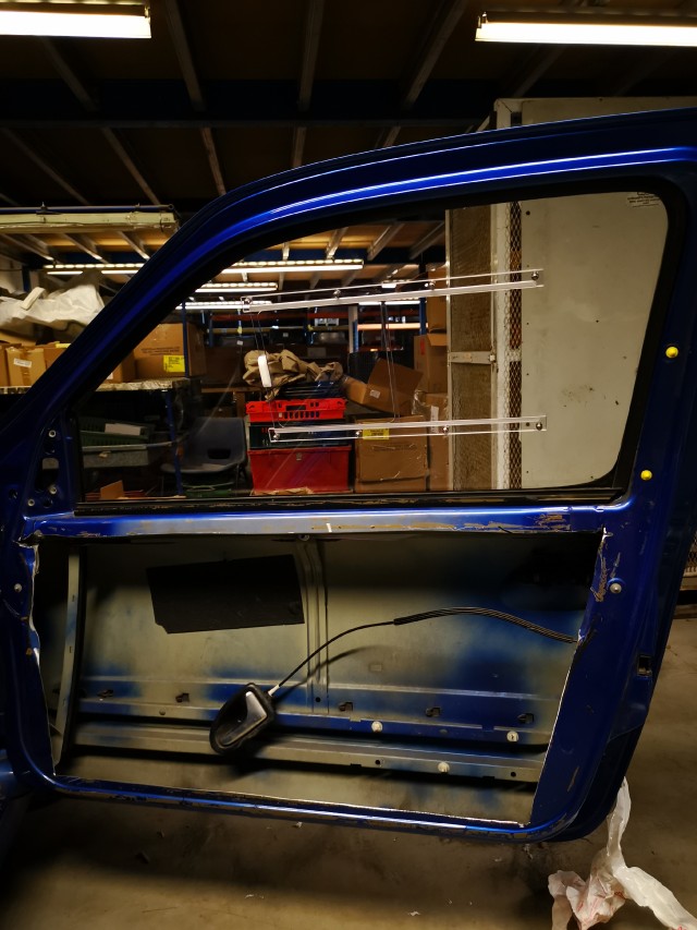

I then started cutting the doors and fitted one of the polycarb windows. I will do the passenger side and rears tomorrow hopefully.
Then it will be time to get the holesaw out and try and save a little weight.
