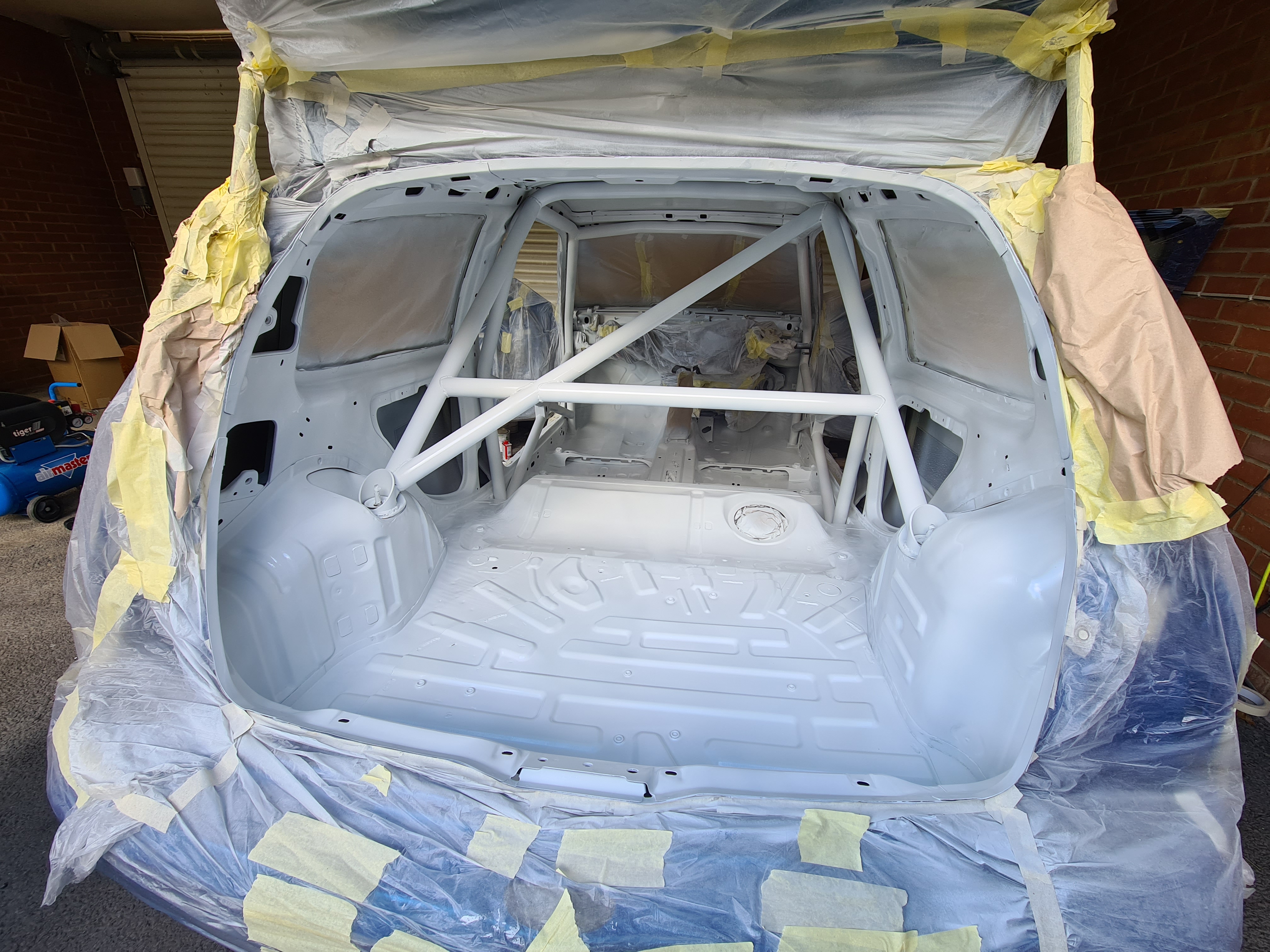

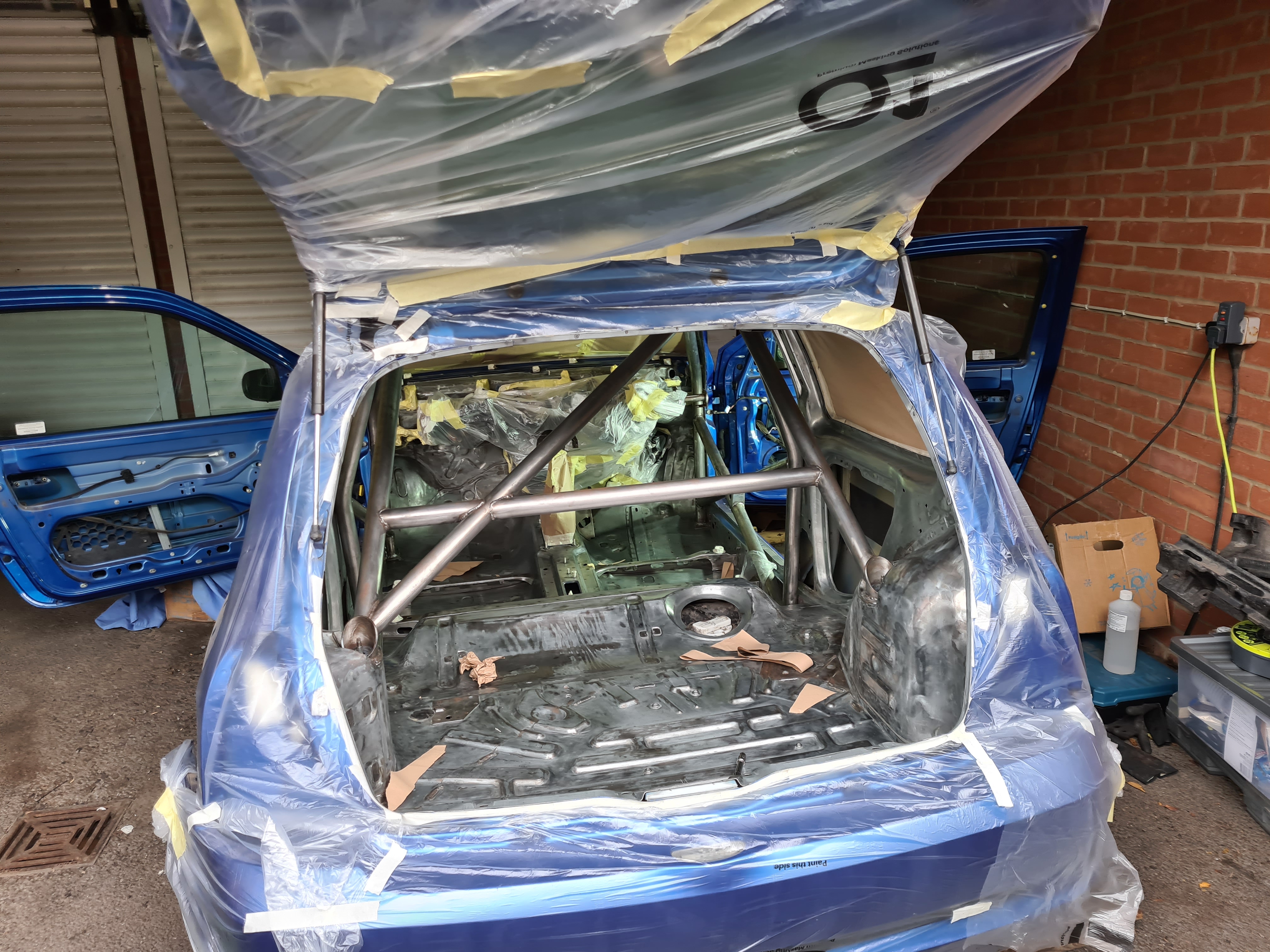

- Stripped interior back to bare metal with wire wheels and stripper - no body shop job as wasn't super concerned about finish and wanted to do it myself.

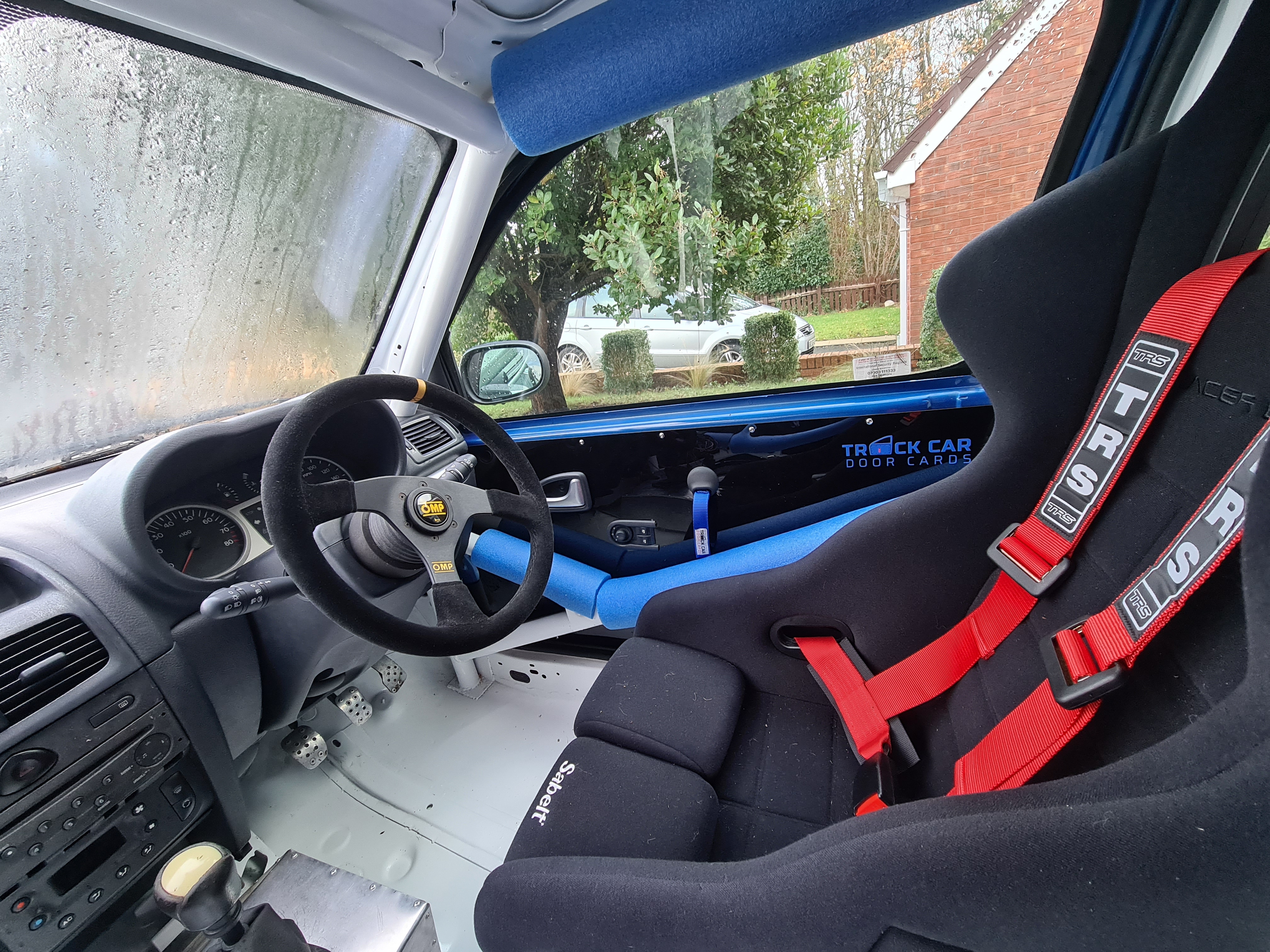

- Welded in Custom Cages 6 point cage with double door bars.
- Finished tidying up metal work, extensive masking and then primed and sprayed interior in gloss white. Not a bad job but still some gaps to finish with rattle cans.

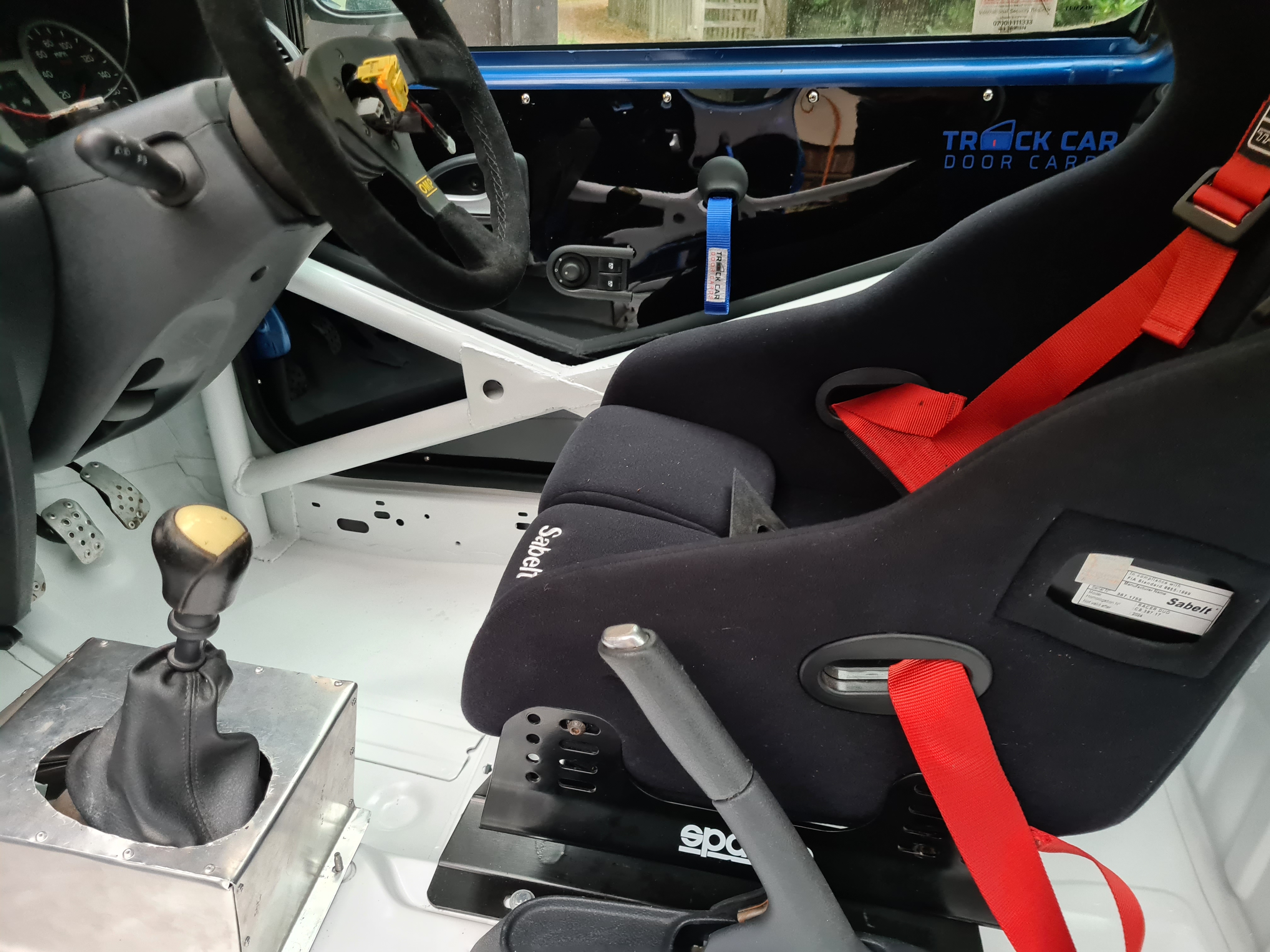

- Fitted Track Door Cards front cards with a bit of door cutting to reposition switchgear due to doorbars.
- Rebuilt interior including cutting dash in half to get in. Fitted Sabelt seat with appropriate hardware, TRS 4 point road legal harness

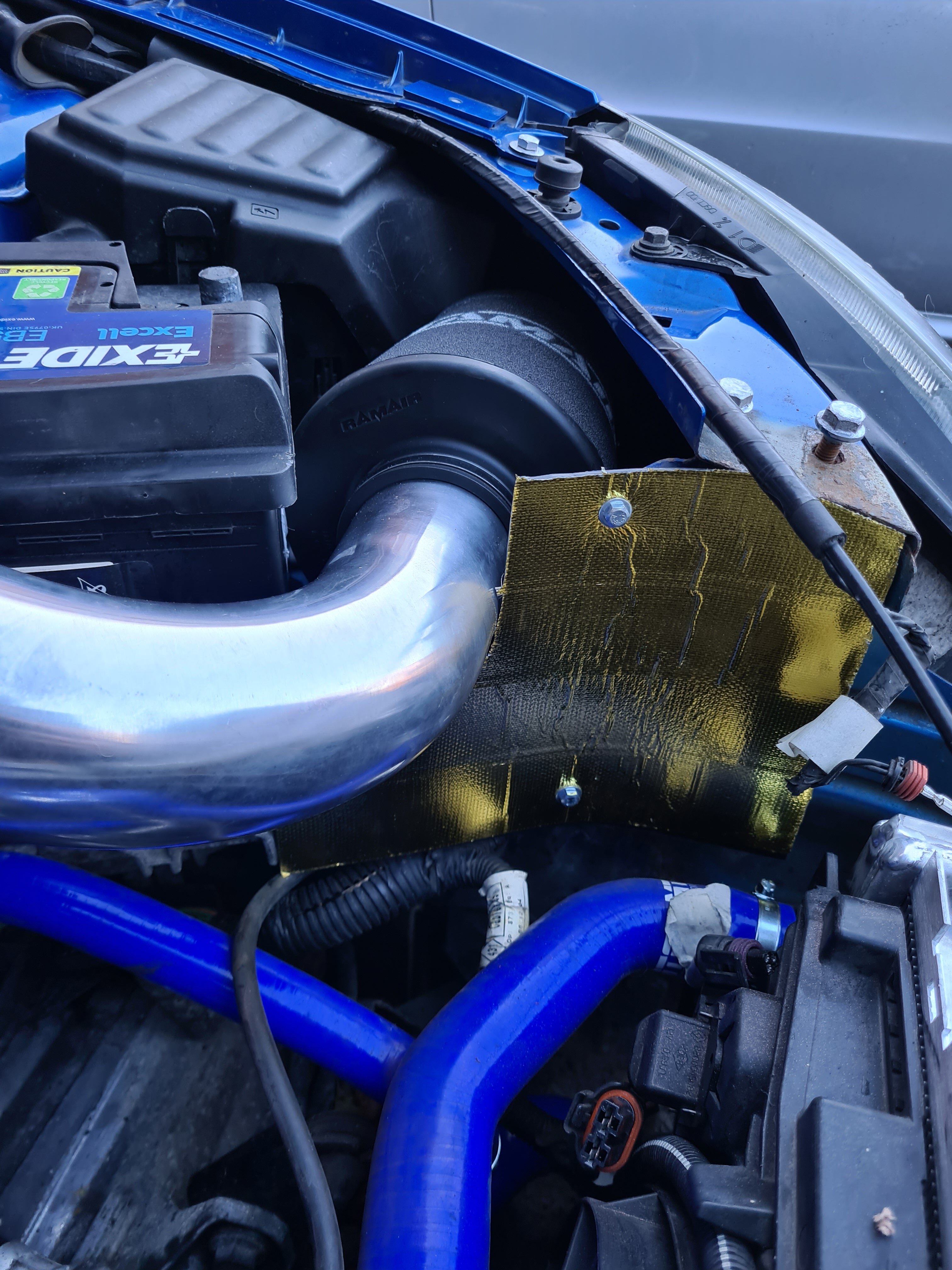

- Fitted homemade induction kit from Ramair 70mm cone and ASH parts, plus K&N crank breather (because looks nice)
- Cut piece of ABS to shroud cone intake from hot engine bay, coated in heat reflecting foil

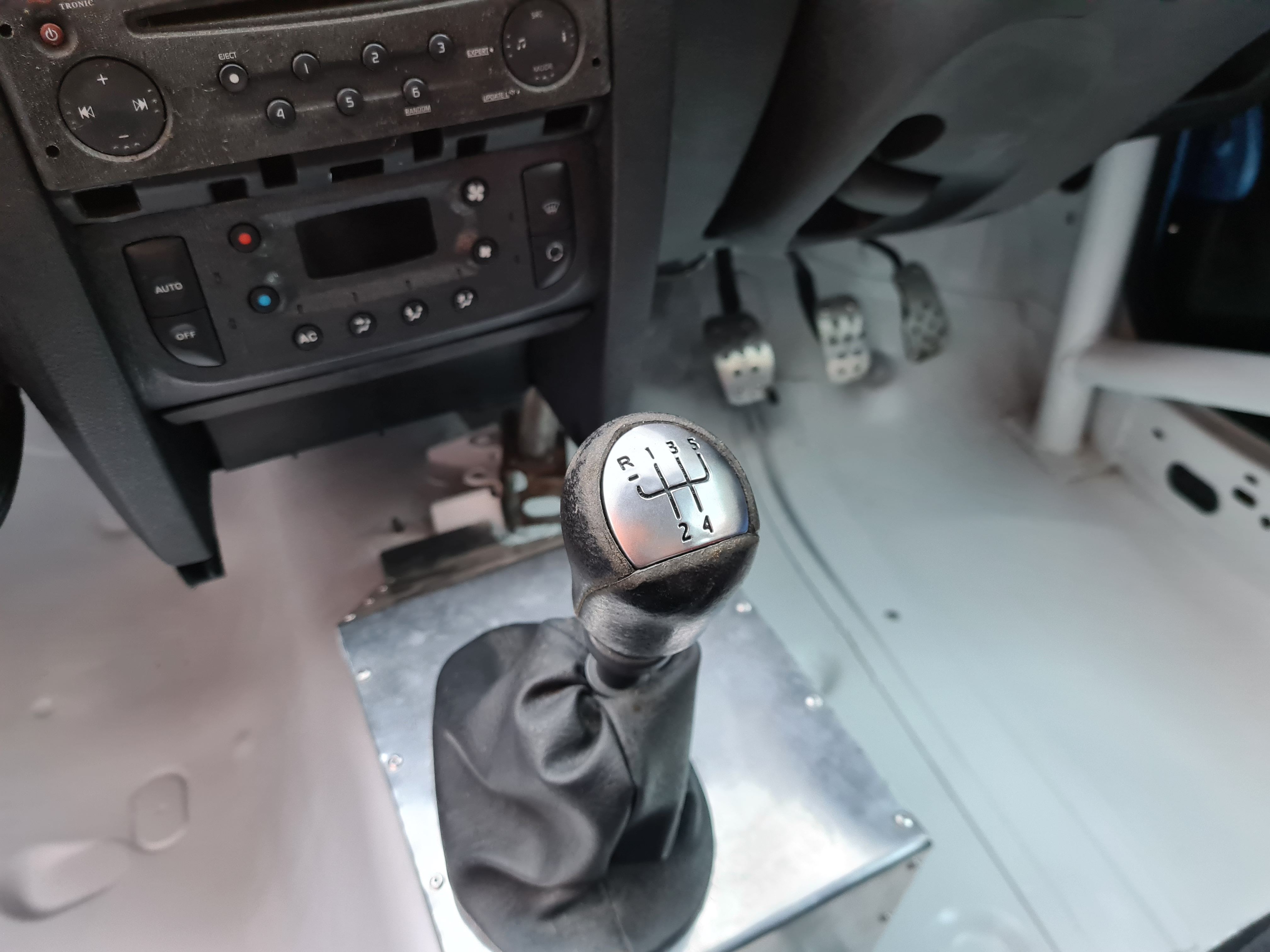

- Scenic gear lever mod

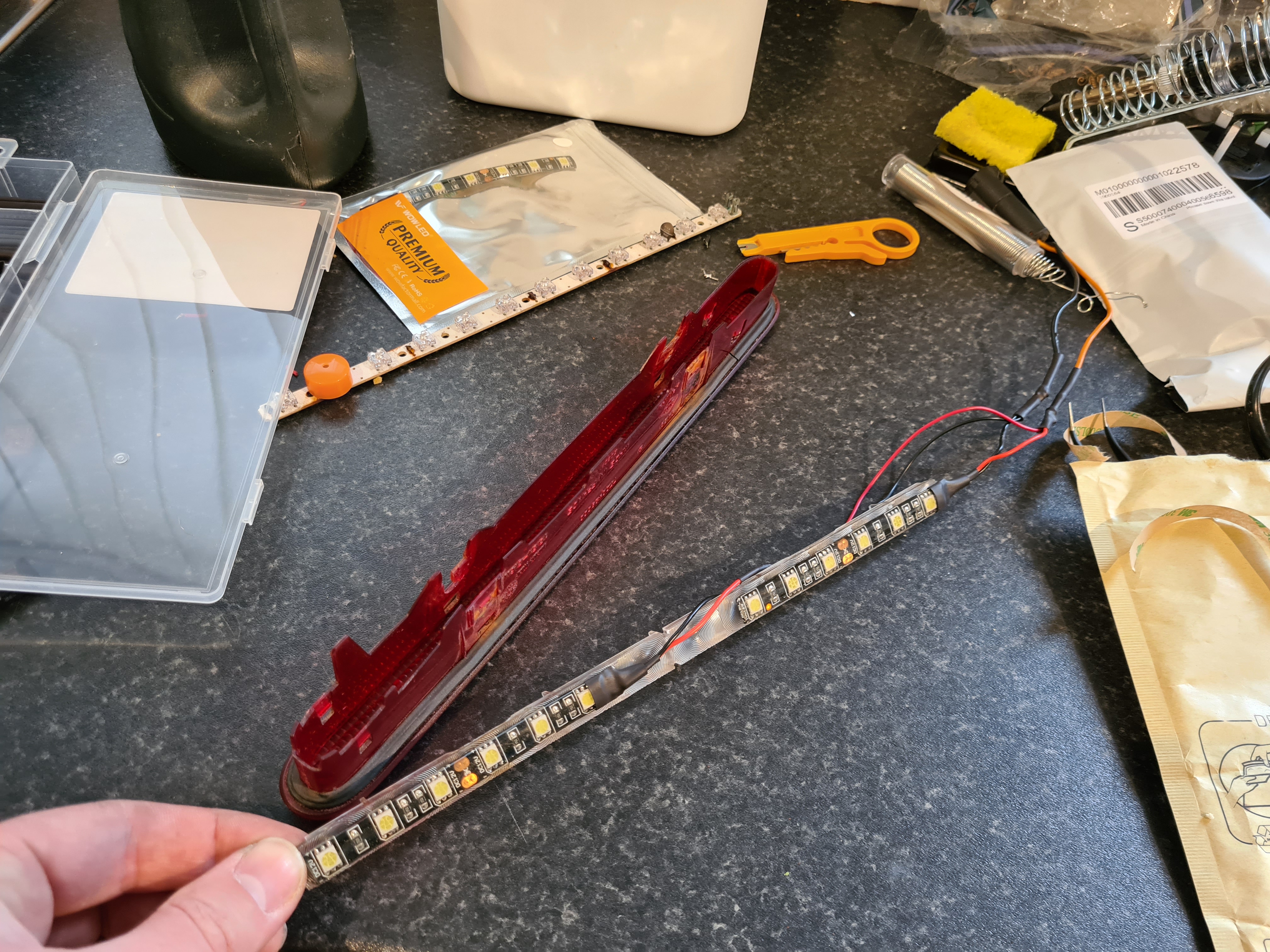

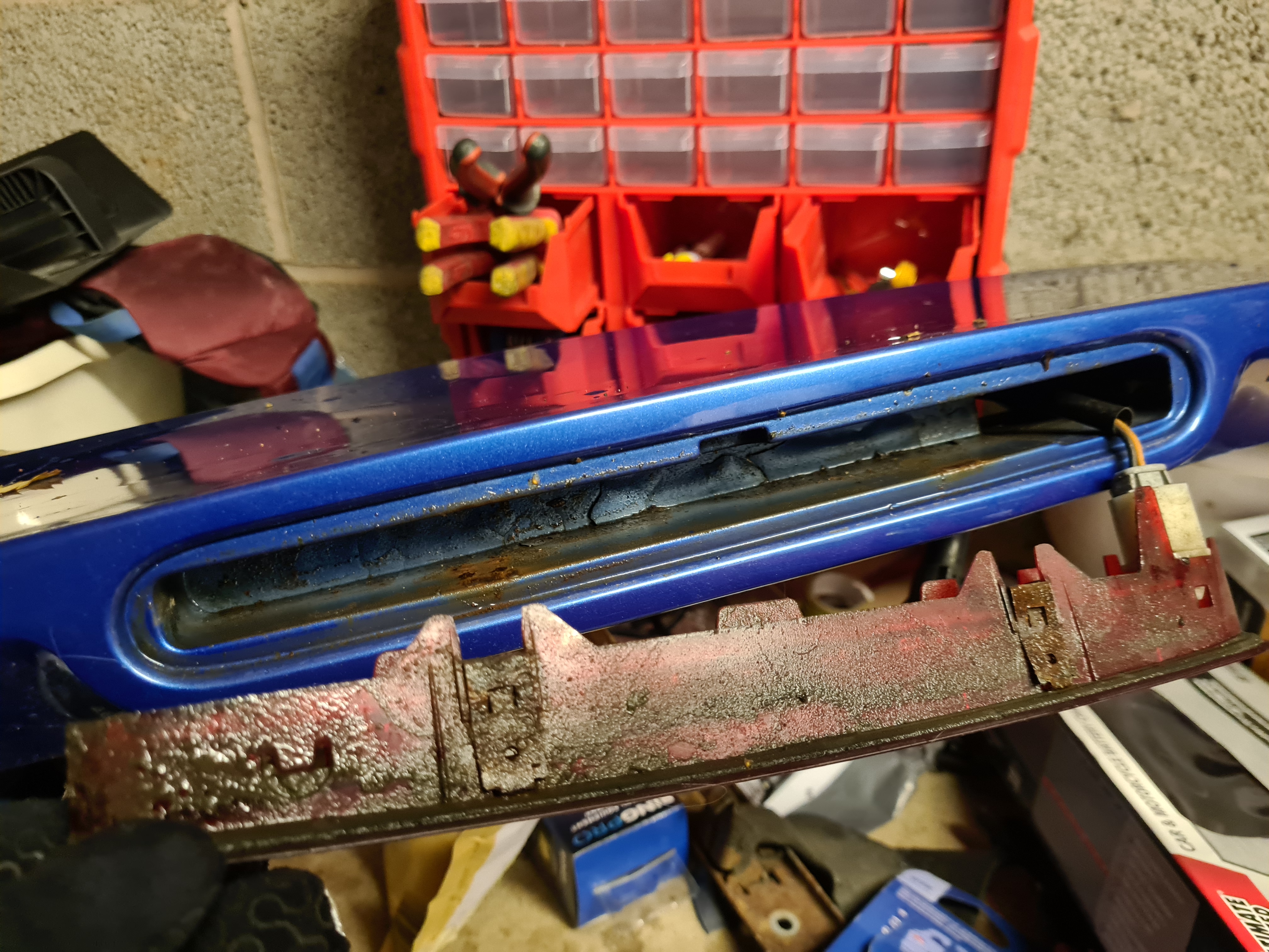

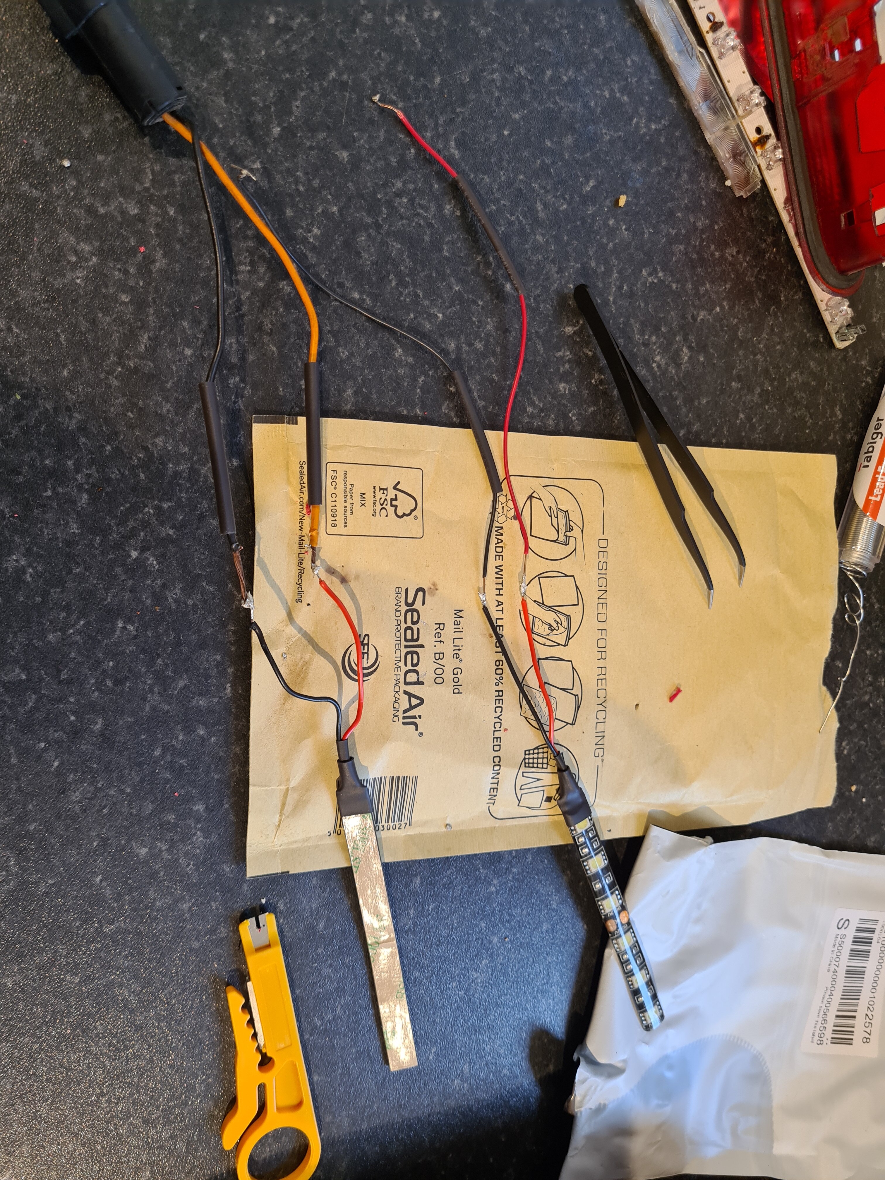

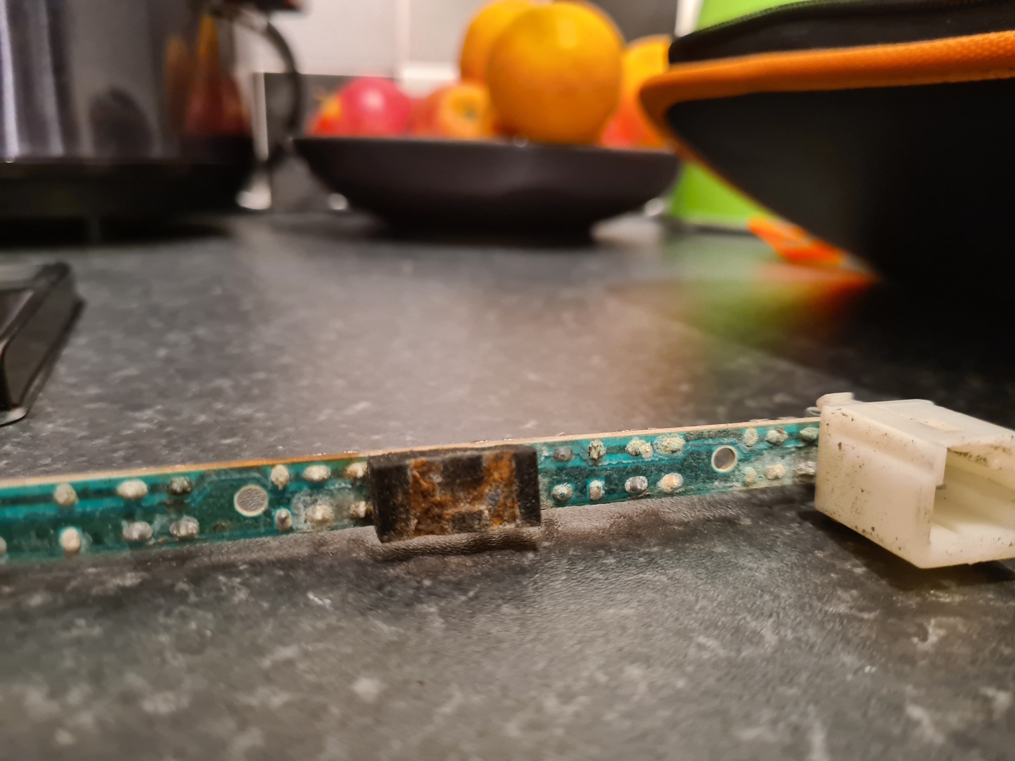

- pulled out non-working hig level brake light. Not hard to see why this doesn't work. Anyone selling them seems to want £40 so I'm gonna get some cheap LED strips and see if I can bodge it myself- pulled out brake pedal switch and adjusted it a bit, seems to have cured ESP warning light

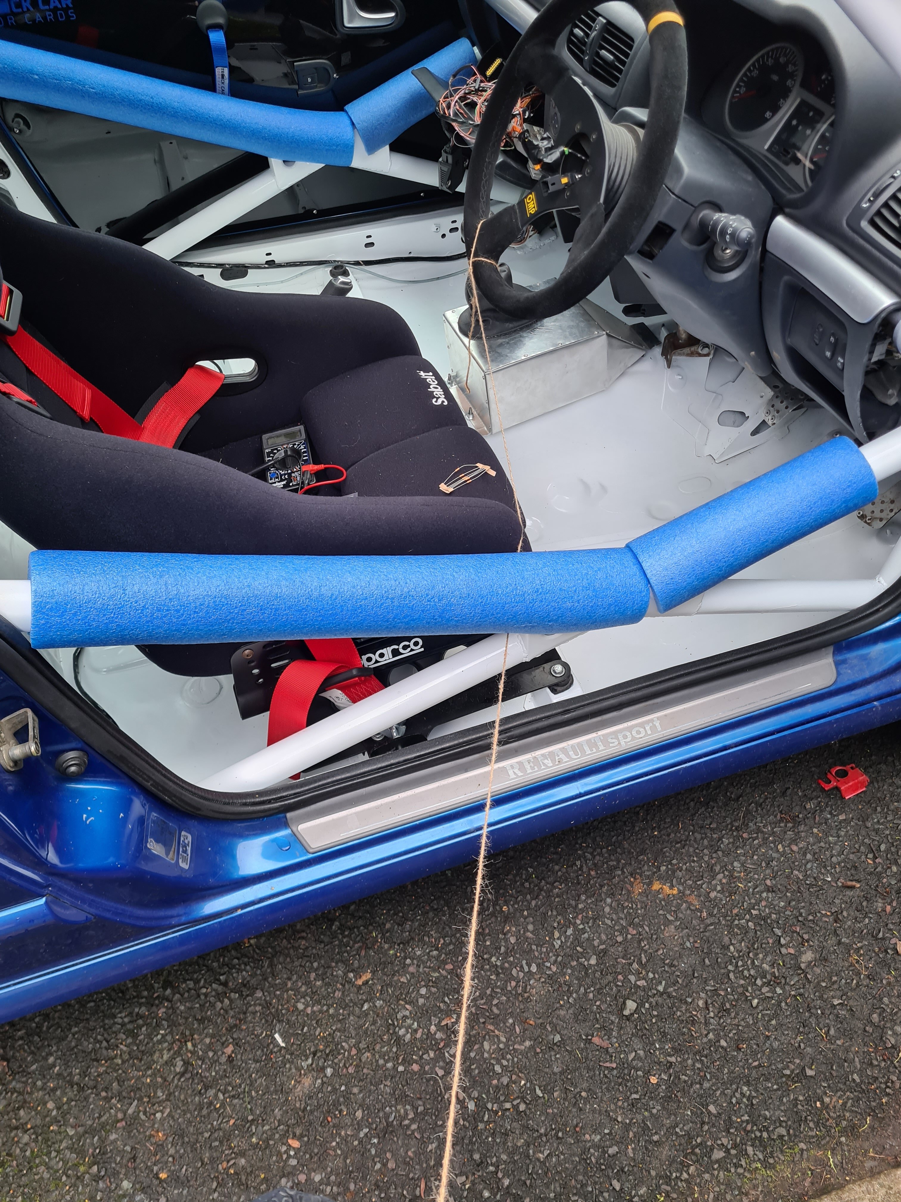

- used a piece of string to verify that PAS pump is the source of the whine under steering load. Will order new one and cry at having to take the aux belt I put on last week back off again

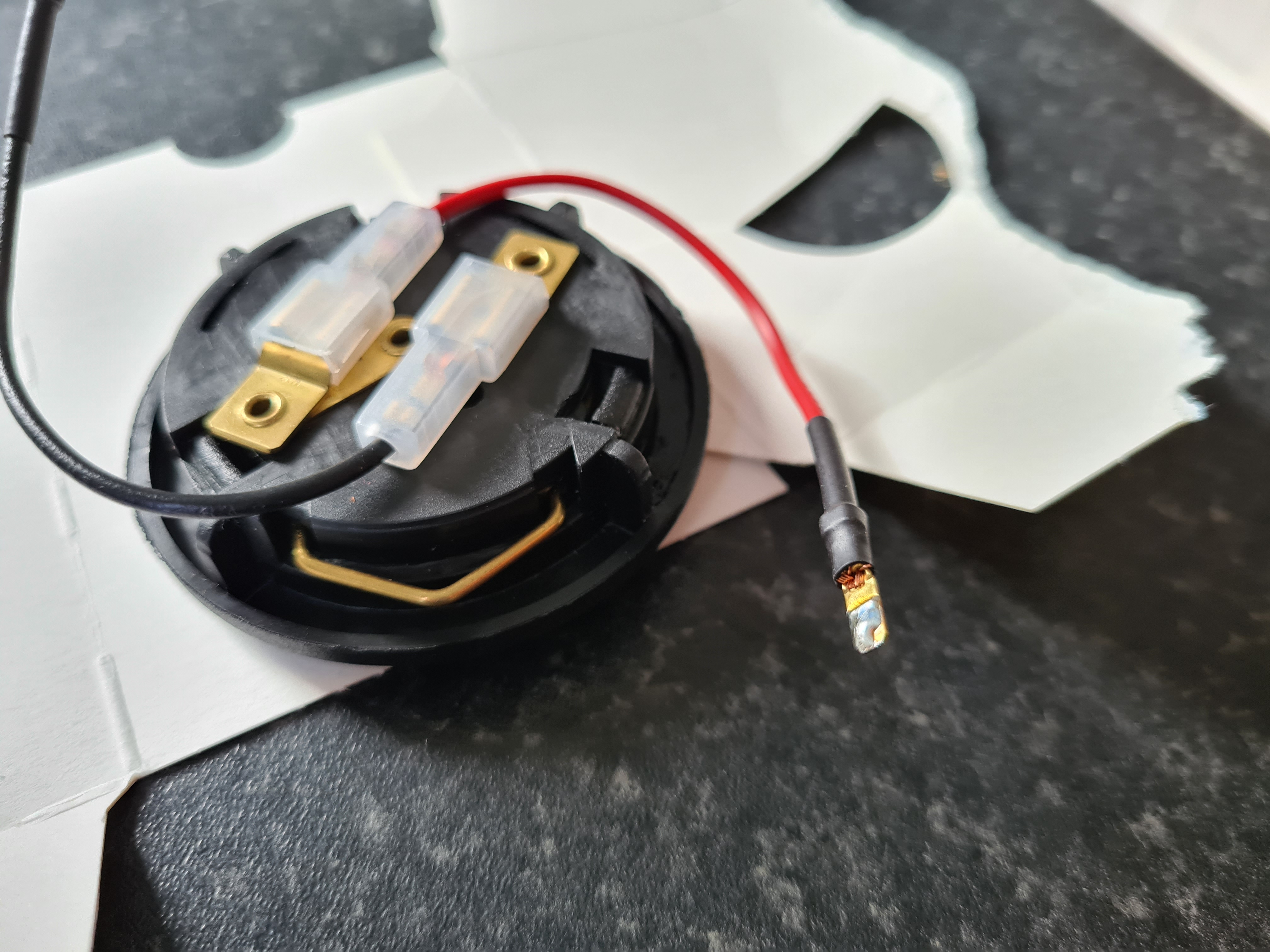

I got bored today and decided to quit messing around with airbags and put the horn in to tidy things up. Blob of solder on each contact for a better fit and some tape to keep it in, easy. Cannot overstate what a difference to morale that tidier wheel makes.

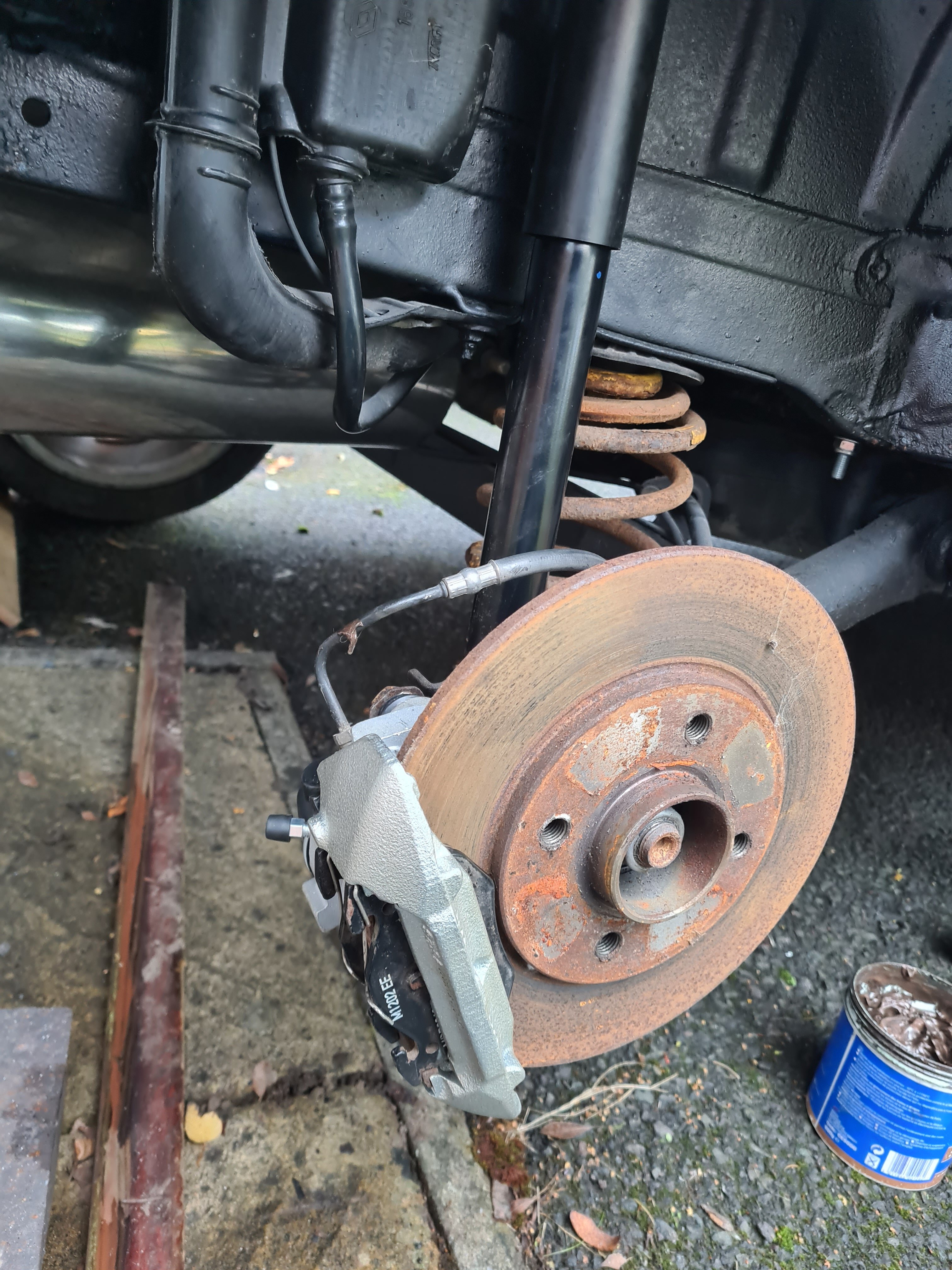

New rear calipers arrived today so decided to swap them in over lunch. For once, a job on the Clio was a dream. No problems whatsoever, whipped the old calipers of and had the new ones on in under 40 minutes, super pleased with that. They need a full bleed and the handbrake cable adjusting but they sit well. Only potential issue is they float too freely so I worry they might rattle, but that's a problem for another day. Very easy job with minimal tools needed. Please excuse the rotten springs, new ones in soon.
Ordered a new PAS pump last night along with some cheap LEDs for the rear high level and also a second hand airbag module to try out. Tried to bodge the OBD port but no dice on that one.

Never mind the rusty springs, i'm looking at those cobwebs on the brake discs 😂🕸️🕷️
Tell me about it. The years...they have not been kind to this car. In the last two years it has covered <1 mile in total - a shakedown after it first started after injectors, battery and starter problems fixed.

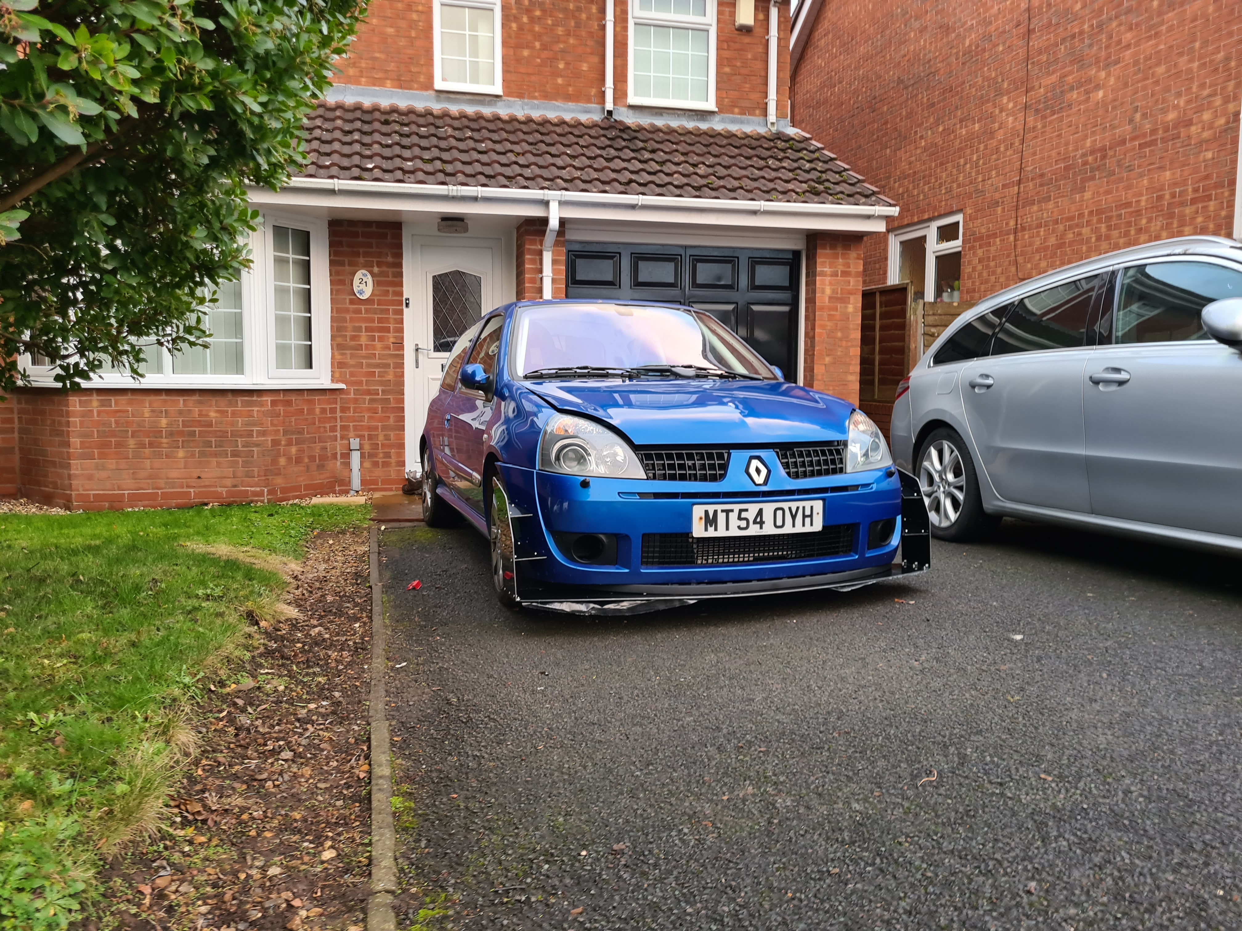

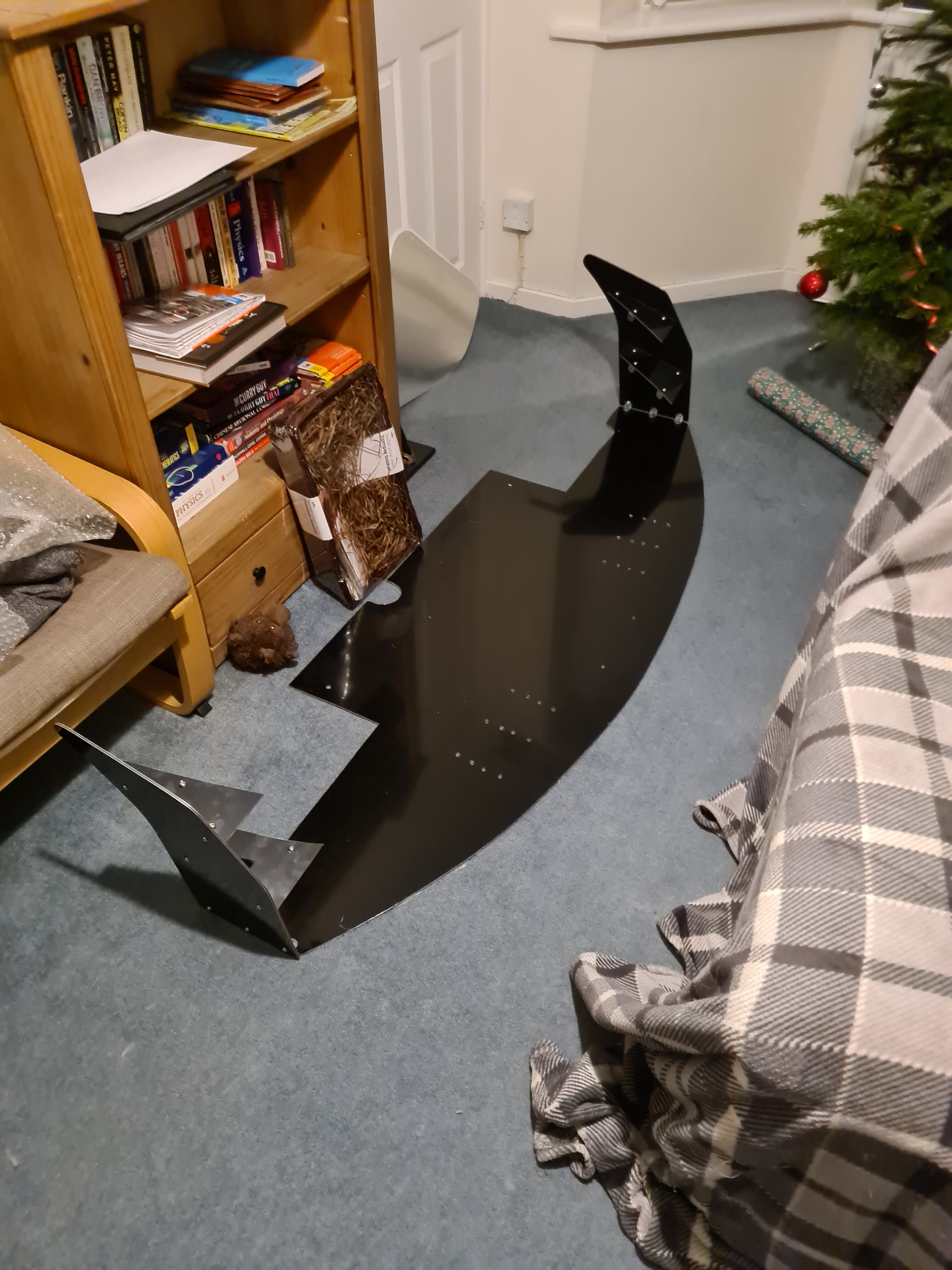

Friday; drove down to Bristol for a party and picked up my new aggro splitter from Simon at Track Car Aero on the way, as well as some white rear cards. Looks like a great piece of kit and very grateful to him for being so accommodating with all my stupid questions and requests.
Saturday; drove home and spent the day feeling hungover, started piecing together the splitter before realising I don't have any instructions. Gave up. Came home to a bunch of packages ready for Sunday.

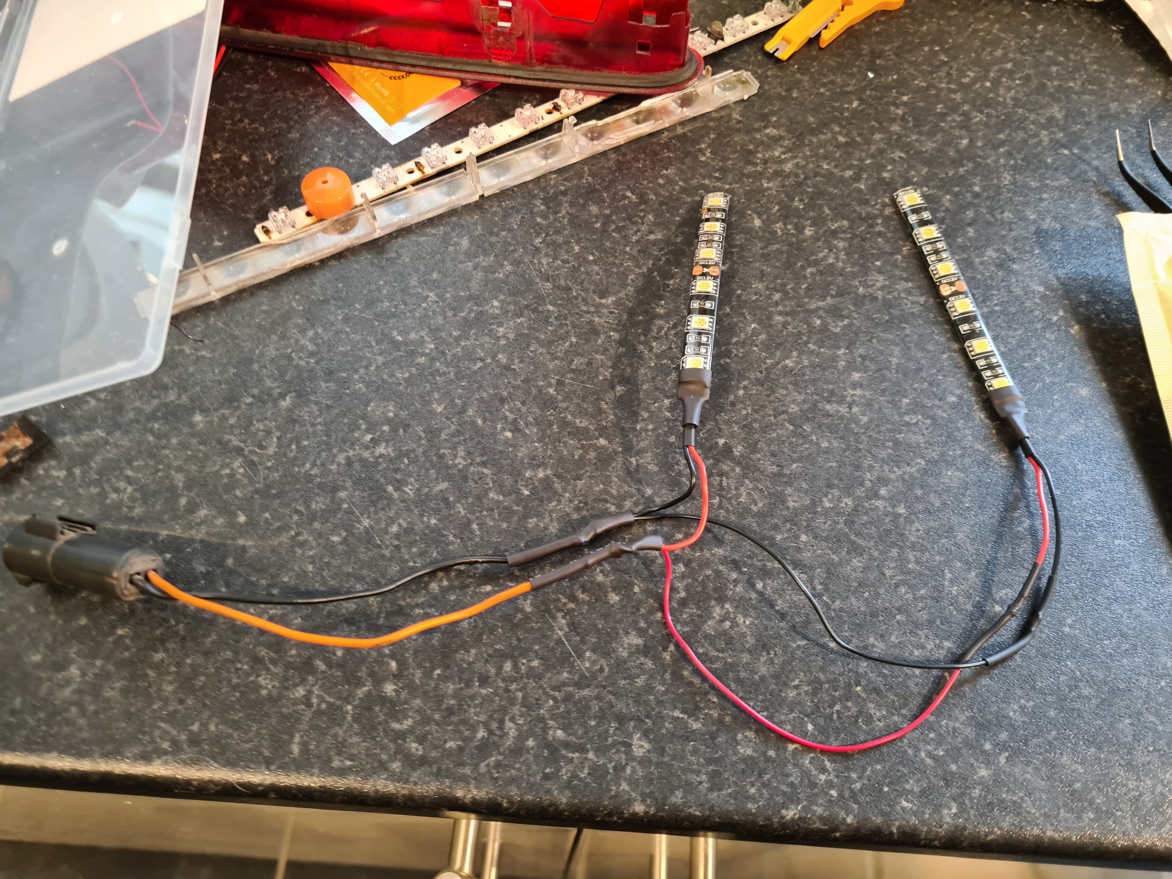

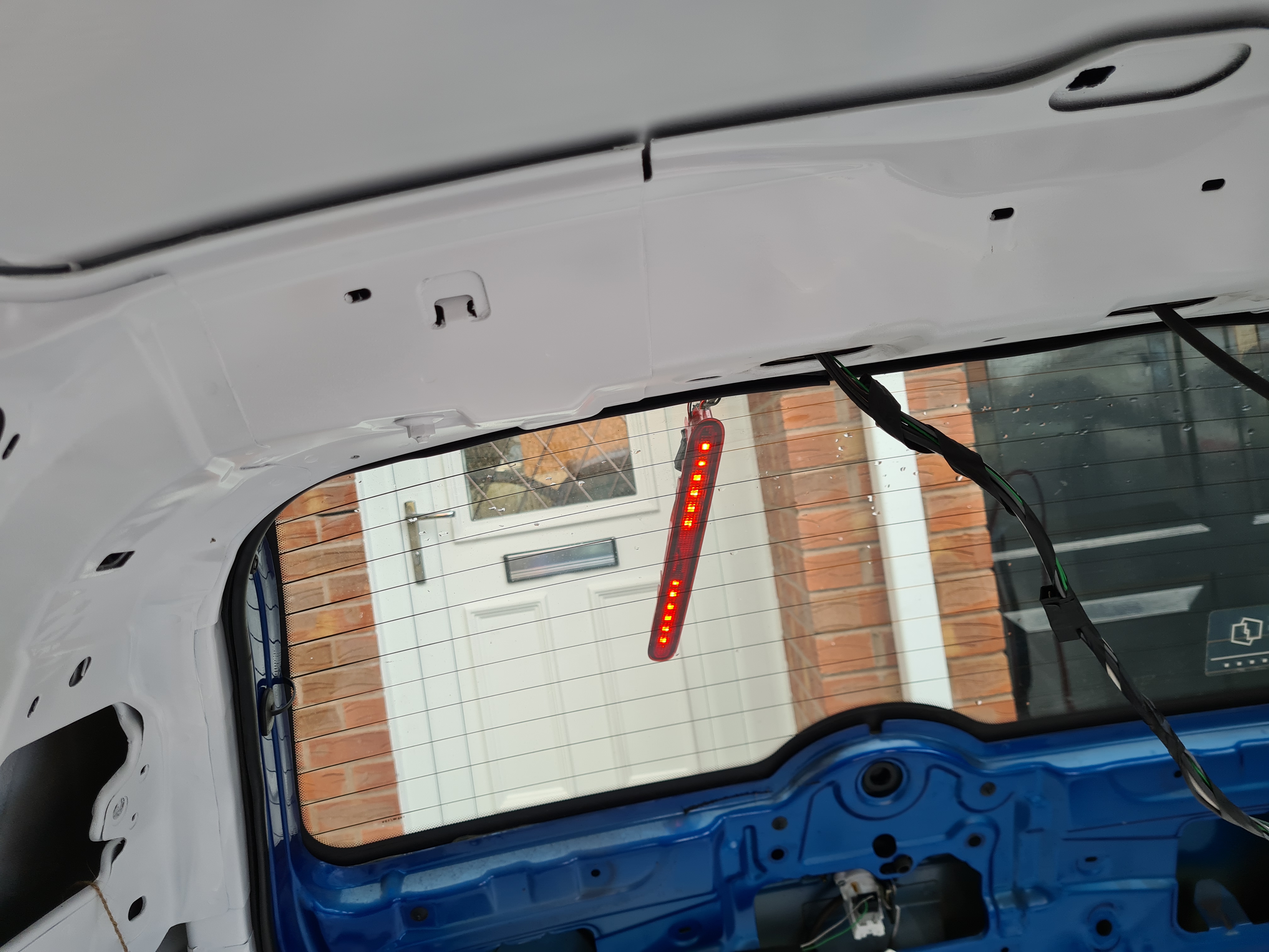

Sunday; cracked on in earnest. Pulled apart the non-functioning rear brake light and determined re-animating the board was not going to happen so made my own with £2 worth of eBay adhesive LED strips. Started by just squashing the flying leads into the terminals of the connector and a dry run with that; LEDs lit up. Soldered in two strips in parallel to the leads of the old connector after cutting it off; also worked. Assembled in housing and re-routed wires, taped down; all working brilliantly. I've never been any good at soldering or electrics so very pleased this all came together. No photo from the back all pieced together yet as other half wasn't here. The scraps of wire I used to lengthen the leads are too thin so will need replacing but it's a good stopgap.
Finished bolting on the canards and brackets for the splitter and got it mocked up on the front end. Need to request instructions.

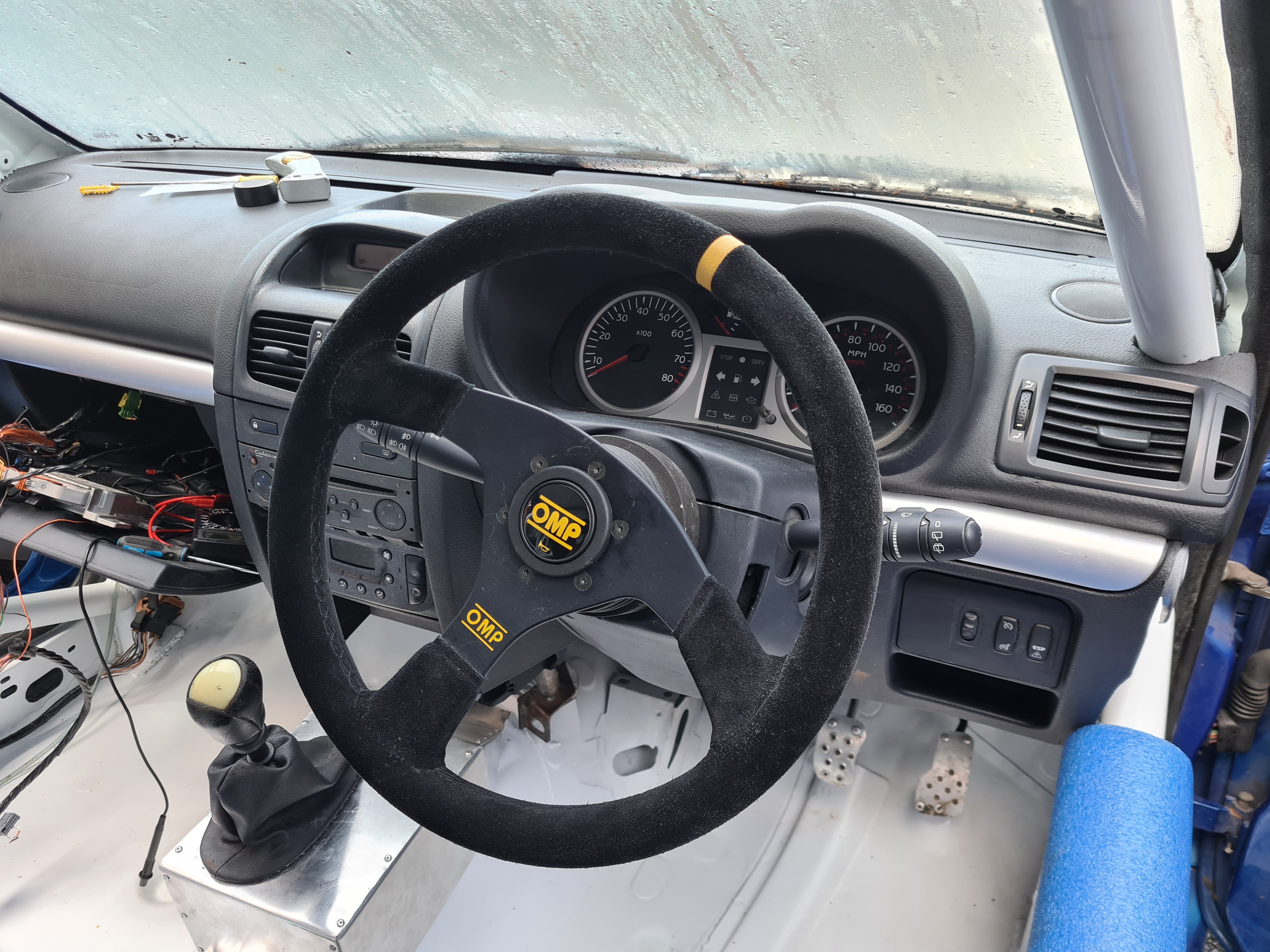

Remembered seeing someone rerouting their wiring harness on a stripped car between the interior and body of the shell so very slowly went about this with satisfying results.

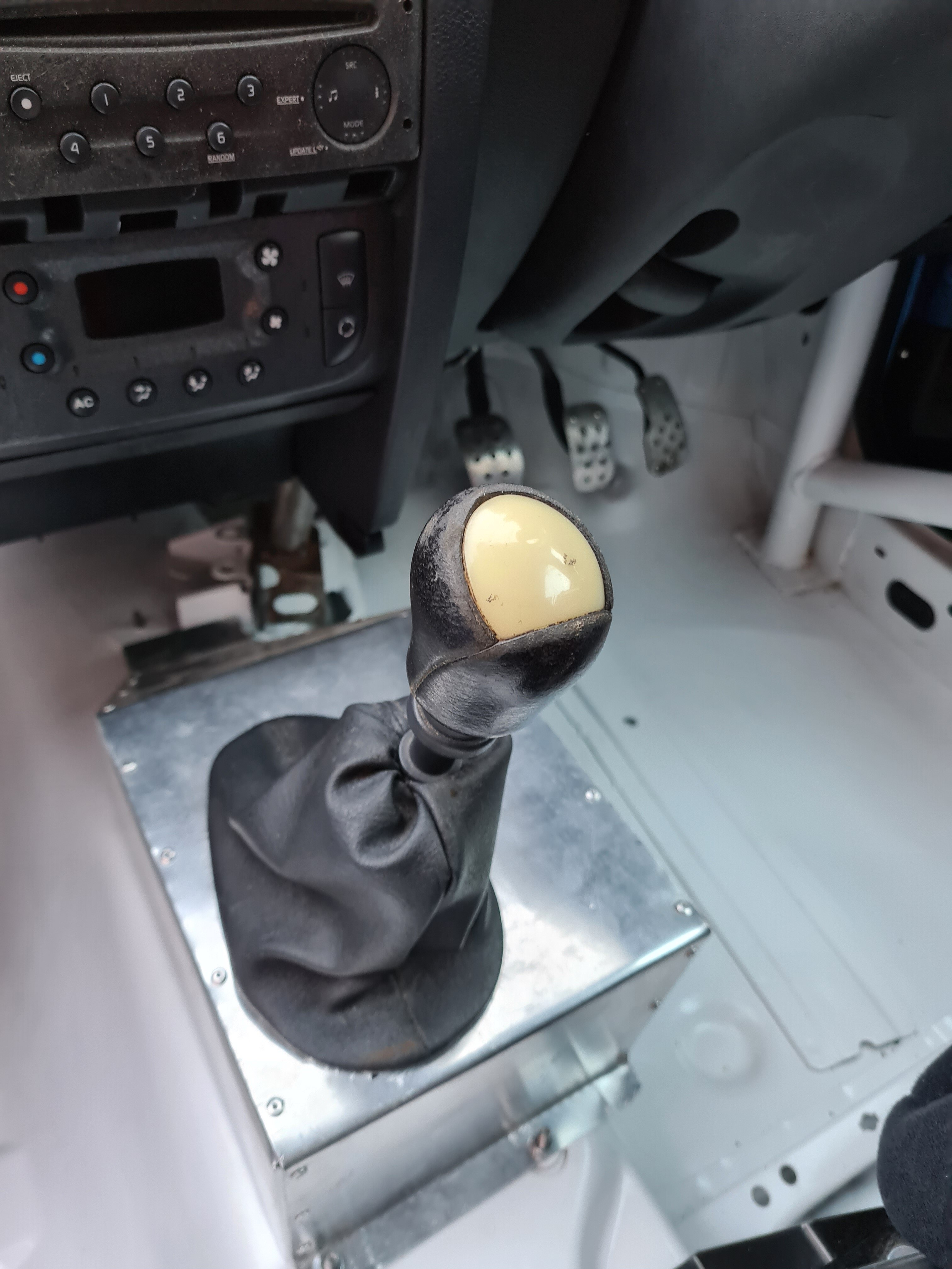

Replaced the gear lever cap with a new one. Little things make a lot of difference.

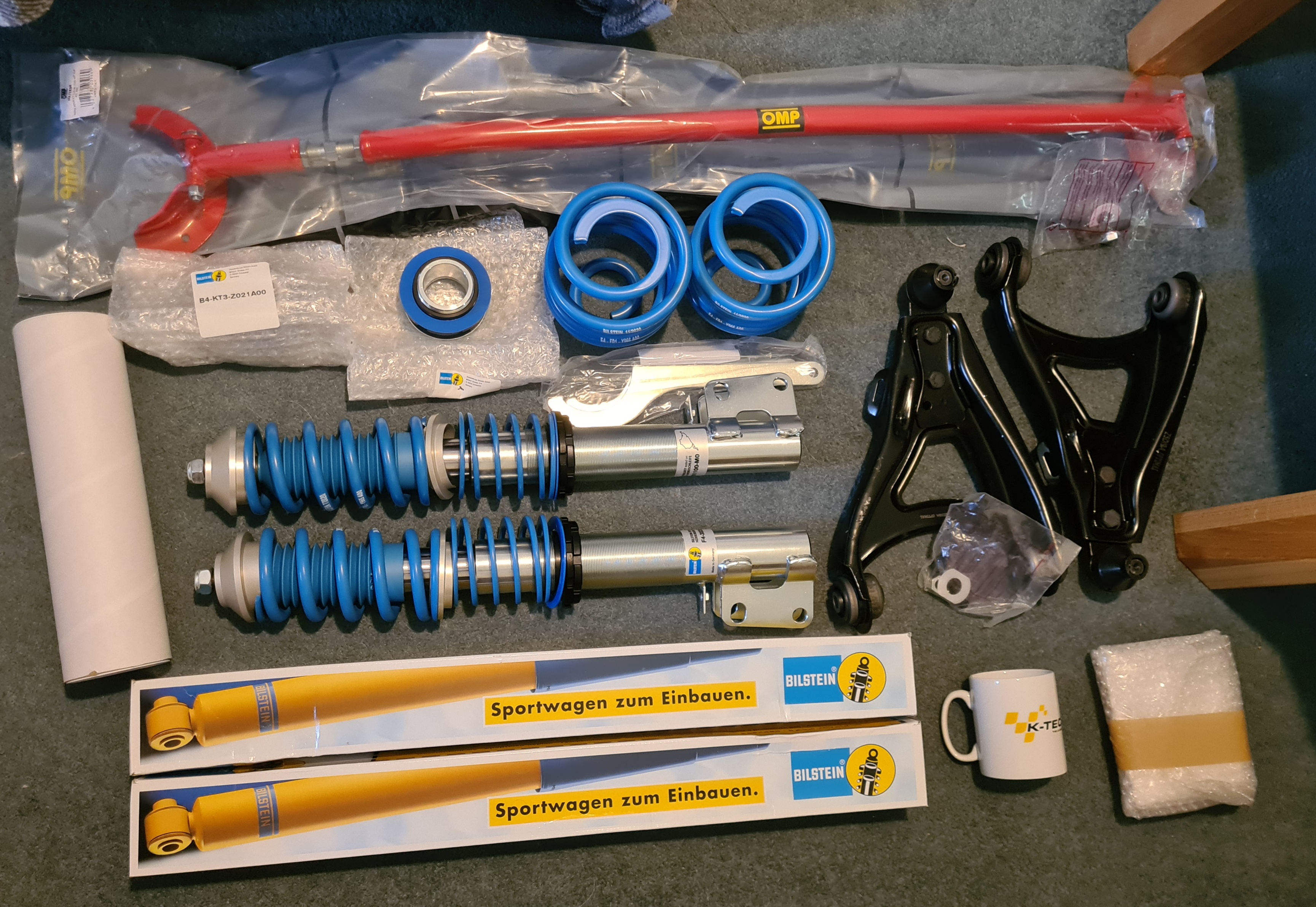

Two big boxes of goodies arrived from K Tec this afternoon so a real mixed bag today. Full set of Bilstein B14, OMP strut brace and heavy duty wishbones.

Replaced the rear calipers

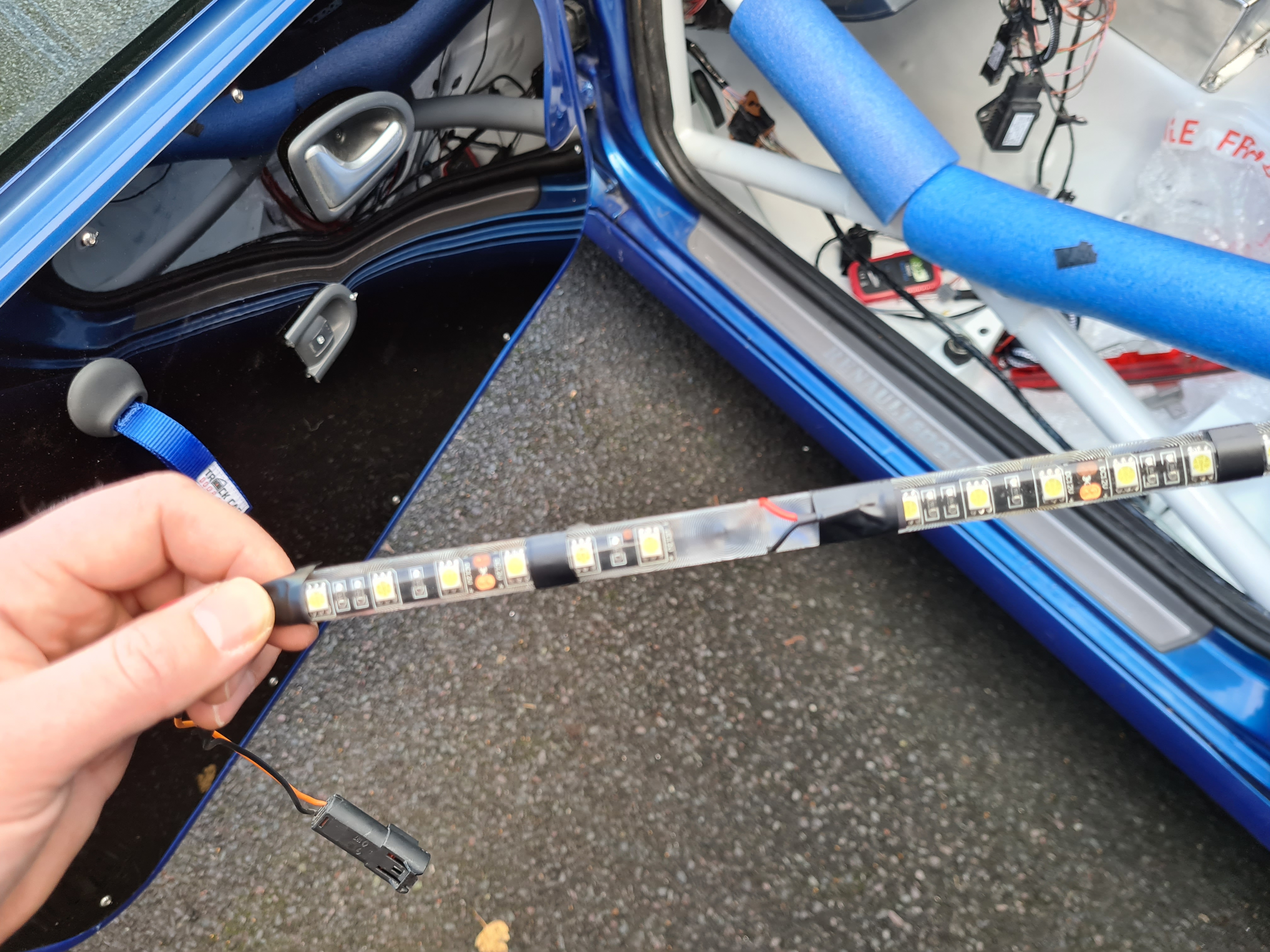

Rebuilt centre brake light with random LEDs

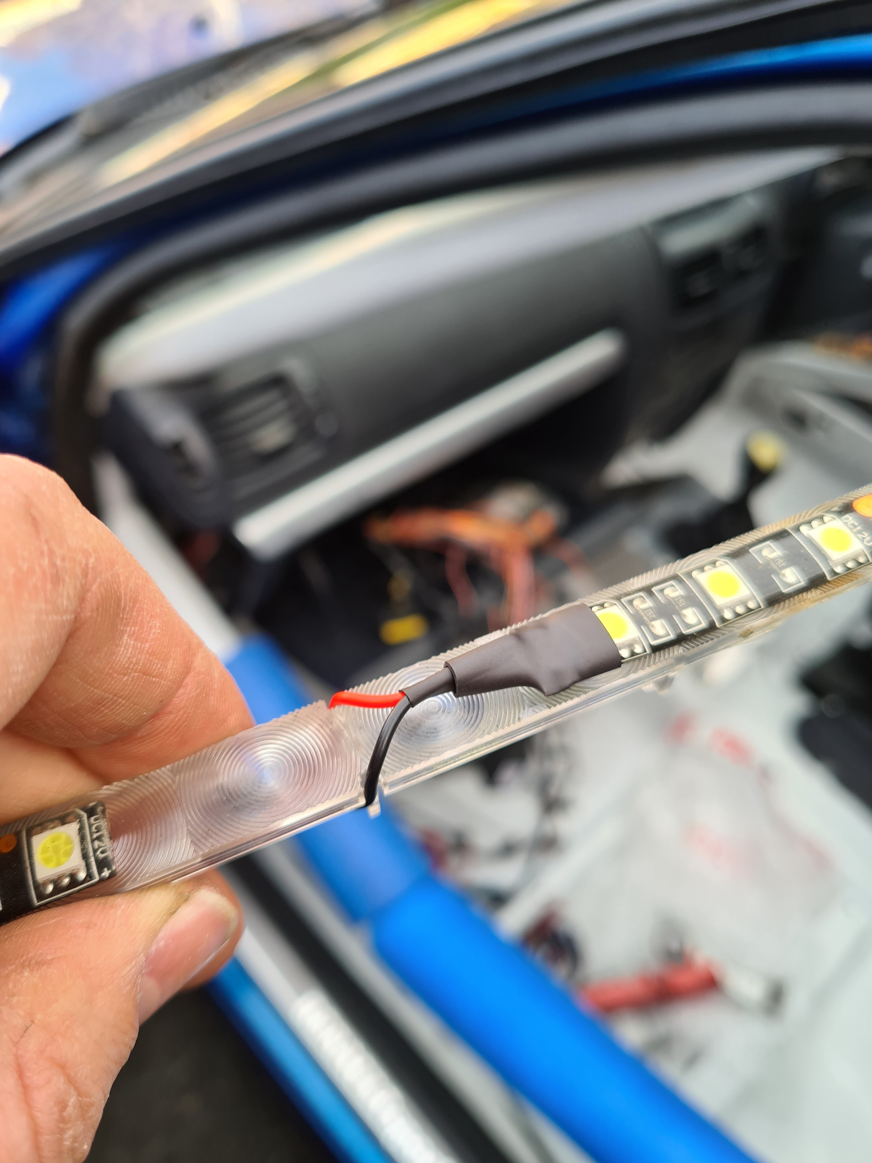

Rebuilt number plate light with cutting, soldering and a glue gun

Made a silly box to hold my mess of electrics under the glovebox

Fabbed a heel box for drivers side

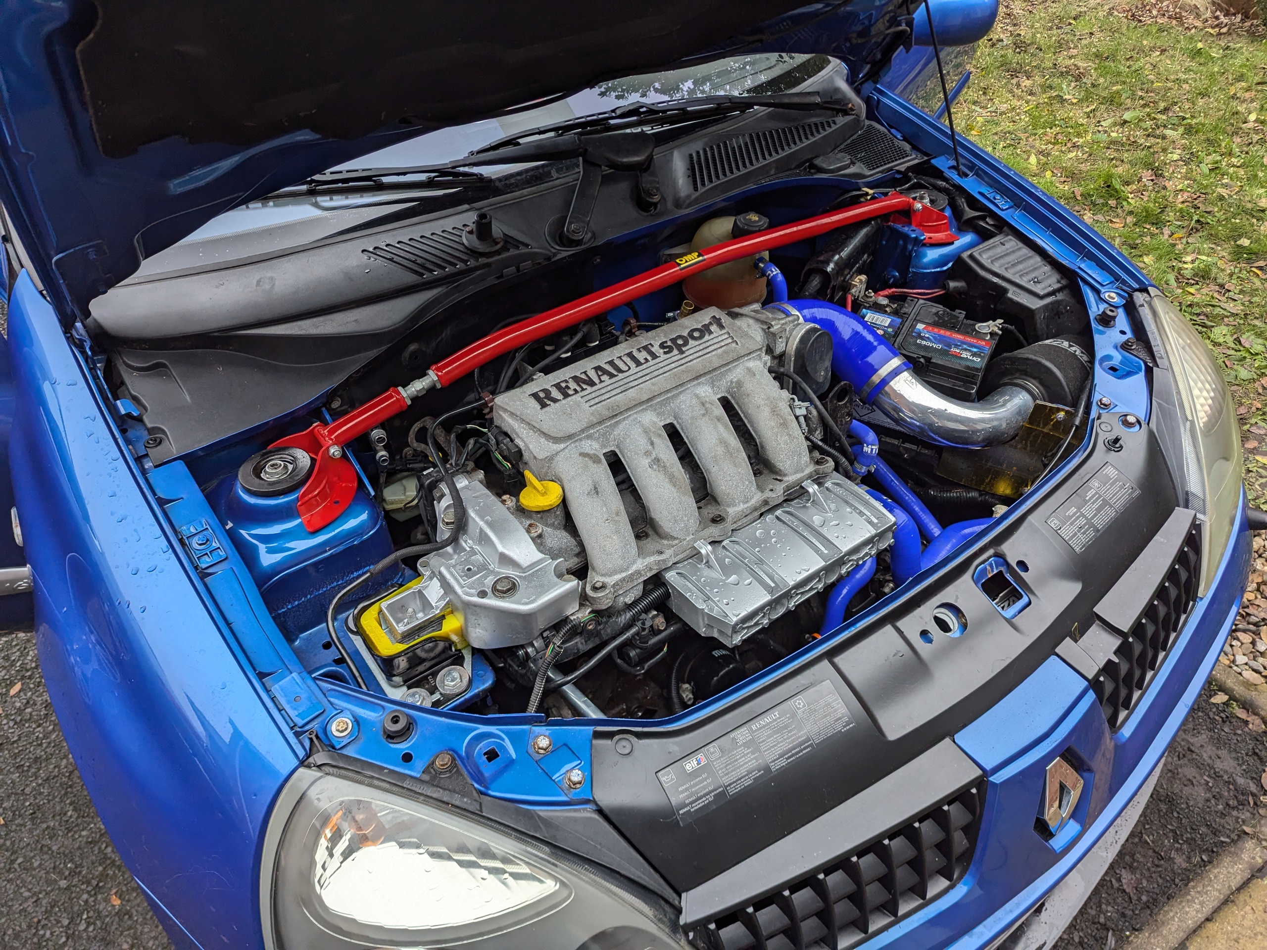

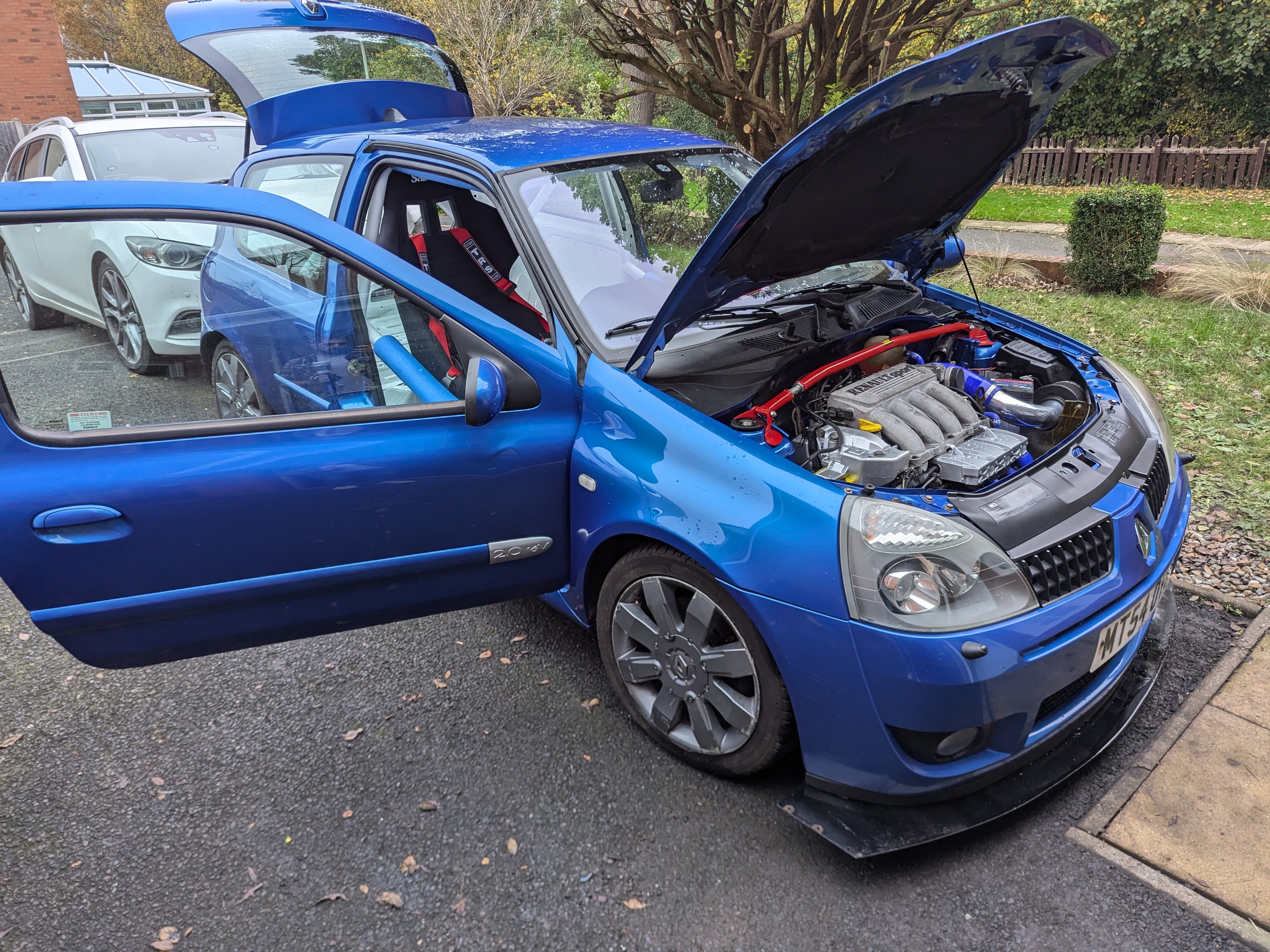

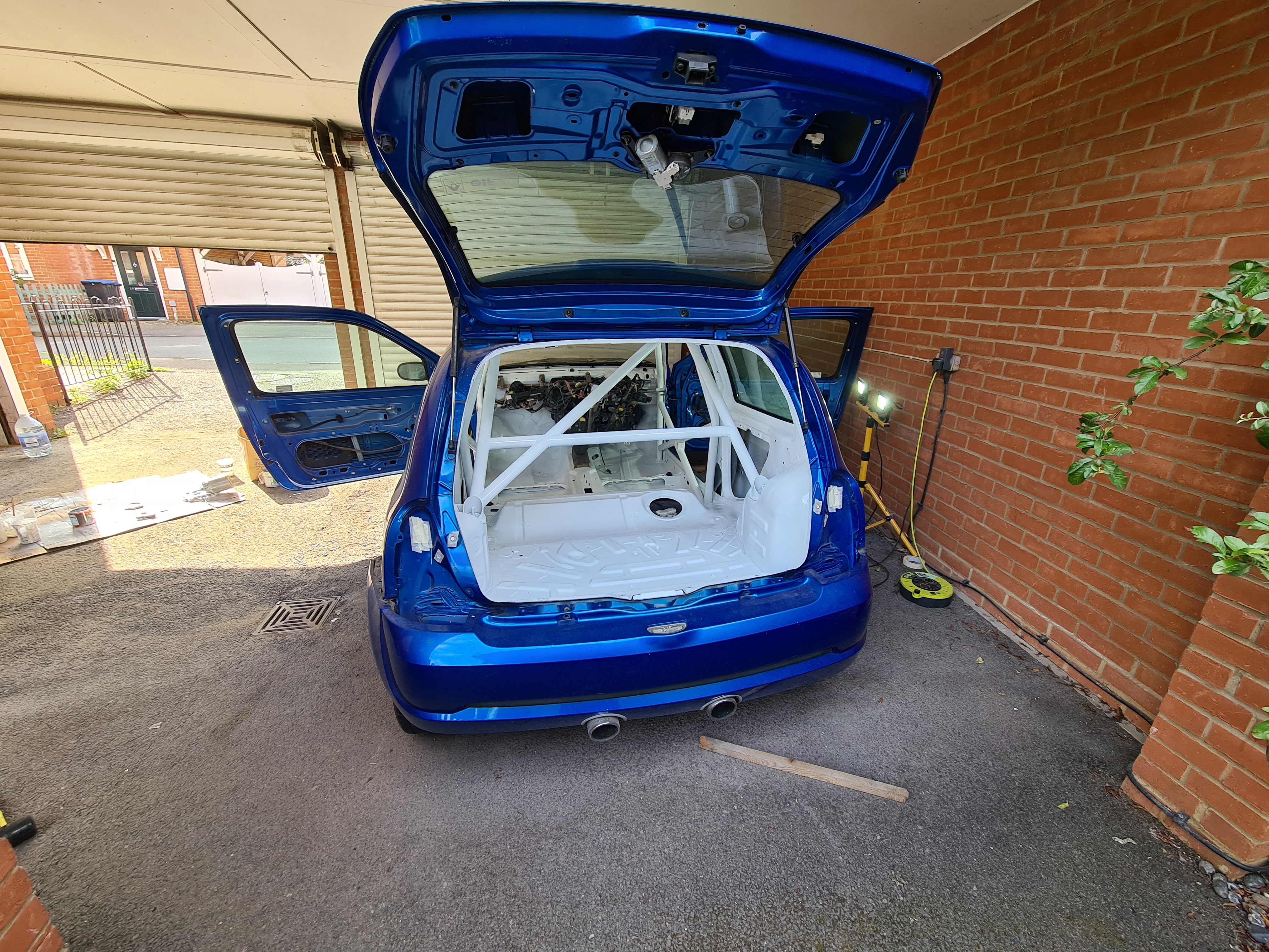

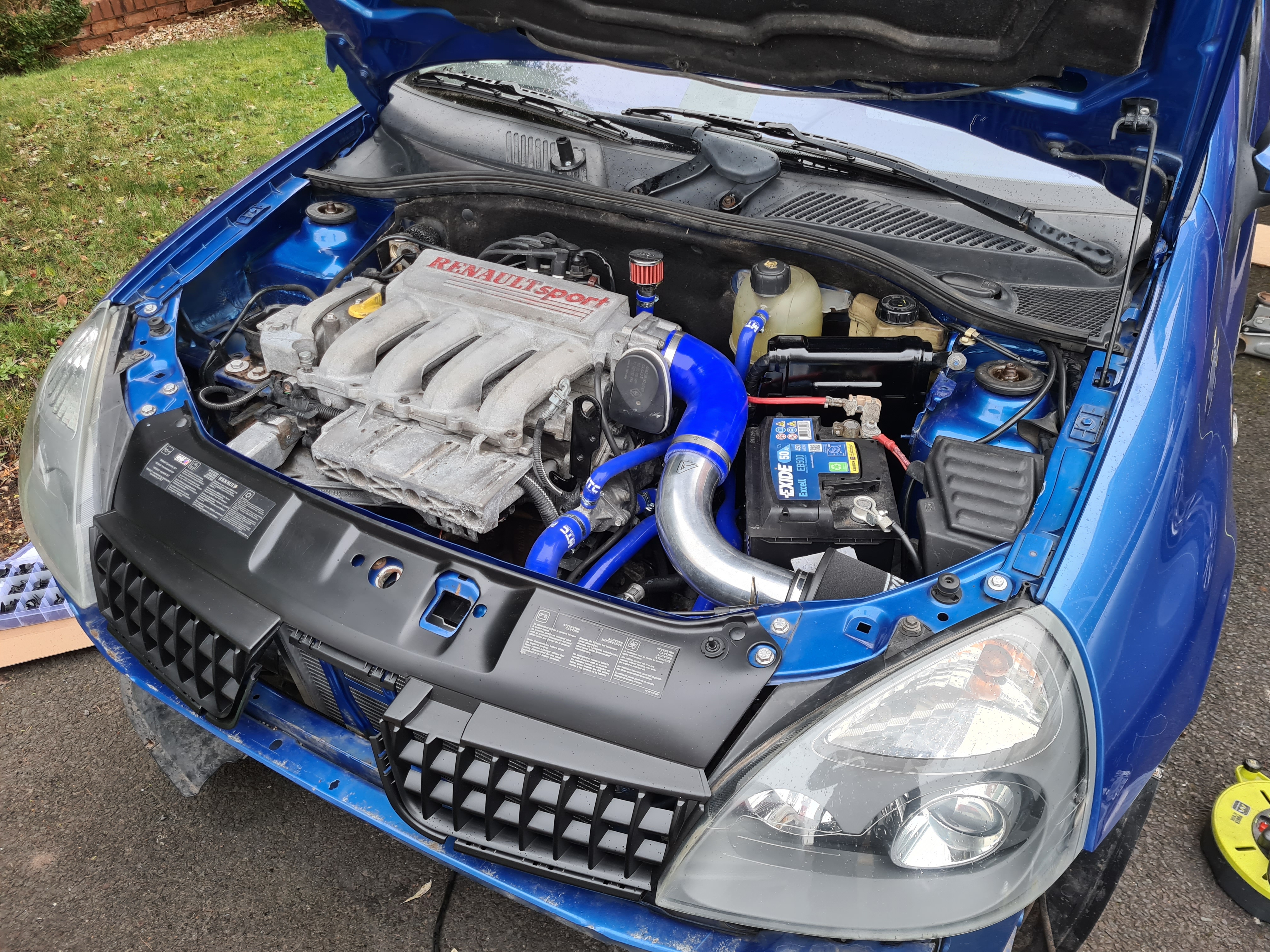

Couple of pictures of current state.
Yes, I'm aware I still haven't actually attached the strut brace.
Some time in the not too distant future I'll respray the manifold halves and rocker cover too.
Will try to update this more than once every three years...
