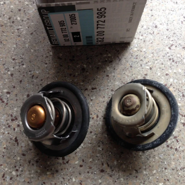

If the temp gauge sits on the middle line then you could leave it. You will probably need a new rubber o seal for it though, you don't need sealant mate. I have heard issues of ECP thermostats not fitting properly so would personally only replace with a OEM T-stat
Untitled by fletcher10, on Flickr
Adam @ Wolverhampton Renault sells T-stats for £21
