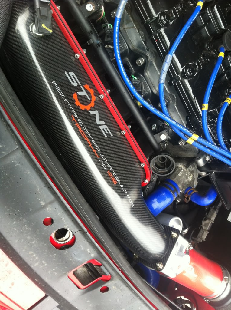

Ok, confirmed the car is off to micks to remedy the internal problem with a complete head rebuild.
I think the car feels significantly better with the sports cat at lower rpm's so I would sooner keep it in plus it'll go through an MOT!

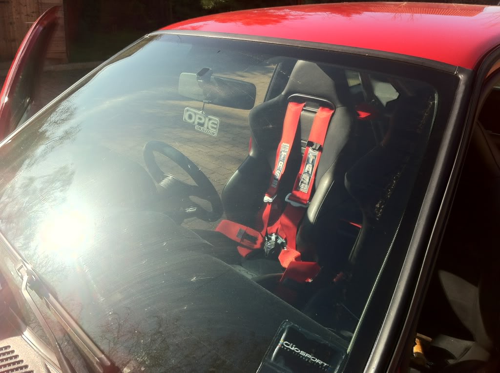

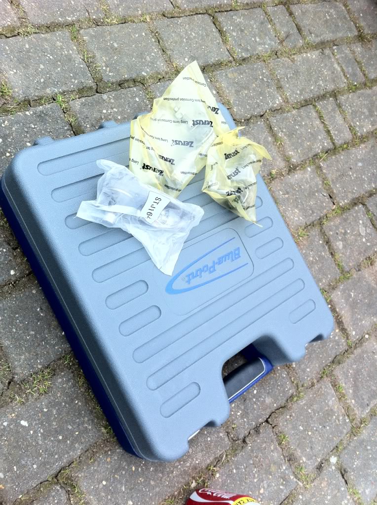

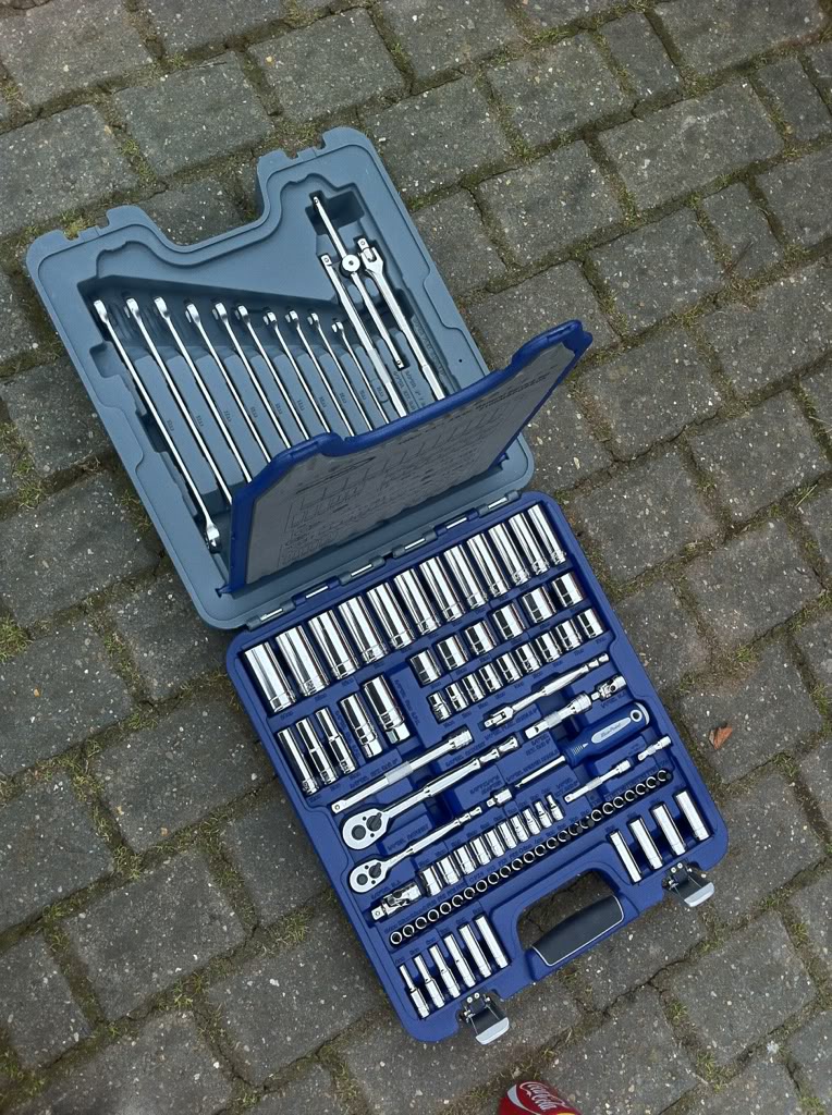

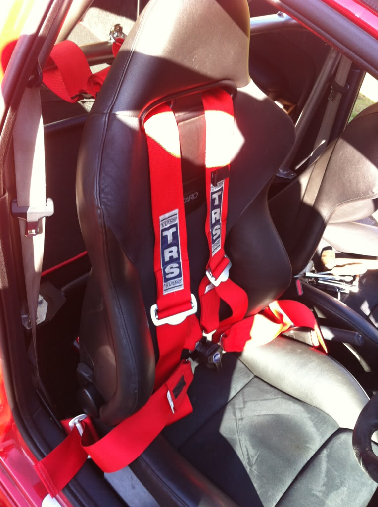

Small update, sticker fitted, Harness fitted, new BP toolkit, new ball joints and track rod ends its feels far tighter now! road trip tommorow to get the engine, then off to Micks First thing monday morning to get it fitted!!
TRE's & Ball joints
Well chuffed with the kit and quality!!!
Sticker fittage (Massive thanks to James at Stone Automotive and Ady at N2graffix cannot rate both of you highly enough!)
Finally fitted my harness, needs some adjusting but its near as dammit spot on!
