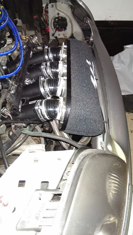

1. If you look through my build thread you'll find the details on the radiator, its a Scirocco/Gold/Toledo item, http://www.cliosport.net/forum/showthread.php?682060-ITB-d-Road-amp-Track-Ph1-Titanium-172/page10 I'm running 1 x 12" fans but it would be better with 2 x 10" or 2 x 11". The standard radiator and fan combo means the fan covers almost the entire area, whereas the new radiator its only about 55%.
2. I don't need to remove the bumper to change the filter, then again although I've got the same ITBs I've got the longer, angled trumpets and the different radiator. I've got plenty of access though.

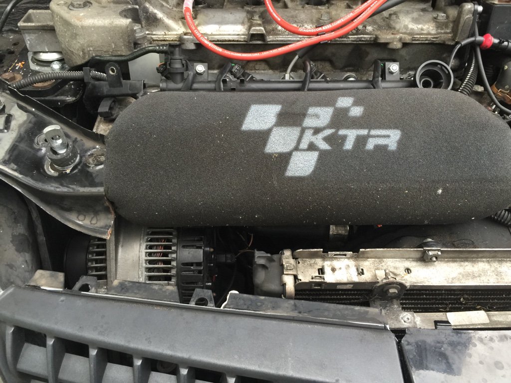

What's the polo rad setup like driving the car daily ? I have the Ktec itbs ready to fit but was thinking more on he lines of a nice custom alloy rad
Polo rad is smaller than mine so can't comment although a few people have had issues with it getting too hot but the one I've got is bigger and works fine. Like I said its just making sure you cover more area of the rad with fans for traffic. The single 12" fan does the job in traffic on the hottest days but only just, 2 x 10 or 2 x 11" would be much better.

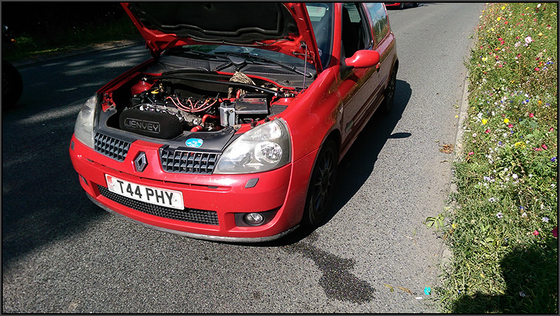

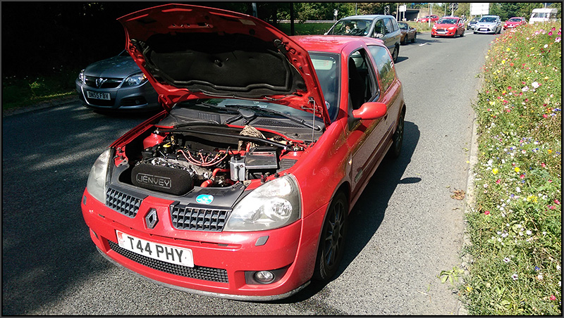

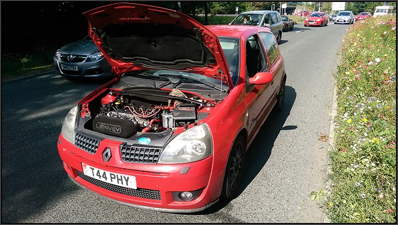

Personally I think the VW Polo rad is crap - here's what happened last weekend. Admittedly I got stuck in a freak traffic jam on an unseasonally hot day in South Wales (25 degrees). I couldn't get out the stream of traffic and had to abandon the car as plumes of steam suddenly erupted from the engine bay! It didn't help the traffic congestion...
I've got a custom rad setup on order / being fabricated and can't wait to get it fitted. Bear in mind I'm running a forged setup, high-compression build and it generates a LOT of heat. The VW Polo rad just does not cut it in this case. Especially not on my Trophy where I use it on road as well as for the odd track day here and there :)

Seeing as your car gets a lot hotter it's not really fair to say the polo rad is crap is it? Haha.

LOL! Yep, it is perfectly fair to say it! :p
If it were a pure track car then it would not be so much an issue. Or if it didn't get used much. Or if there was no other traffic to get caught up in. If you're regularly in standing or slow-moving traffic then I'd look for a better solution :) I'm not biased. :p Just don't want to see potentially a grand or two's (or more) worth of engine ruined for the sake of a few hundred quid's worth (if that) of decent radiator setup.

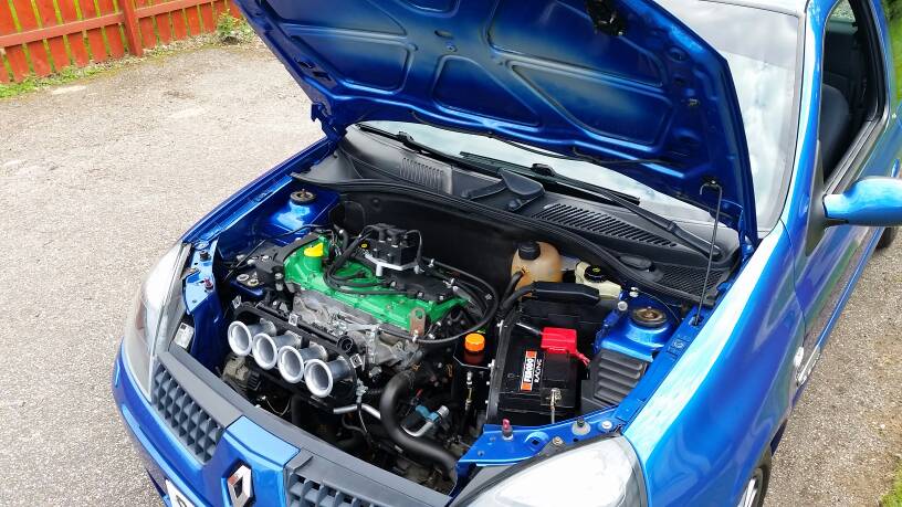

It's the same with mk1's of the high comp itb'd variety, the VAG (not sure if it's a polo 1 though) rads people use don't seem to cope very well, they're fine with standard comp though. Just 1 of those annoying extra expenses when going for the silly spec engines :)

I've had mine stuck in traffic with ambient over 30 degrees and no steam. But it's a scirocco rad not a polo rad. The polo rad is much smaller, just looking at the dimensions you can see it's not sufficient.

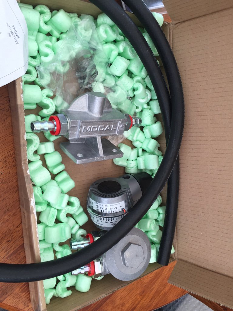

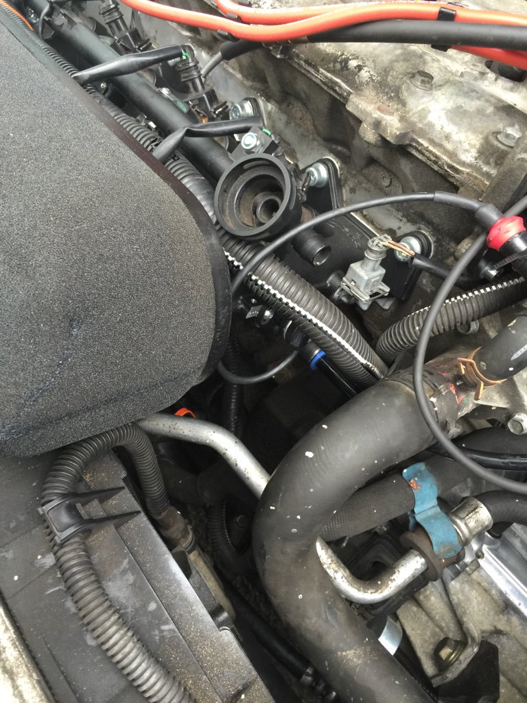

Mr postman made a brilliant delivery this morning,
Shall be adding an oil cooler in the near future :)
This is the space I have to work with at the moment, once the aircon pumps gone should be much more room :)

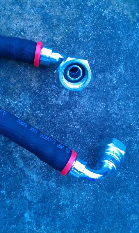

Be careful with that type of hose, those fittings are for a different push-on hose, I got caught out buying a cheaper supposedly socketless hose. I've lost an engine to the hose you have (or it looks like you have), even with double clamping it on the hose take-offs.
Here's a photo of the correct stuff, you might not be able to see properly but its got a harder outer layer wrapped around.
This is the stuff, PITA to get the fittings onto, you need to use boiling water to soften the hose to get the fittings on http://www.ebay.co.uk/itm/Aeroquip-...ts_Vehicles_Automobila_ET&hash=item5662466287

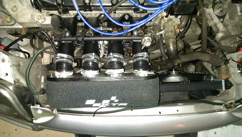

I've got a fair bit more space with the longer trumpets and Scirocco rad, you'd be able to make the trumpets even longer on a Ph2. The angle of the DTH ITBs from the butterfly to the engine is better than the SF bodies on the MR23 manifold but the trumpet length and filter location is really compromised, hence I've done what you can see below, doesn't cost much but has many benefits.
£100 on them gets you more power, better torque, more space to work (negates the need for remote filter and having to remove bumpers), better airflow especially with the bonnet closed and so on. Such a worthwhile addition if you run the KTec DTH ITBs.

For the hose I got myself the gates stuff with the harder outer layer and ditched the stuff that felt like heater hose, I used to run the same stuff on my old cooper, preferably I would of run braided with the aeroquips, but unfortunately funds don't allow for it,

Hopefully the Gates stuff should be good, get some decent hose clamps (Jubilee, Norma etc.) on too just in case.
